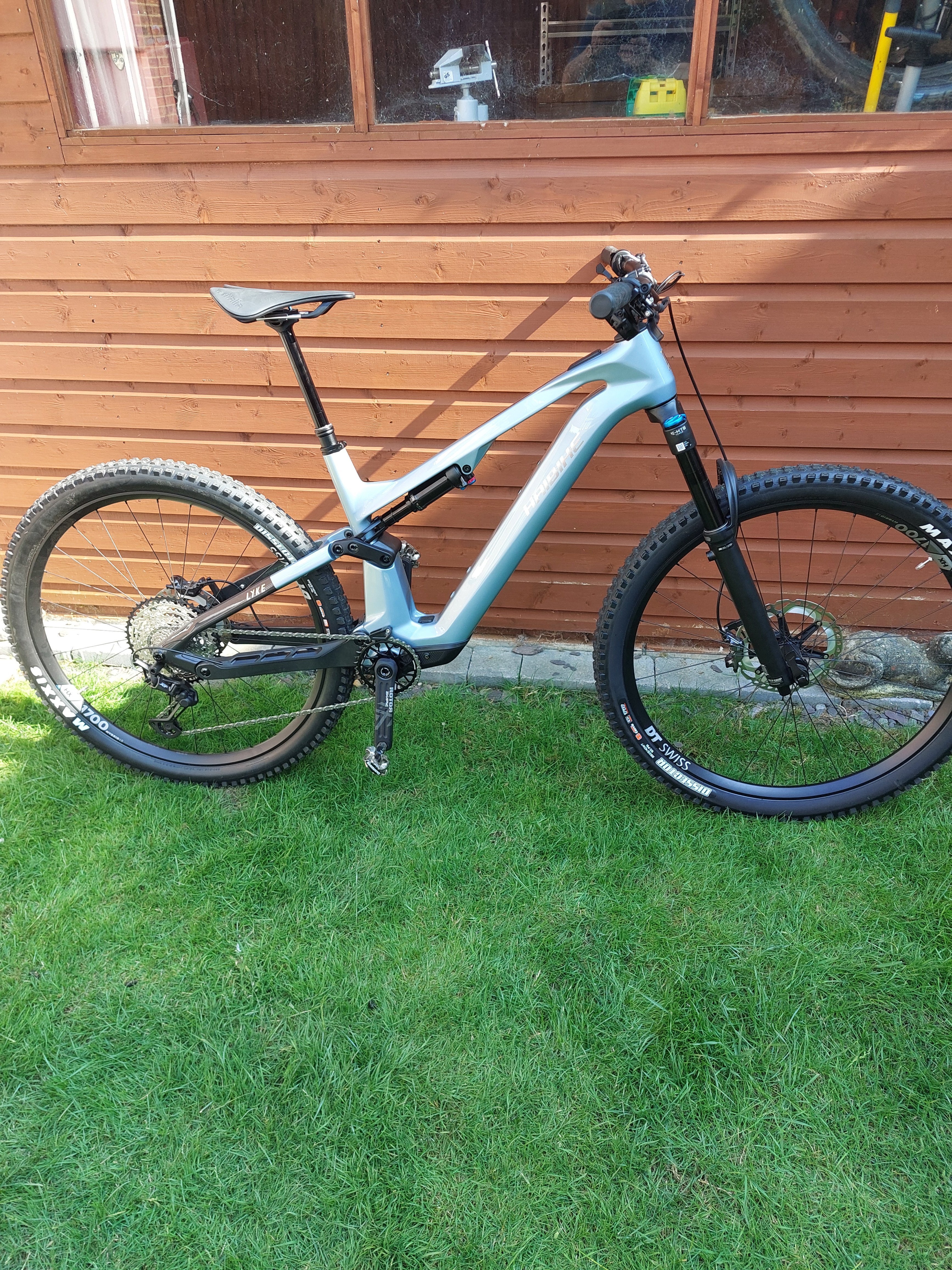

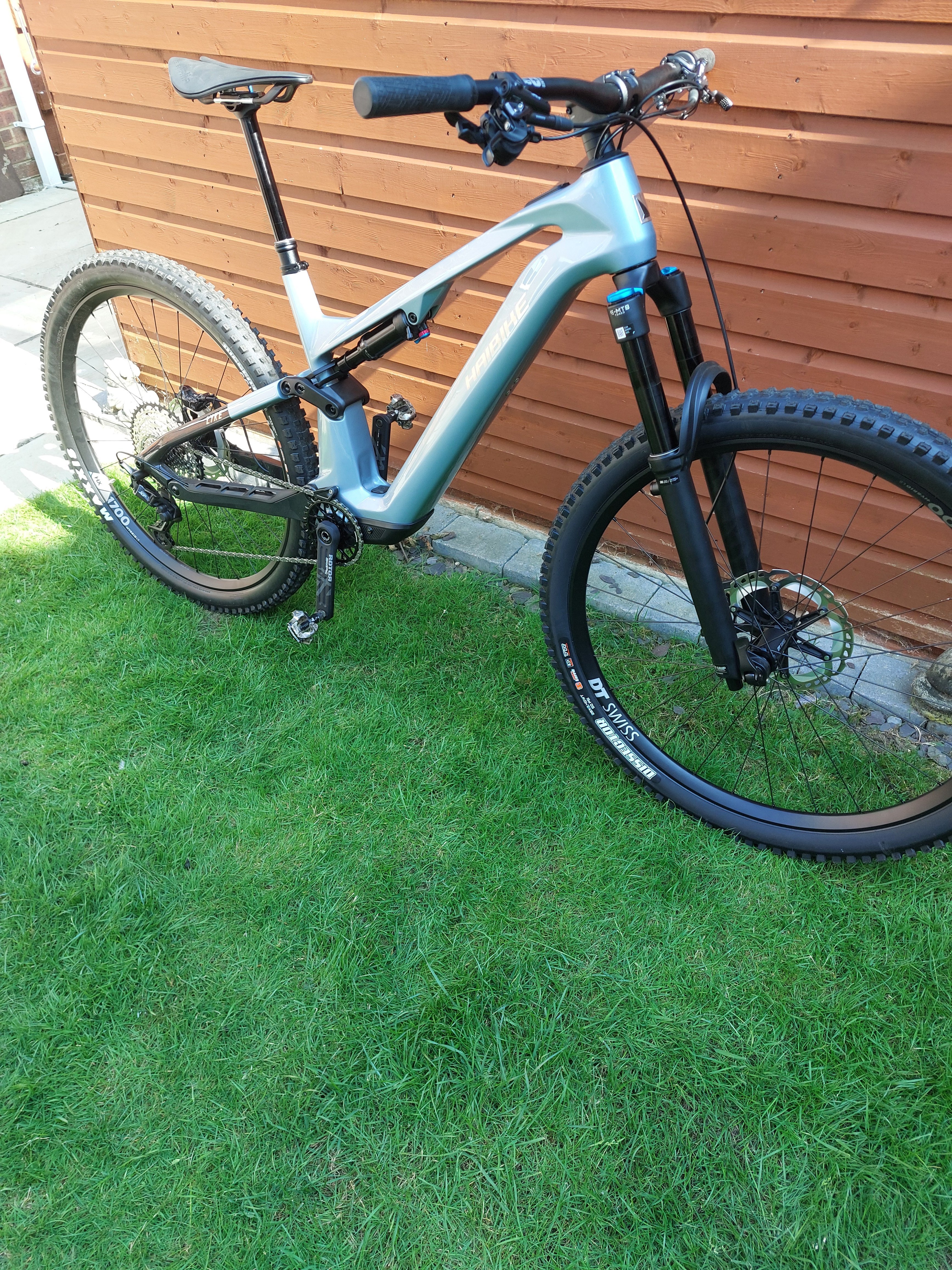

Lyke cf11 in the blue..she is 🥰
Came with the new 480wh battery too..
After a few miles and tweaks the bike is excellent.
If I put my carbon wheels on this thing will be nearly 2kg lighter with xc tyres and its already ok weight wise compared to my Levo.

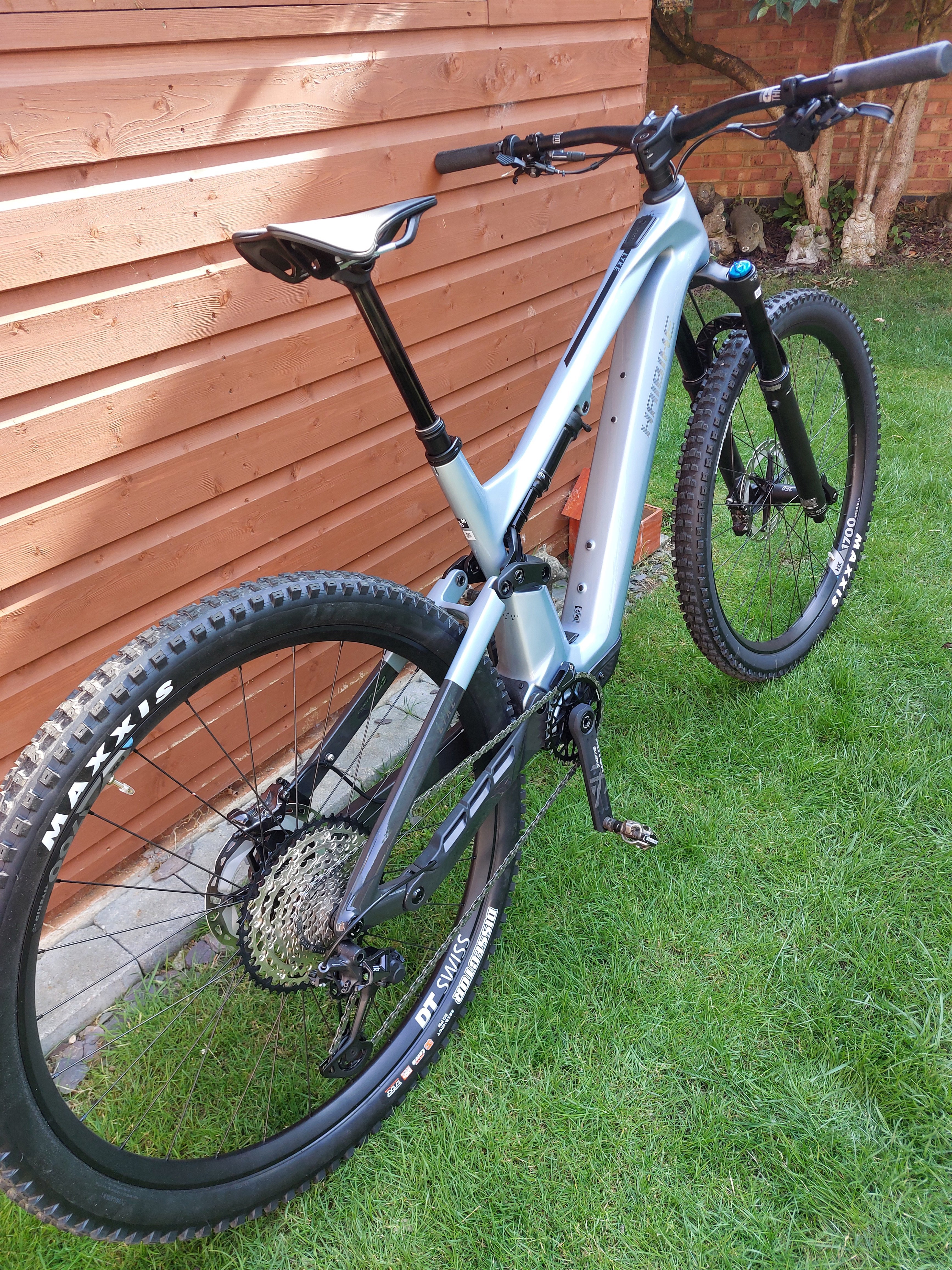

I had a creak in the frame..
Solved that with a bit of packing on the battery top mount.
The 2 prongs rub on the frame and make a seat post type creak noise
Slacken the 2 security bolts a couple of turns only Do not remove 😊
Slide in some packing 25mm wide 40mm long ,you will need long tweezers ect for this..I have fish tank tweezers ,perfect tool..nip up bolts and refit battery, done.
So creaking noise sorted .
