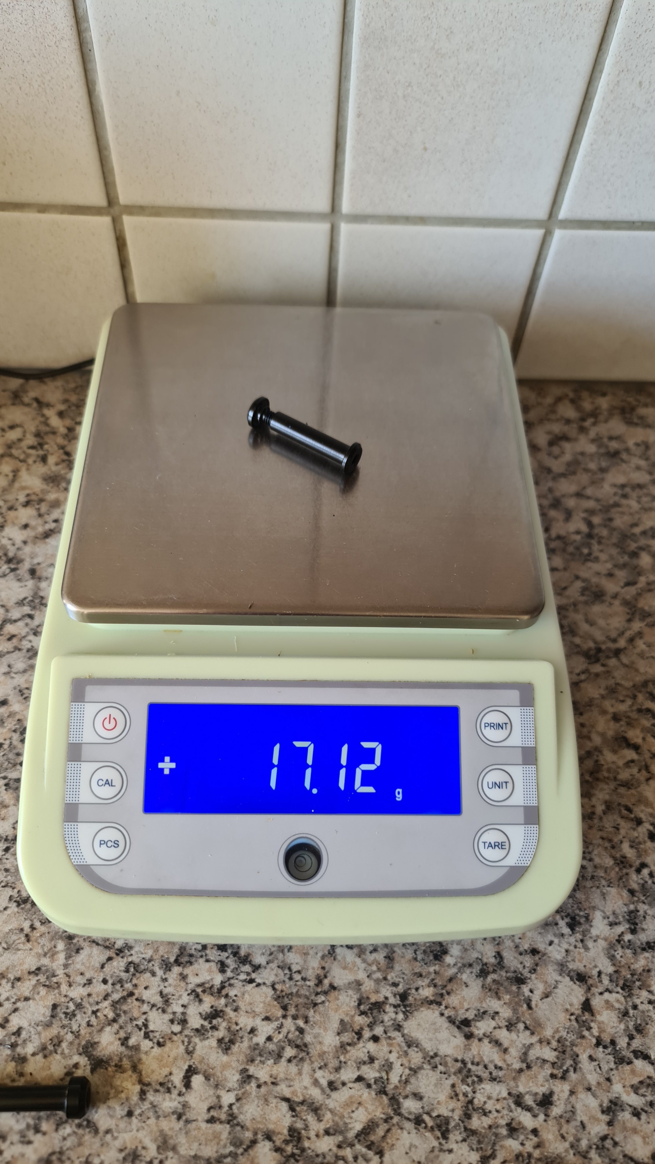

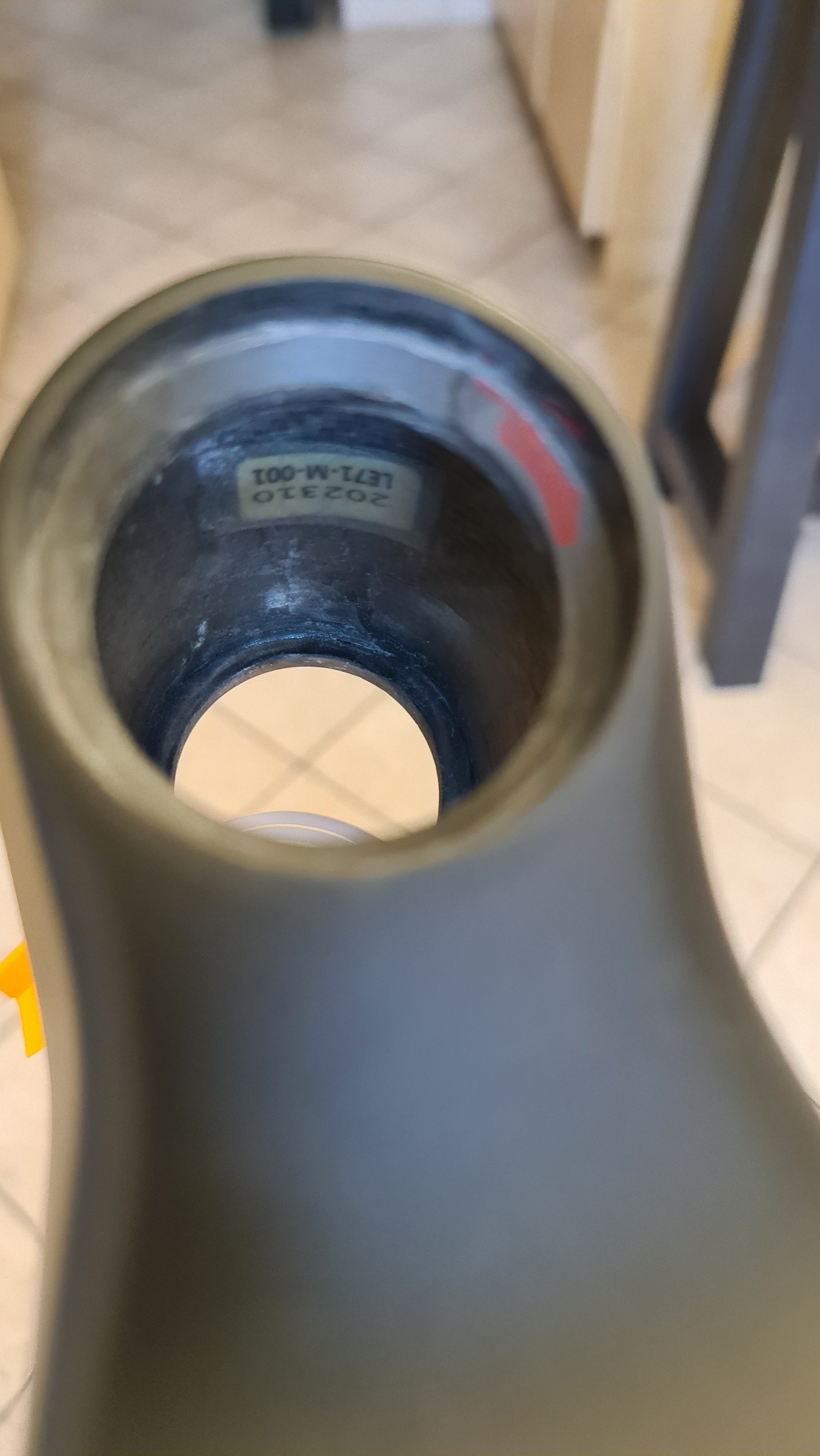

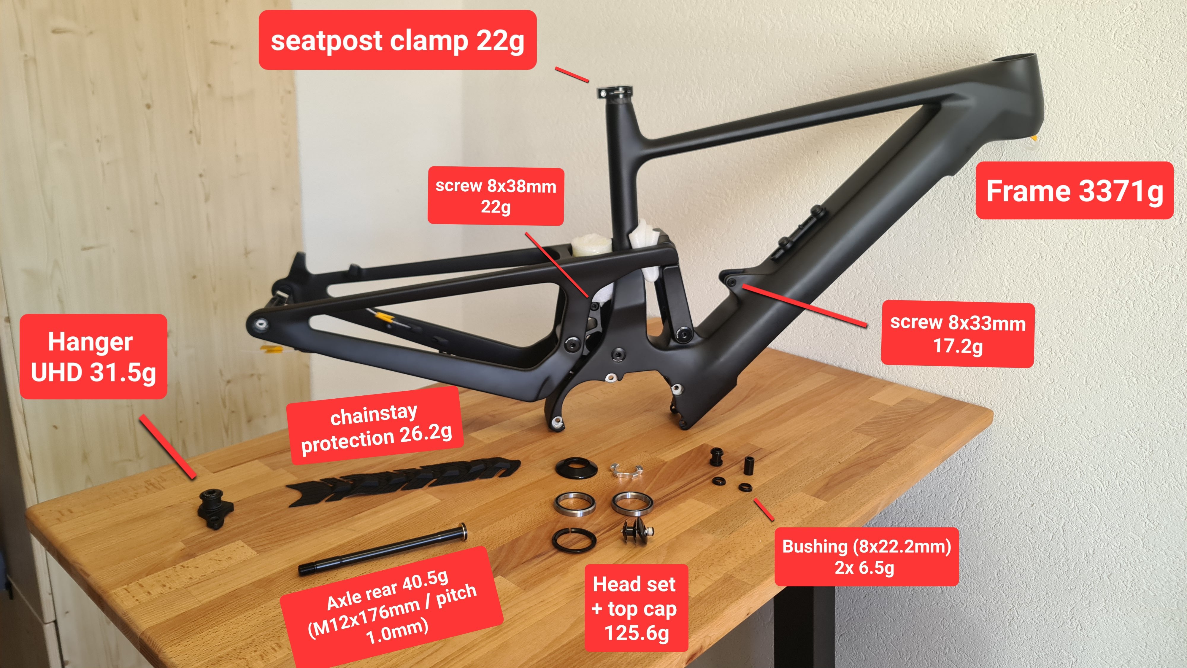

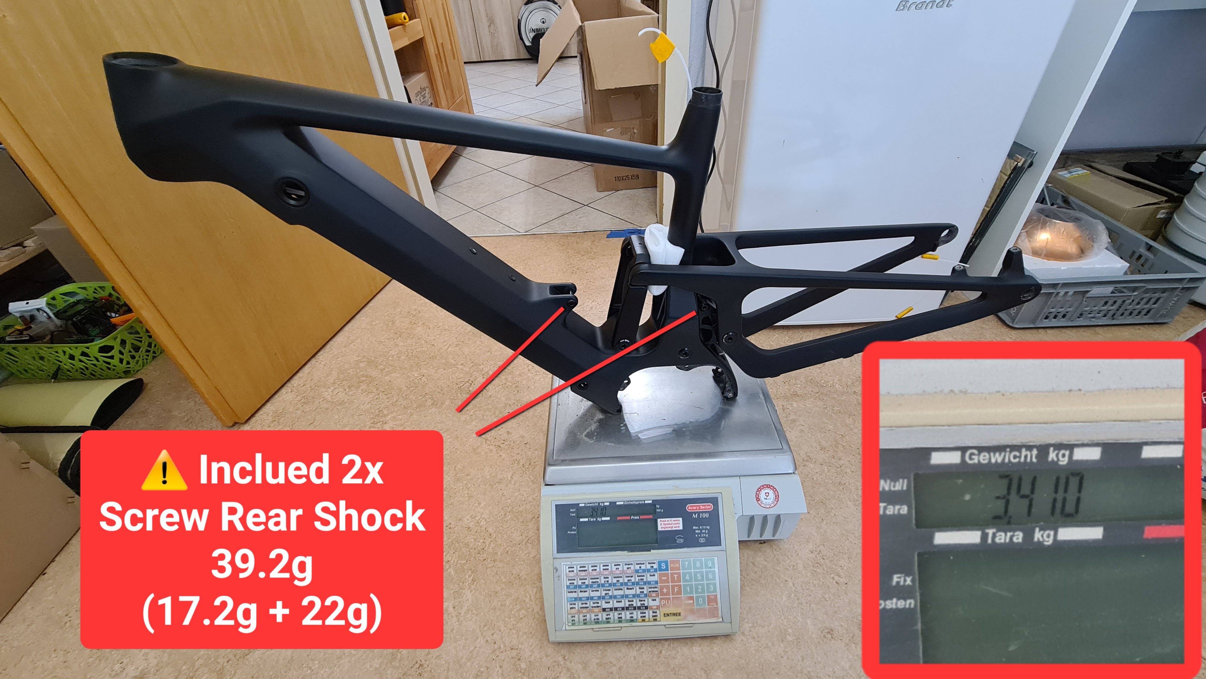

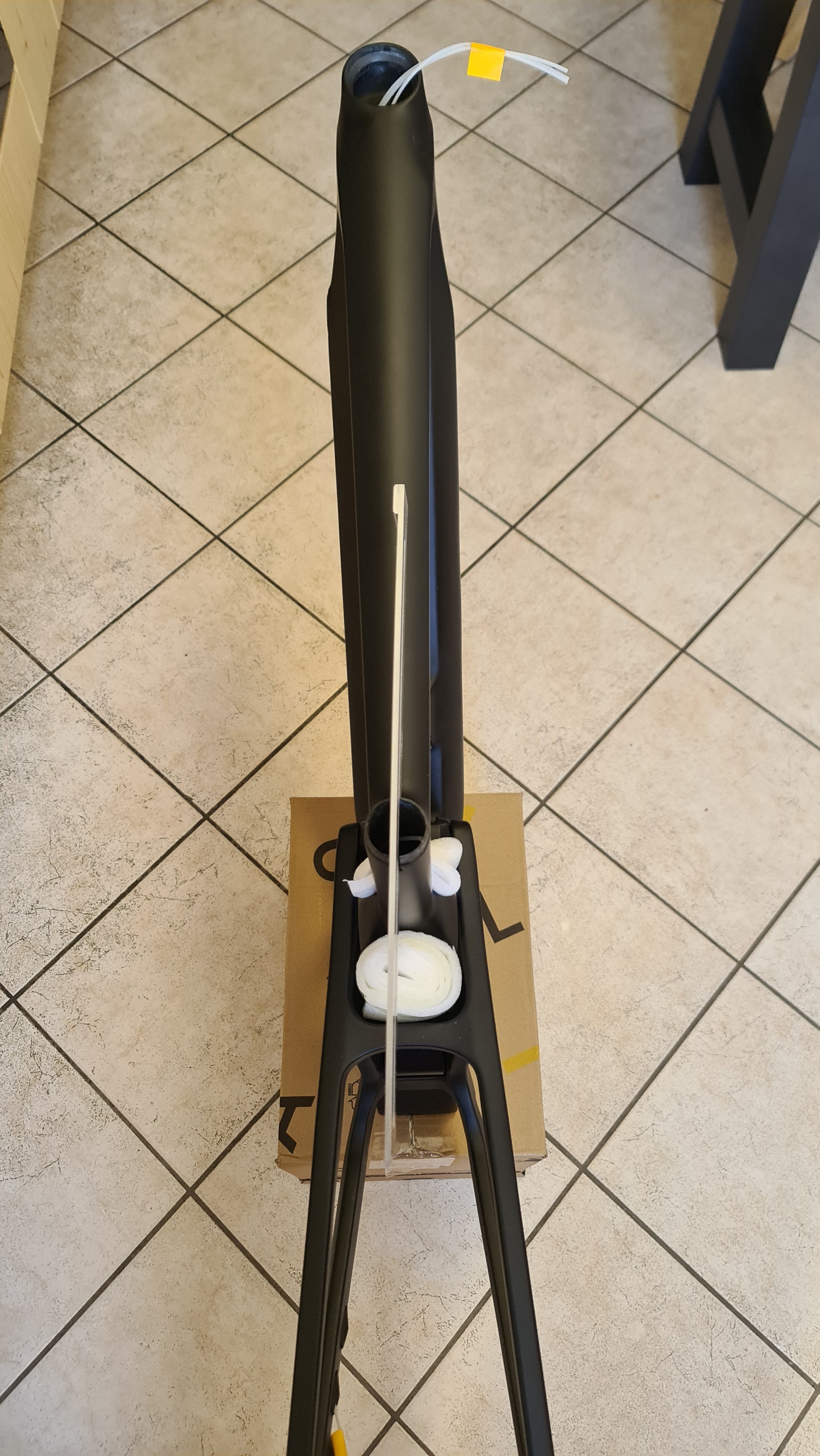

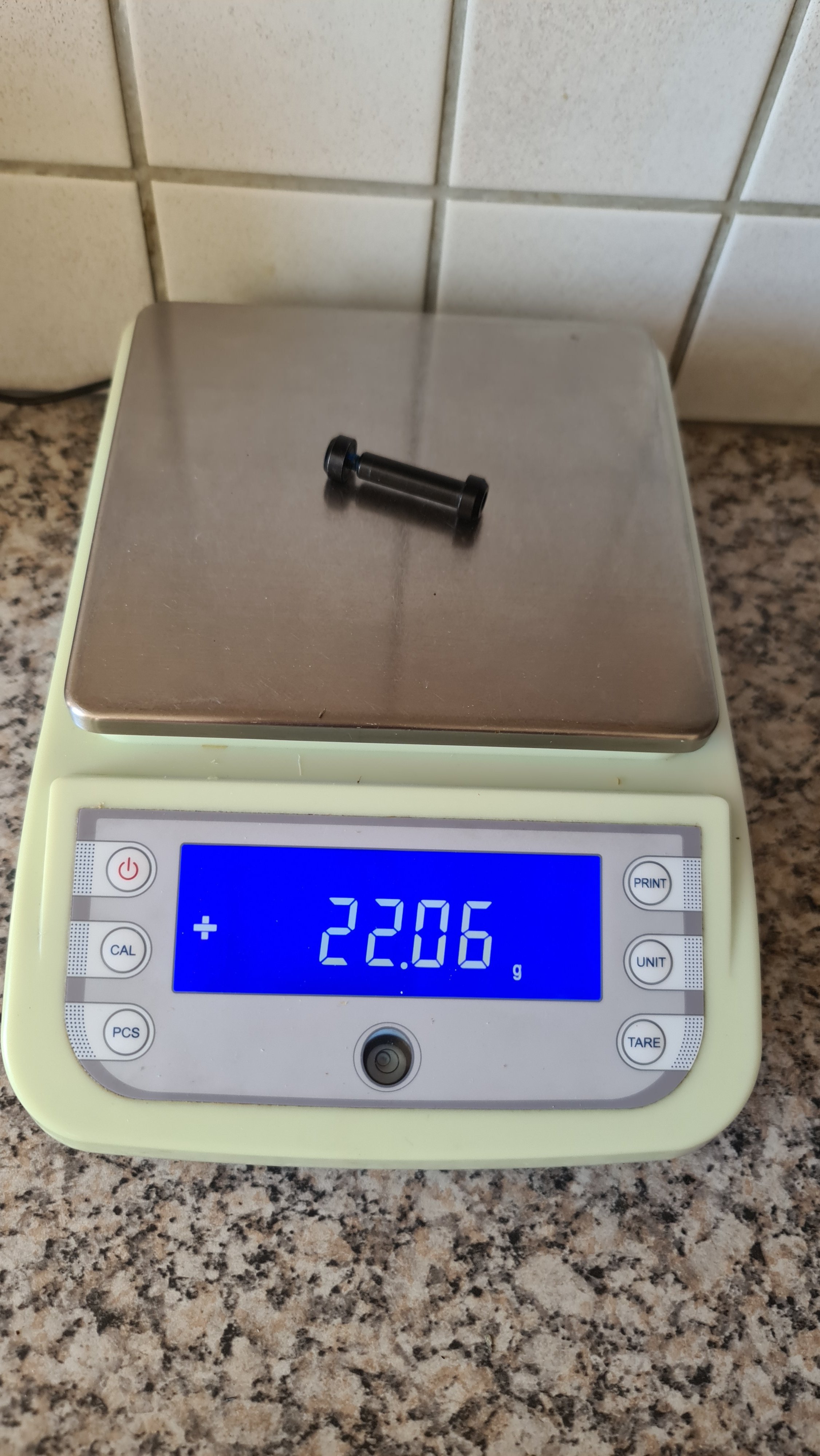

Let's start with the centerpiece, the frame !

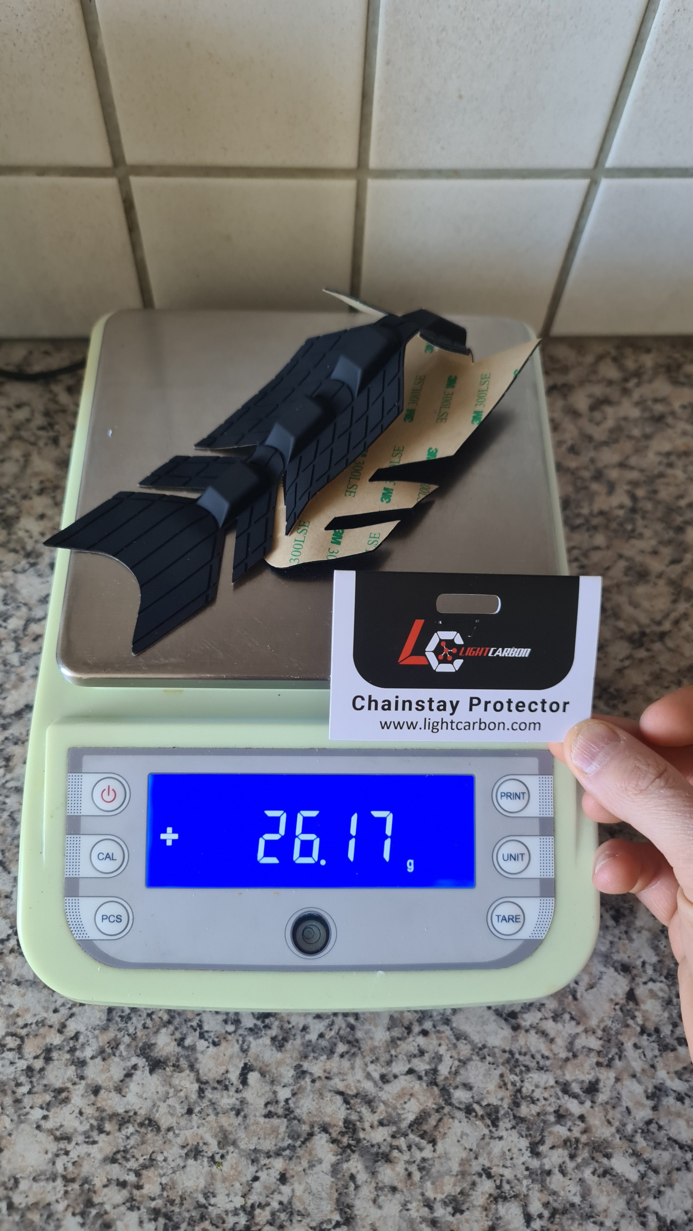

Lightcarbon advertises a weight of 3750g +/- 45g for the "Size M."
This specification is well-respected, and my frame weighs approximately 3669g with the base paint (matte black), including some basic components (see photos).

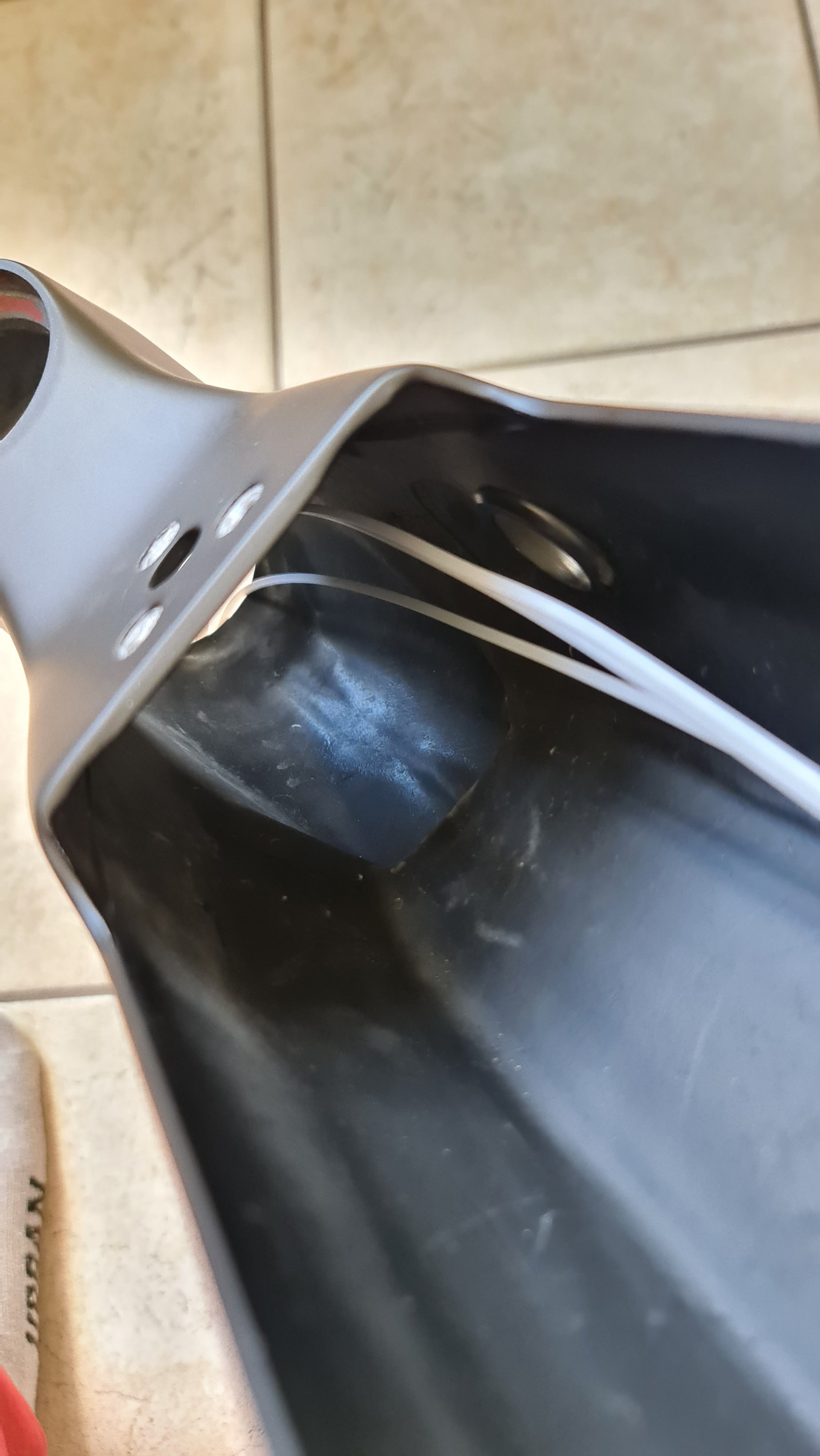

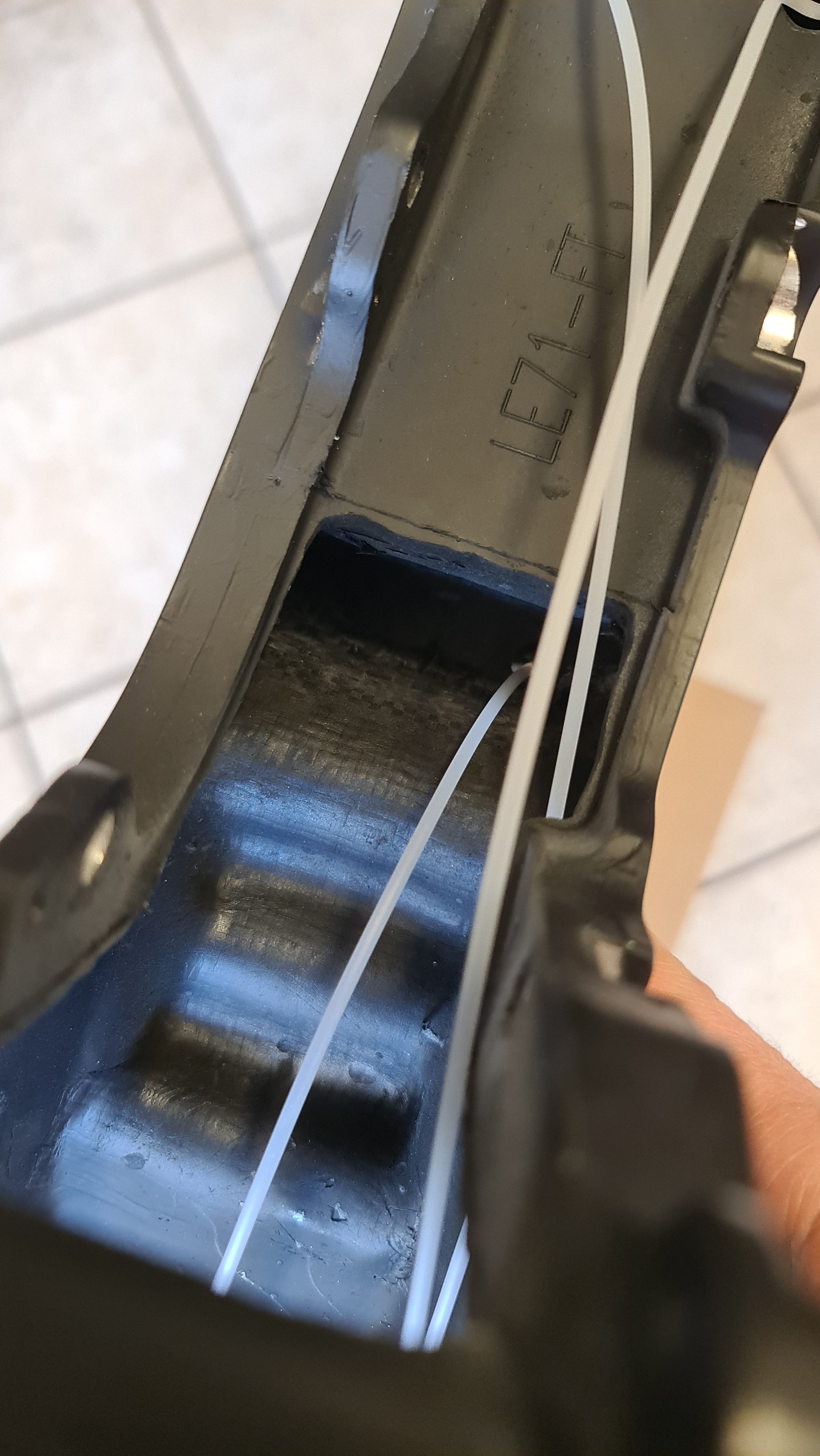

Here, "Lightcarbon" adopts, in my opinion, a good practice by including certain basic components in the frame weight. Therefore, it's reasonable to assume that with a customized paint job, we would still reach the specified 3750g or even 3800g.
The carbon manufacturing and finishing seem very satisfactory to me. Of course, to judge if a carbon frame is well-built, one needs to test it to see if the manufacturer has established a structure to make the frame adequately rigid yet flexible for comfort. I haven't noted any major defects in the frame; everything seems well-constructed.

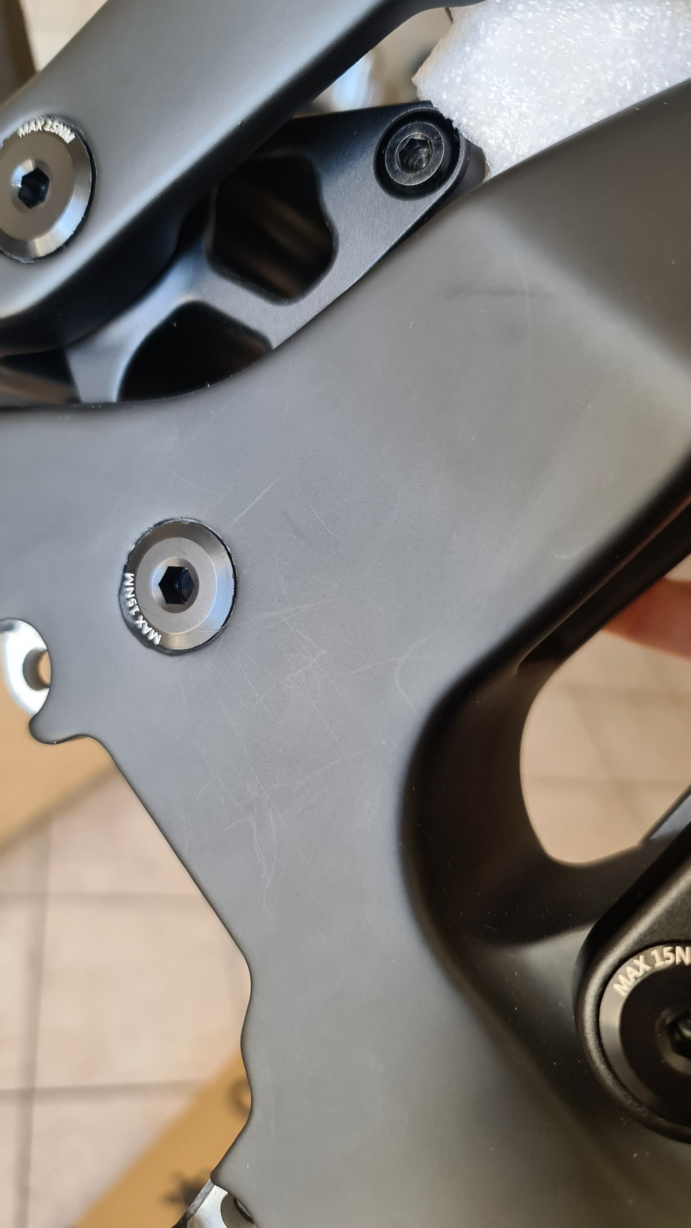

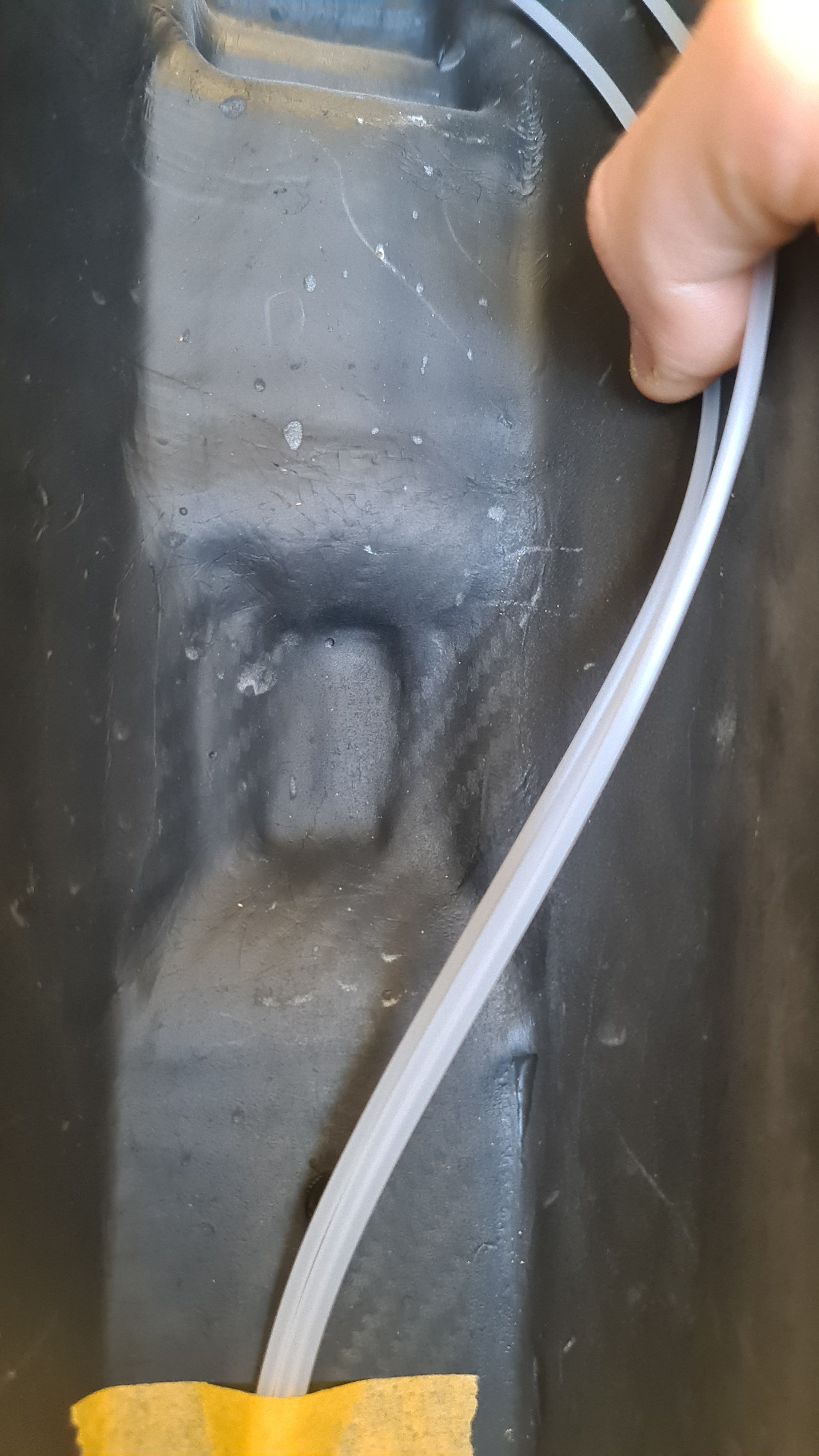

Regarding the paint, as seen in the photo below, the frame shows scratches quite easily. Can we say that the paint is of poor quality? Certainly not. What needs to be understood here is that a non-lacquered paint will tend to mark like this anyway (my Frey AM1000 EX behaves exactly the same way). If you want to address this issue (which isn't really a problem), you'll need to lacquer your frame with a matte clear coat. That's the only solution (but it adds weight).
I should note that the scratches were not present during unpacking.
I accidentally caused them myself while handling the frame.

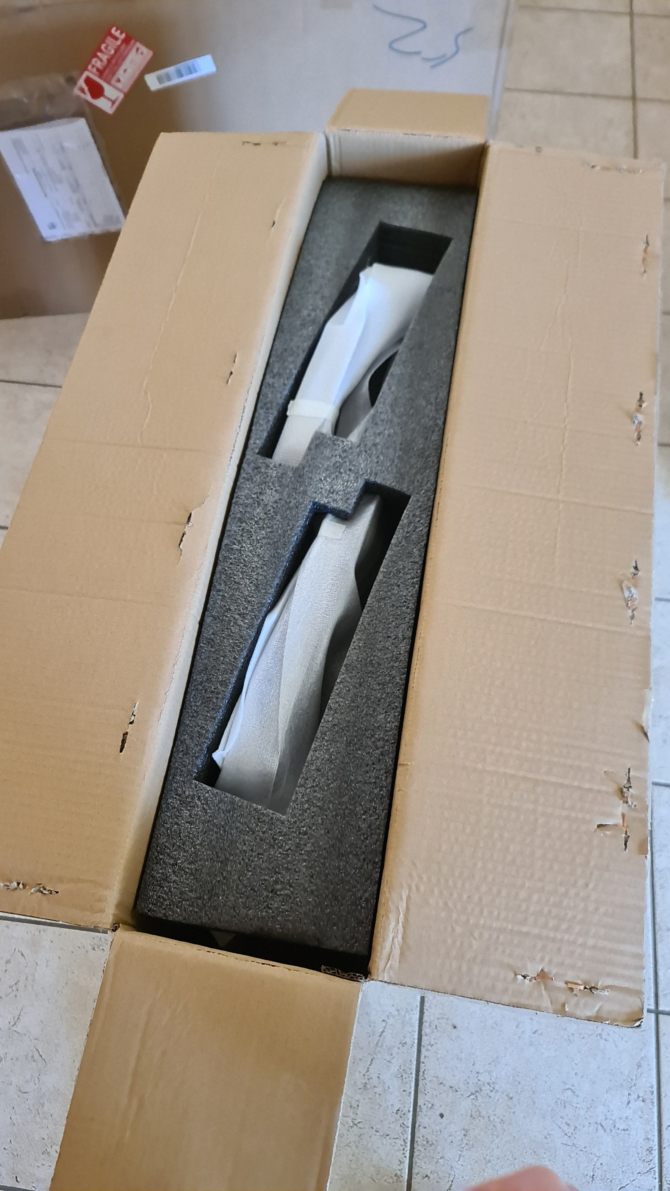

The frame was well-packaged with no apparent scratches.

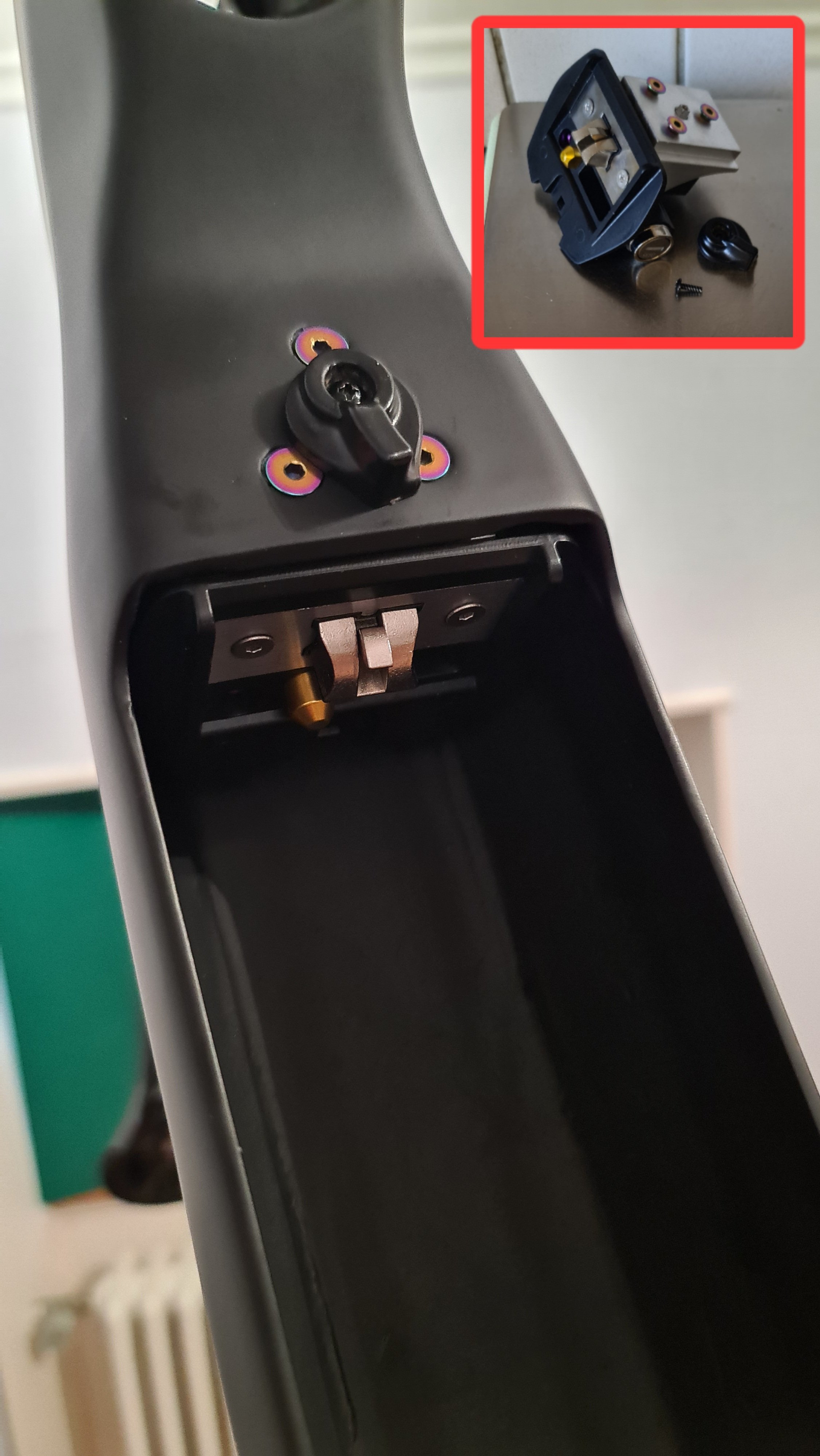

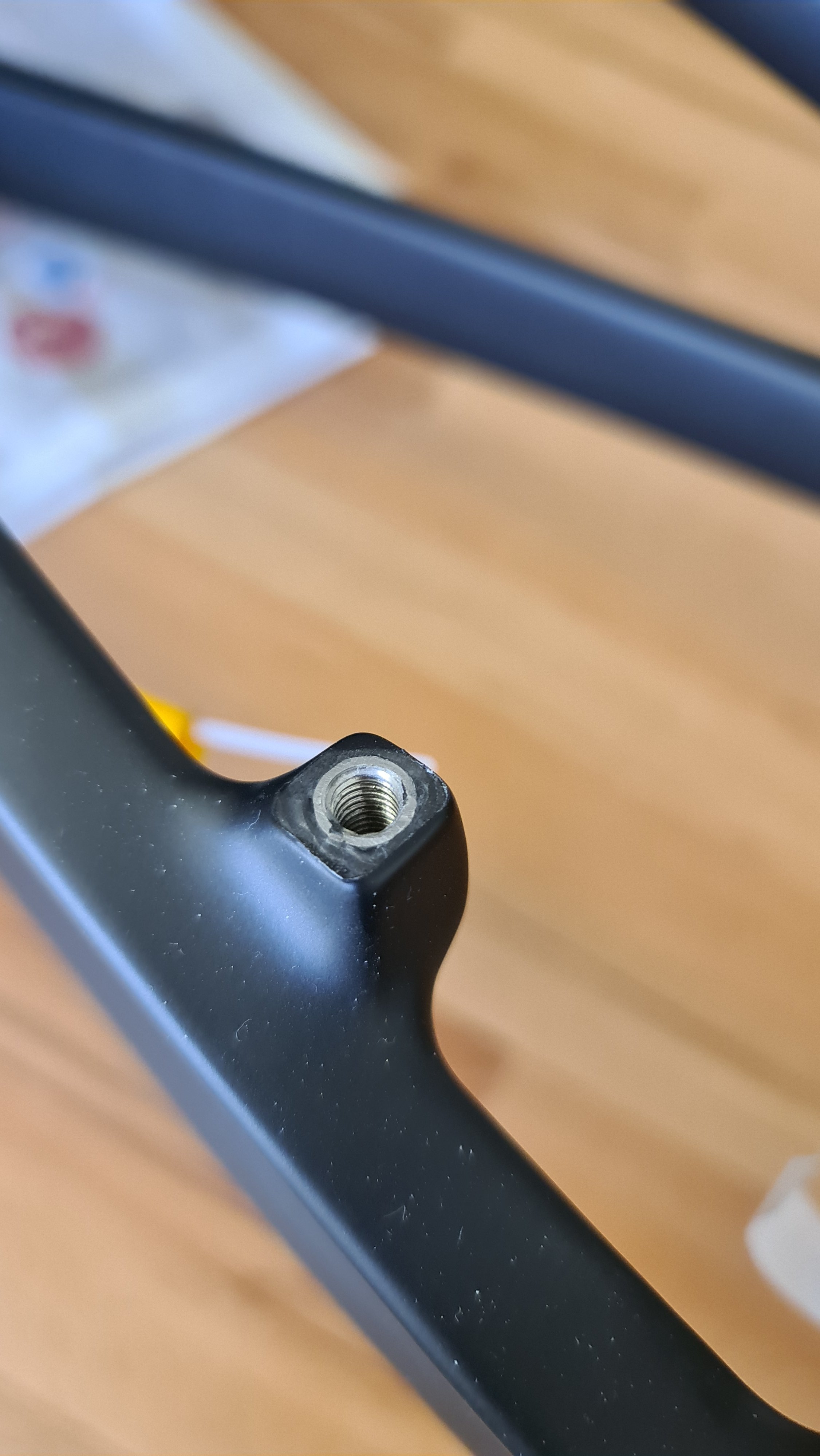

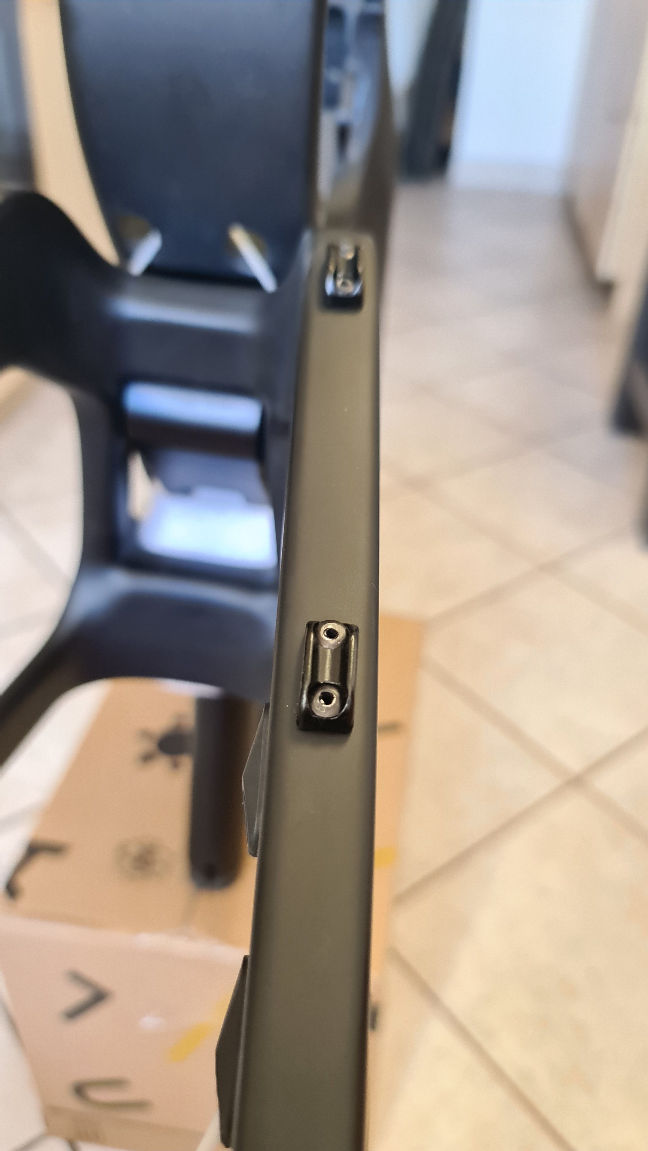

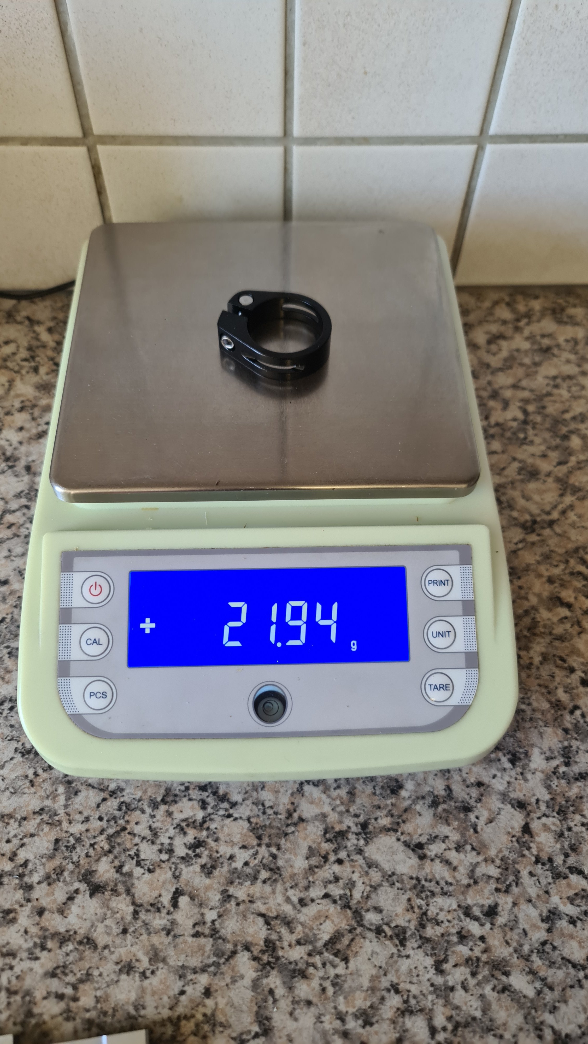

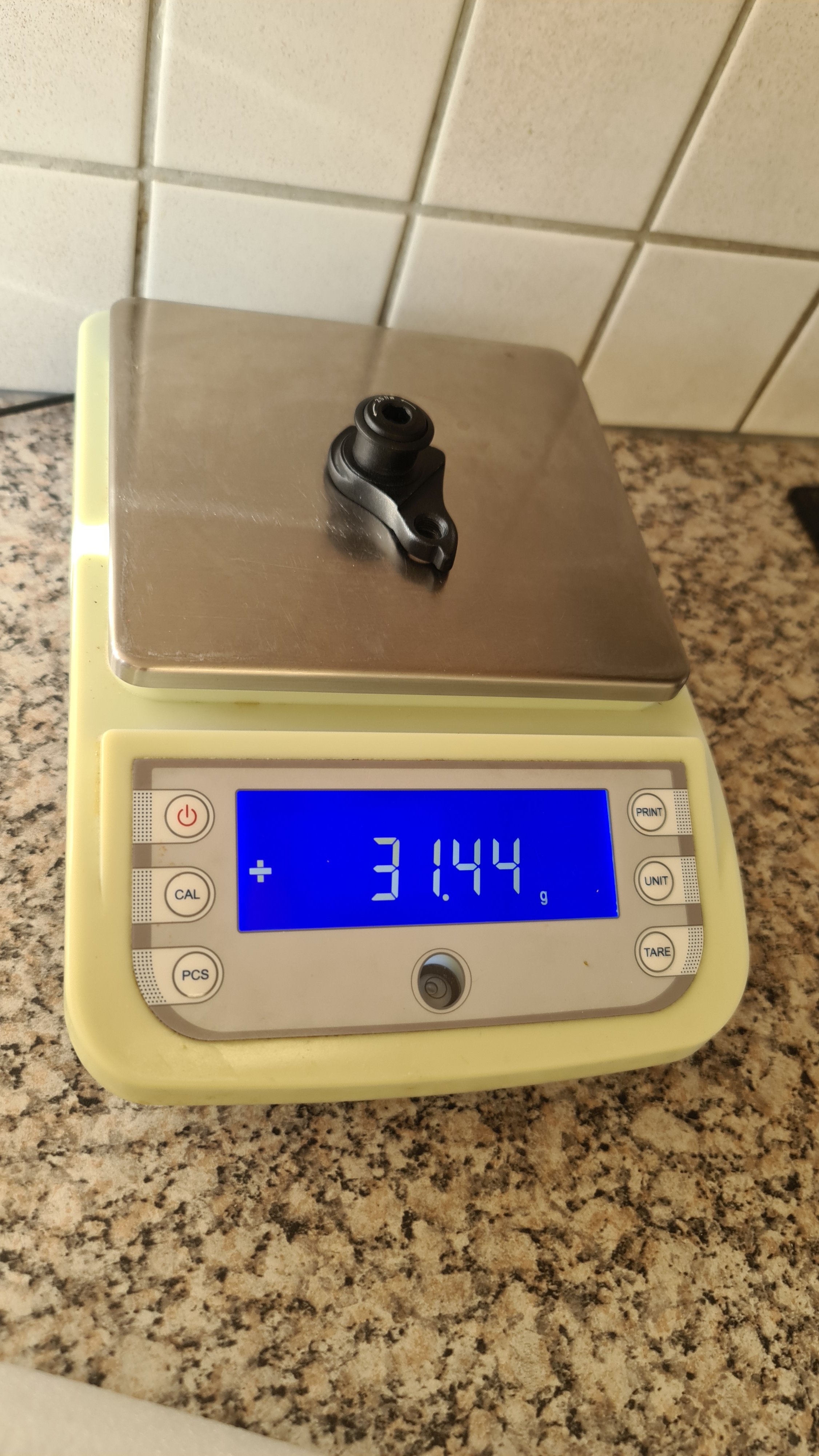

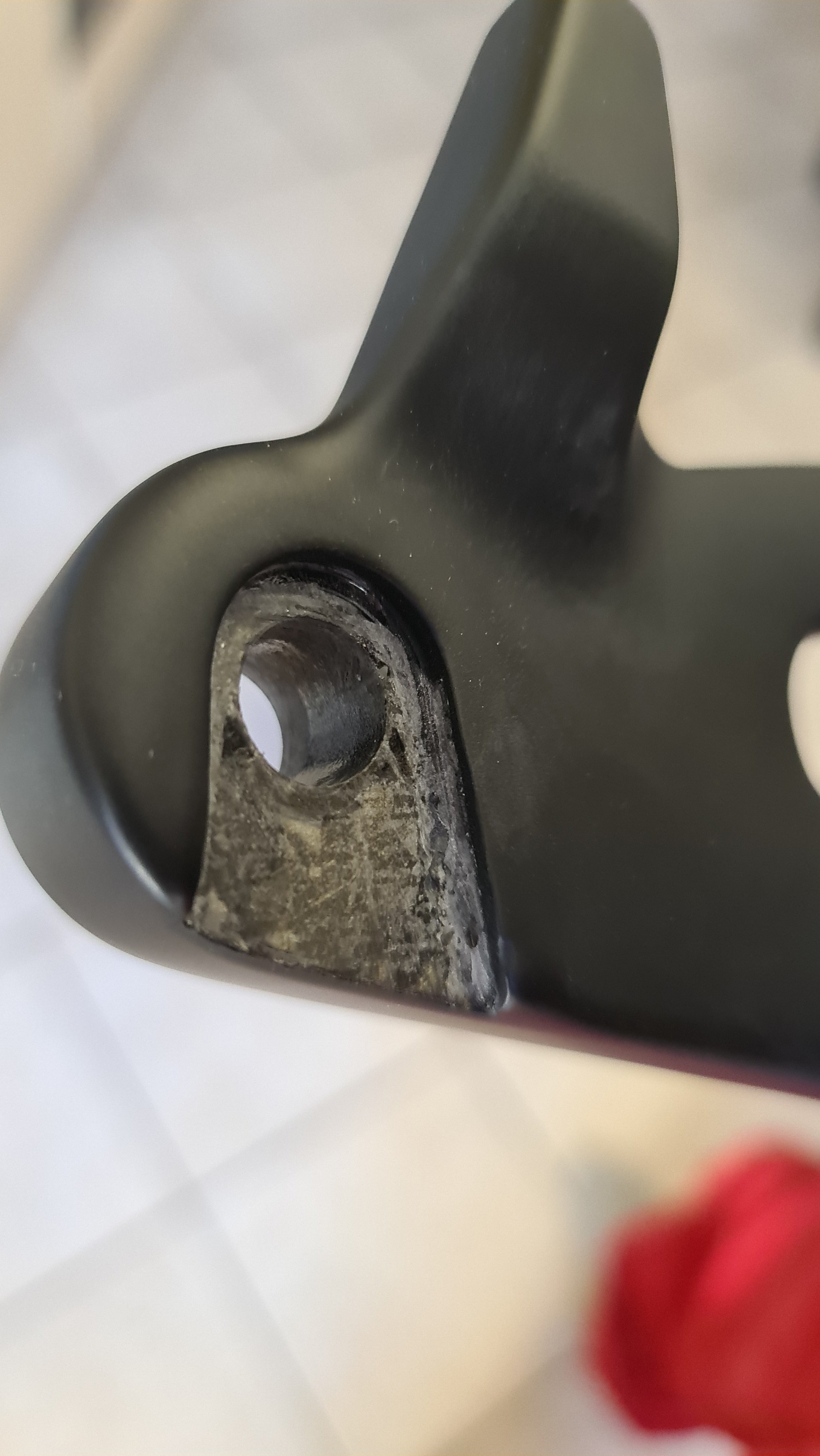

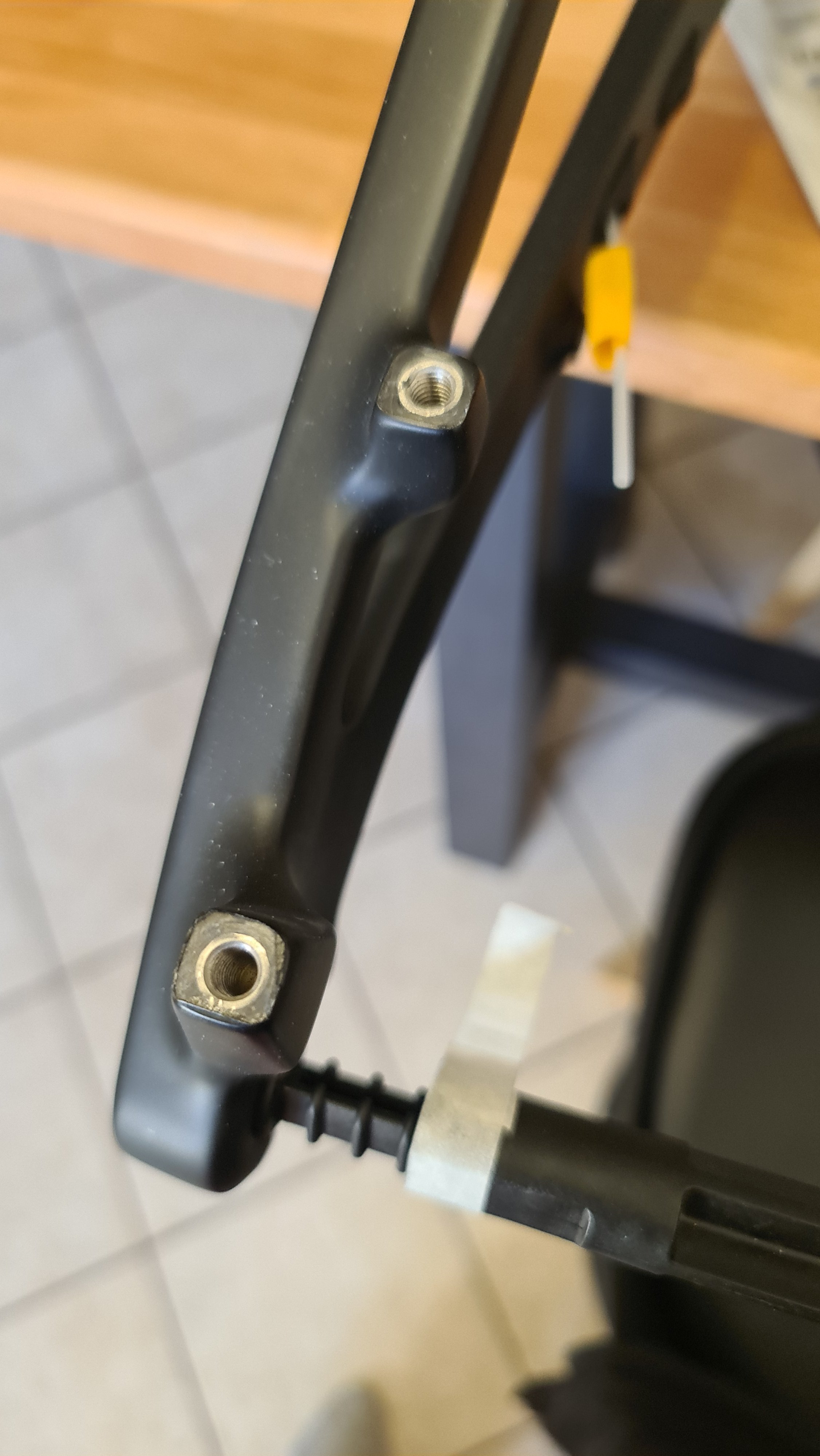

We'll also take a brief look at the seatpost clamp.
Here, the only minor criticism I could make, and it's a purist's criticism, is that the two notches are not perfectly aligned with the frame. However, there will be no hindrance in use.

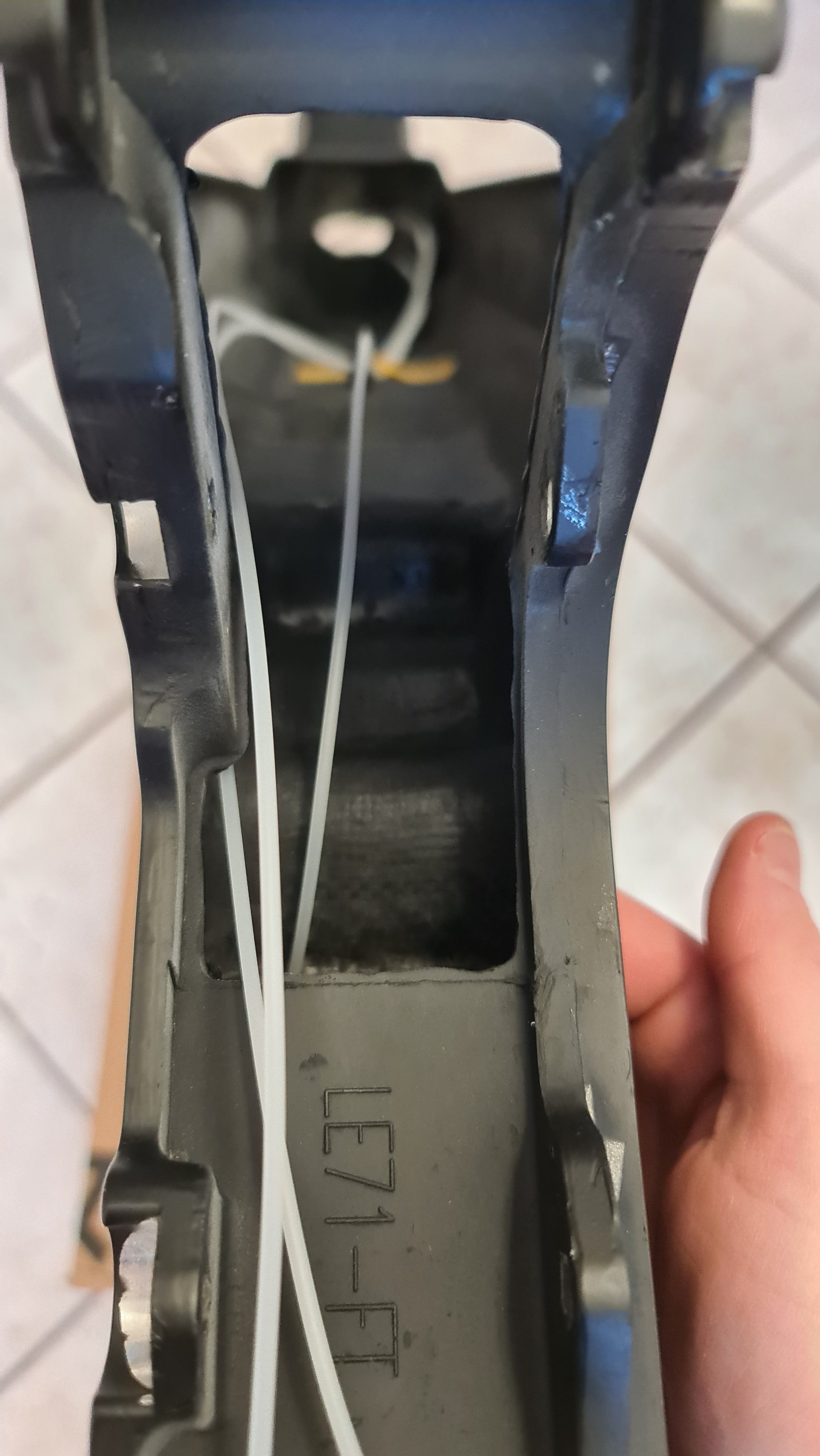

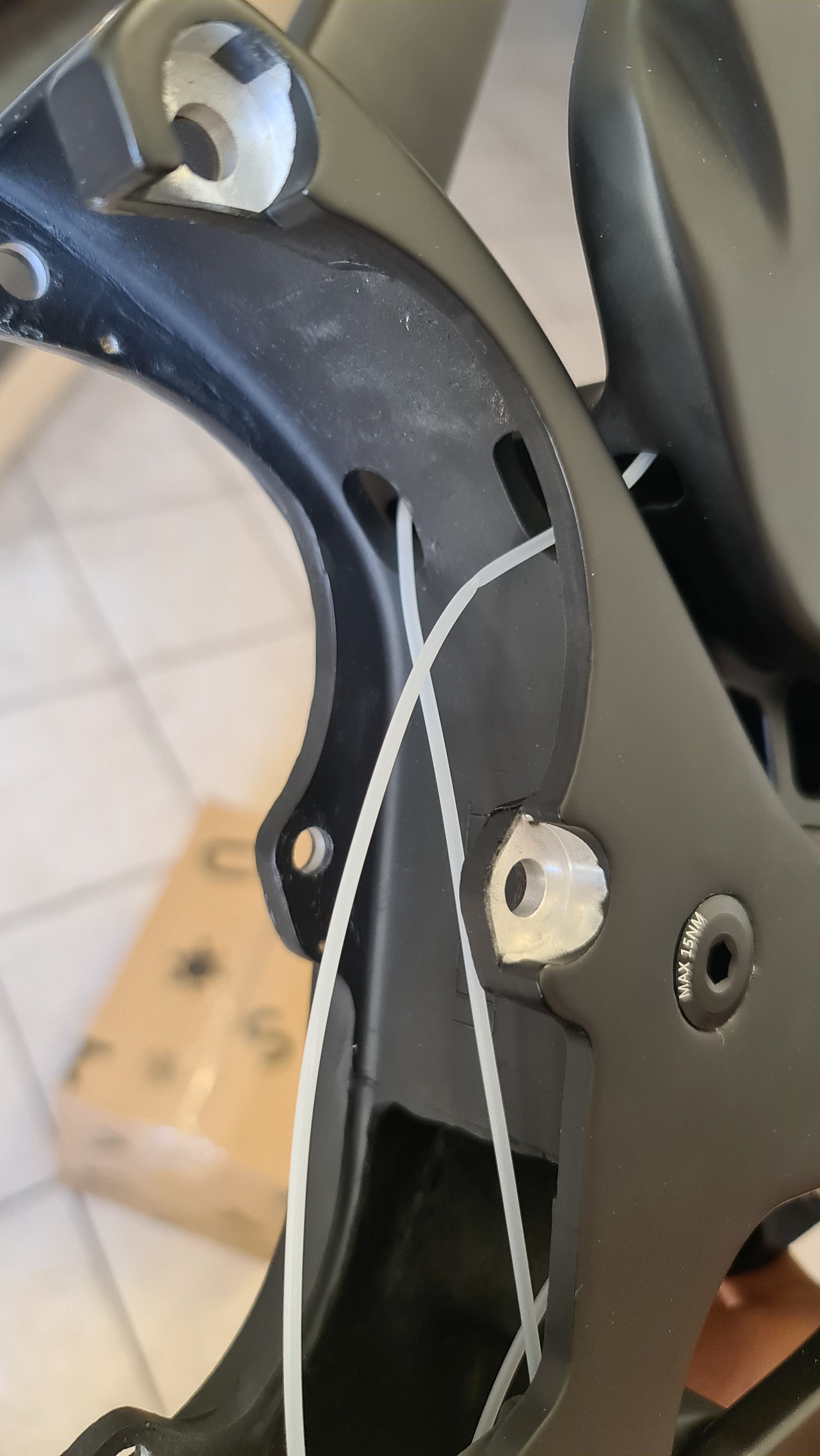

Personally, I'm always curious about the technical aspects, and that's why I'm sharing a link where you can explore the rear frame suspension kinematics.
Next, I'll discuss the carbon rims, model: E810-AD938-EN-Race circle.
Frame trame (2).jpgFrame trame (3).jpgFrame trame.jpgFrame biellette.jpgFrame Head Set XL P16 52x7x45°.jpgFrame mount brake rear (2).jpgFrame mount brake rear.jpgframe mount cable brake.jpgFrame mount motor (2).jpgFrame mount motor.jpgFrame rear.jpgFrame seatpost clamp 2.jpgFrame seatpost clamp.jpgFrame.jpgFrame paint black mat.jpgHeadset + frame (2).jpgHeadset + frame.jpgAxle Rear.jpgBushing 8x22.2mm.jpgHead Set XL P16 52x7x45°.jpgProtection frame.jpgScrew Shock Rear 8x33mm.jpgScrew Shock Rear 8x38mm.jpgseatpost clamp.jpgSram Hanger UDH.jpgTop cap Carbon + Fork Steerer Headset .jpgWeight Frame (2).jpgWeight Frame.jpg

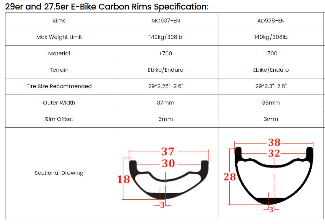

In choosing the wheel type, I hesitated between two models for a long time...
The model E810-AD938-EN-Race and the model E810-MC937-EN-Race.
Both models share the same type of spokes (Sapim Race), the same hubs(E810), and an asymmetrical design.
However, one model has deeper rims, while the other has shallower ones (MC937 = 18mm / AD938 = 28mm).
In theory, a deeper rim is more vertically rigid, translating to better pedaling efficiency but sacrificing comfort. Currently, the trend is for depths between 18 mm and 22 mm for enduro or downhill riding. Personally, aiming for all-mountain riding and wanting to prioritize efficiency, I gave the 28mm depth model a chance. It's possible that in the future, I might regret this choice. We'll see if LightCarbon hasn't made the rim too vertically rigid. In the worst case, a too-rigid rim tends not to absorb vibrations, making the ride more tiring. An overly rigid rim also has less tolerance for riding mistakes. So, if you're like me and you're unsure, favor a lower height if you'll be riding on very rough trails. Conversely, if you want a more rolling bike, go for a higher height.

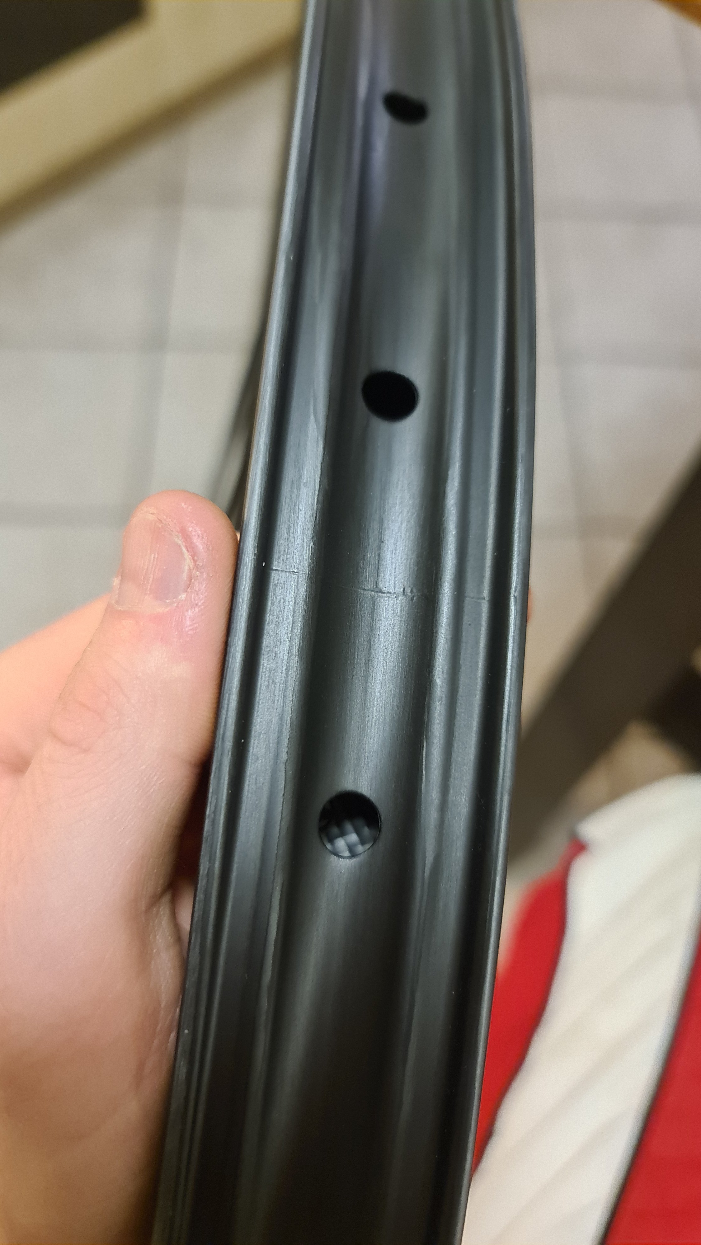

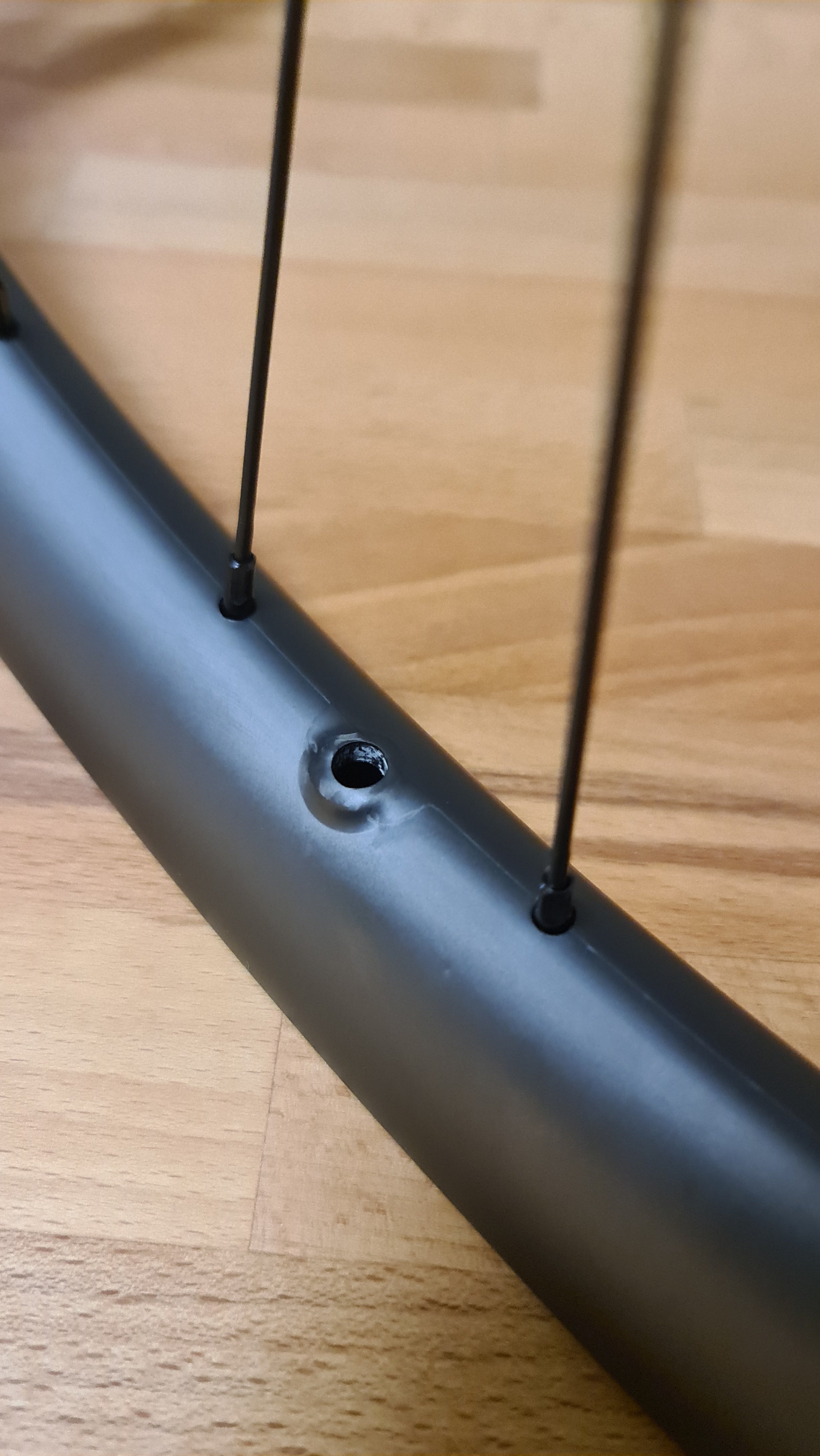

Visually, the rims appear to be of very good quality with solid assembly. Similar to the frame, the rims were chosen with a matte finish. However, (I would have liked to show you in a photo, but I couldn't) the paint layer is much thinner on the rims than on the frame. In reality, the rims have more of a satin effect, and you can very slightly discern the carbon weave. It's a style I wholeheartedly accept; I find it very attractive.
Let's take a moment to also briefly delve into the dimensions of the rim. The advertised width is 32 mm internal and 38 mm external. When taking measurements on the rims, it's observed that the depth (sorry, I can't find the photo) as well as the external width is as specified. However, the internal width falls short by 1mm (the smallest internal measurement I took was 30.4mm).

However, I took the time to check the "warp" of the rims as well as the "hop."
I'll share a short video with you...
It's excellent craftsmanship !

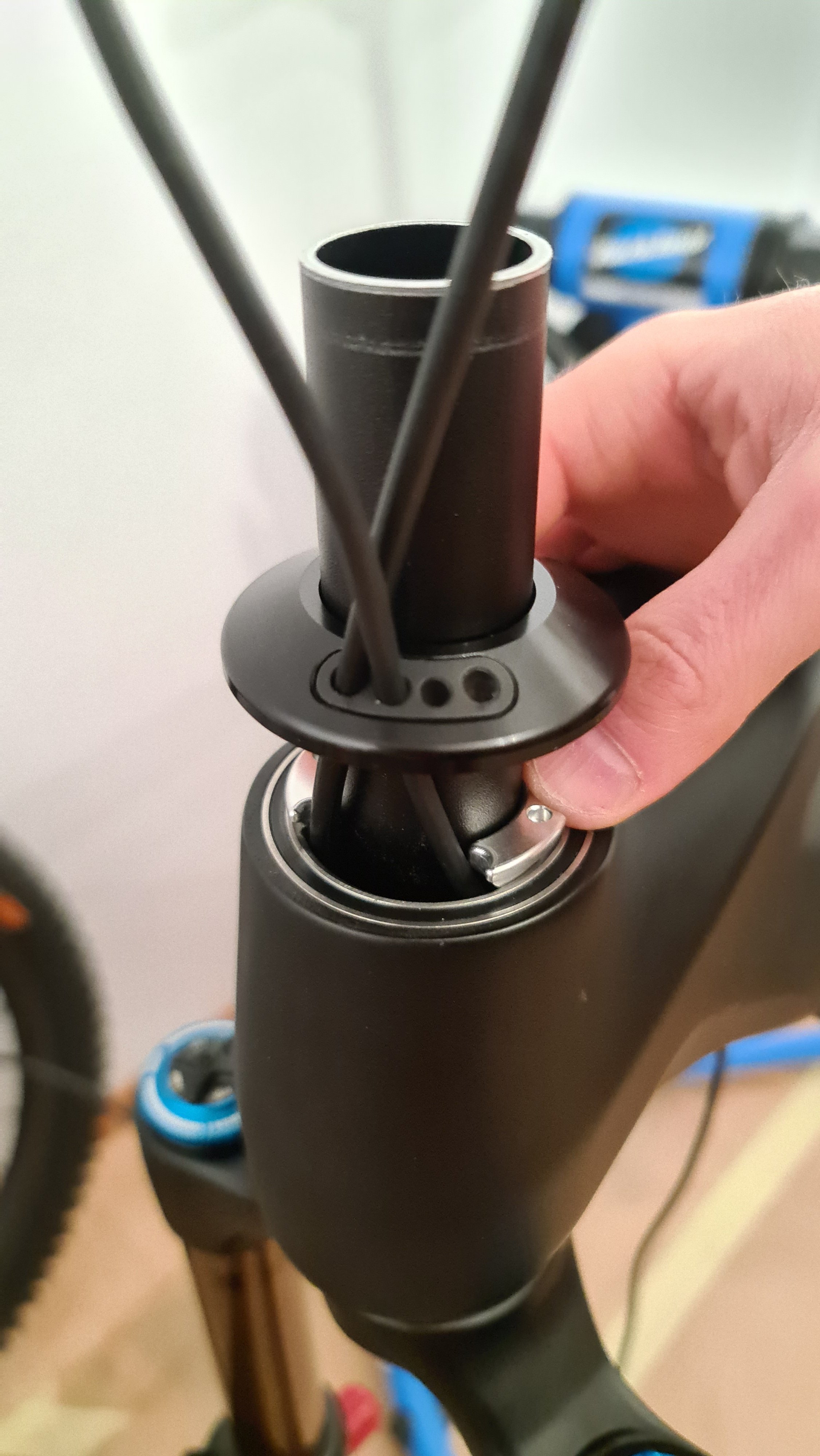

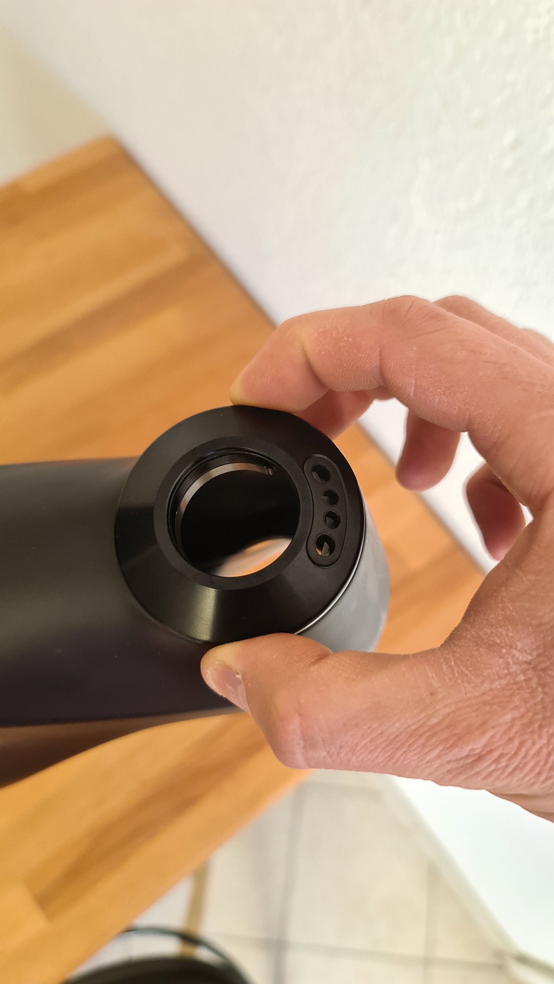

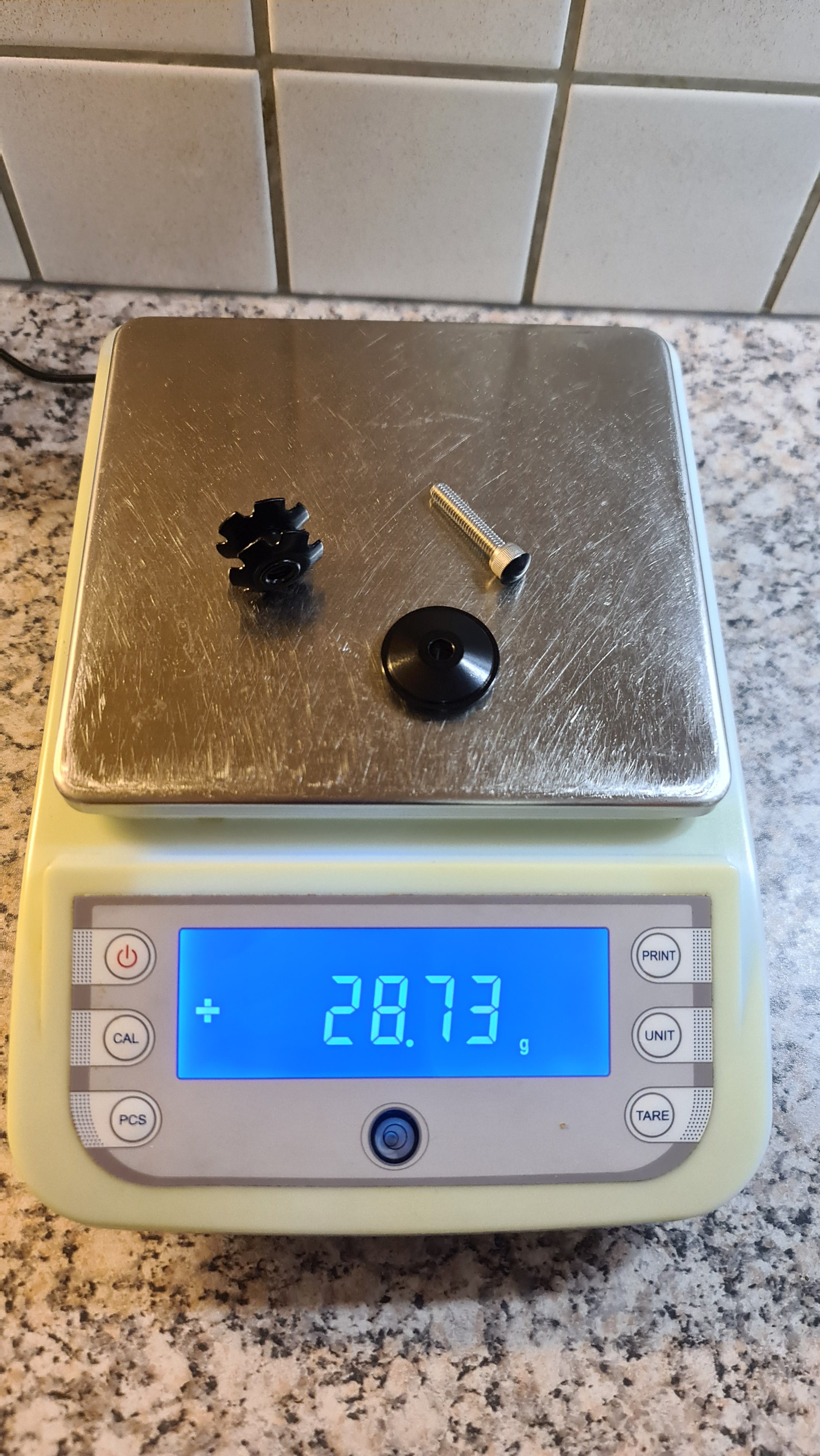

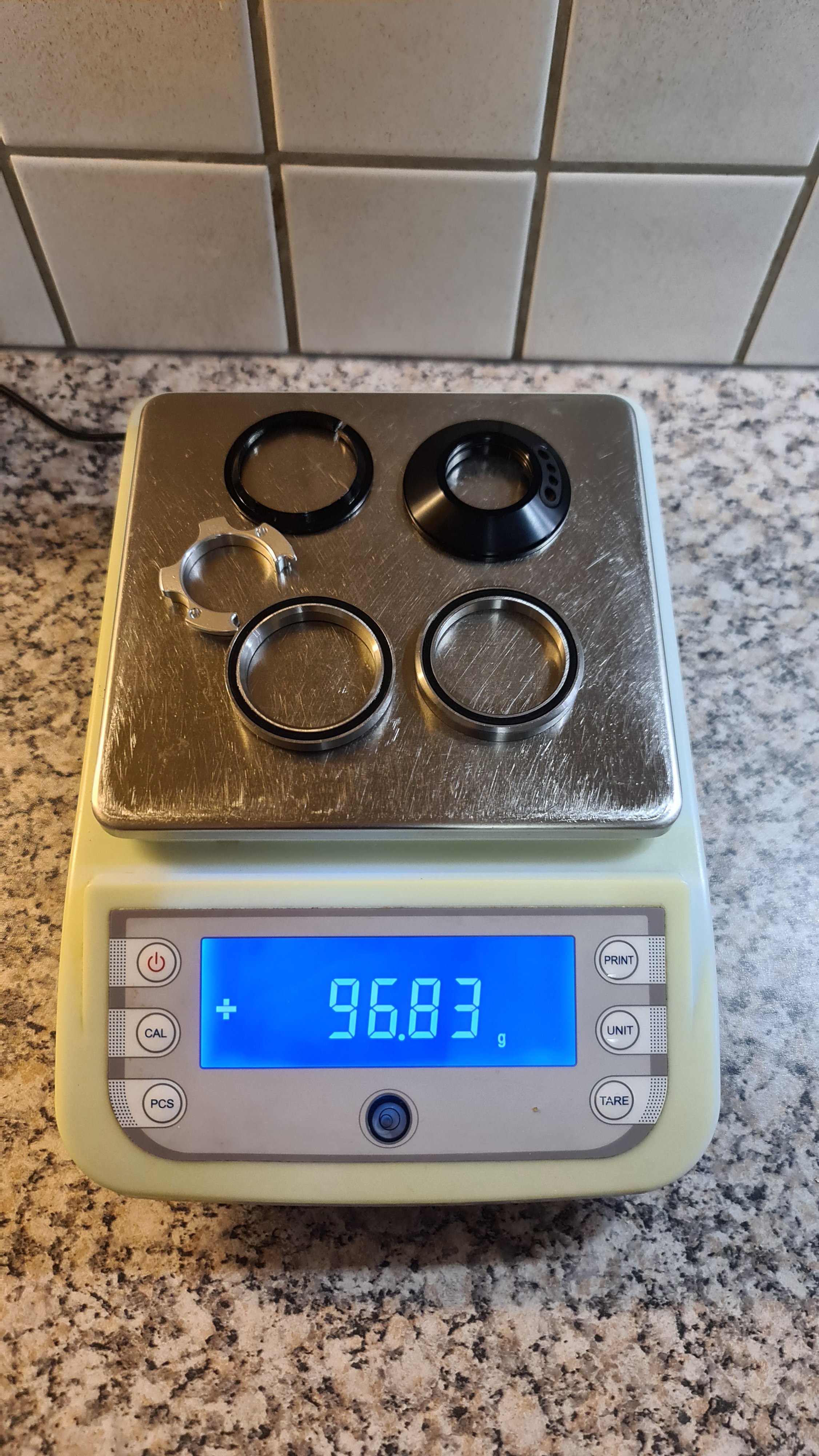

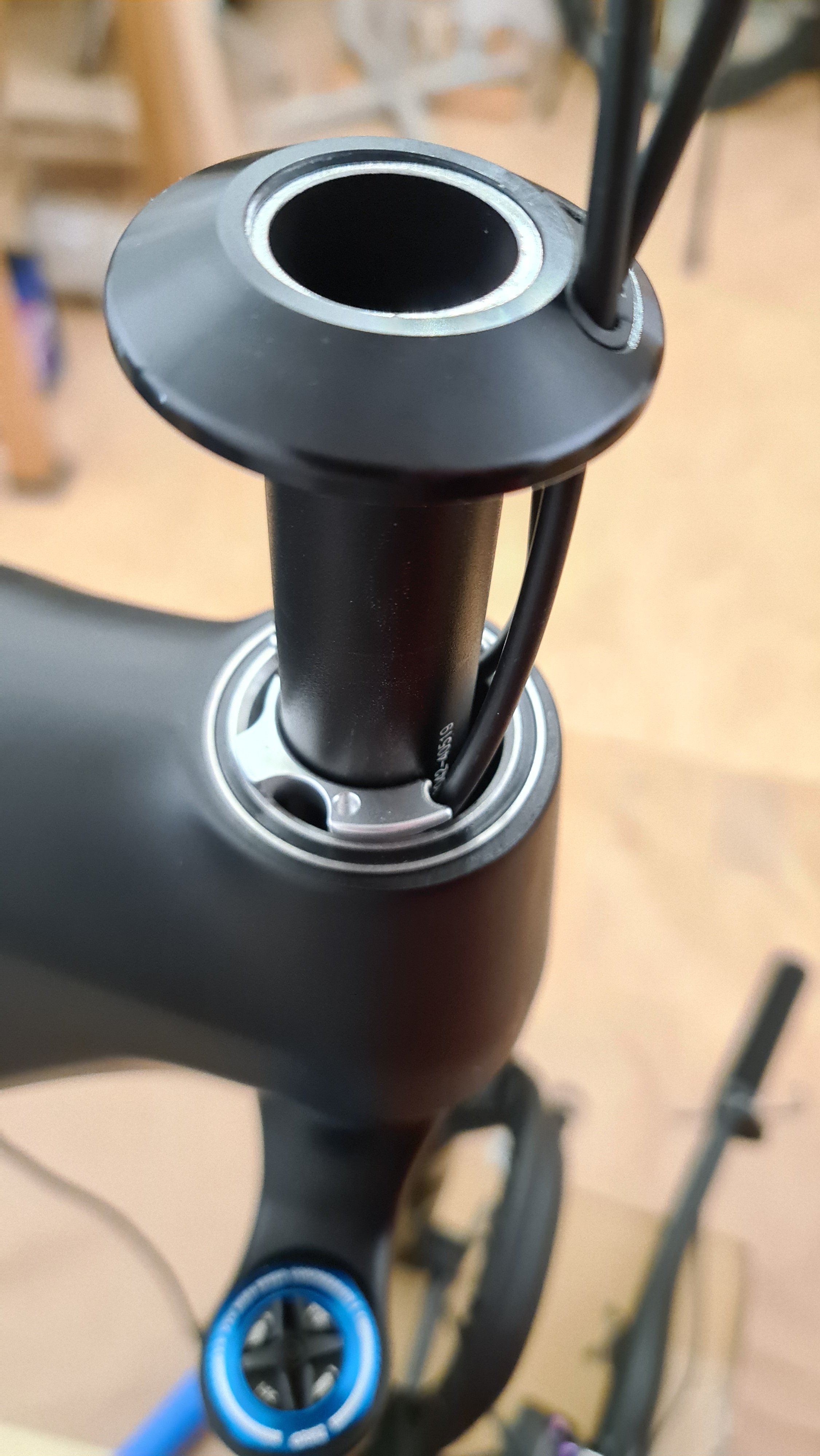

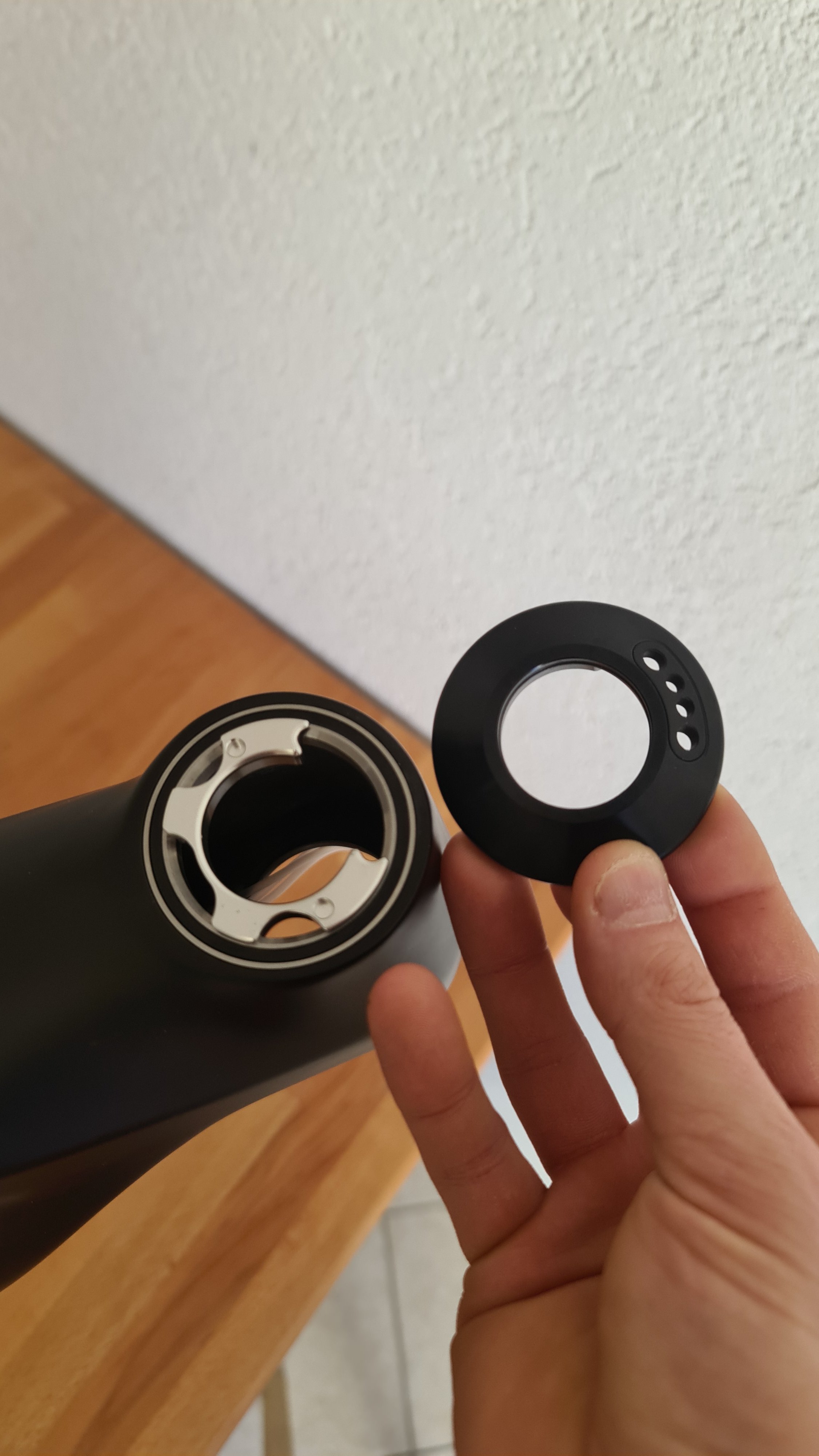

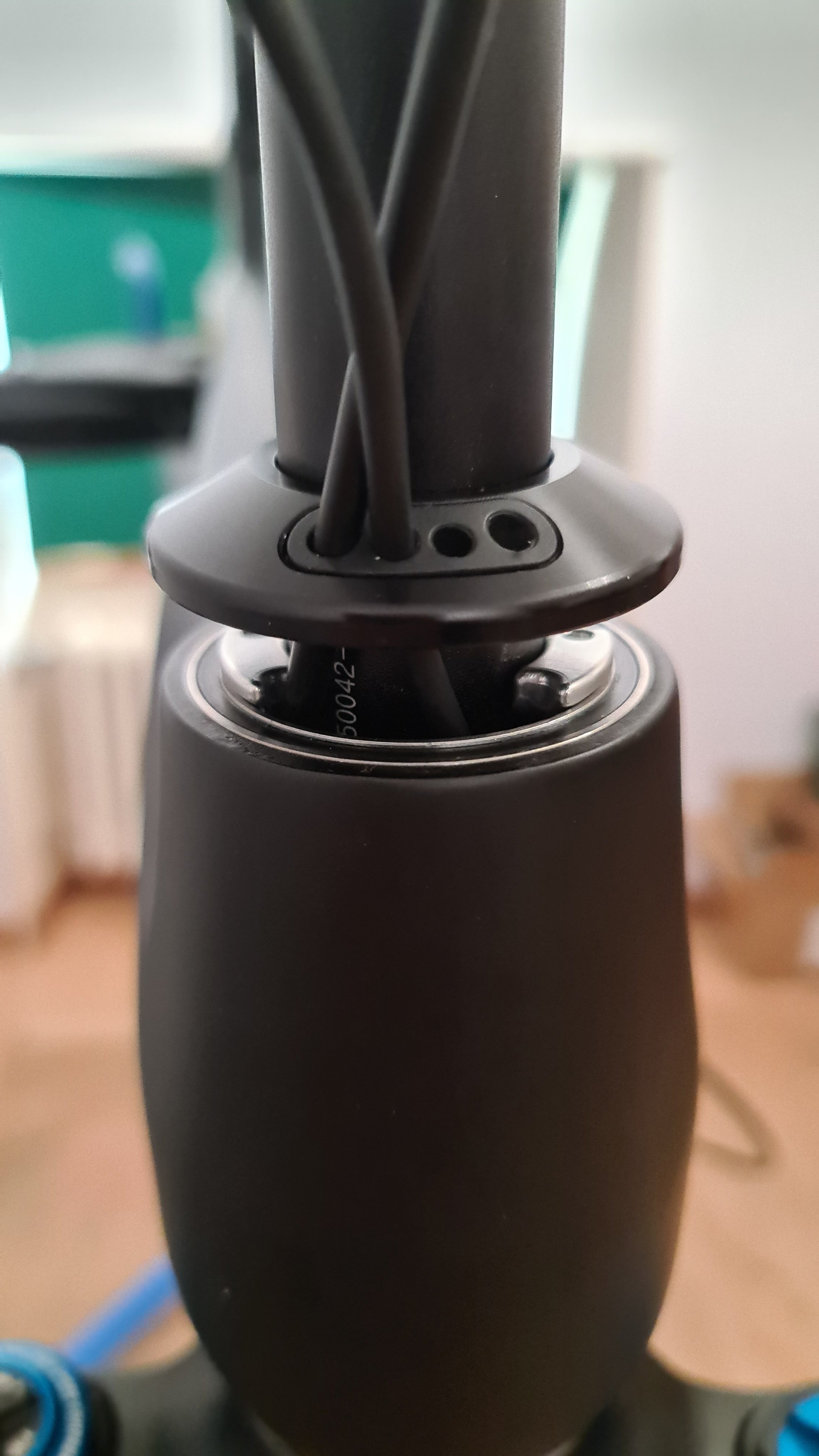

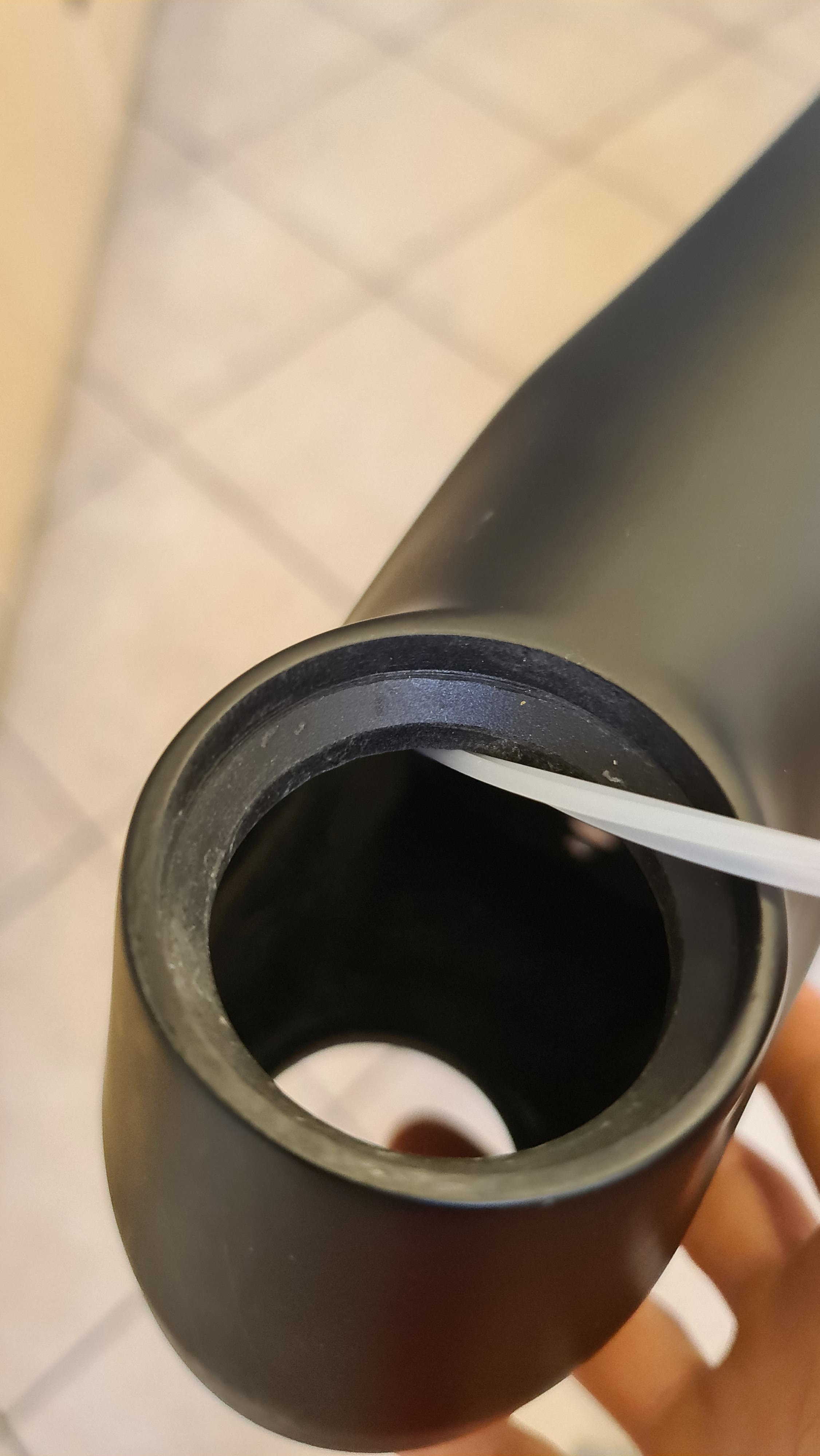

Regarding the head tube, the frame is designed for a mountain bike fork with a tapered tube (I've attached a photo below for better understanding).
Mountain bike fork tubes are always conical to increase rigidity at the "T." If you want to use a straight tube fork, you'll need an adaptation shim to compensate for the missing cone (although I'm unsure if such shims exist).

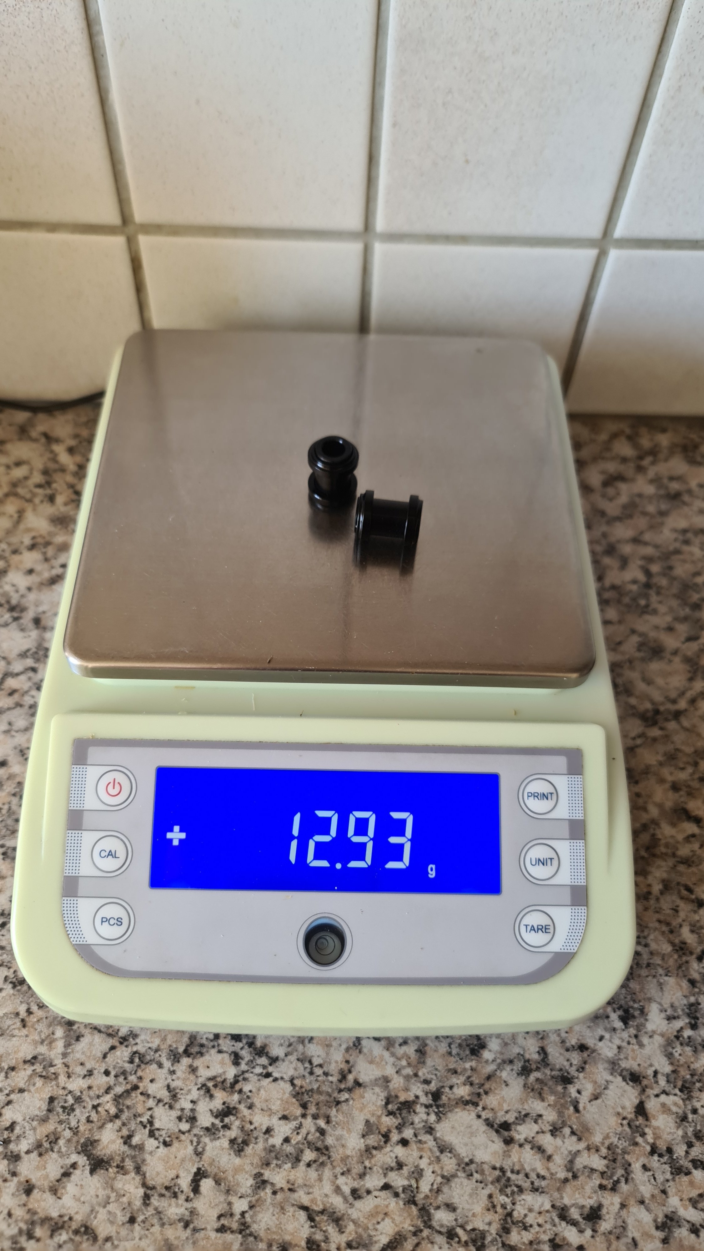

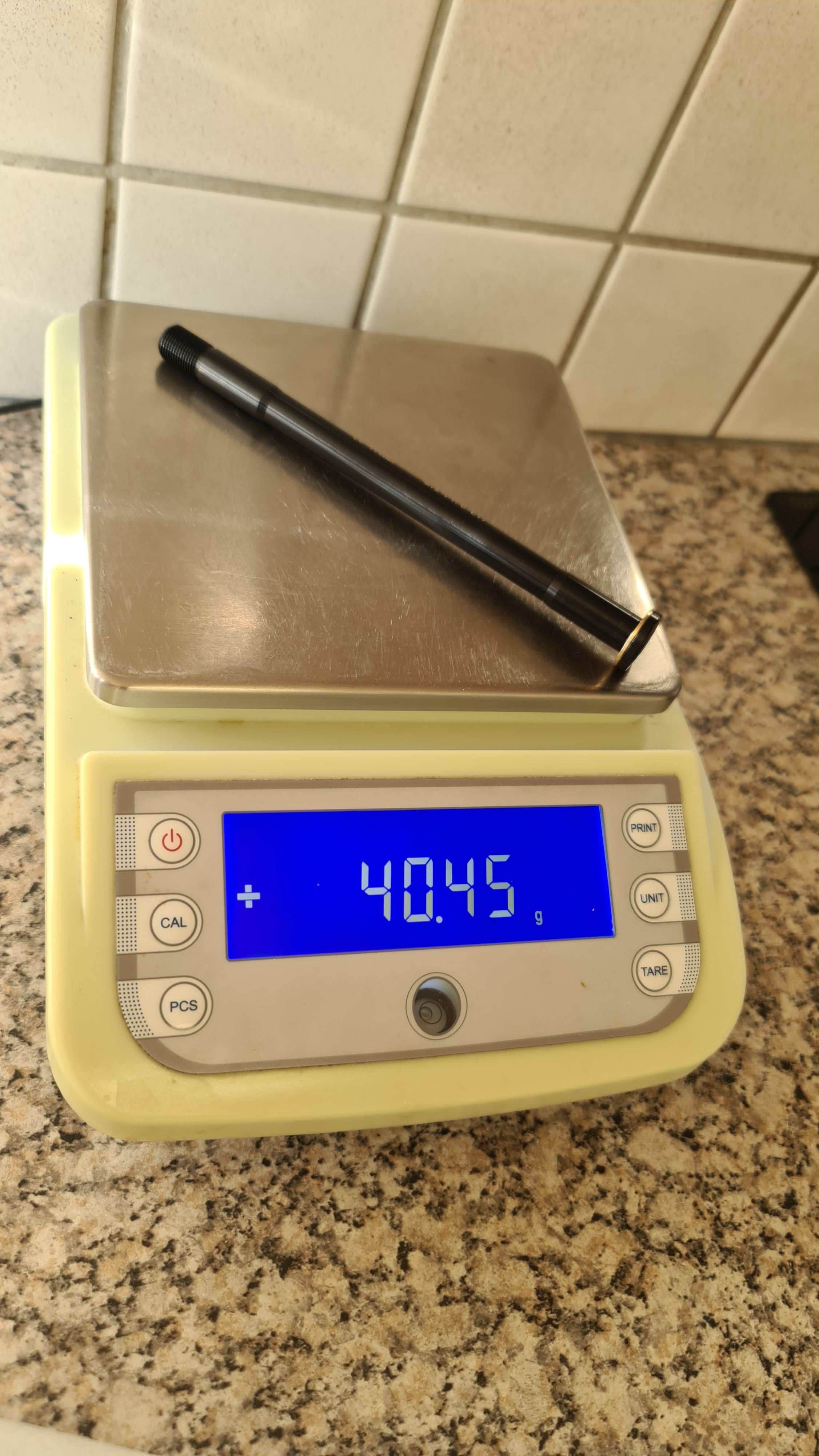

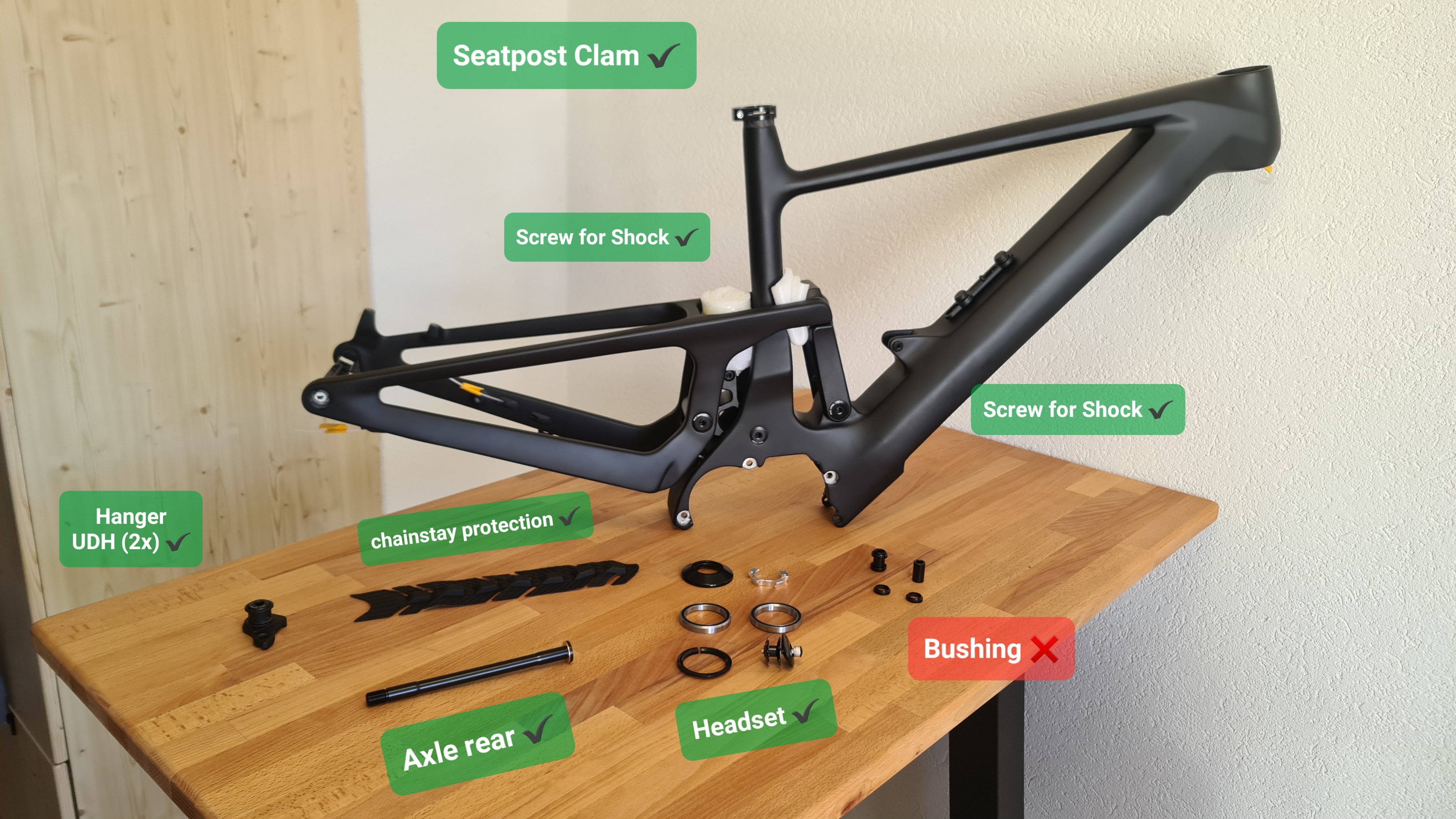

For your information, the frame comes with the rear axle, screws for the rear shock, 2 Sram UDH hangers, and indeed, the headset is included. I've also included a photo below of what's included or not.

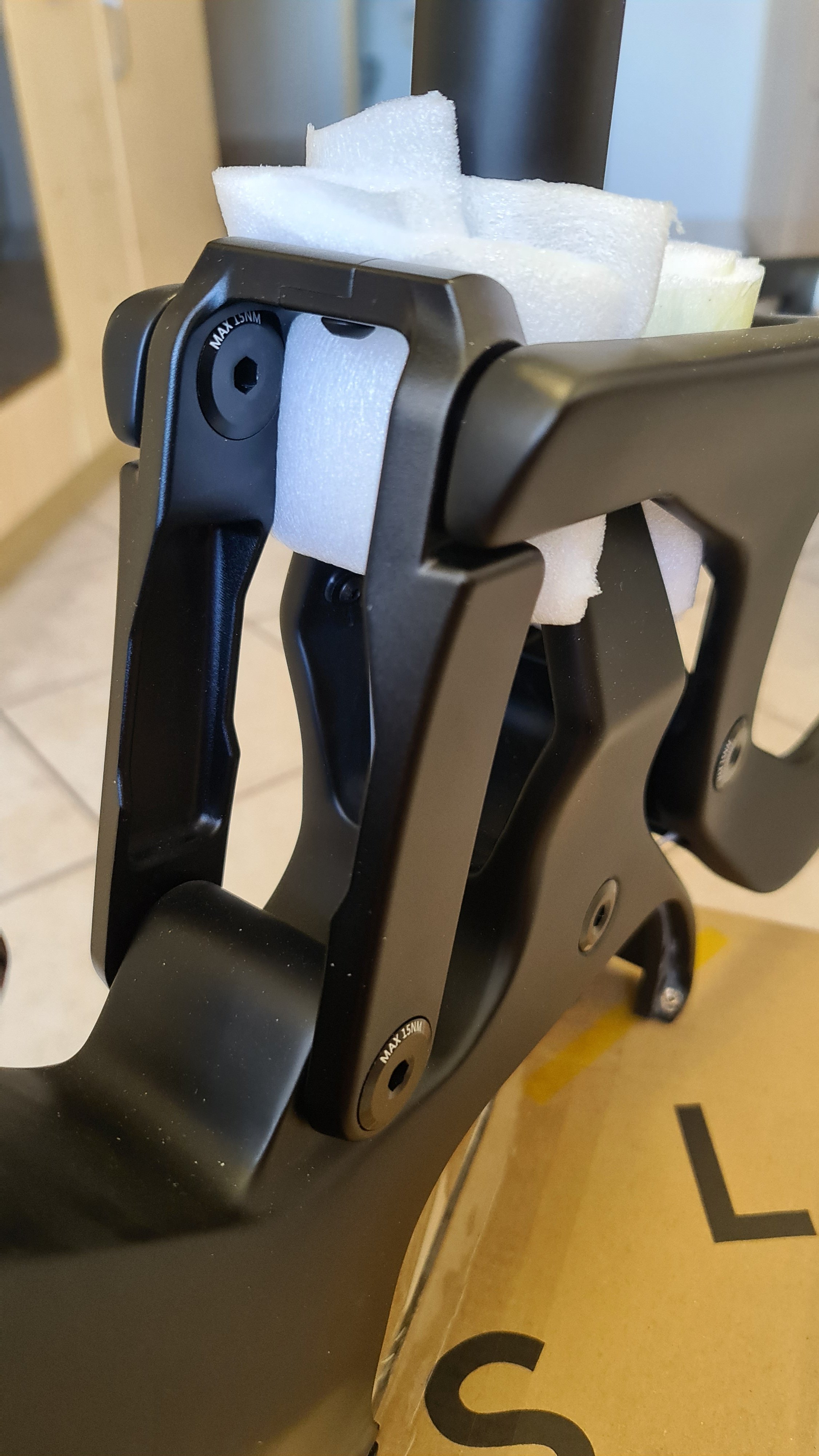

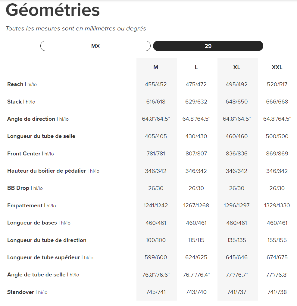

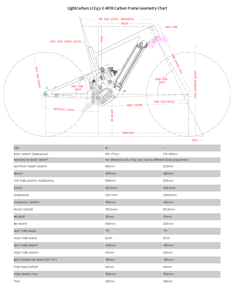

From my research, this frame is midway between a Santa Cruz Heckler and a Scor 4060 Z ST.

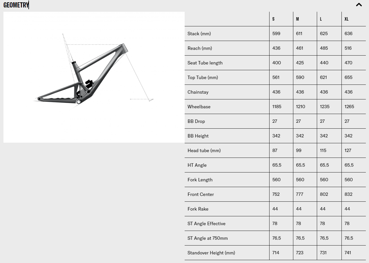

"Lightcarbon" displays diagrams on their website concerning the virtual pivot point, and based on my analysis, everything seems coherent and worthy of major manufacturers.
I haven't finished assembling this bike, so I can't provide a usage experience yet. However, analyzing the "Scor 4060 Z ST," tests unanimously describe the bike as playful due to its short rear base (436mm). If we look at the "Santa Cruz Heckler" tests, it's praised for being well-balanced and very stable. Combining all this information, it seems that the "LightCarbon LCE971" frame physically resembles "Scor" with a geometry close to "Santa Cruz." Therefore, one could naturally expect it to have a good stability with a playful spirit.
Géometry Scro 4060 Z ST.PNGGeometrry Santa Cruz Heckler.PNGGeometry LightCarbon LCE971.PNG
I personally have a strong inclination towards virtual pivot points. Even though this system is heavier than others, I find it helps overcome potential issues such as a too pronounced "kickback."
From all my analyses before choosing this frame, the geometry appears to be an excellent compromise, especially the "Trail", which is also very coherent with its 128mm. Generally, a "Trail" of 130mm is considered an excellent compromise.

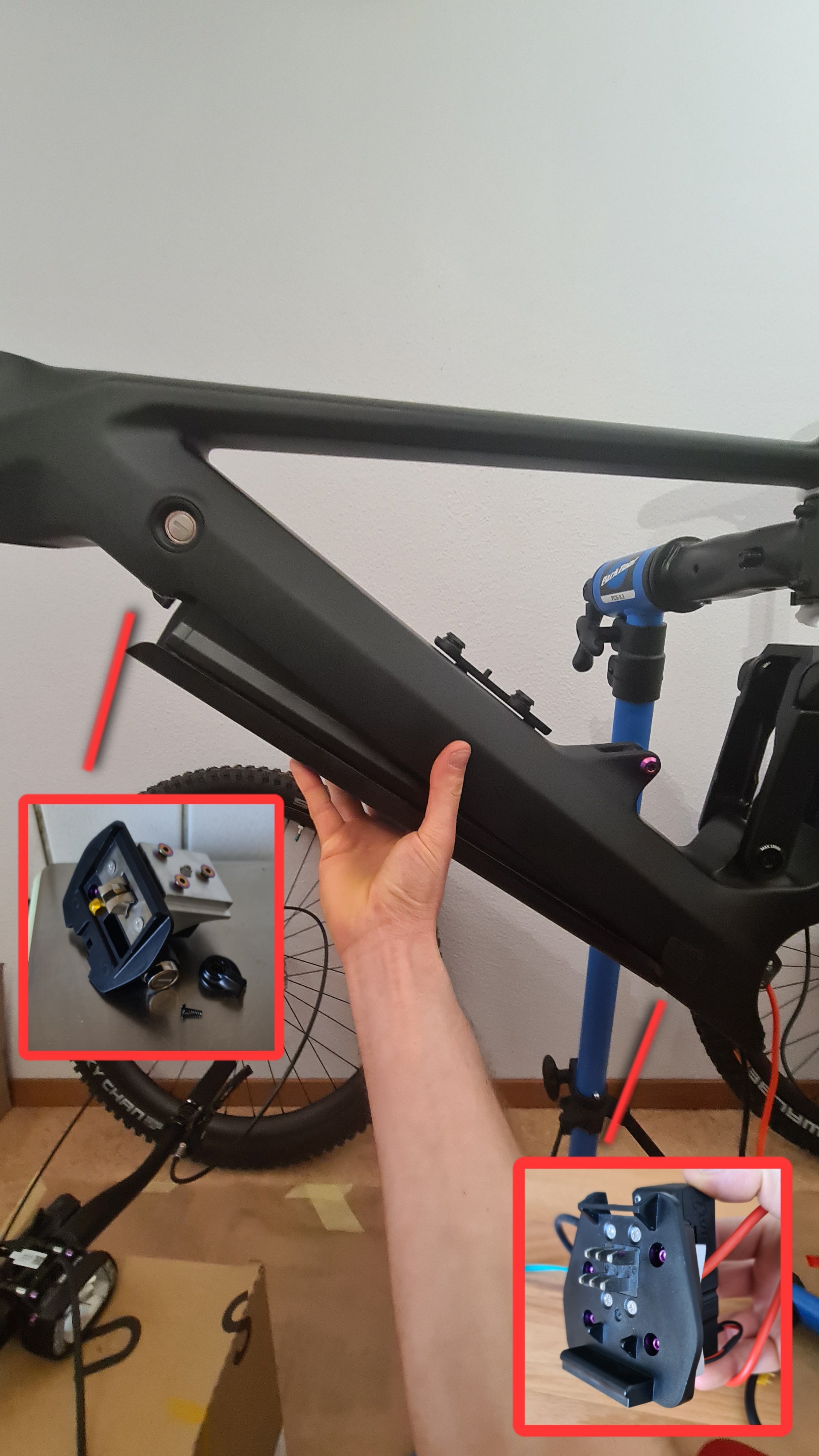

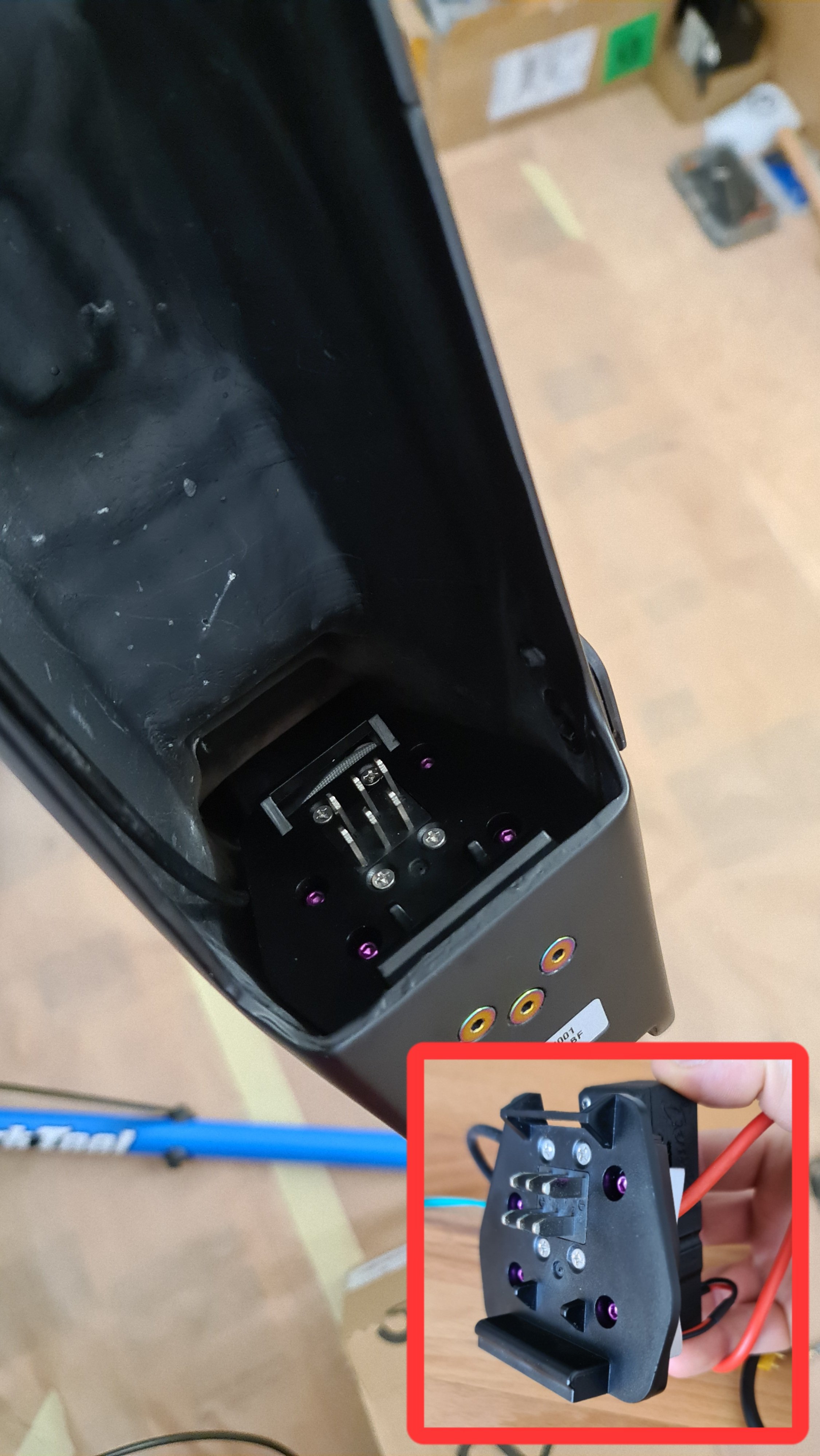

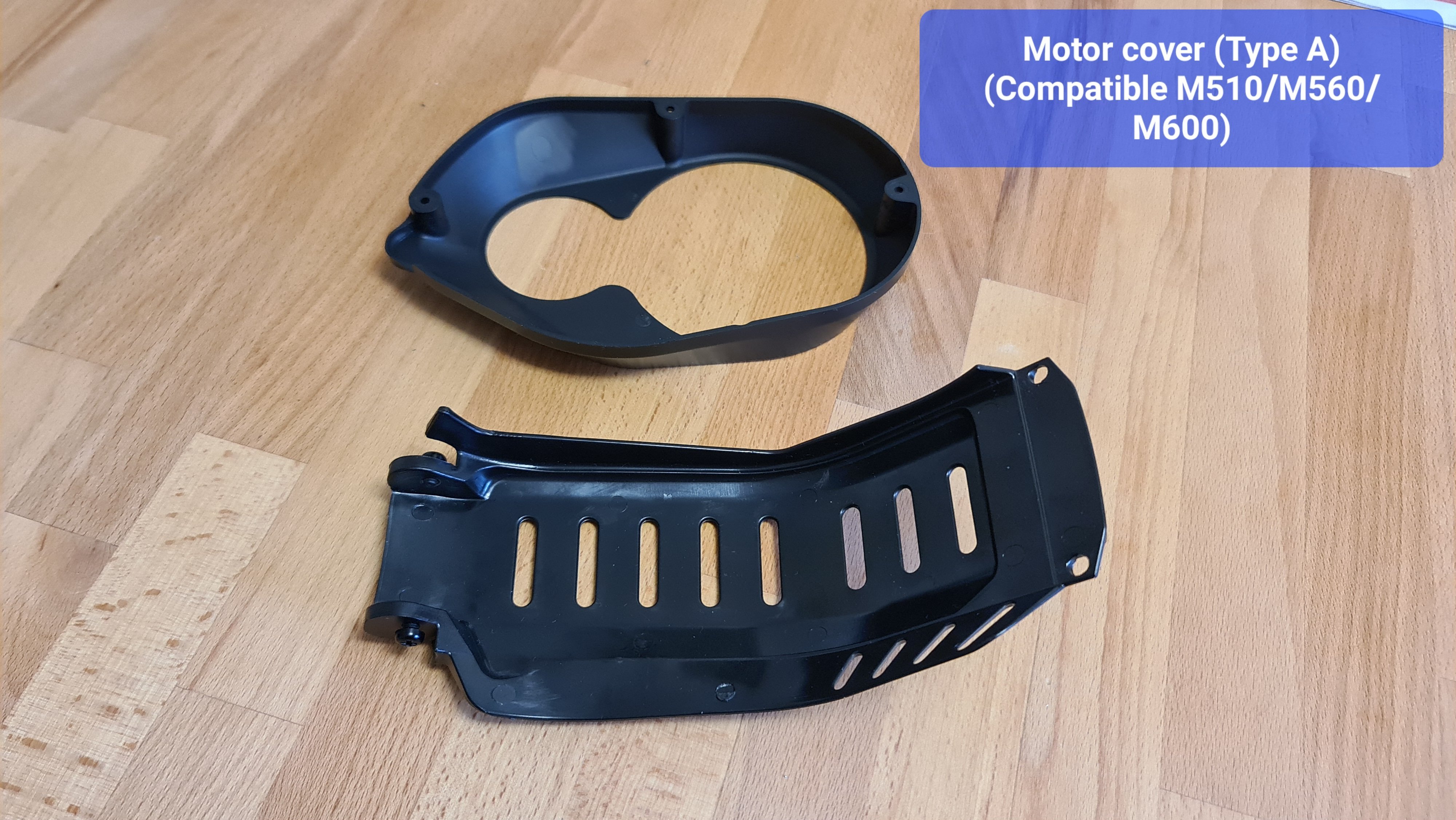

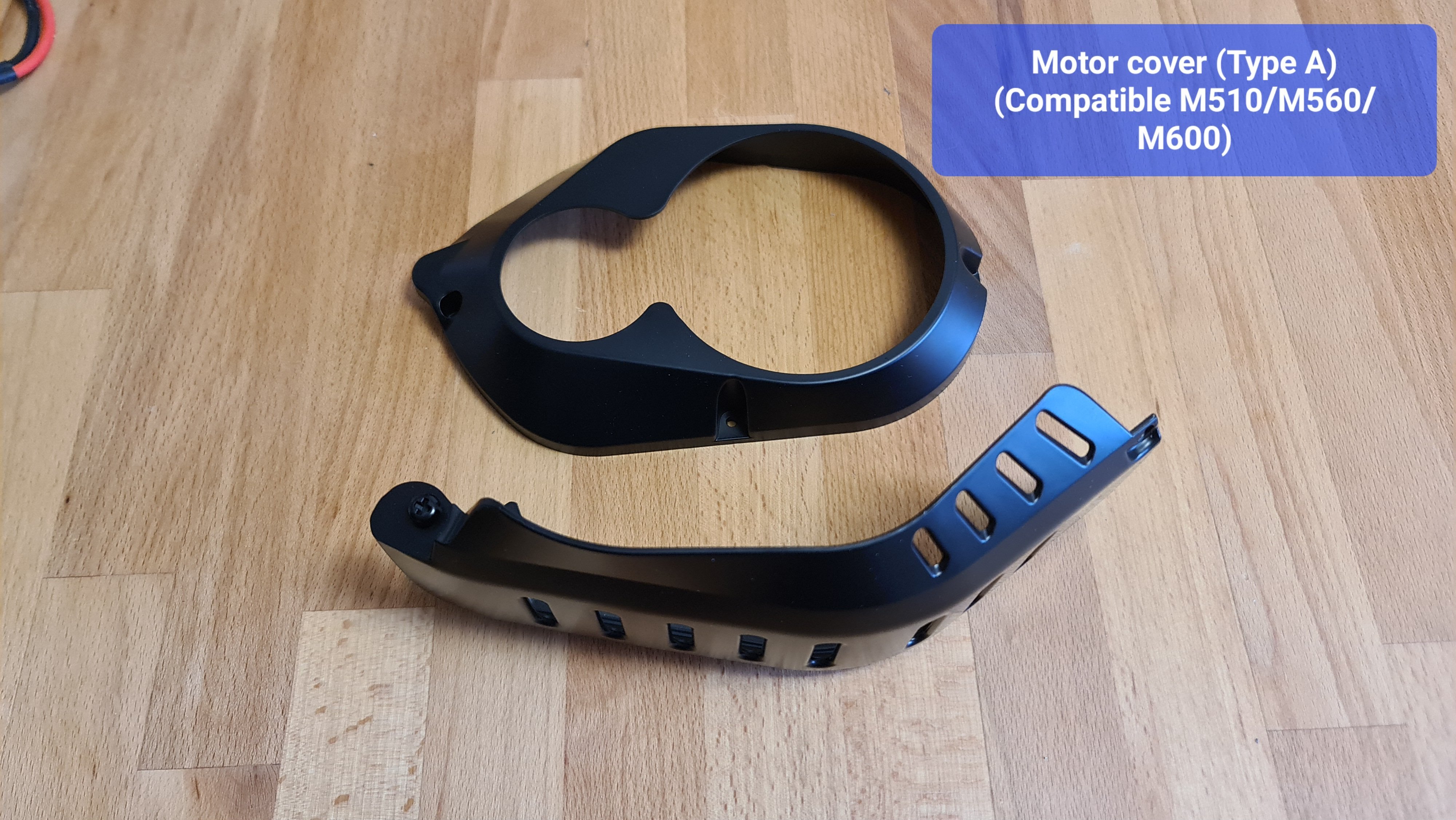

Not included in the frame:
- Motor cover (Type -A)
- Motor (M510/M560/M600)
- Battery (SYR014 model)
- Mount for the battery
Bafang Cover ABS (Type - A) 2.jpgBafang Cover ABS (Type - A).jpgSystem Mount Battery SYR014.jpg

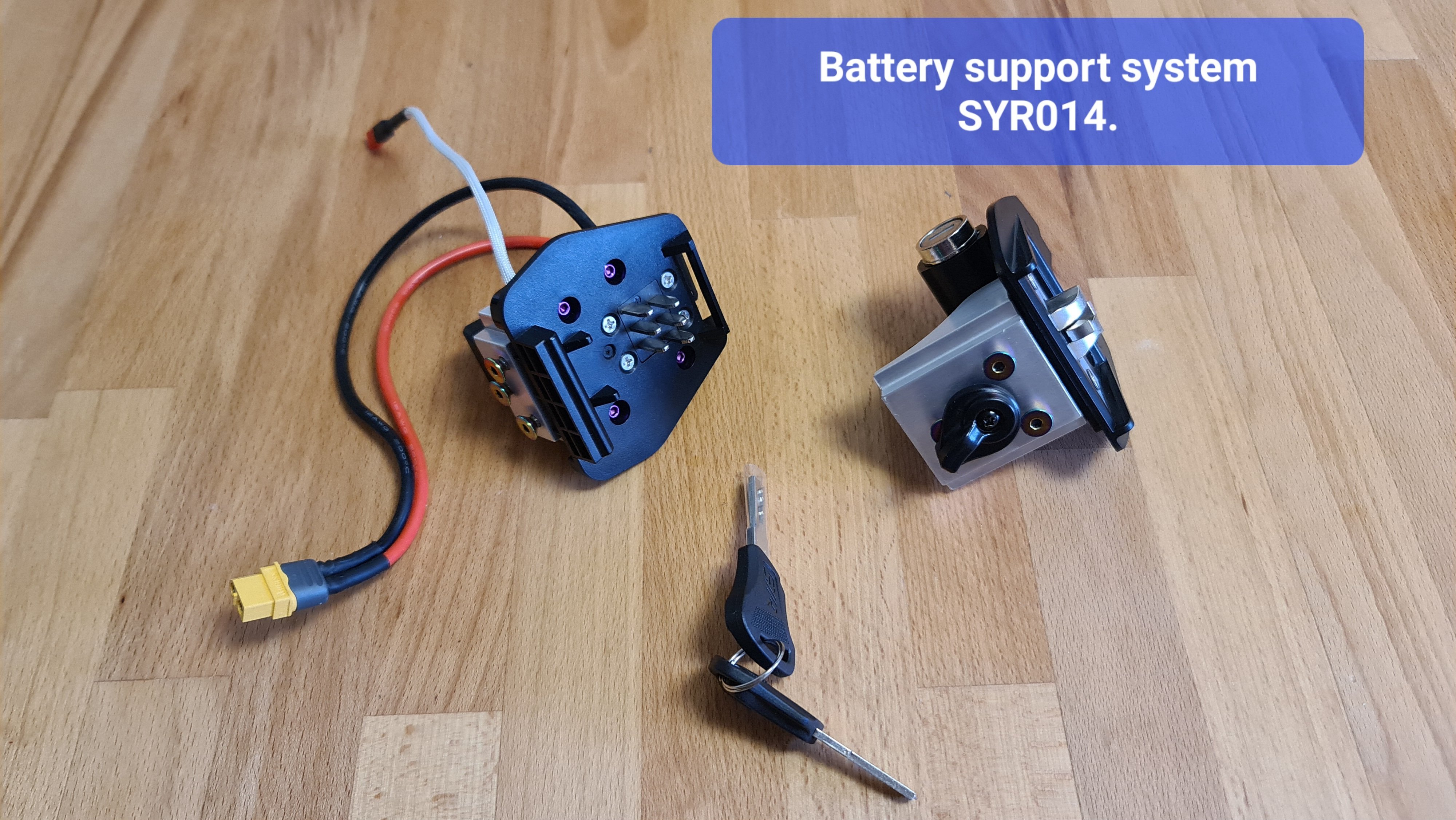

For the battery and support system, I purchased them here :
Shenzhen XiangYang Power Co Ltd St
I've conducted a capacity test, and everything seems consistent. I confidently recommend this supplier, given the attractive pricing.
View attachment 134533View attachment 134534View attachment 134535
From all my analyzes before choosing this frame, the geometry appears to be an excellent compromise, especially the "Trail", which is also very consistent with its 128mm. Generally, a "Trail" of 130mm is considered an excellent compromise.
I hope I've answered your questions clearly; feel free to ask again if needed. (I hope my English is understandable as it's not my native language).
- Engine (M510/M560/M600)
View attachment 134536View attachment 134537View attachment 134538
For the battery and support system, I purchased them here:
For the motor, I've had positive experiences with this store:
SingYiu E-bike Store
I know people who've ordered multiple motors without any issues.
Thank you for extremely informative answer. I'm from Finland so my English isn't the best either haha.
I've been riding my diy full suspension bbs02b 750w for a year now and I'm planning to build my next bike.
Regarding the headtube I was referring to the information straight from the lightcarbon website where it says that the frames headtube is straight 1 1/2". Picture below.
I thought this measurement is what dictates what type and size the forks needs to be. That's why I was so confused about the frame and fork compability when these are the different size forks in bike24.de for example. Picture below.

Thank you very much for your interest in the construction of my bike; it gives me the feeling that I'm not doing this in vain.
Indeed, it can be confusing; "Lightcarbon" should indicate that 1 1/2" is the top part of the head tube, and 1 1/8" is for the bottom part.
So, for this frame, you must choose a fork with a "T": 1 1/8" 1 1/2" Tapered.
Regarding maintenance ease, RockShox is "simpler" in my opinion, with more accessible service manuals, modern colors, and clearer explanations.

If you're wondering why I preferred 150mm, it's because my practice leans more towards "all mountain" than "enduro," and moving to 160mm increases the trail.
- 160mm = More "Trail" = more stability / less maneuverability
- 150mm = Less "Trail" = less stability / more maneuverability
If the 160mm travel doesn't suit me, for a lower cost (70-100 USD), it's easy to change the air shaft and decrease the travel.

As for titanium hardware, I've replaced missing parts for aesthetic reasons and weight savings. Be cautious about titanium types (grade 2, 4, 10) as they have different resistances. Moreover, titanium has lower shear strength than stainless steel, especially concerning the screws that hold the rear shock.
In one of my previous posts, I mentioned that my first bike weighed 31 kg, an experience I'll never repeat. With such weight, it clearly deviates from the essence of mountain biking. The bike lacks playfulness, that "Poppy" feel, not to mention its almost non-existent maneuverability. In simple terms, it's a bike suitable for descending in a straight line. However, it's crucial to be honest; the "Frey" has a very peculiar (to put it mildly) geometry, and unfortunately, it's a brand I wouldn't recommend.
As for the converter, it's a voltage converter (48v to 8.4v). I'm installing a Lupine AX light that operates at 7.2v nominal. To avoid an additional battery at the correct voltage, I added this small component to draw power from the main battery. (I'll discuss this in my next post).
When I mention complete locking, it corresponds to the system securing the battery to the frame (not included with the frame).
I'm not sure if it's a typo on your part, but I have a Bafang M510.
When I purchased my motor, I got a complete set (motor, cranks, cables, covers, DCP245). To get the DCP245, I contacted "SingYui E-bike Store" to inquire about replacing it with the DCP240.

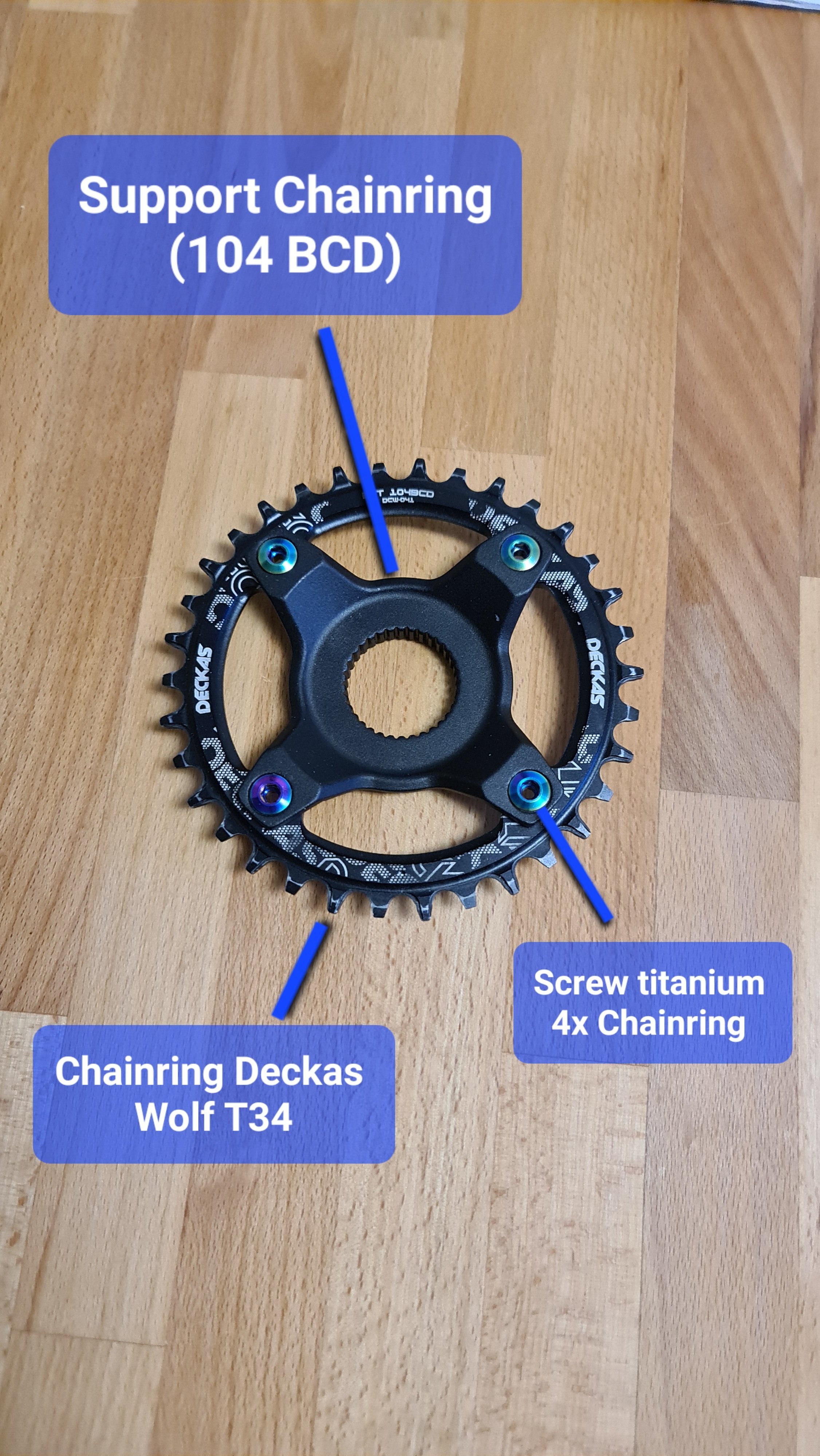

The "support chainring" is this :

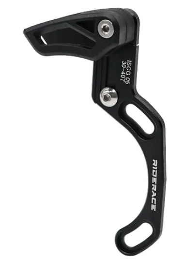

The Ztto chain guide is in my Excel spreadsheet, but don't buy it; it's not compatible.
Edit 06.05.2024 : The chain guide is indeed compatible with Bafang M510, M560, M600 motors; however, you must be careful to select the correct "Spider" because only two models are compatible (CW G522.1A and CW G522.1B) (I'll discuss this more precisely in the next post) so that you can attach a chain guide. The key is that the chain guide is in the "ISCG-05" format. However, be cautious as some "ISCG-05" format chain guides may be too offset to the right or left. Some have compensating shims, while others do not (see my upcoming posts for more details).
You can attach it to the motor (ISCG-05 = ok), but the support plate rubs against it. If you want one, I think you should do what I did and make a custom one because I haven't found a compatible model on the market.
The chain guide I chose is not the same as yours, so I don't know if yours is compatible.

Indeed, it can be confusing; "Lightcarbon" should indicate that 1 1/2" is the bottom part of the head tube, and 1 1/8" is for the top part.
View attachment 134574View attachment 134576View attachment 134577
I chose the DCP245 for its compact and colorful screen. It's, in my opinion, a good compromise between a small size and maximum available information (especially pedal cadence). Its placement on the handlebar also provides better protection against falls compared to a screen fixed on top of the handlebar near the stem.

Ah yes, thank you. I think that's what they call "spider" as in support chain ring.

For the continuation, as I mentioned earlier, we will talk about the wheels from LightCarbon.
View attachment 133430In choosing the wheel type, I hesitated between two models for a long time...
View attachment 133437View attachment 133436View attachment 133438
View attachment 133439View attachment 133440View attachment 133441

And what about the spokes ? Of course !
I believe you've understood that I enjoy pushing the reflection quite far.
Regarding the spokes, I've questioned whether there are counterfeit Sapim spokes.
Attention, I'm not suggesting that LightCarbon uses counterfeits !)
I own "HOPE" Fortus 30 Pro 4 wheels with Sapim Race spokes, and the LightCarbon wheels are also equipped with Sapim Race spokes ! Comparing the two, we notice that the letter stamping is very similar, but the spokes from "LightCarbon" display a "T," while the "HOPE" wheels show what seems to be a number "6." But it doesn't end there;
View attachment 133462View attachment 133463
I wanted to push the reflection even further. Currently, I'm developing my own spoke tension meter and calibration bench. Naturally, I have various types of spokes.
Most of my spokes are ordered from Bike24, and I also have some Sapim spokes from an official distributor! Upon comparisons, it seems challenging to determine whether a spoke is official or not. However, there is one spoke from Bike24 that exhibits a significant flaw (see photos). I can hardly imagine "HOPE" using counterfeit spokes, and consequently, I also believe that "LightCarbon" uses genuine ones. To conclude on the spokes, I would have loved to take the tension of each spoke and provide a detailed report on it. However, my tension meter is not yet completed, so I can't check that aspect yet.
View attachment 133469 View attachment 133471 View attachment 133472View attachment 133473
As for the rim tape, prefer a 32mm width over 30mm, allowing you to cover the entire surface. Regarding tire installation, I managed to mount them without any tools, and I even succeeded in seating the tire sidewalls using a mini pump. For me, it's well-sized, demonstrating that in case of difficulty during a ride, there won't be an issue putting back a sidewall that has come loose. As for air tightness, my tires have been mounted for a week, and I haven't experienced any leaks.
View attachment 133488 View attachment 133485
But then, in the end, do I recommend these rims? If we don't consider the fact that I haven't tried them yet and I don't have durability feedback, I would say: Yes!
View attachment 133486View attachment 133487View attachment 133478View attachment 133479View attachment 133490View attachment 133491View attachment 133492View attachment 133489View attachment 133476View attachment 133477View attachment 133481View attachment 133482View attachment 133483View attachment 133484

Previously, I was asked why I hadn't finished assembling my bike yet. I replied that the next "post" would be there to answer this more precisely. And that's what I'm going to do, starting with the headset.
As you can see below, the photo shows the headset installed in the frame. Everything fits together correctly, there is no play, it's well designed and well manufactured.
However, I have a few small criticisms to make about this headset kit. Firstly, the guide ring isn't angled enough. If you want to preserve your cables as best as possible, I advise applying a file to break this angle.
Additionally, and this is a poor choice by LightCarbon because unfortunately the cable of the DCP245
doesn't fit through the hole. So you have two solutions ; either cut the plastic to reduce the thickness of the connector (as I did) or cut the cable and resolder the copper wires...
I can also tell you that the rubber grommet won't be very durable because it's too flexible...
But then why do we have this type of headset ?
Simply "Current trends" dictate that this type of headset is found on our mountain bikes because, let's remember, it originated from road bikes. It has the advantage of providing a cable management that is the most streamlined and discreet and moreover, attractive. You can judge for yourself the difference between my LightCarbon LCE971 and My Frey AM1000 EX :
But we have the possibility to counter this problem, and that's where 3D printing comes in handy. I took the trouble to completely model the headset and thus create a TPU seal to act as a barrier against potential dirt that could infiltrate.
TPU has the advantage of being very resistant and flexible. I took care to design the seal with 2 lips that come into contact with the outer cage of the bearing.
The seal only comes into contact with the metal part of the bearing to avoid rubbing against the frame and prematurely wearing the paint.

And now we move on to the rear end of the bike.
Here we can see the same problem as with the headset. There are openings for cable routing; the derailleur cable, the rear brake hose, and the speed sensor cable.
We can also note that LightCarbon could have aligned the holes.
Here too, it's an open invitation for dirt to embed itself in the rear end and around the motor.
Personally, I can't see myself cleaning the inside of the rear triangle because it's filled with dirt and water or constantly disassembling my motor from the frame to clean it properly. It should be noted that carbon is known to be abrasive, so it's not a good idea for cables to rub against the frame.
To address this problem, TPU grommets were modeled and printed to seal these holes as best as possible and thus limit the accumulation of dirt while minimizing cable friction as much as possible.

It would have been wise to make a small hole at the bottom of the rear triangle to have a drain in case water entered inside. I don't know if LightCarbon didn't do it for reasons of rigidity and strength or simply because they may not have thought about it.
The best compromise would have been a guided internal cable routing.

Now let's move on to the virtual pivot point.
Personally, I love this kinematic, I find it super aesthetic but like a Santa Cruz or a Scor, these kinematics have a small flaw.
The top part of the photo shows the frame linkage and the bottom part shows exactly what it reminds me of (yes literally a rock crusher).
The amalgam may be a bit exaggerated and I don't know what the odds are of a rock getting lodged in this spot, but one thing is for sure, the day it happens and the rock remains stuck between the frame and the linkage, I don't give much for your frame...
In this video (sorry it's in French) Youtube: "ButterCream Suspension" (Video 4:03min) explains that there is always dirt that gets lodged around the linkage for both Santa Cruz and Scor.
And what can we deduce from all this ?
Well, simply that it's not an isolated issue with LightCarbon, but rather a constraint inherent to this type of geometry.
To draw a parallel with Santa Cruz, we can see that they have made a small plastic tab to limit the projection of foreign bodies through the wheel.
Even though from my point of view this is not enough, I think that for this part, LightCarbon could have defined two small threaded inserts at this point to be able to attach a guard and thus limit this potential problem.
Maybe some of you won't see much use in protecting this part of the frame and even having some, they like to combine botany and mountain biking...
So I racked my brains trying to find a solution and honestly it's not easy. The best would be to drill the aluminum linkage and make threads. However, it requires equipment and skills. Personally, I have the skills but maybe you don't. So I opted for the non-drilling alternative. So there is a part to be glued to the frame to cancel out the friction and not wear the paint while the other part is attached with a quick-release clamp to the aluminum linkage.
Here's a little video that supports my remarks.

And finally, the cable routing system at the battery level.
As shown in the photo below, LightCarbon did not provide cable routing guides and that's a real shame... It should be noted that when you have cable routing through the stem, the additional length of the cables (for when you turn the handlebars) is no longer outside the bike but inside the frame. As shown in the photo below, this has the effect of having cables that are stretched and therefore, it's difficult to keep the cables pressed against the frame.
During my first tests (without guidance), I realized that this was problematic and tedious if you want to often remove and then reinstall the battery. It's tedious to always be careful that the cables are not sandwiched between the battery and the frame. During my tests, I sometimes pinched the brake hose and I can tell you that it came out in a bad state.
So to address this problem I made a modeling in ABS which has two adhesive fasteners and which attaches to the threaded tubes used to attach a bottle cage to the frame.
I took the opportunity to push the reflection a little further and to integrate a compartment to accommodate an air tag.
This can be very useful in case of theft of your bike.
Of the four necessary screws 2 are to hold the support and the other two are to fix the airtag. So it will be very easy to change the battery when it is used up.
Of course, my support is purple in color, however with a black support and black screws, the location of the airtag is practically invisible. Moreover, in case of theft it will be difficult to reach because it will first be necessary to break the lock to remove the battery.

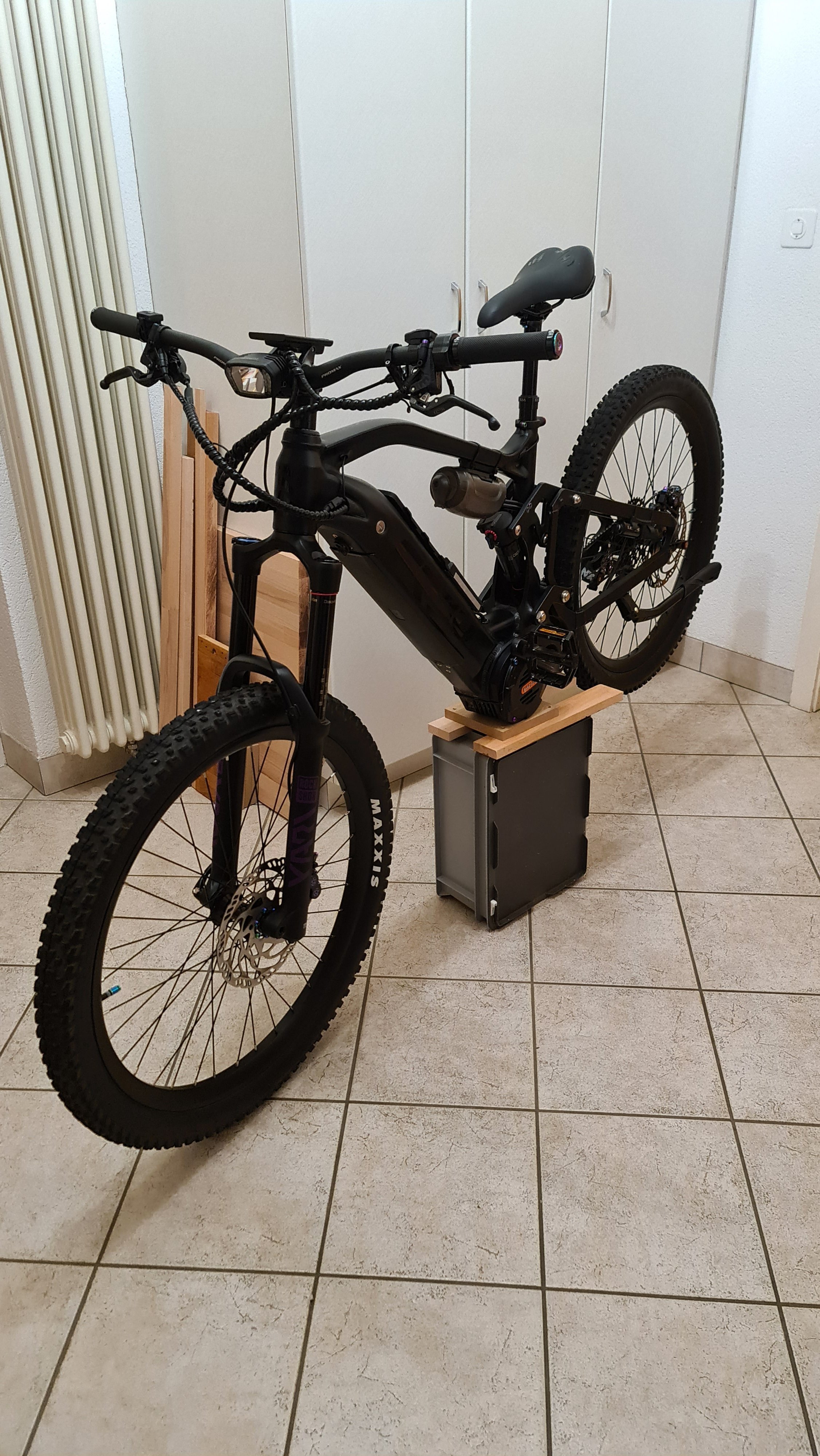

It should be noted that I have already finished assembling my bike. I have already accumulated 150 km with the bike and I will soon give you feedback on its behavior. But before that, we'll talk about the battery (model SYR014) ...

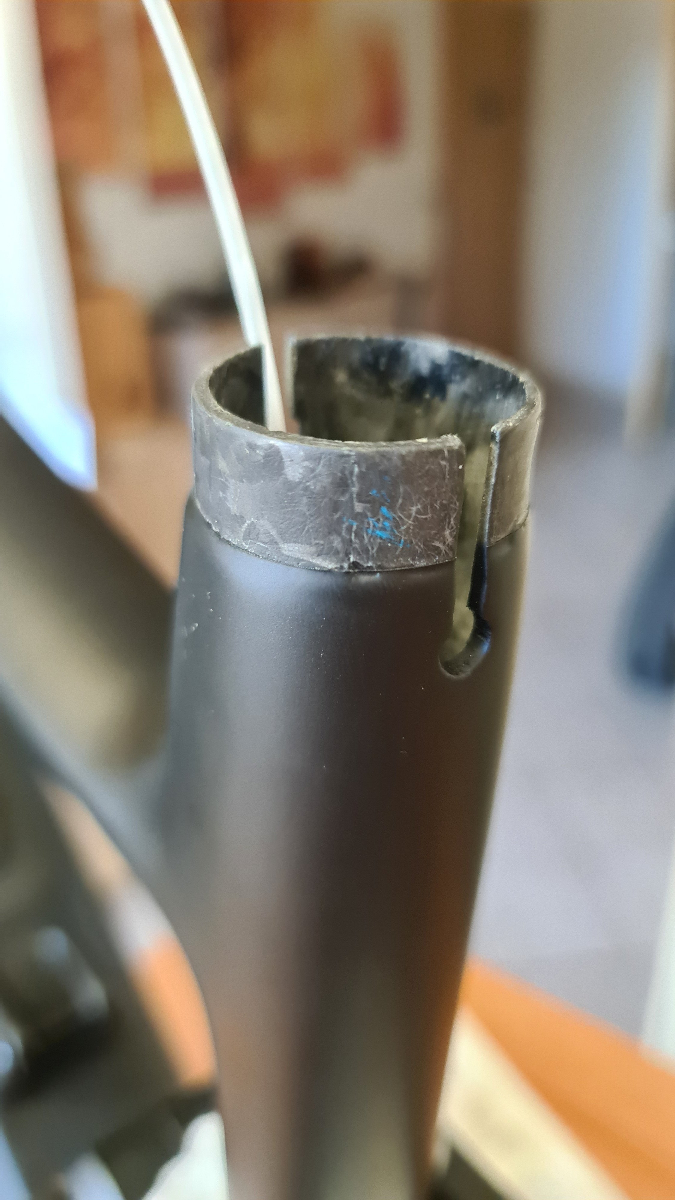

Regarding cable routing ;
I see on this thread :
The headset clearance is worse than mine, it chews up the cables, and it is far from waterproof...
I noticed a slight issue with the speed sensor.
For internal cable routing, no photos show the routing (for me, I didn't find anything). And so far, no one has delivered a verdict on this E82 like I'm doing for my LCE971. So I'm not saying that an LCE971 is better but just to be cautious until we have it in our hands...
I wish you good luck in attaching a bottle cage to this frame as there is hardly any space. The same mistake as the Frey Dopamine V2...

Yeah the headset cableling is terrible on the E82 but apparently they are trying to fix it with better headset. However my plan is to have them drill holes near the headset for the cables and from what I have spoken with Ben from Dengfu they are able to do it in the factory so I will keep the warranty.

My bike 23kg
Difference between LCE971 and E82 frame +500g?
Motor +400g
Battery +800g
FOX 38 +300g
Float X2 +200g
DH tire + 700g
Panzer + 220g
Sealant + 200g
Total: 26.3kg
And for this weight, it's still concerning my bike, which has been optimized for weight, with all titanium screws, lightweight axles, custom cables, titanium saddle, carbon wheels, carbon handlebars... That's why I said around 28 kg.
As for routing cables through the headset, if it's done properly by the person doing the assembly, it's very neat and functional. I saw someone on the threads

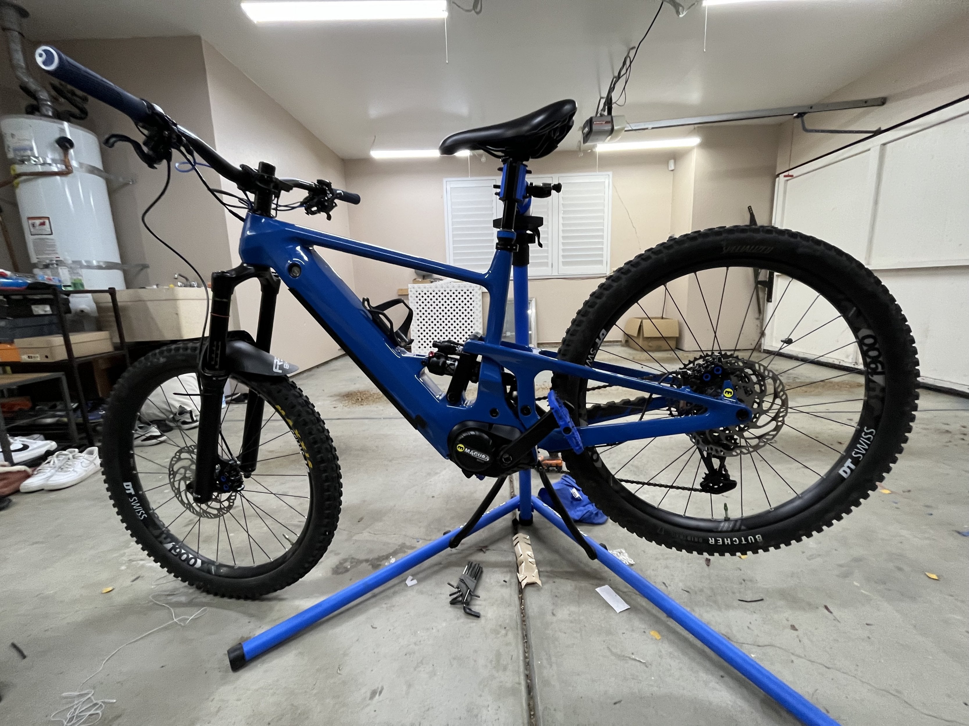

That’s great work. Thank you. Mine painted blue. 😅
