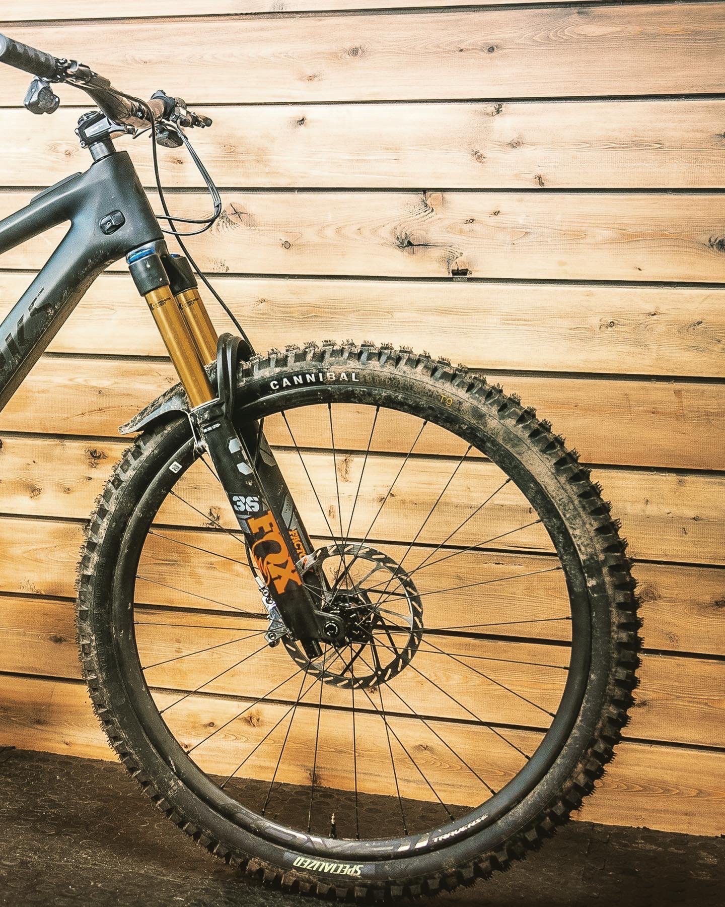

I've been running Cannibals for about a year. Front and rear. Right now it’s my favourite tyre on the market.
Tested in Triscombe / Quantock Hills / Minehead / Surrey Hills. Mix of steep rocky and rooty chutes, rooty ruts, and flowy singletrack and fast loose rocky descents.
A very competent, dry to mixed condition all rounder for fast emtb riding.
PSI used: 25 rear (1.72 bar) / 23 front (1.6 bar). Rider weight approx 82KG
Pros:
  • Soft, damped feel. Very high levels predictable grip when cornering. Soft T9 compound which is comparable to MaxxGrip.
  • Deep Tread pattern with a nice transition from centre to outside blocks - feels slightly different to Assegai, more like a DHF.
  • Carcass is quite strong (but not perfect, see cons). There's very little cornering folding when run approx 23f 25r, but can also run as low as 20f 23rr.
  • Slow rebounding rubber provides plush damped feel. Great over constant rock and chunk.
  • When ridden hard the tyre is supportive (to a point) whilst the soft rubber compound provides high levels of grip
  • Run on the rear for massive braking and climbing traction. Much more than a 2.4 DHR
  • even at 2.3" its bigger than Maxxis 2.4" and more like a 2.5" (id say its ever so slightly wider than assegai 2.5")
  • Excels at cornering ,with supporting carcass, soft rubber compound and round profile on 30mm rims
  • Weight of approx 1360g, in line with most decent DH tyres.
  • Pricing is amazing. £50 in UK and Specialized website regularly offers 10% off.
  • Rolls surprisingly well for this type of tyre
Cons:
  • Not a long lasting tyre, especially on the rear. Rubber wears quick. Have slashed 2 sidewalls on rocks. But, they’re a soft race tyre tyre wear so longevity isn’t it’s goal.
  • High speed square edge hits can deform the tyre and lead to rim dings, unless run at higher pressures (I had some around 25psi on the rear). This obviously happens to many tyres, but I havent had many at all on other 1.4KG DH tyres (like the Michelins for example)
  • Some may not like the 1360g weight.
Overall:
  • Cornering Grip: 10/10
  • Braking Grip: 9/10
  • Climbing Grip 9/10
  • Dampening: 10/10
  • Wet weather: 8/10
  • Carcass Strength 8/10
  • Longevity: 5/10
  • Price: 9/10
  • Overall 9/10

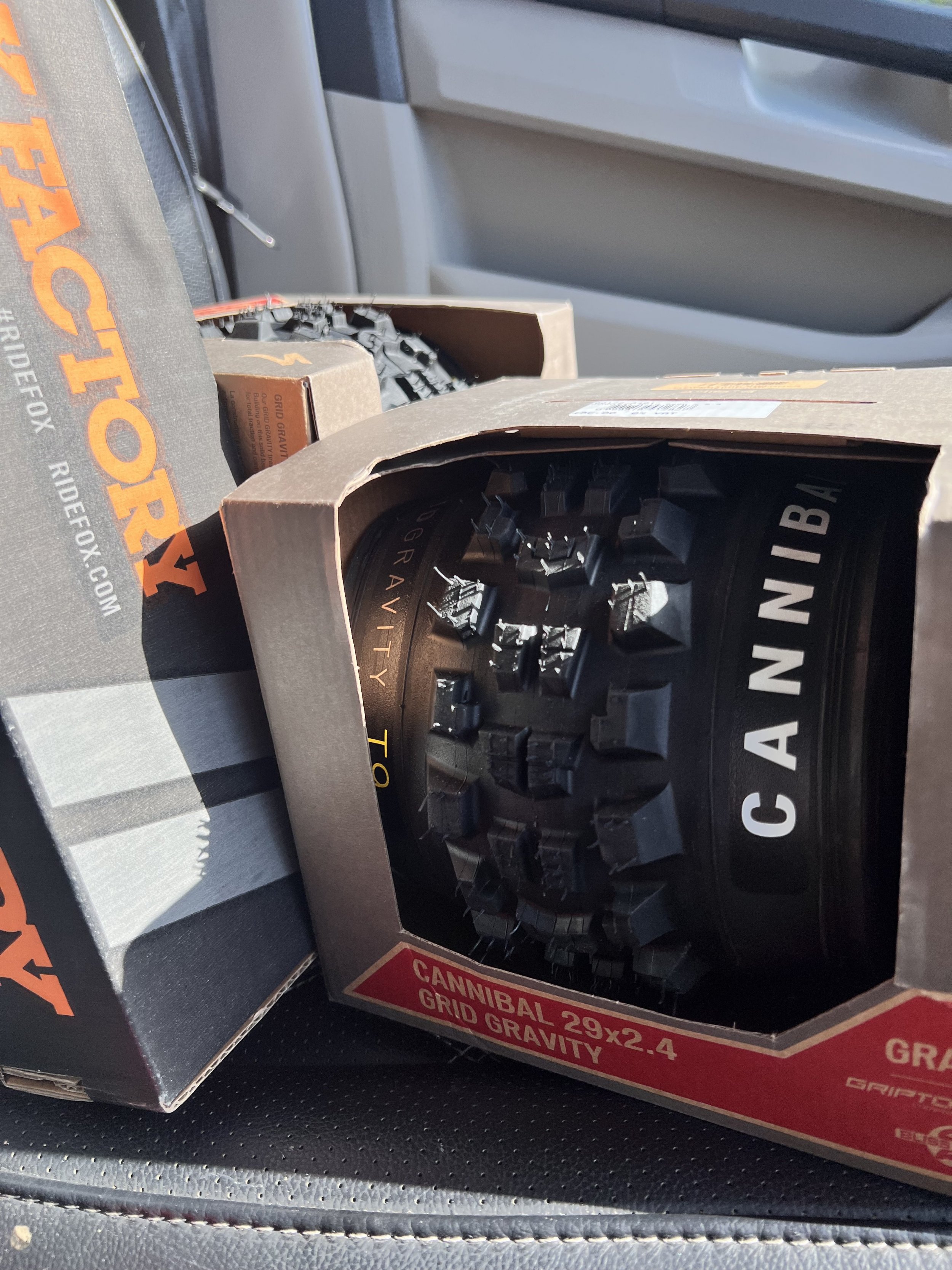

I've recently bought a Cannibal Grid Gravity T9 27.5/650B x 2.4 for my Status 160 acoustic bike and really appreciated it at Dyfi bike park this weekend so might think of sticking one on my Gen 1 Kenevo next time I need a tyre (y)
I have rode some more with Cannibal now. There is no full 10 tyre( it’s not possible), but i give Cannibal 9,99 points. 😁 As a front tyre.
There must be some weak point, but i haven’t found it yet.

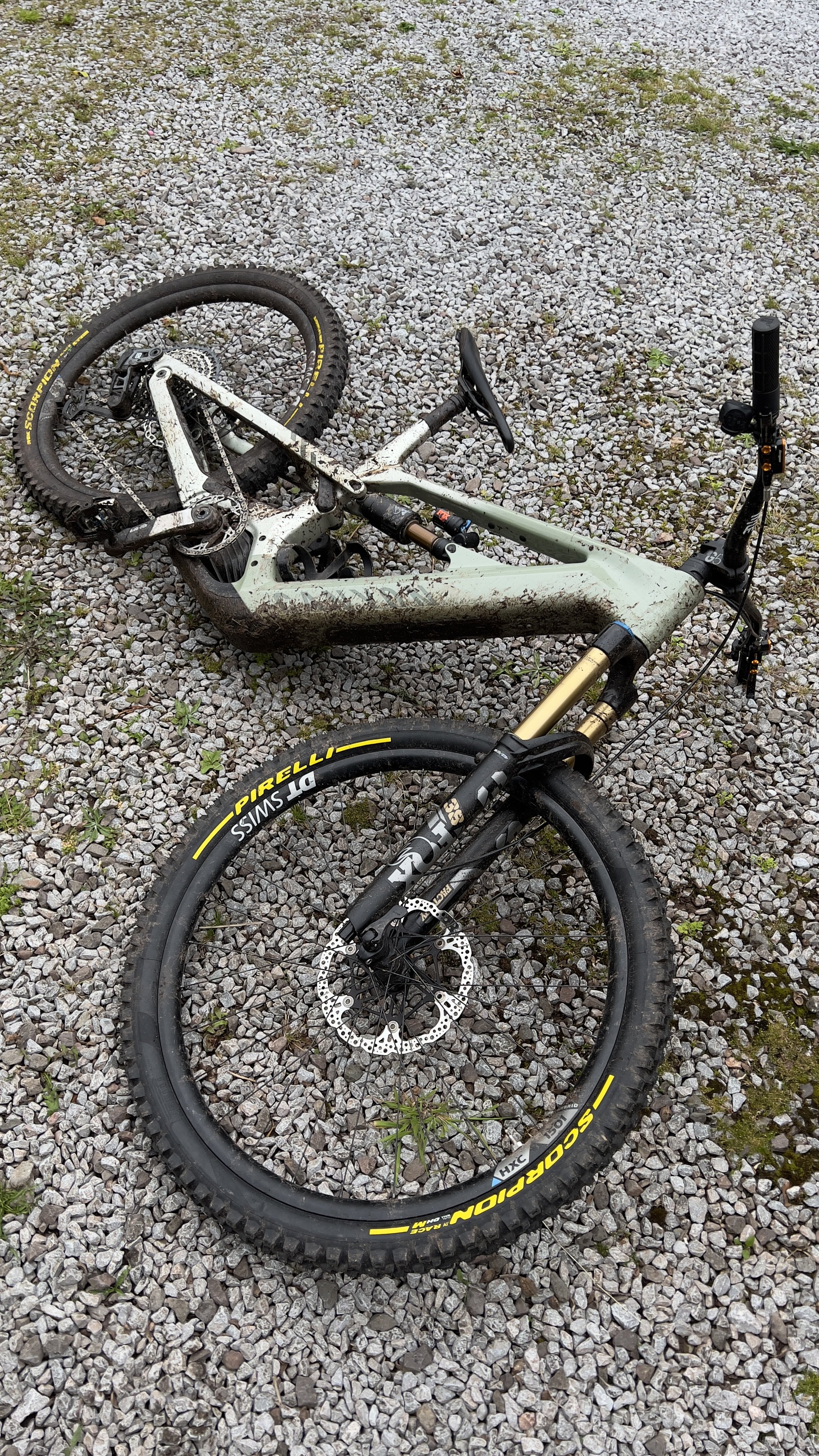

New e-biker here (Relay) and am not surprised but they are hard on tires.
About 40 miles on a rear Aggressor 2.5 and the side knobs are looking pretty injured. It probably has another 15-20 miles on it at most.
I keep swapping front tires but can see them getting some good wear as well.
