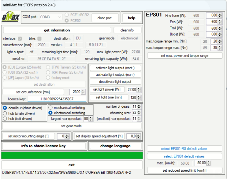

Yesterday I had a online session with eMax from Germany.
They speek/write very good english.
The job was:
- get AutoShift to work.
- raise the speed limiter to 32kmh.
Bike:
- Orbea Rise M20 2023 with RD-M8150-11-SGS 11s derailleur (Di2 LinkGlide)
The bike did turn on a error code E903, when I connected the RD-M8150-11, which was quite strange.
AutoShift is not available in the Shimano mobile app, and not in E-tube Windows program.
The free miniMax software could change the shifting from mechanical to electric - and this made the error E903 go away and the AutoShift to be enabled - and it did work.
So....the German tech connected via the free software AnyDesk, and I could follow all the steps.
After some minutes he was finished.
I assembled the bike, and did a quick test ride in the rain/dark.
The speed limiter was raised and the AutoShift was working.
I am happy.
I have not had time to look through the software - but as I remember I can:
- set the speed limiter between 25 and 50 (32 is enough for me)
- set the power level in all modes (up to 600w)
- change between mechanical/electric mode for the derailleur
- a lot of reading possibilities.
The prize was €119 and it was worth all the money.
The support is very good.

I have used the emax function and gone from mechanical to electric shifting.
The error is gone and the shifting is working.
I am happy.

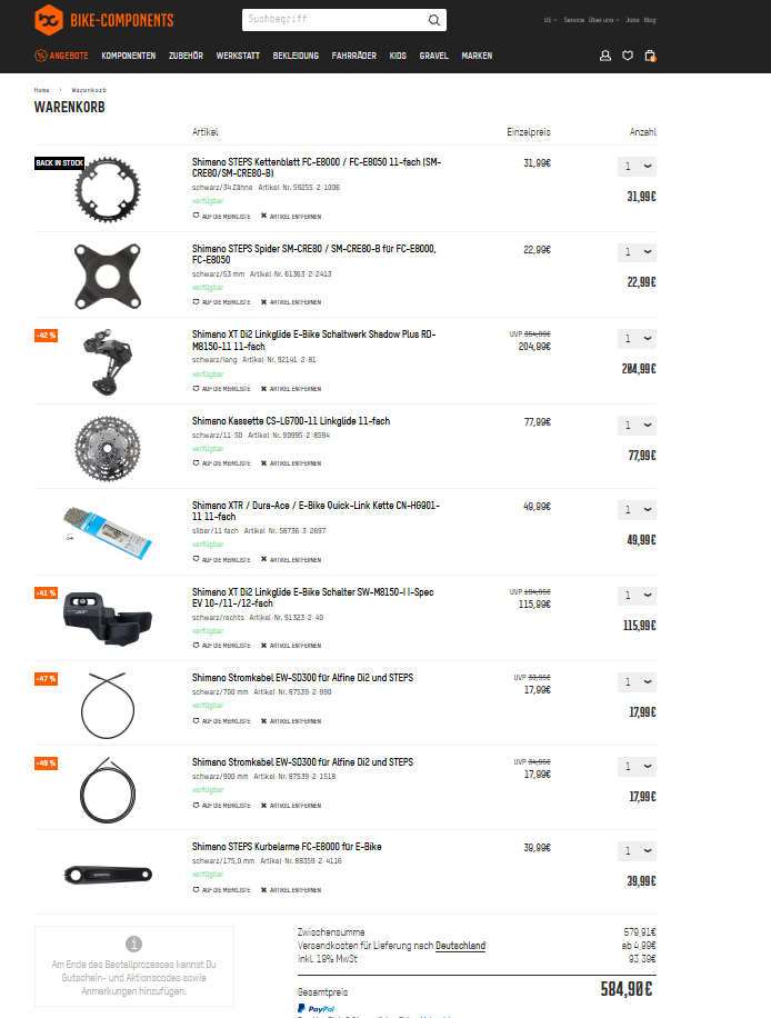

i plan on upgrading to 11 linkglide too, my bike is a m20 2023.
if u go after the shimano compatibilityy list i basically need to change the whole drivetrain...
-did u used all of the stuff shimano recommended or did u kept some old stuff from the drivetrain?
-did u actually got a new rear wheel?
-did the new shimano sprocket worked out compared to the stock e*13?
after getting all parts together in the shopping basket, i noticed the 11 linkglide need a different hub to fit the cassette, the one coming with orbea is microspline and the 11 casette is HG...
sorry for my bad englisch :D i hope u understand my question.. thx
Yes. If you currently have a 12 speed Shimano cassette, which the 2023 ORB M20 has, it will have a Microspline Freehub, whilst the 11 speed needs a HG Freehub, and you cannot just change the freehub. You have to change the whole hub, which means re-spoking the wheel. So it's probably easier to just get a new rear wheel with a HG hub.
Don't forget you need to reprogramme the motor from Manual Shifting to Electronic Shifting, which needs the PCE02 cable. Or you can ask a local Shimano Agent to do it, but they may not want to. In which case you'll need to do it yourself, and that cable is expensive.
You don’t need the crank arms, spider or chairing. Although I changed mine
The 2023 ORB M20 has a 12 speed Shimano chainring. Are they compatible with an 11 speed chain ? It will work, but you won't get the best engagement, as the teeth are probably thinner.
I have never tried that. I guess it should be ok. But I know a 12 speed shimano chain won't go on an 11 speed shimano chainring.
