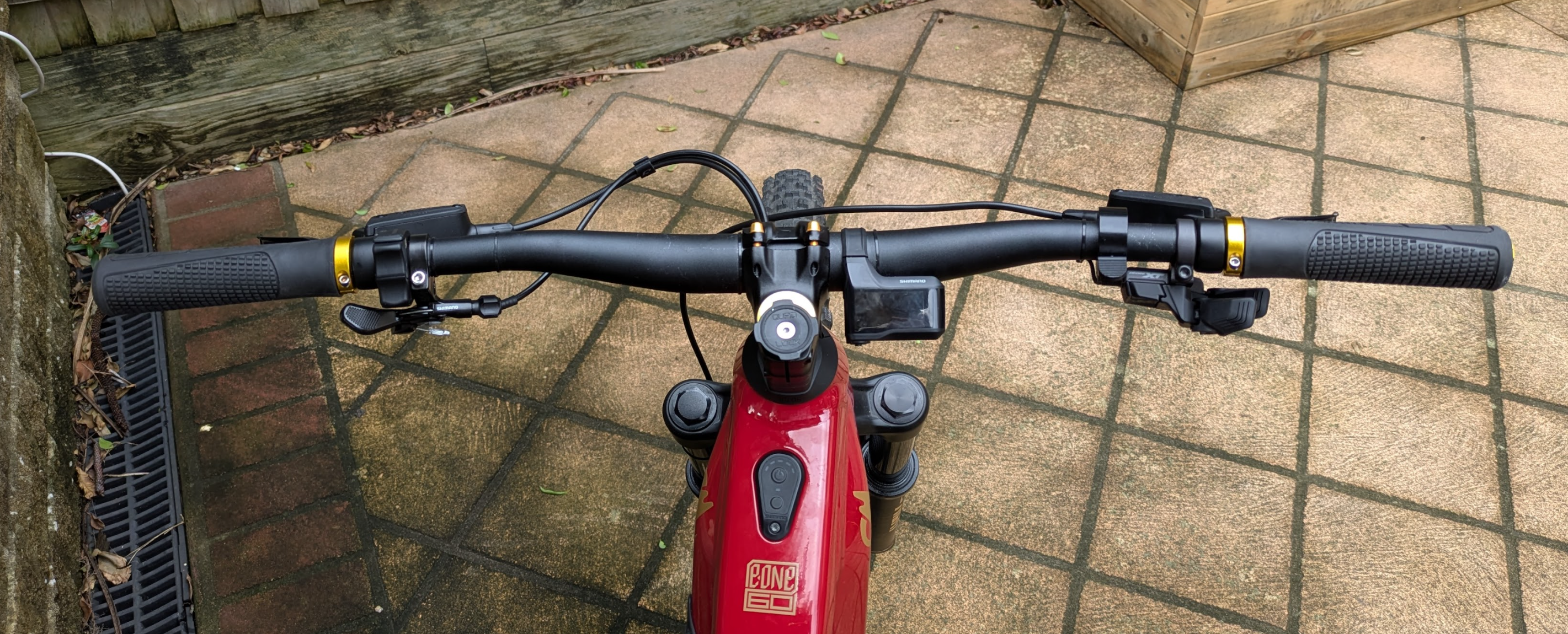

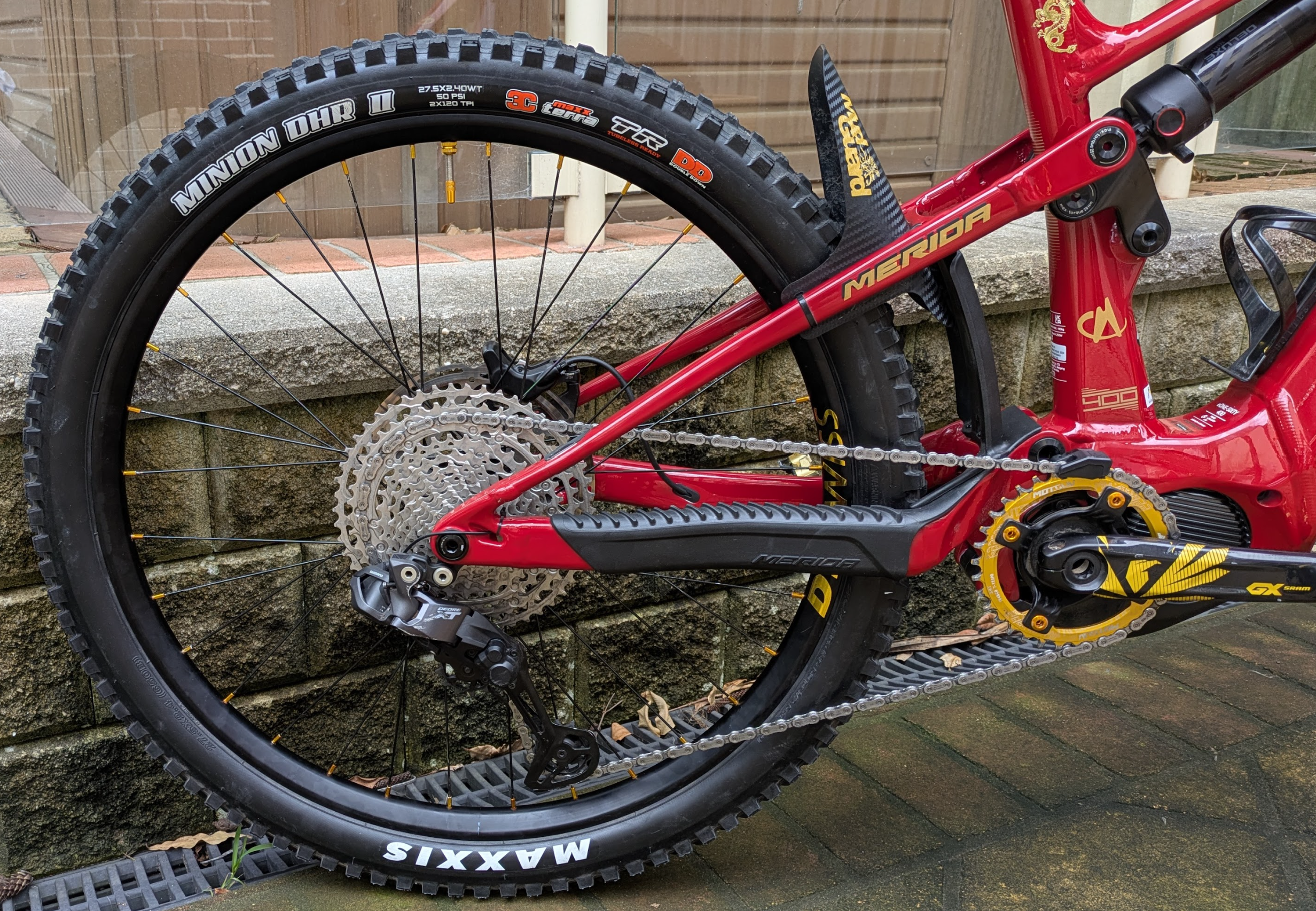

I have the EM800 display and 12 speed transmission.
Don't bother making changes for Autoshift. I changed to 11S Linkglide on my previous bike for Autoshift, and Autoshift was pretty useless. It cannot predict the terrain ahead, so shifts too late. Then quite often shifts when you don't want it to.
The useful shifting is Freeshift. This is the ability to shift without pedalling. This I used all the time on both bikes.
So do what I did on my latest bike.
1) Leave the 12S hyperglide cassette on the bike.
2) Get the RD-M8150-12 Di2 Derailleur.
3) Get the SW-M8150-R Shifter. It's much better as a shifter than the SW-EN600-R. Your thumb is much more comfortable.
4) The EM800 display has 4 SD300 ports. So you need a cable to go from it, to the SW-M8150-R Shifter. Just measure the distance. Leave a little extra. Tie any extra under your stem neatly.
5) Then you need a cable to go from the Motor to the RD-M8150-12 Di2 Derailleur. Measure that distance, plus a little extra. You can tuck extra into the motor housing.
6) Then you need both the Shimano ETube and Mini-max program, and SM-PCE02 data cable to reprogram the motor for the electronic shifting.
That's it. Photos below.
I see you have a derailleur extension. This is always needed for the Di2? I love your rear mudguard. Where can I get it?
I'm not sure what you mean by an extension. I added nothing to the derailleur. It's a stock XT Di2 derailleur.
There is a plastic mudguard covering the rear triangle mounting. That came standard with the Merida. The other carbon fibre looking one, cable tied to the seat stay, came from Aliexpress.

The motor cable ran to the handlebars. So I ran it to the EM800, which has the 4 port junction. Then a cable back to the top tube switch, then on the handlebars, one to the shifter, and one to the mode switch.
No error codes, but I updated the firmware, and changed the derailleur to electronic in the software, so I didn't. If you don't do this. You will get error codes.
You easily can connect the SW-M8150-xx shifter via an EW-SD300 cable directly to a non-used port of the 4 ports in total of the SC-EM800 display (it does not matter which ports you are using, because all of them are equal in functionality) . So, no extra quadruple EW-JC304 adapter is needed. Ideally also order a cheap TL-EW300 tool, because this makes the cabling work much easierChat GPT said is wasn't possible
