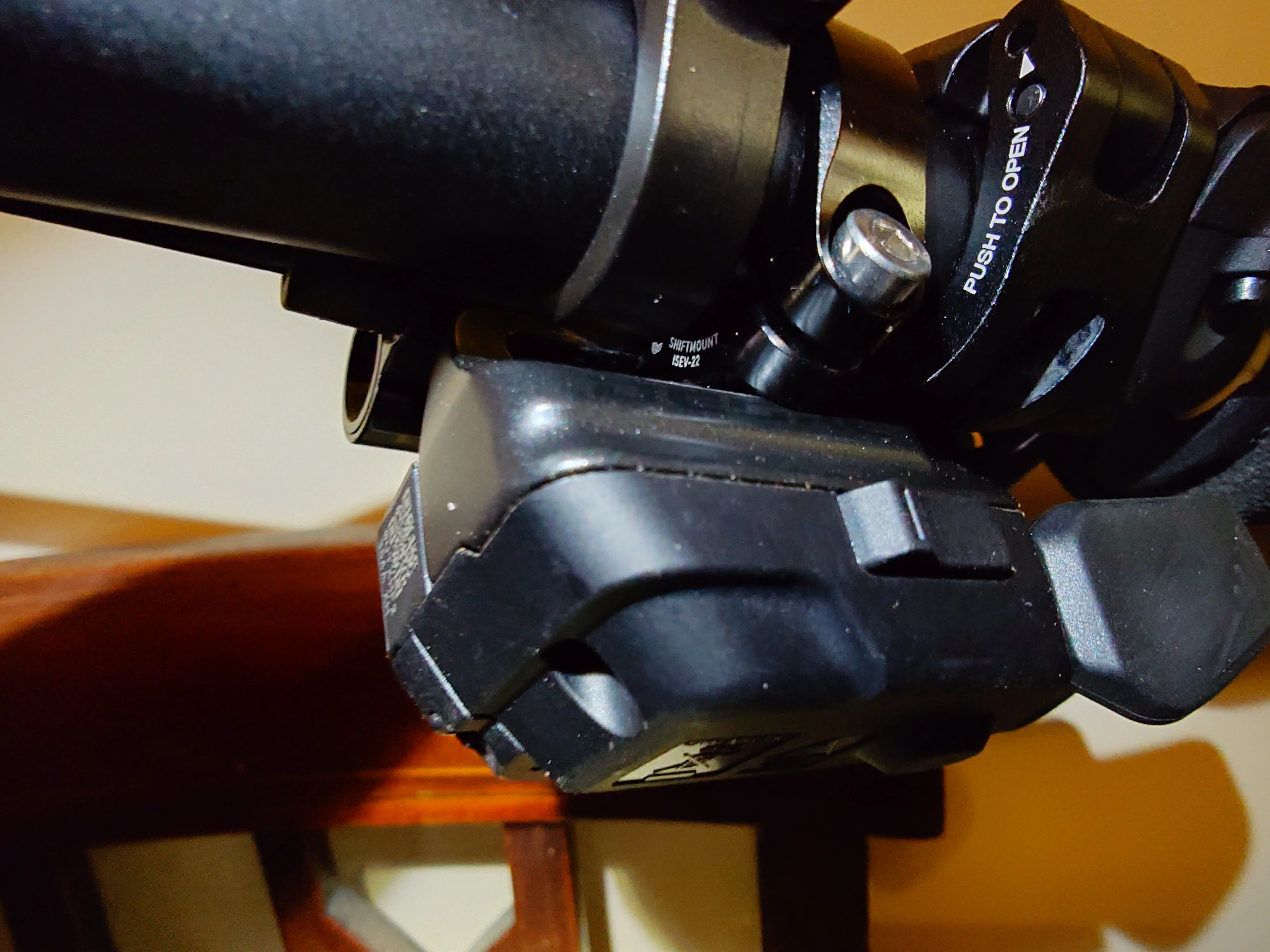

Remove strangely headed screw that attaces switch to XT brakes caliper.
NO - It can't be removed - the screw is 'riveted' in place (barrel beyond the threads is widened to prevent removal).

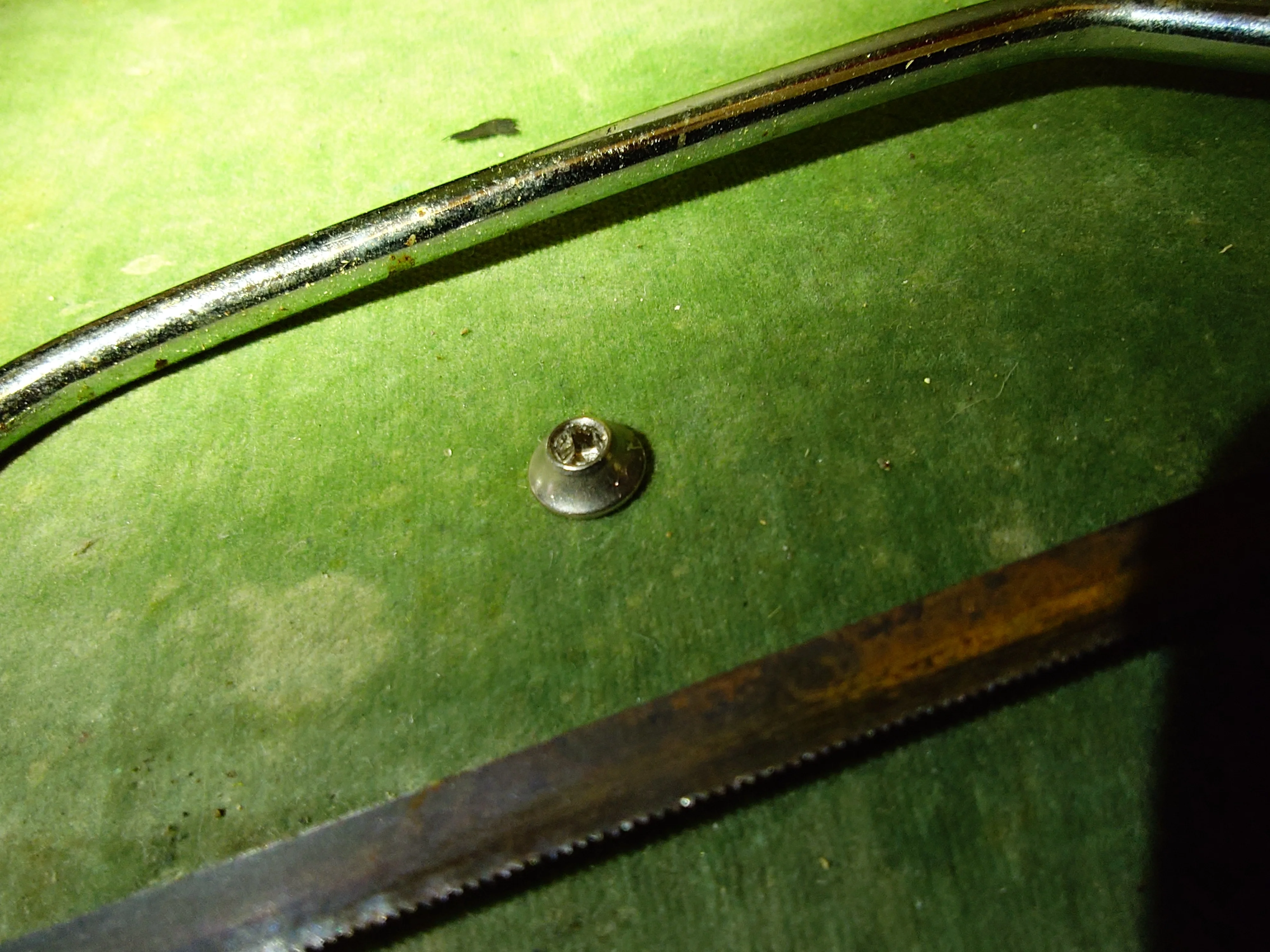

Took a junior hacksaw to the little SS screw and took it's strange little head off.
Looked to replace with an M5 hex socket cap head screw, and it won't fit - the body of the switch prevents the screw from being inserted, hence the strangely unique shape of the Shimano one.
The screw also has to be 13mm long, so I took an angle grinder cutoff disc to the head to flatten one side and then to reduce length to 13mm.
Add an M5 SS washer and Bob's your auntie !!

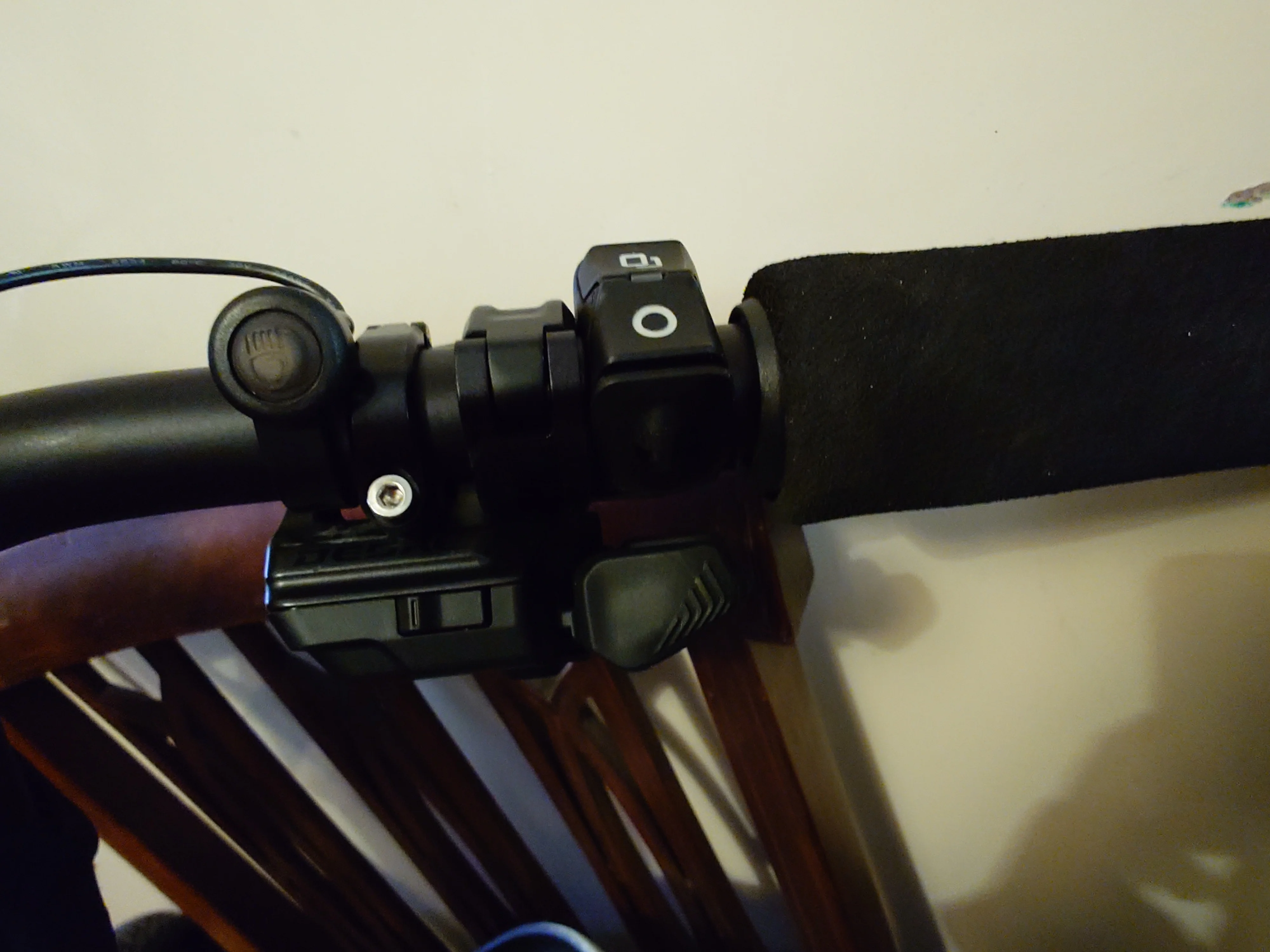

All mounted up nicely and no longer banging my thumb against the sharp little button ends !
So - Doesn't fit, but can be made to fit, with a bit of swearing
