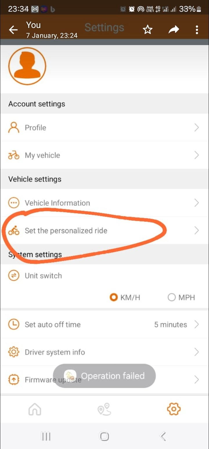

Im not understanding, how do i disconnect bluetooth from the motor but then still change the settings?
Remember the bluetooth is supplied by the display. Nothing to do with the motor. The motor is connected to the display with canbus not bluetooth.

I have not used GO+ or Besst. As far as I understand if you can connect bluetooth, which requires the version3.0 245 display, and the app can connect to the display you can do everything the app offers with the motor connected, which is not as extensive as the Besst tool. But someone who has actually used them both should anwser.
Power is provided through the motor control unit through a bias supply most likely, that is why I ask. The motor unit has to be connected to the display.

Sure but the motor speed controller is in the motor, unlike some of the other Bafang motors with external speed controllers, and the computer/display controls the speed controller. With these units you don't touch the speed controller. All the options are in the display computer.

Besst tool and besst Pro are good for diagnostics and changing firmware on motors (CANBus).
Nearly all of the parameters (in terms of motor tune) can be amended with the Bafang go+ app, provided the motor's firmware permits parameters to be amended via the app.
The M820 is one of the newer motors from bafang. So using either the dpc245.3 or the DP-E165, will allow the motor to connect with either bafang go+ or besst Pro.
You could argue that the besst pro software and besst tool are more for "dealers".
