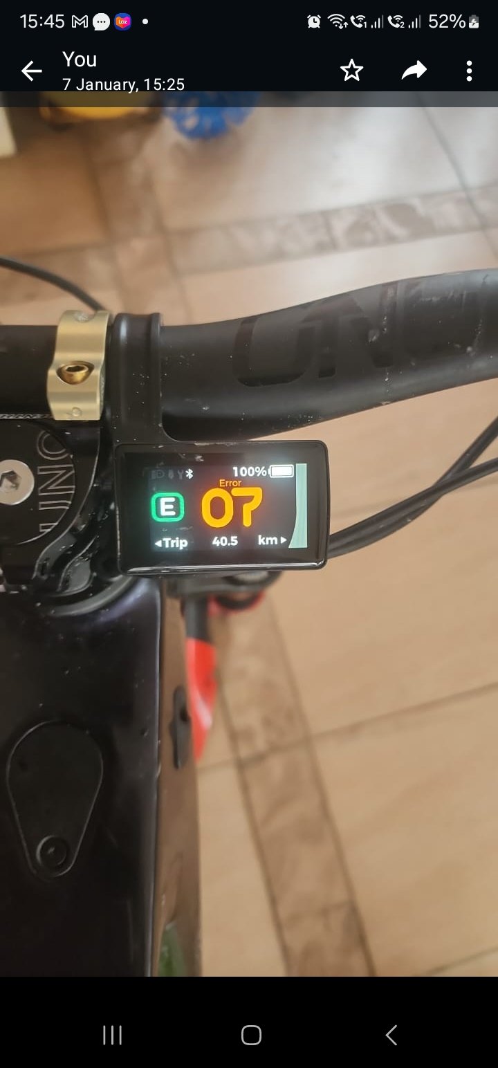

Quick question for those with a 48v motor , when you bought your bikes, did you also have to pair it with a 48 volt battery or can you run the system with 36v battery?
My motor originally its 36v and then linda upgrade it to 48v. When i update using Bafang Go+ firmware, its update 36v and i got error 07 which is over voltages protection because my battery its 48v so i need to use Bafang besst to manually update its back to 48v.

my 48V motor unable to access Go+ funtion (Set personalized ride) only besst can do. For calibration you need besst and manual update firmware. Don't update your Bafang Go+ firmware if you dont have access Besst USB, else u will be like me. G0+ update wrong version automatic and i have have to manually fix it back with BESST,
