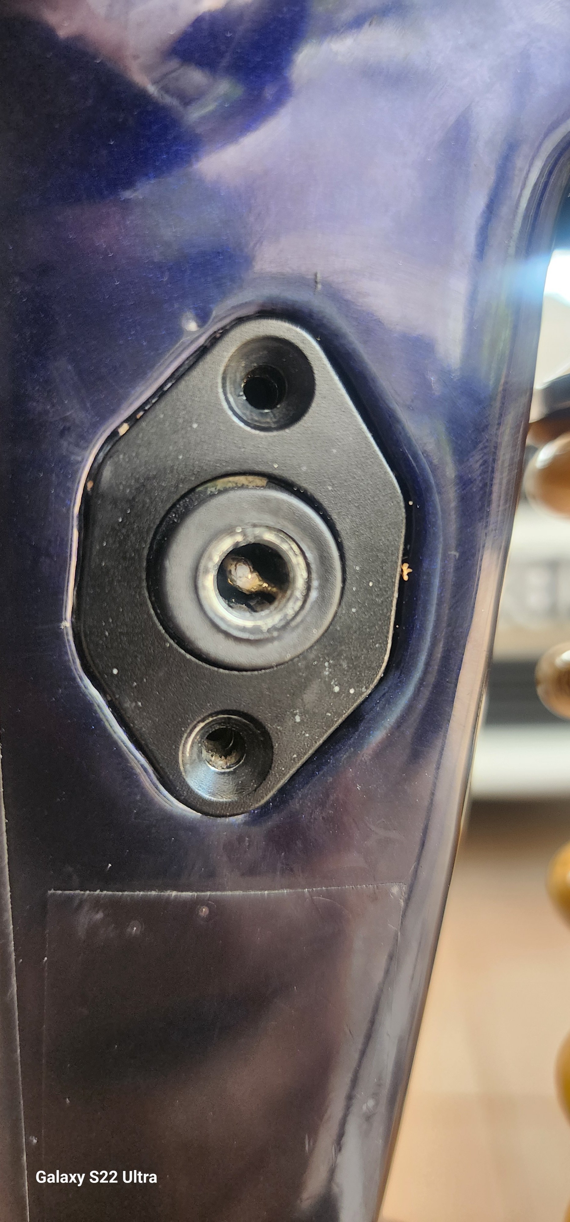

Last week i was try to remove the charging port n accidentally insert the allen key into the port n its spark with smoke. So i quickly remove disconnect the battery, motor and the charging port cable. Lucky my battery n motor still working, only the charging port + n - has weld together as on picture.
