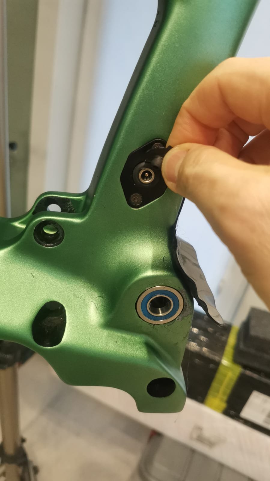

The color is very beautiful. I see that the shock absorber with a spring cannot be installed. Which version of the frame is this?
Linda asked me if I needed a coil, I said no, so I guess I have a v1 front triangle and v2 rear triangle as it supports udh

Need a replacement charging port dust cover for our CEF50/720Wh/36V frame.
SZZS is clueless on simply identifying the proper size. 😝
Sure, I can order another charging port somewhat inexpensively from Linda($8 +15 shipping to the US), but it's the single-hinged cap will likely keep breaking and getting lost again and again. I haven't found a comparable replacement yet after a month of searching electronics websites for either a new flush port or simple cover.
My strategy for a cheap and quick workaround is to just buy lots of caps on AliExpress/eBay/Amazon, like 10 caps for $5USD.😁 But what size exactly is the dilemma. I have measurements for the port, BUT most online retailers don't or don't match up for the needed dimensions unfortunately.🤔
Anybody have a solution for the dust cover strategy specifically? Or even a better charging port that is low profile and flush to the frame? 🤞

I have installed a regular port
