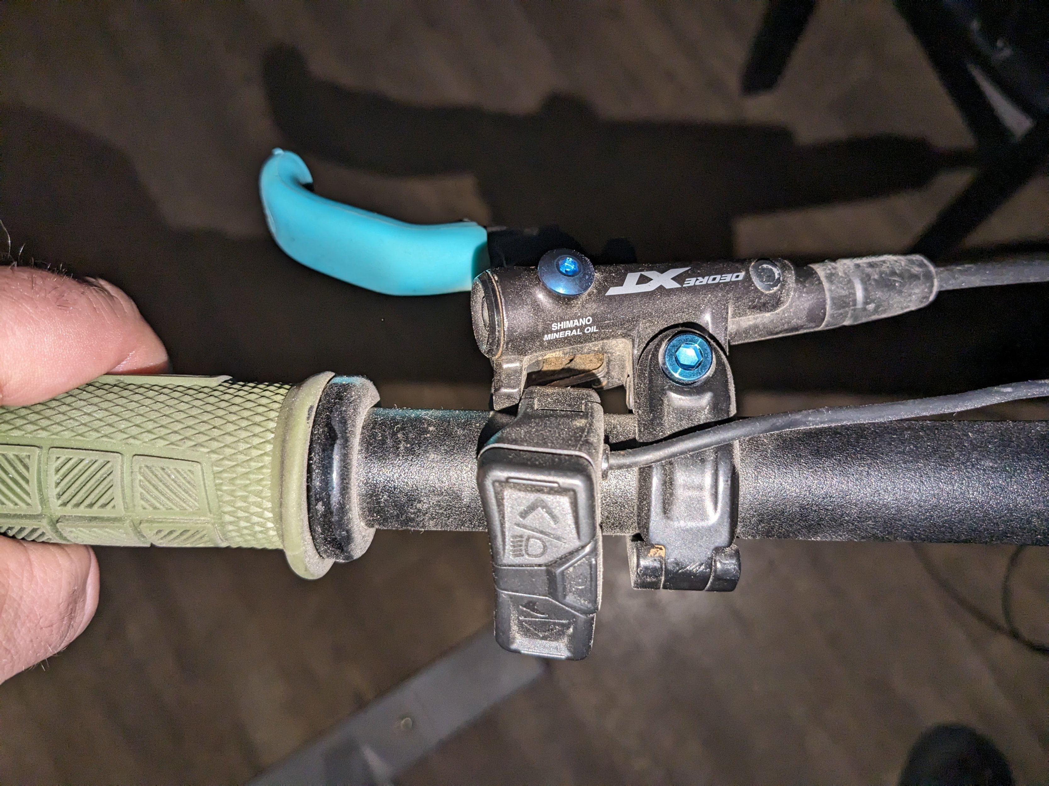

As I'm still waiting for my kit and can't check it myself, I was wondering if anyone was able to install Bafang control unit (the part with mode up/down buttons) together with Shimano brake levers for 12-speed groupset (m8100, m7100 etc) in a way that the control unit is located between brake lever clamp and the additional contact point touching the handlebar to ensure stiffness. I'm planning to use ispec-ev mounted shimano sl-mt800 dropper lever and it seems like the buttons might fit in this space. Can anyone share a photo of such arrangement?

My setup: XT M8100 levers, generic HB dropper clamp, DPC245 power button/mode selector.

XTM8120 w/DPC 245 power mode selector.
It fits between the clamp and bridge but creates an angle that might not work for all.

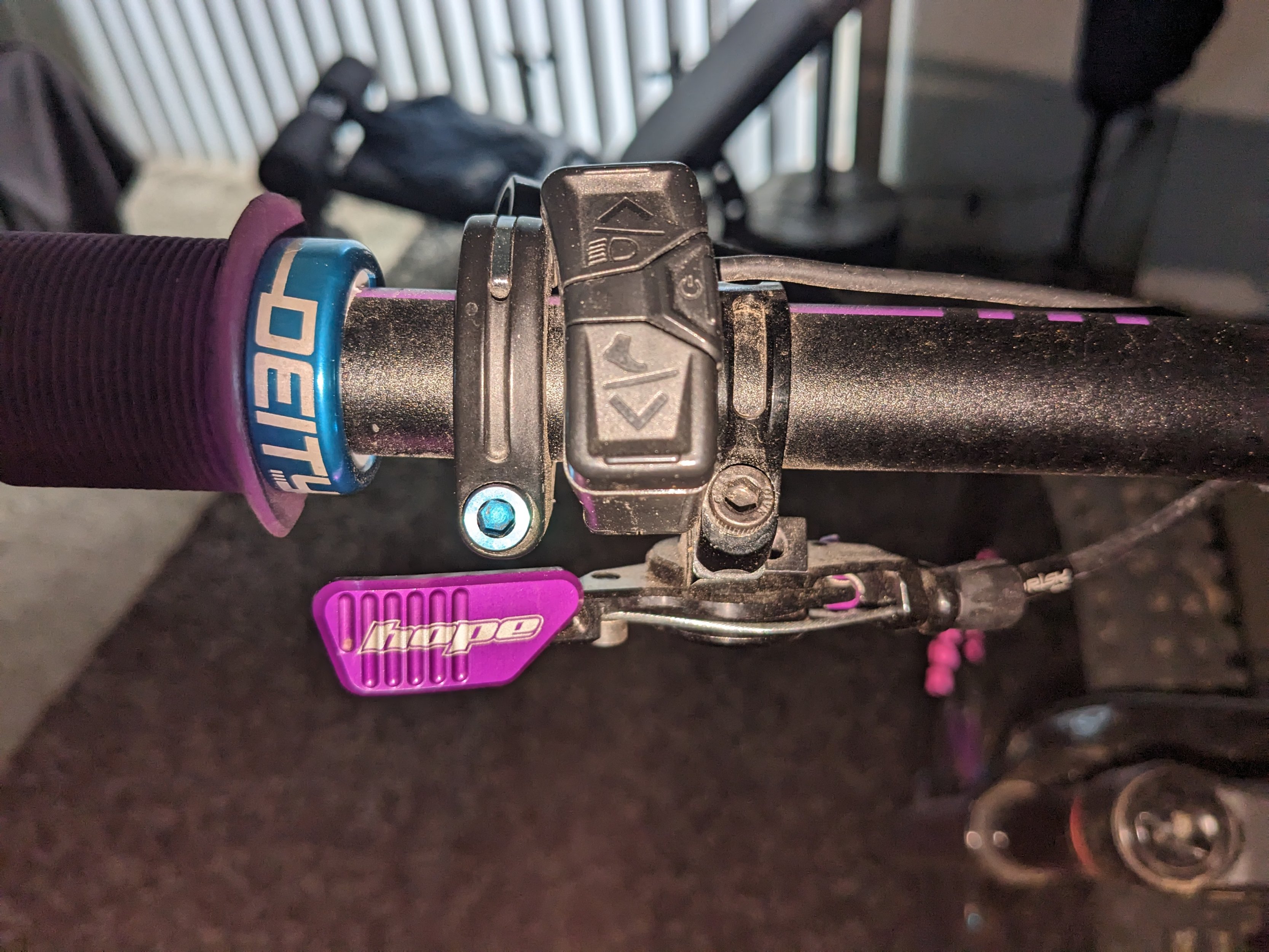

I run 800 mm bars and needed the dropper lever further out (not showing currently) so I used the solo clamp rather than I-spec ev integrated brake clamp. From M600 rig.
Extra info.
Additionally, I have high rise 40 mm which effectively shortens the power mode cable to the display, hence the odd angle of the mode selector.
All the nuances of the custom cockpit.🤯 Also why would be nice to have a wireless selector.😎 And a little lower profile like on the Forestal Siryon M820 for future designs would be desirable.
Although, it's is a major hepatic improvement over the old DPC 242 as well as now having a color screen and an HB clamp that actually fits a 35 mm handlebar!🫡😁
It fits between the clamp and bridge but creates an angle that might not work for all.View attachment 133099 I run 800 mm bars and needed the dropper lever further out (not showing currently) so I used the solo clamp rather than I-spec ev integrated brake clamp. From M600 rig.
Extra info.
Thanks, this setup is exactly what i’m hoping to do. I have rather small hands, short fingers and moving the control unit further inside will probably be highly uncomfortable.
