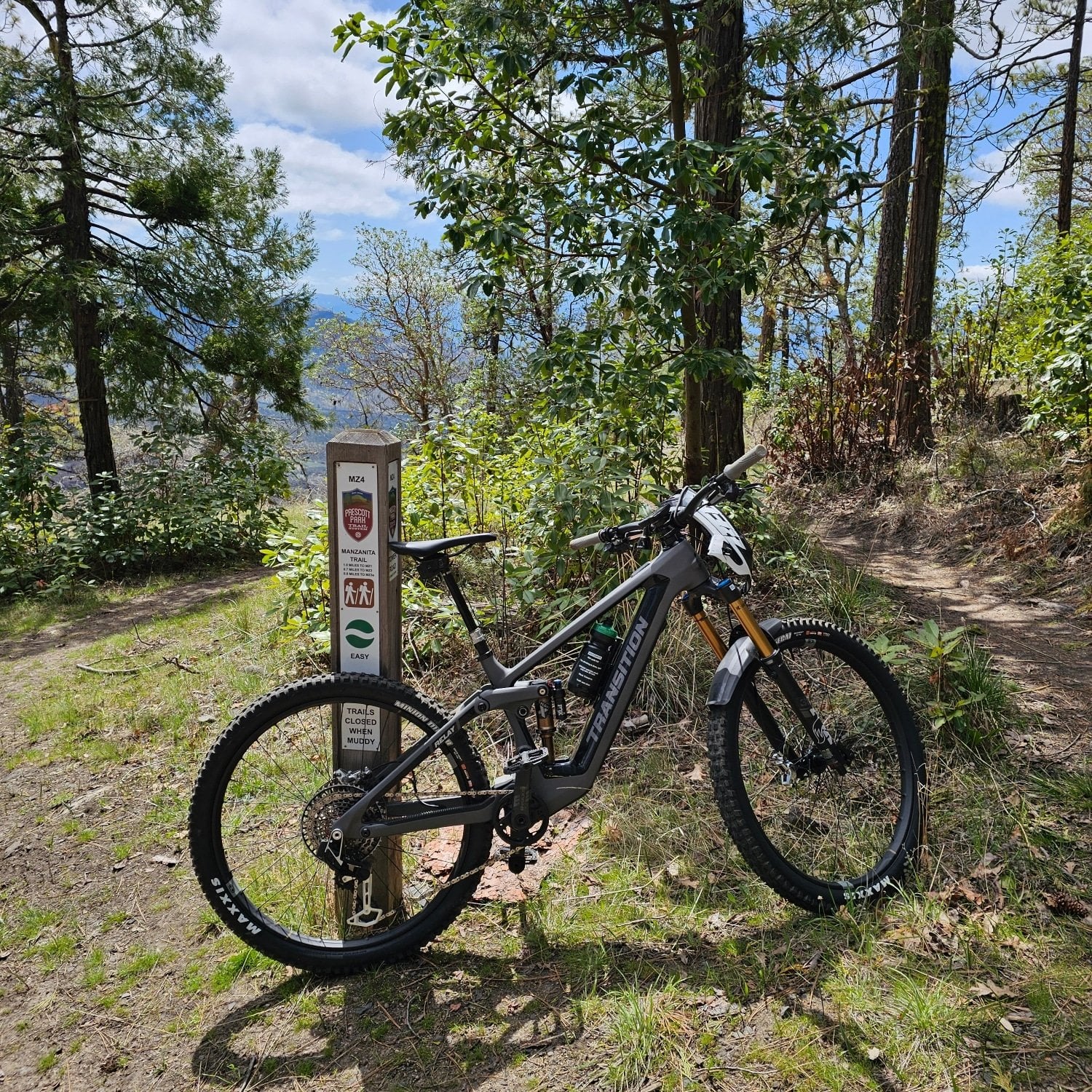

So coming from my incredible Revel Rascal and still wanting to push myself, most of my rides have been in a mix of the 3 modes with majority in "eco". That being said most of my rides have been 10-17 miles with a minimum of 2k feet of climbing.
I have only been on one ride with other e-bikers and it was just under 17 miles, 2,800 feet of climbing and I still had just under 40% battery (2 dots) left. Granted I was being pretty conservative with my battery as it was only my second ride. And I did not get left behind (middle of the pack) but it was pretty tight, slick and technical single track for the climb so that can be a great equalizer as I'm sure they could have left me in the dust on a fire road.
Yes I spent too much, but due to availability I ended up with the top XX build, transmission and all. Glad to say it does weigh as advertised right at 42lbs and 37lbs w/o the battery. So really not bad at all for a 160/160 "enduro" bike. Which, to answer your questions, is probably about half of what my riding style is because of our varying terrain we have.
Hope that gives ya'll some insight as it really is an incredible bike and does ride like a normal mountain bike just with that extra help going up!

Can you clarify what condition (i.e. tubeless w/ sealant, which dropper as you have 2 different ones pictured, with pedals?) and what size it is for that 42# weight? Also was that weight dead on?

I did change the dropper. The original picture was when I got it and then I put my Reverb AXS on it. And its a medium. Not sure if its spot on 42lbs, but it was as factory speced. Im not that anal and don't weigh it each time I change something minor
The relay looks great IMO. Whats it like to pedal with the motor off? No resistance at the cranks?
Absolutely no resistance. I've actually made it a point to do some climbs with it turned off (battery still in) and it just feels like Im completely out of shape with a really sticky tire
