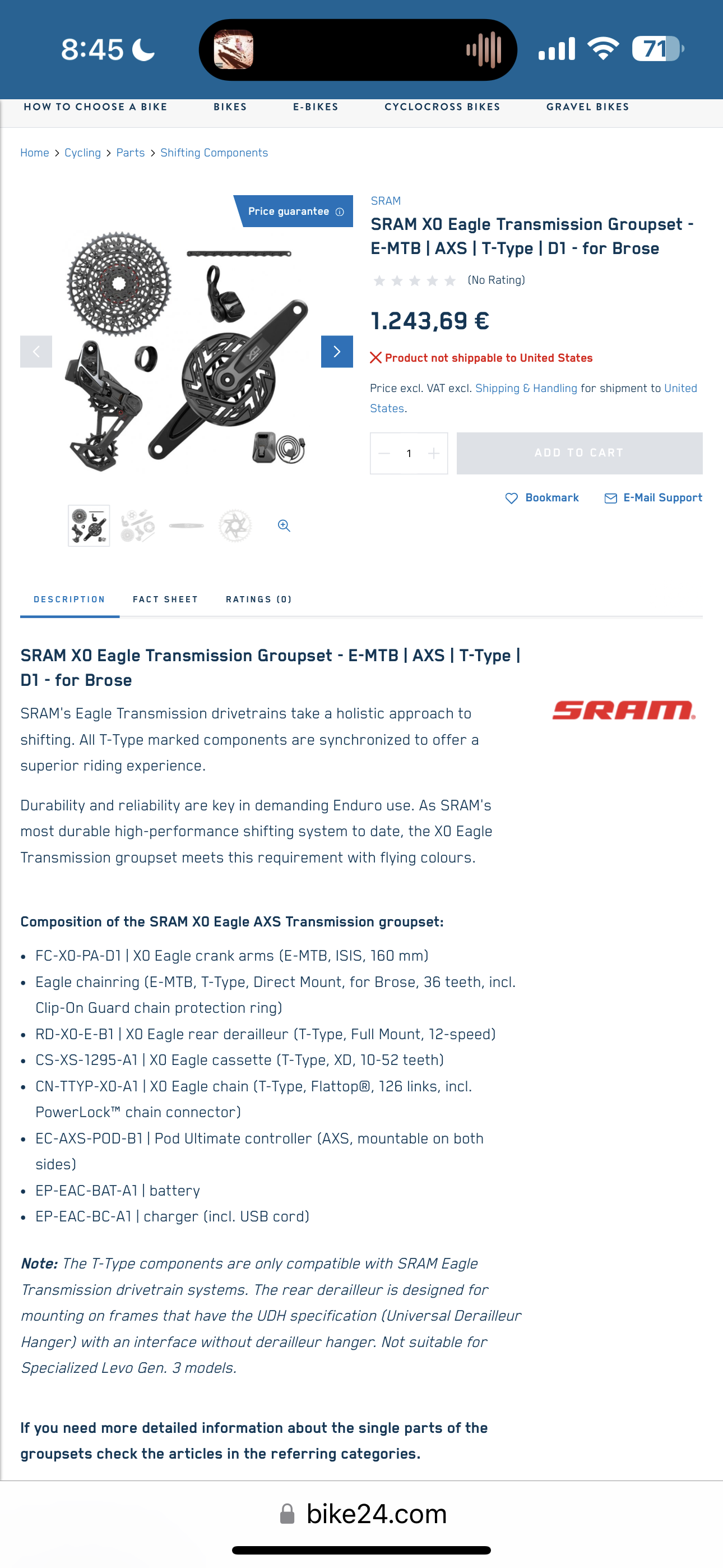

Brand share wise…SRAM would be the dumbest company on earth to produce a groupset for the Brose that does not work on the current Levo. It has to work…
Read last line in description
First of all that is a third party site. I would not trust it.
2nd, my 2022 Levo Expert Gen 3 Levo has “UDH” literally printed on my derailleur. The video from SRAM literally stated that if it stated UDH on your bike transmission would work.
I will call SRAM tomorrow and get to the bottom of this.
How this is even questionable with the volume of Levo’s on the trail blows my mind! Especially when SRAM states that this drive train was literally built for ebikes lol.
And Mr ebike himself, [mention]Rob Rides EMTB [/mention] mounted transmission to his 3rd Gen Evo!

Brose goupset is the correct one for the Levo, ignore the comment on the Bike24 website. The direct mount chainring supplied with this groupset will give you the correct 55mm chain line.
If you buy the 104BCD groupset, it will work but you will still be running a 52mm chain line.
The chainguide will work with the 104BCD chainring but you would either need to remove it or add an additional 3mm of spacers to get it working with the direct mount chainring.

I wouldn't ignore bike24 comment. The case isn't the chainline, it's the levos asymmetric crank.
"NOTE : A frame with UDH interface is absolutely necessary to mount the rear derailleur! Does NOT fit Specialized Levo Gen. 3, since a drive is used here that requires an asymmetric crank. Please use the group with 104 mm BCD chain ring."

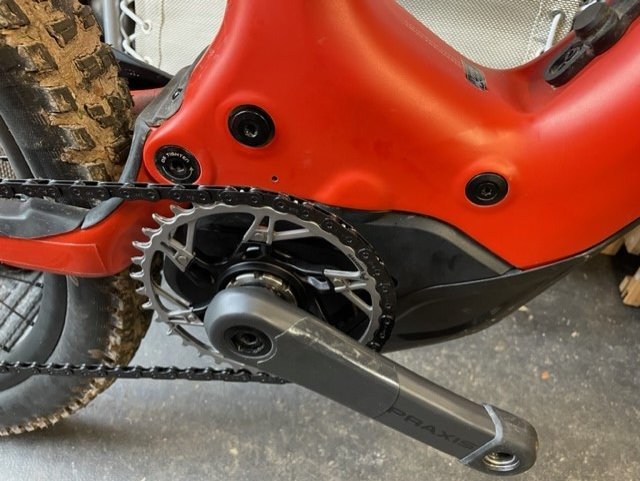

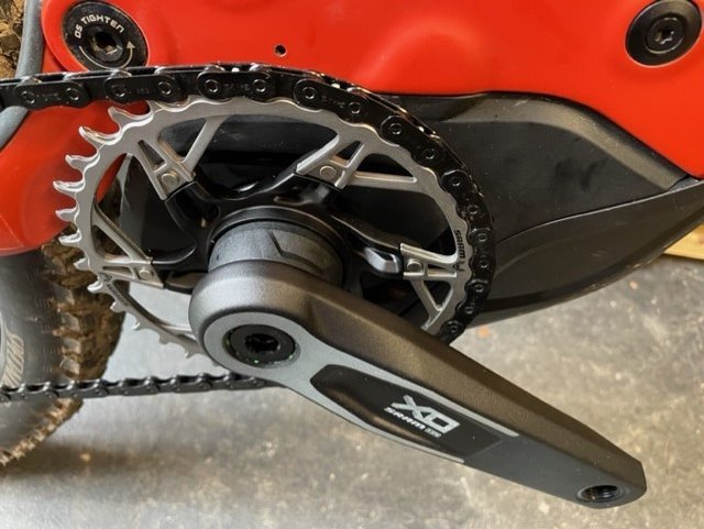

I'm running X0 cranks with zero issues. If you don't want to use the cranks that are included with the groupset, simply install the chainring and use your existing cranks and live with the gap between the crank and chainring.
the 36t version is not available separately or another month.
Clearly I ordered the wrong upgrade kit, mine came with the 104BCD chainring, but it work OK.
Could be only an issue of wear use 104 bcd with 52mm chainline ?
i’m now on 104bcd and 34t, but i ordered brose chainring 36t and a new chain, cause i need 2 link more.
i’m not sure to change it.
I was told by my dealer that the 104bcd kit is the proper kit for the Levo per SRAM….and more information and clarification will be released soon. ??
