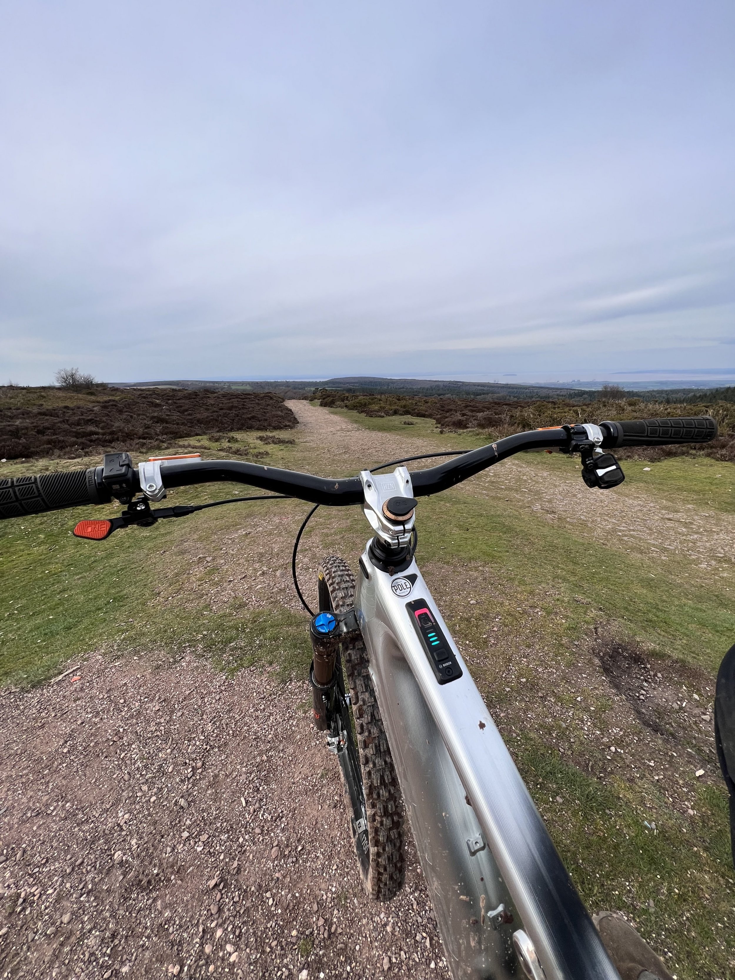

K2 works amazing for me. I know it sounds crazy to a lot of people but sizing down on these bikes is totally doable. Having spent an hour or so on the bike today it’s so much better to ride than the K3.
There’s a lot of scope to move things around with bar height / backsweep / stem length etc to fine tune fit.
I’m 190cm / 6’3” and with the 480 stock reach and the +5mm works components reach adjust the bike handles sweet.
Had a knocking sound coming through the bike that I had to solve. Fox X2 is already toast sadly. Super Deluxe back in and knocking sound has gone!
Bike is superb, so happy with how it rides.

@Rob Rides EMTB what handle bar is that?
It’s interesting that you are now liking shorter reach bikes. It wasn’t so long ago that you wanted long reach and builders to extend their geo to accommodate larger riders. What’s changed?
Its from a brand called Title. Great quality Alu bars (mines 31.8)
