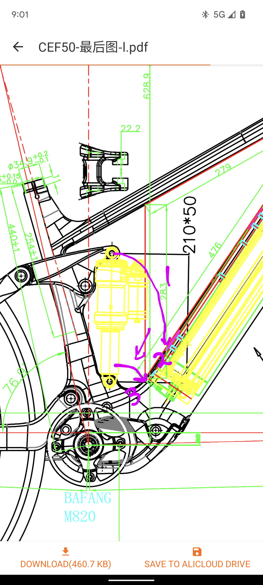

I don’t think we’re gonna be able to fit a coil shock with the seat post sitting so closely.
Linda confirmed with her engineering team that it was a fit for my RS Ultimate MegNeg. I submitted caliper measurements and they gave me the thumbs up 👍
Chances are good if it's an accurate diagram and spring is same or less width. Posted below a few weeks ago
But it will be the very first item on my checklist to confirm as soon as it comes out of the box. 🍻

I am looking at used Fox x2 210 x 55 rear shock.
Will that fit?
Linda's engineering team says it should. See above in recent thread.
But first thing I'll do is fit my MegNeg out of the box when frame arrives. My backup was going to be the Fox X2...so that should show you my confidence level.
I got a 210x55 at first but the note up in the thread is using a 27.5 wheel not a 29er...
210x55 Is a safe upgrade on rear stroke. Can go shorter crank arms too if worried about bottoming out. I find 155-160 mm is becoming more common to avoid pedal strikes. But some argue on lighter weight builds 165 mm may be optimal. lf u gotta pedal w/o power, they're still long enough for leverage.
I went 155 mm cranks on a 55 rear stroke on a 27.5er. But the 180 fork should give more motor clearance. 🤞
Nice thing is the CEF50 geo accommodates both Enduro and/or trail build. Hey, doesn't Transition do the same with the PNW (Enduro) v. their trail builds?😁
So should be several cool versions of CEF50 to fit your riding style.🤙
