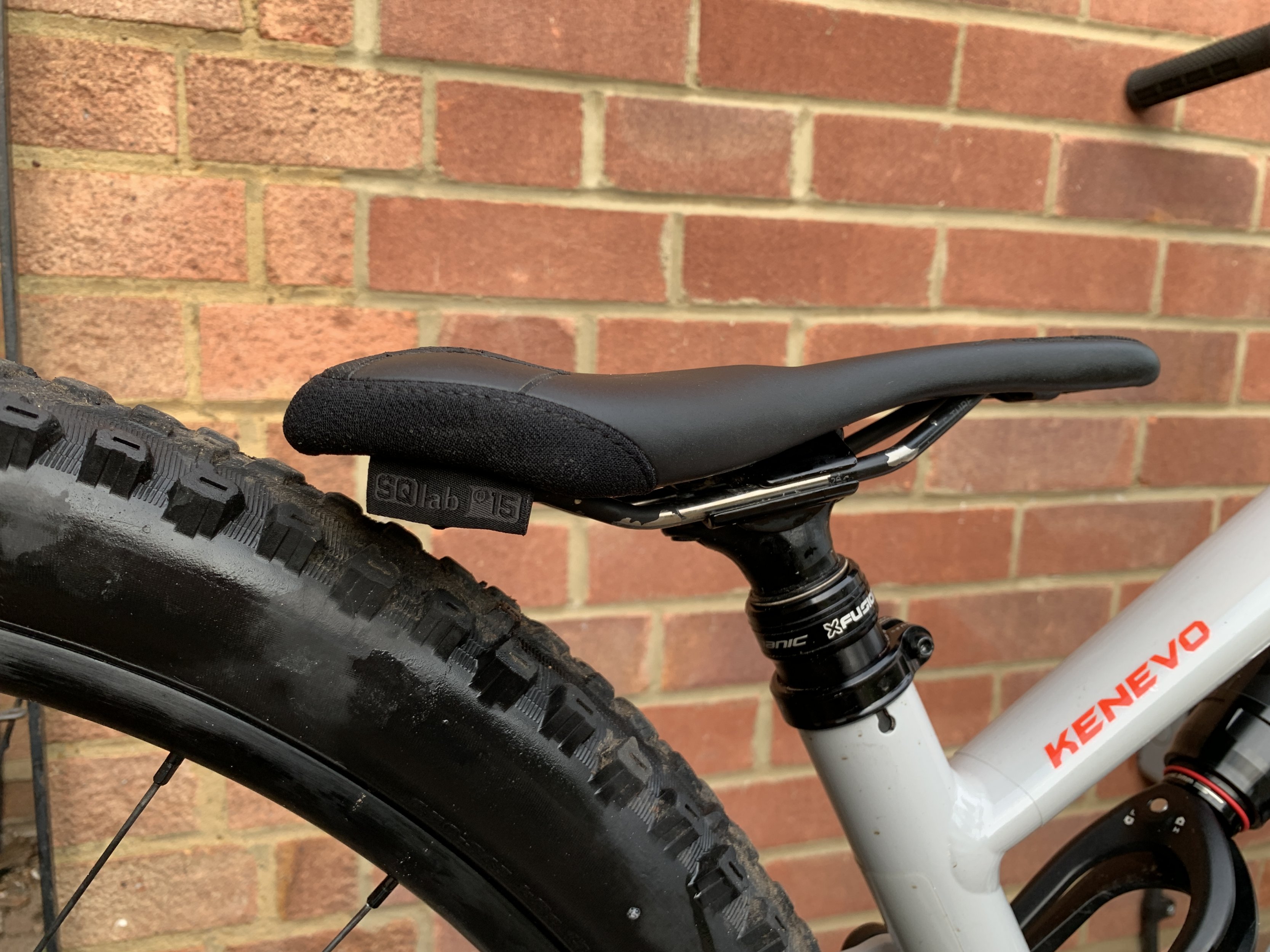

Here is a photo of the saddle clearance on a size S3. The tyre is an Aggressor 2.5, the post is as low as the frame will allow, and the rails on the SQlabs saddle are quite low.
The seat tube length on the S2 is 20mm less than the S3, so it gonna be tight on an S2 unless you run the post about 30mm or more up! Otherwise, you’d have to run a shorter travel dropper.

What length XFusion post you have when you got it so down?
