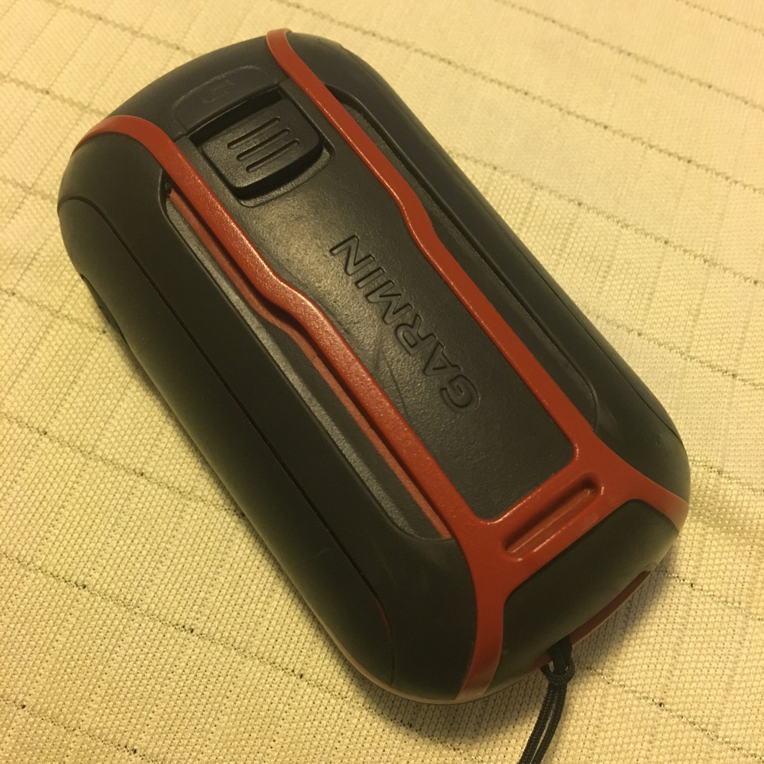

You fixed a GPS on the stem. How did you fix it? I have a Garmin Dakota on the handle bar but since the tube is tapered the holder fixed with cable ties tents to get loose.

The Garmin Dakota doesn't seem to have a Garmin mount at the back, you will have to buy or invent something else.

The Dakota is in a holder where it slides in/out from forward direction, where it collides with the Kiox - if in front of it. Could do something with a hing kind thing. Well, I will see what I can do or if I switch for Christmas to some other GPS.

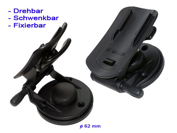

This kind of adjustable mounts work very good the first 5 minutes on our MTB :-)
For your original dakota mount, think the surface to the bars and the tension isn't big enough.
