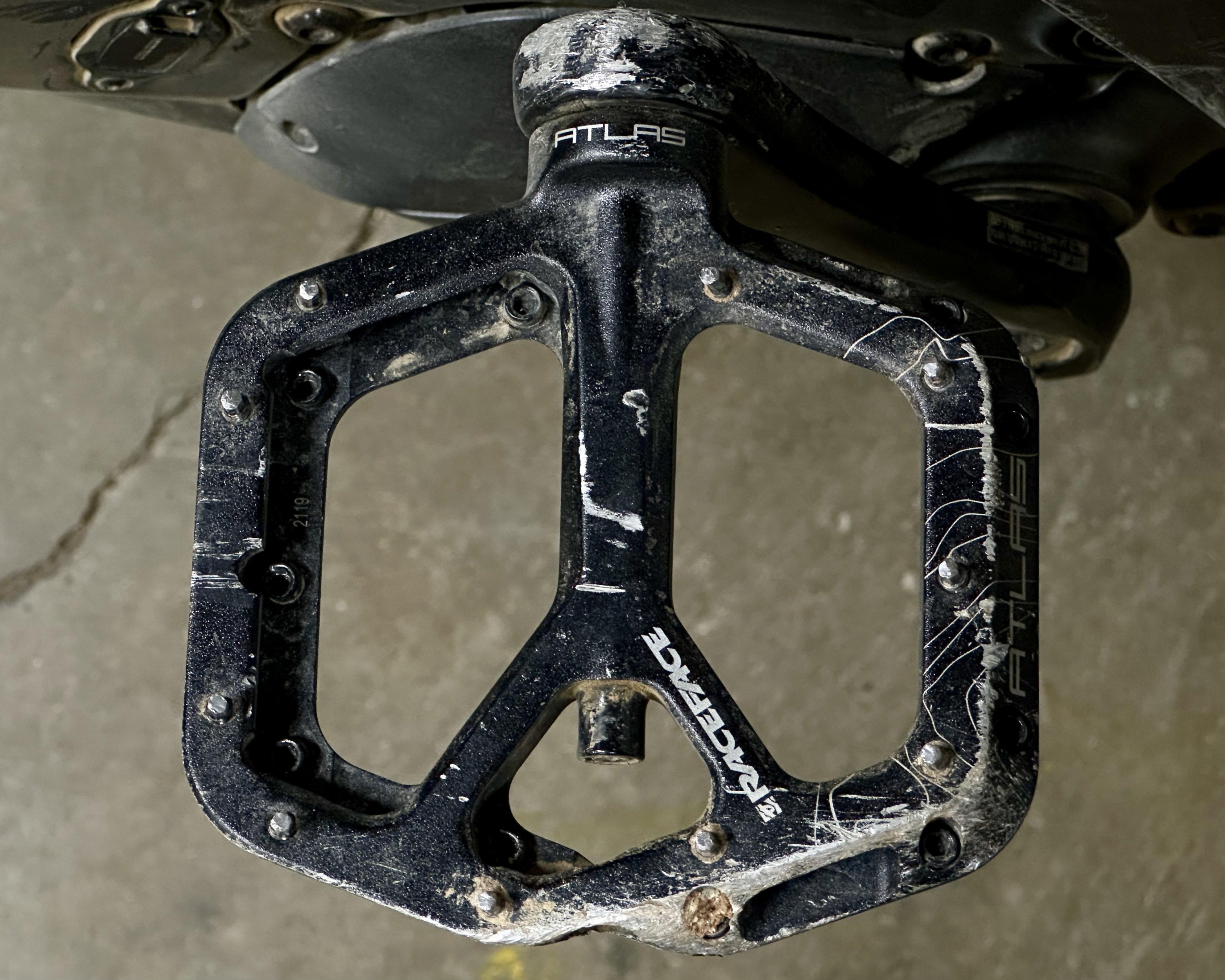

Evening all - took my Giant Reign E+0 to Afan today and the number of pedal strikes I was getting was quite ridiculous.
I have the flip chip in high but even so I lost count of the number of pedal strikes I got today, not even just on techy rocky climbs, I could feel it clipping the ground occasionaly on relatively tame trails too.
It’s a size large so I believe it comes with 165mm cranks as standard - would say the Hope 155mm cranks help to solve this, do I need to increase rear shock pressure significantly etc? Any ideas would be very welcome from anyone who has also had a similar issue!
Edit - just occurred to me that I have changed the front and rear tyre sizes to 2.5 and 2.4 respectively (0.1 decrease each) - could that be part of the cause?

The most likely cause is your shock settings. Either not enough pressure or too much rebound making it pack down.

I had this problem when I first got the bike and then again when replacement frame came defaulted to low. Set flip chip to high and upped the pressure, issue entirely solved and the bike still rides great downhill, for my type of riding.

Cheers guys. I’ve set the rear shock a bit stiffer and it definitely felt a bit better today but then I was doing far less technical climbs. We shall see - next step shorter cranks. Thanks for the advice!

I’ve had pedal strike issues, changed to a lower profile pedal and it made it a bit better. Am considering swapping out the cranks for 155mm Hopes (med frame). I’m in the HIGH setting on the flip chip.
Happy with the rear shock (X2) so don’t really want to chuck in more air to gain more clearance.
I’m pretty happy with my riding technique and strikes have never been an issue in the past (Specialized Demo 8/Orange Five).
Let us know how you get on if you go for shorter cranks, I’d be interested to see the results.
I’m literally holding off buying nice pedals until I’ve resolved the issue - smashed my HT composites to bits…

I've had this issue on bikes in the past, a few things to look into:
  • Flip chip in High: easiest solution, might not be enough
  • Bigger rear tyre: also easy, tradeoffs
  • More pressure in shock (and fork): easy but has more important tradeoffs.
  • Shorter cranks: miranda cranks are €50 and come in 150mm, im running 155mm on my current bike, will probably go lower on the next as I see only positives.
  • More travel up front: if ok with your frame add 1cm to fork travel, this only gives a few mm at the BB
  • Offset bushing "upside down": usually used to make big slacker/lower but can be used for the opposite, unfortunately the trunnion mount means you can only run one.
  • Custom shock: expensive and dimensions might not always be available, unfortunately the Reign has a fairly weird standard.

I have the E+0 too. This is what I did:
- flip chip in low position (that should rise the botton braket)
- I removed the token from the rear suspension
- SAG at 25%
Problem solved. I still hit pedals sometimes but in extreme conditions and not any more than friends with other bikes.

In terms of suspension, to increase the ride height you need to run more air. You should then REMOVE tokens so that the suspension is more linear through the stroke so that you still get full travel.
Having more tokens will make the rear wallow during pedalling and it will sag more under body movement as it makes the top of the stroke softer.
Set your sag, then figure out rebound and compression, and then adjust tokens to control bottoming out.

I found I was getting a few pedal strikes initially and so I swapped the flip chip to high and bought a pair of Miranda 155 cranks to try (with a view to upgrading to Hopes if I liked the shorter cranks). My advice would be to just swap the cranks, I'm struggling to find any negatives on my bike (E+1 size large). I also found that lower profile pedals helped quite a lot as well and took the Nukeproof Neutrons off my Rallon to replace the Deity pedals I initially had on the Giant, they're much better.

Tried out the Miranda 152mm cranks today having kept the sag the same as last week. Miles better. Still a few strikes that could have been avoided through timing. Not quite back to where my Haibike AllMtn was in terms of technical climbing ability but I think with 25% sag it should help some more.
One thing that did occur to me is that I changed from a stock 2.5 rear tyre to 2.4 (from new). I can’t imagine this drastically affected clearance, but ´at have made an impact?
