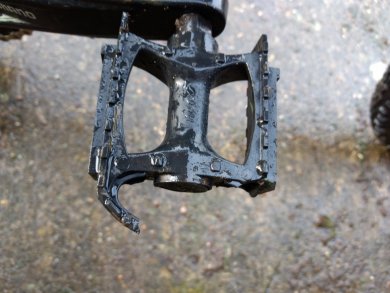

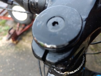

Hi . Had same with mine . When I clocked the huge holes in the box , I was just a bit gutted !
Luckily just the steerer cap marked . No other marks . Plastic pedal did snap first time out .
Vitus thicker cardboard , bubblewrap etc and you be golden ( or green ).

Yeah the top cap on mine was damaged identically. At some point it's been upside down through the spin cycle of the delivery companies.
I genuinely didn't think people really ever used those pedals, i'd have them as a second spare in the van as a loan set.. clearly just to that guy who always forgets stuff :)
I wasn't fussed about the Topcap as I was going to change it anyway.
