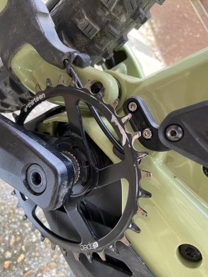

If it is only jumping off on the higher gears (I assume you mean the smaller gears on the cassette?) it may be that the chain is too long and the derailleur is not able to keep the chain tight.
I would shift it into the hardest gear (smallest sprocket) and see how much tension there is on the chain. With modern wide/narrow front rings and chain guides, dropping a chain these days it fairly rare.
I also assume in your photo the chain guide is up to show the condition of the front chain ring?

yes the smaller gears on the cassette. When I changed the chain I fitted the exact same chain, cn-m6100, and took out links to match. I’m not really sure what the tension should look like on the chain? How much movement should there be?
It would be good if you could answer Streddaz other question. I haven't known a chain to come off the chain ring with thick / thin teeth and a chain guide fitted. So long as the chain is under tension, that part should be right. Did you have the chain guide fitted and was it fitted correctly? It will be something like the picture below. One other thing, did you fit the chain facing right way (text outside) and joining link facing right way (long side trailing).
so the first time it happened I had removed the chain guide as it had come loose when out on a ride. But it’s happened multiple times since I refitted it, even with the new chain.
I noticed that it had bent the first chain and also a couple of the teeth on the chain ring. I’ve straightened the teeth out but they’re all so messed up now I fear it’s putting unnecessary wear on the new chain.
there's one part of your problem I think. With the guide fitted correctly it's hard to see how the chain could come off. Consider; the chain came off because the chain guide was loose. Now the guide isn't there, the problem continues.
Still there is more at play here - the chain guide shouldn't come into play unless there are other things at fault too. You're problem looks like a cascade of small things.
Is the chain fitted correctly to the chain ring - consider the thick / thin teeth;
Chain guide fitted and correctly adjusted - use thread locker while you're at it.
Chain facing right way (text on outside)
Joining link facing right way - long hole trailing.
Derailer clutch activated and working.
There may be some outliers we can't see, for example a bent chain or a bent chain ring or a damaged tooth or a damaged link. If you believe all I've listed is good, then tip bike upside down and work through the gears. Look for anything that doesn't look right or sound right. If you think something is wrong but can't pick it, take a video where you think something isn't right.
