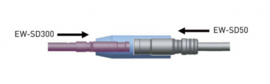

There a reason why the SMJC-41 is needed? Can't use just use an EW-AD305 conversion adapter instead?
If one wanted to drop the motor - hook up the COMPUTER -> PCE02 (has an EW-SD50 cable end) -> EW-AD305 adapter -> EW-SD300 cable -> EP8 Motor.
