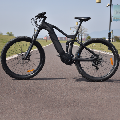

My CHEEB V2 will have it - looking forward to trying it out. Maybe it’ll match, or be stronger than then Bosch Gen 4!
