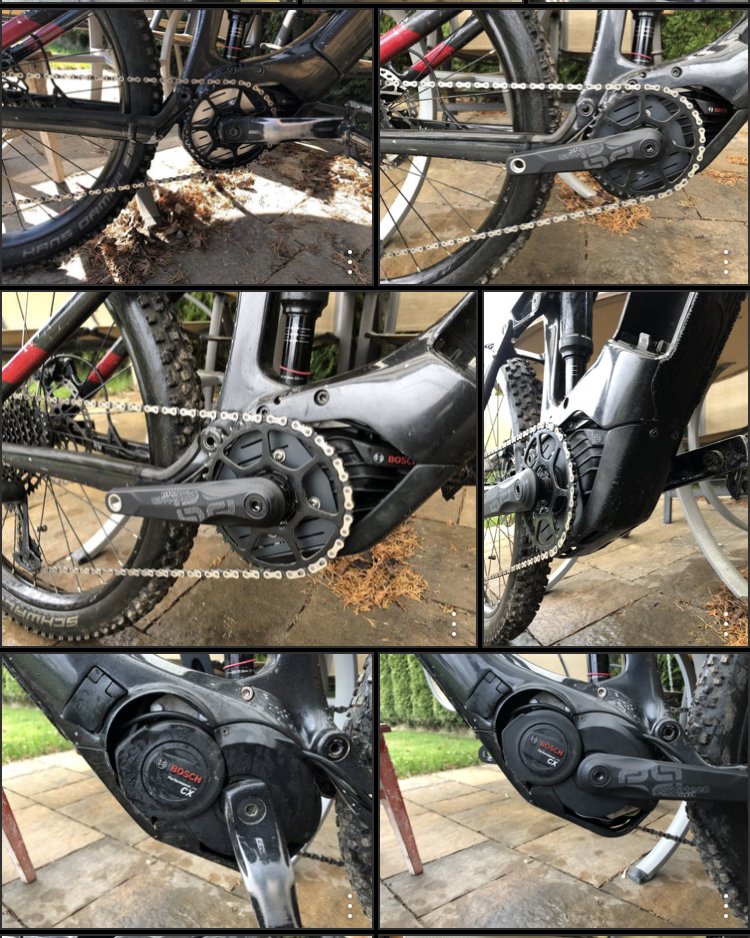

Hi, I’m in progress.
I’am not sure that will be work perfect. I will check it , I like it :)
Bike Trek Powerfly 9,7 lt plus 2019 in carbon.
Mount plates made from stainless steel 1,403 cutted on laser and milling.
Later I will design Alu covers.

first feeling - quite ok. but I was try found which motor is stronger, more aggressive. I think that gen2 is very good motor comparing with gen4. I have a good comparison ( two motors on the same bike). and I’m still thinking to go with this far or back to old. Because is not big different with power.
Old motor have some disadvantages.
Noisy / sharp start stops / heavier /

Little cutting left side cover.
New alu right cover will painted in black.

BTW, I wonder if the adapters would fit any bike brand, I guess they will, as the engine mount is the same, anyone has tried the adapters on a Lapierre?
Thanks. Here are adapters on my second bike trek Powerfly 9.9. Right, engine mount are the same.
