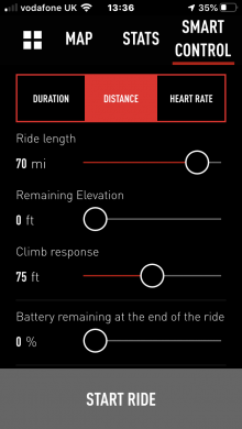

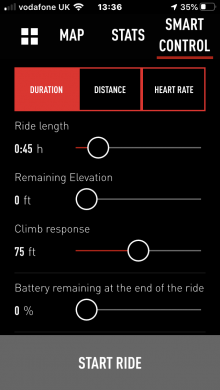

So today I thought I'd try the SMART CONTROL ! Phone charged and off we go .
50km's 800m's 2 hours with 10% left as parameters.
My MC doesn't allow those 4 options at once under Smart Control!!
Under the DURATION heading i have: Ride length (in Time terms), elevation, and Battery remaining (I'm ignoring 'Climb Response' for the purpose of this posting)
Under DISTANCE heading i have: Ride length (in Distance terms), elevation, and Battery remaining
I don't know how you're managing to set the ride length as a time and the actual ride distance at the same time.............. if you see what i mean! :)
But i'm a newbie to all this so i might have it wrong........only trying to give a bit back as I've learnt a lot from you guys!

So had a look now and you're right, you can't configure all those setting as I said under one option screen. I guess I thought they were optional and the more info you gave it between the screens, the more it would have to work with.
It appears that you can input the information on either screen, such as remaining elevation, and that information moves to the other screen if you change. However, the actual support provided is based on the last option screen you set things on - Duration or Distance.... (so I'm answering my own spesh questions :) )
Some example configurations, it also shows you the smart control level at the bottom based on the settings you've chosen - but says this will adjust dynamically, however, it gives you a guide.
So on Distance. 60k , no height .. no idea what climb response is, and 50% battery left at the end .. gives 20% support.
Throw in 900m climbing and you're down to 10% support.
Drop it to 10% battery remaining and you're at 15% support.
Increase to 2000m and you're back at 10% support.
Change to duration and have just over an hour to climb your 2000m, but with no set distance and you're back upto 15% support.

After trying blevo's various functions and egenesis to try and expand my range, I finally tried Specialized Smart Control.
Not sure why I've always ignored it ? Maybe because it's part of MC, which always seems slow to connect to the bike compared to Blevo so I don't bother with it. (like several minutes some times).
Anyway .. the OH said "Why don't you go out for a nice ride and enjoy the countryside and look around for a change" ...
After much bewilderment at her madness, I gave it a go.
Normally I max out at about 30km's max. Recently I've had a few less than 20km's, so did the Mission Control pre-set reset which seems to sort things out and get me back upto 40km's in Eco.
I have to say, everything felt really good. I thought it might feel like riding with the power off like my previous efforts to hit 50k. But it didn't. I'm guessing you can't use the eco/trail/turbo whilst it's in this mode (but might be wrong) and I'm also guessing that powerwise, it was like test riding a very very heavy Levo SL (I'm sure Spesh can confirm that from their figures).
After just under 40k, I still had about 40% battery left !!!! Never seen anything like that before, so headed off on a loop of the lake as I was already part way round.
Sadly, my phone battery went flat at about 45k. I think my torch must have come on at some point with the handlebar turning motion (you double karate chop for torch).
So I carefully limped home and rolled down hills for the last 15k and made it back with 7% left.
Probably one of the most overlooked functions and one which completely solves range anxiety !
So some Questions for @Specialized Rider Care on Smart Control.
When using the basic version (no heart control). You need to input distance, altitude to climb and time of ride.
I just guessed at these. Time for instance, I didn't know how much slower it would be so it's difficult to estimate.
So the question is, when inputting this information, which are the predominant variables it uses to calculate how much power to give you ? I ask, because you might not know all three with complete accuracy, so it would be important to focus on the most relevant one ?
For instance, If I put in 50k and only 100m climbing, would it let me use lots of power after I'd climbed 50m, thinking I was half way through ?
After 2 hours, 45k and 650m I had about 30% left. So does it use all of the numbers and try to make sure you can hit all of them ?
The second question. After I lost connection to the phone, I pressed mode down and it beeped, suggesting it wasn't in "eco".
If I'd not changed modes in the event of a phone disconnection, would the bike have continued to run with it's last known MC/SC settings ? So would I have been best not pressing anything to have a higher chance of reaching my destination ?
The third question. Due to the number of trees down, I had to walk away from the bike a few times with the phone in my pocket and lost connection. It didn't seem to auto-restart and when I checked my phone it asked if I wanted to continue the ride. Does it do this automatically after a pre-determined time, and if not, can it - or you might get "caught short".
I didn't have a clue where I was, so eventually the phone went on the bars so I could use the map :) Using the sun works fairly well, but when it's dense cloud/rain/hail .. it's less effective.
@Specialized Rider Care - I would be also interested to see answer on this post. Especcially to loosing connectivity of SmartControl. Regular after 5-10 min SmartControl turned off and went to ECO. Not sure if the issue belong to iPhone (7) or to a settlement. Are these issue known?
