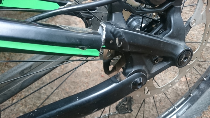

My new Levo Expert 2022 has a broken carbon swing after 160km.
The swing is broken on a forst way no Trail or Jumps...............
Thank you Specialized for thix High Quality!

Just take it back to the shop you bought it from as its still under warranty
Worst case Spesh will provide a new rear end, best case a whole new frame
The carbon rear end's on Levo's have been known to snap since 2019, i was warned against buying a 2020 s-works for that reason so went with a 2020 Expert (alloy rear end)
Nothing flicked up and hit the rear seat stay as you were riding along? big stone etc....
What rear brake is that? i wonder if it could of contributed the the seat stay snapping? i had a Transition Scout (alloy frame) snap in roughly the same place just riding along, Transition said it was due to the rear brake i was running, they replaced the rear end quickly

Hi,no stone etc.,the Brake is a Trickstuff Maxima with 203mm rotor strongest brake ever......
My other bike is a Levo Expert 2020 with Alu Seatstay and No Problem....

Frankly I think that's pathetic on Specialized's part. Even if he was over the rated max weight, snapping the bike so quickly is scary. I would never be happy getting any sort of air on this model.
And brakes size? The standard brakes can lock the back wheel up easily. I'm not sure how a larger rotor creates more force than that?

I asked if the shock was standard...which the OP confirmed.....simply because the seat stays move in an arc with suspension travel and for them both to snap at the centre of their length it suggests the suspension bottomed out.
I am not sure a more powerful rear braking force would add much additional force unless combined with the suspension being bottomed out.
Carbon does not always fracture immediately. More often the laminate is damaged without any visible signs but then fails subsequently.
This is the most likely cause, heavy rider and insufficient air pressure. Unless it was a Friday build.

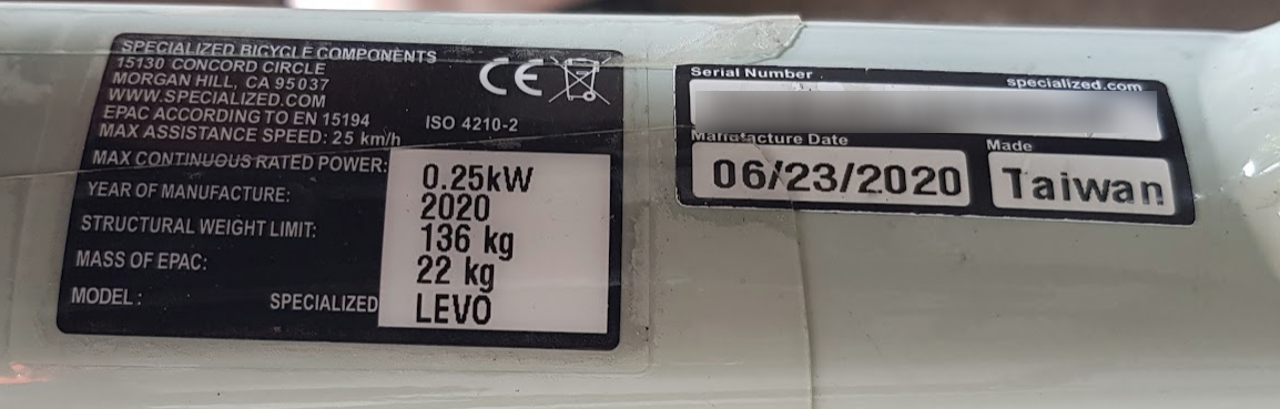

Any idea of what the weight limit of the '22 Expert is? On my 2021 Alu Levo Comp it says 136 structural weight, which is Specialized speak for bike, and everything it has to carry. Looks like I'm right on the limit, despite the LBS saying I still had some good margin with my weight. I don't jump, though, so not too worried.
There's a sticker right underneath the frame that tells you the limit:
It mentions EN 15194, which is the only ebike standard for such things and assumes a total weight (everything!) of 120kg, but was written for road and touring bikes, which are rarely jumped. No standards exist for eMTBs as far as I know.

I had a big crash and bent the same part you broke. The replacement is black and I don't care as I can't see it when I ride.
I can't imagine yours breaking while just riding along unless there were some prior damage. It's plenty strong for how it's designed until it gets smacked on the side
