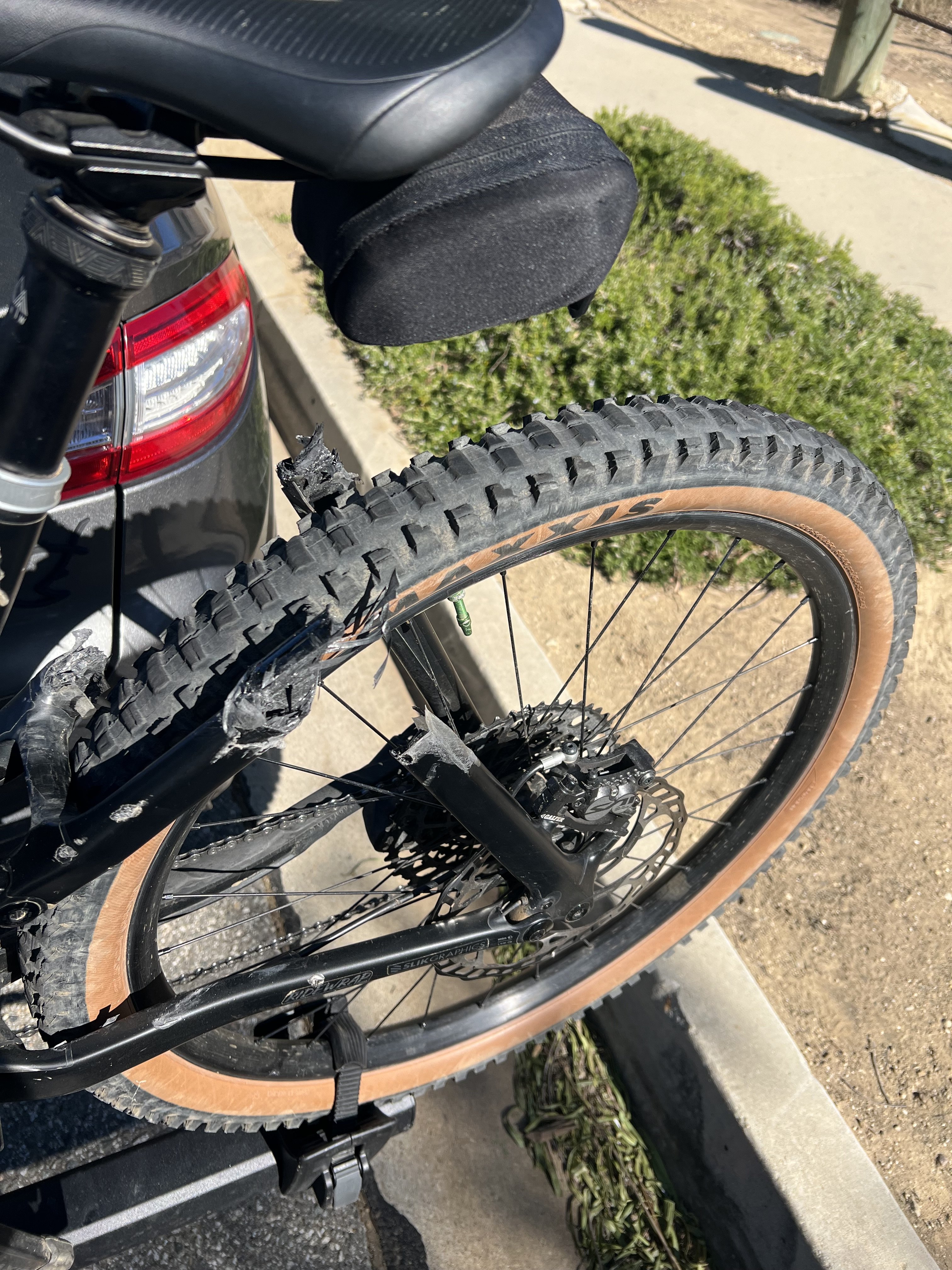

Levo Gen 3 My new Levo Expert 2022 has a broken carbob swing Thx Specialized

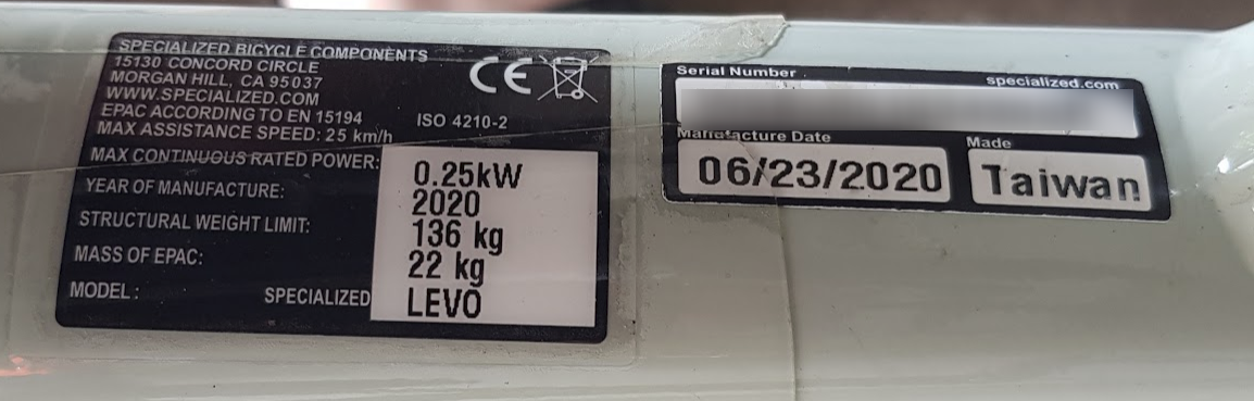

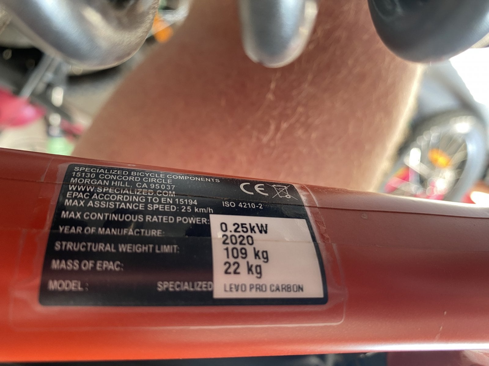

Any idea of what the weight limit of the '22 Expert is? On my 2021 Alu Levo Comp it says 136 structural weight, which is Specialized speak for bike, and everything it has to carry. Looks like I'm right on the limit, despite the LBS saying I still had some good margin with my weight. I don't jump, though, so not too worried.
There's a sticker right underneath the frame that tells you the limit:
It mentions EN 15194, which is the only ebike standard for such things and assumes a total weight (everything!) of 120kg, but was written for road and touring bikes, which are rarely jumped. No standards exist for eMTBs as far as I know.

How heavy are you? I have an expert which received a fair amount of abuse, and it's still holding. Although, I'll probably inspect it thoroughly after seeing pictures in this thread.

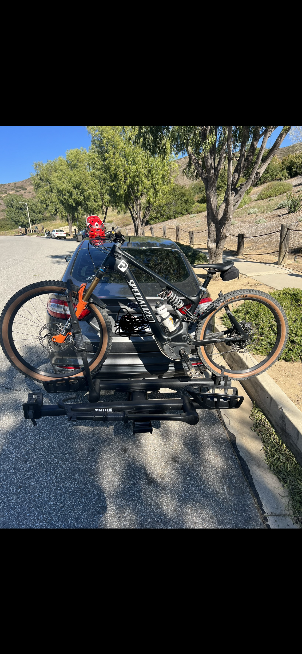

I am around 230 lbs (105kg). My local trails are rocky peak in simi valley as well as suicide trail in oak park. They are fairly rocky but the frame broke on a moderately chunky flow trail while I was doing around 25 mph (40kph).
The stress fracture could have been there from before and this occurred over time. With the chunky flow trail becoming the last straw.
E.g you could have cased a jump or took a hard landing where your shock bottomed out sending forces through the frame itself with the weakest part failing producing the stress fracture.
What spring rate is on the Push? A solid bottom out (or possibly plenty of bottom outs depending on spring rate) is a likely cause of the beginning of the end of those chainstays.
I have a feeling that this happens when you bottom out the suspension and the force has no where to go.

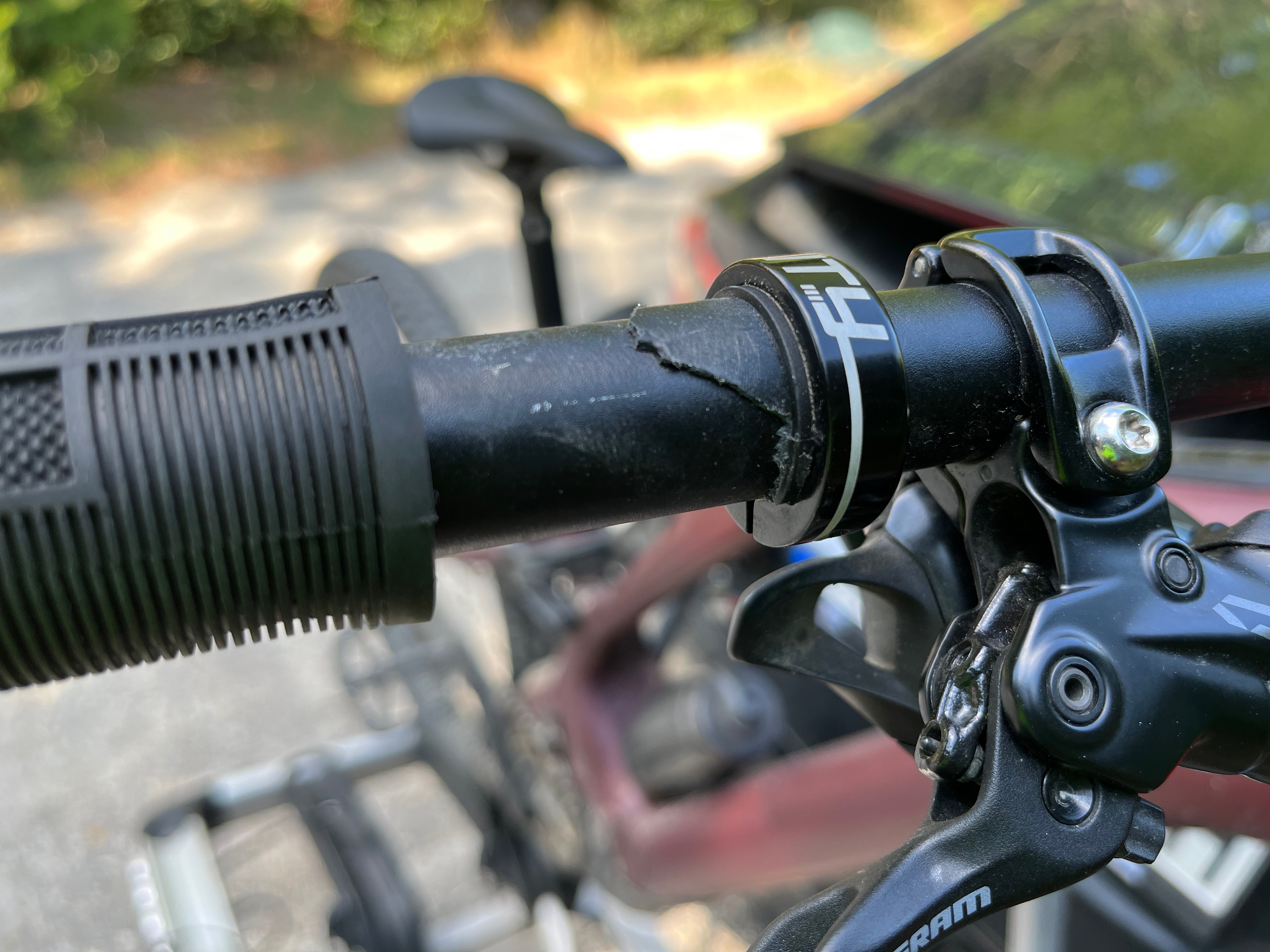

I had a fair amount of bottom-outs. Once, I cased a jump so badly that I ripped off both grips on landing. Fortunately, my Levo is still holding. I even inspected the rear triangle yesterday after seeing pictures in this thread 😅.
I am running 600lbs I believe or whatever is the biggest spring they make.
