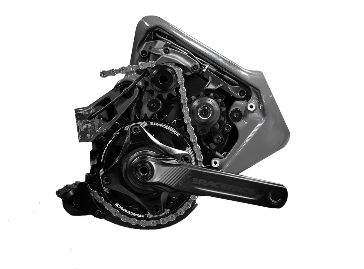

Rocky Mountain's in-house Dyname 4.0 is the quirky outsider of the mid-motor world: the motor sits above the bottom bracket and feeds the chain through its own sprocket, with a second sprocket reading chain tension to gauge rider effort. The result is a uniquely sporty, demanding character.
Dyname 4.0 eMTB motor
The Dyname 4.0 drive unit: the offset motor feeds the chain through its own sprocket, with a second sprocket reading chain tension as the torque sensor.

Rocky Mountain Dyname 4.0 is unlike anything else on the trail. Where Bosch, Shimano and Specialized bolt their motor concentrically around the bottom bracket, Rocky Mountain offsets theirs above it and drives the chain via a separate sprocket, using a second tension-reading sprocket as the torque sensor. On Velomotion's dyno it produced a measured 573 W of peak power and a measured 198 Nm of peak torque at the wheel — well clear of Rocky's own 108 Nm crank claim, because that 198 Nm is the figure after the motor's own reduction stage. It returned 183 W at a steady 100 W rider input.
That offset layout gives the motor an unusually direct, sporty feel, but it asks for commitment. Velomotion's verdict is blunt: "If you put little power into the crank, you will also get little power back." It rewards riders who like to pedal hard and punishes lazy spinning. The flip side is a beautifully natural, controllable power band and genuinely quiet running, helped by a lower motor rpm and the deletion of the old upper chain slider.
