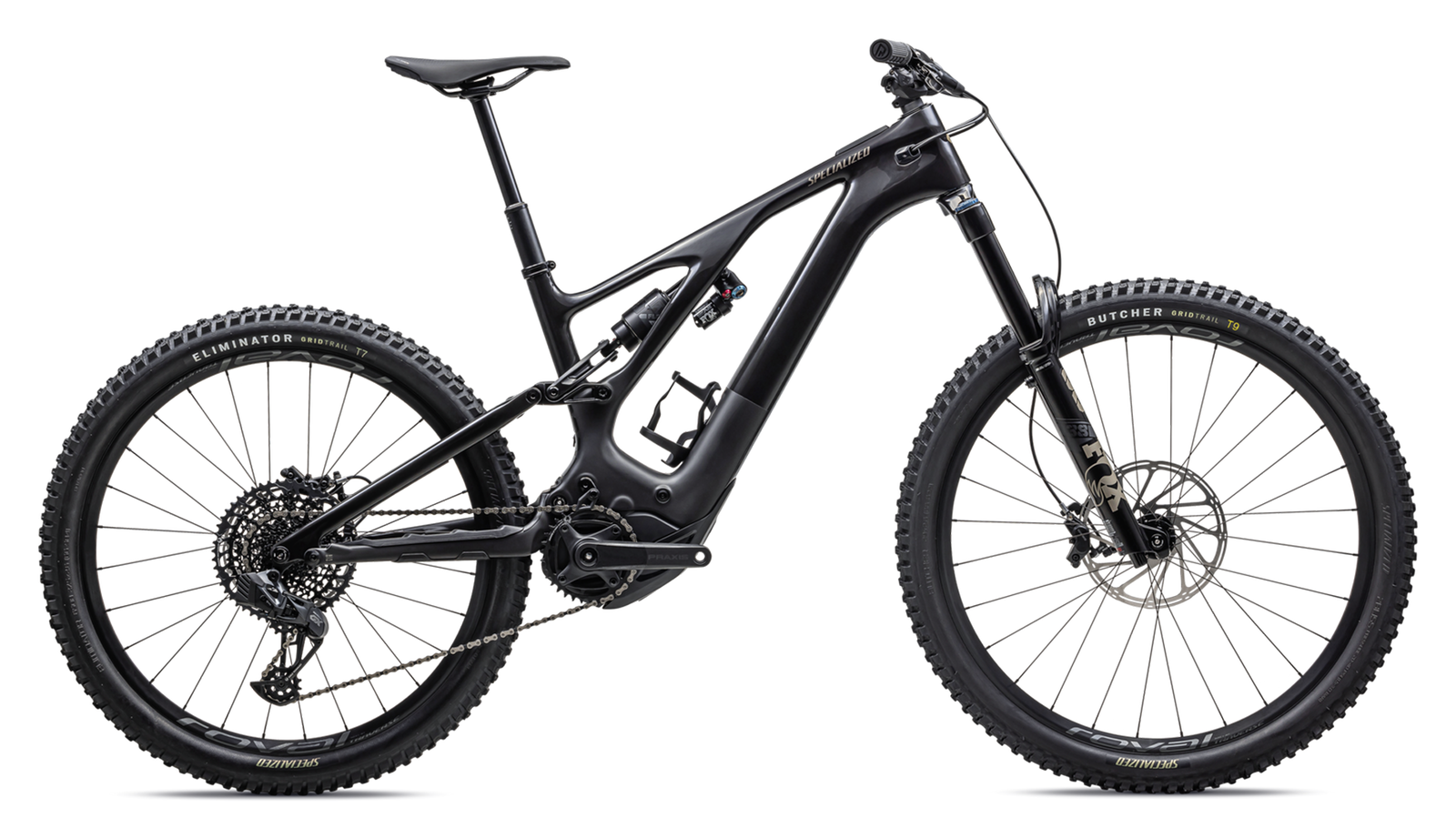

Specialized · Turbo Full Power (Levo Gen 3)
2.2
The Brose-built Turbo Full Power 2.2 was the quiet, belt-driven heart of the Specialized Levo Gen 3 (2022-2024) — a smooth 90 Nm full-power unit prized for its near-silent, organic delivery rather than headline numbers.
