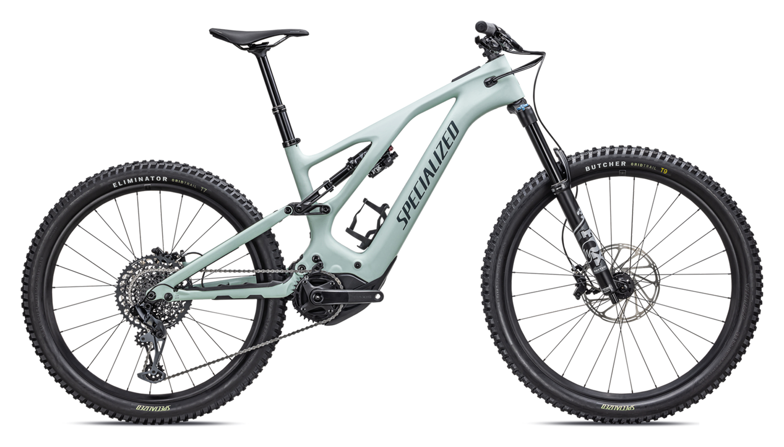

The 2024 Turbo Levo is the third-generation full-power Levo, built around the Specialized 2.2 motor (90Nm / 565W) and a 700Wh M3-700 battery in a mullet (29in front, 27.5in rear) chassis with 150mm of rear travel and a 160mm fork. It uses S-Sizing (S1-S6) so riders pick reach rather than seat tube, with a 64.5-degree head angle and a steep effective seat angle for a balanced trail position. Adjustable geometry lets the head angle move between 63 and 65.5 degrees and the BB up or down by 7mm.
The five-trim GB range spans the alloy Levo (M5 frame, RockShox 35 fork, SRAM SX) at the value end through the Comp Alloy and Comp Carbon (Fox 36 Rhythm, SRAM GX) to the carbon Expert T-Type (Fox 38 GRIP2, SRAM GX Transmission AXS) and the flagship Pro Carbon (Fox 38 Factory, SRAM X0 Transmission, Roval carbon wheels). All five share the same frame geometry and drive system, so the step-ups buy suspension, drivetrain and wheel quality rather than a different ride character.
This generation was discontinued in April 2025 when Specialized replaced it with the all-new Levo 4 (a higher-torque 3.1 motor platform). As a used or run-out buy the Gen 3 Levo remains a capable, well-supported trail eMTB. No verified owner-reliability data is recorded here.
