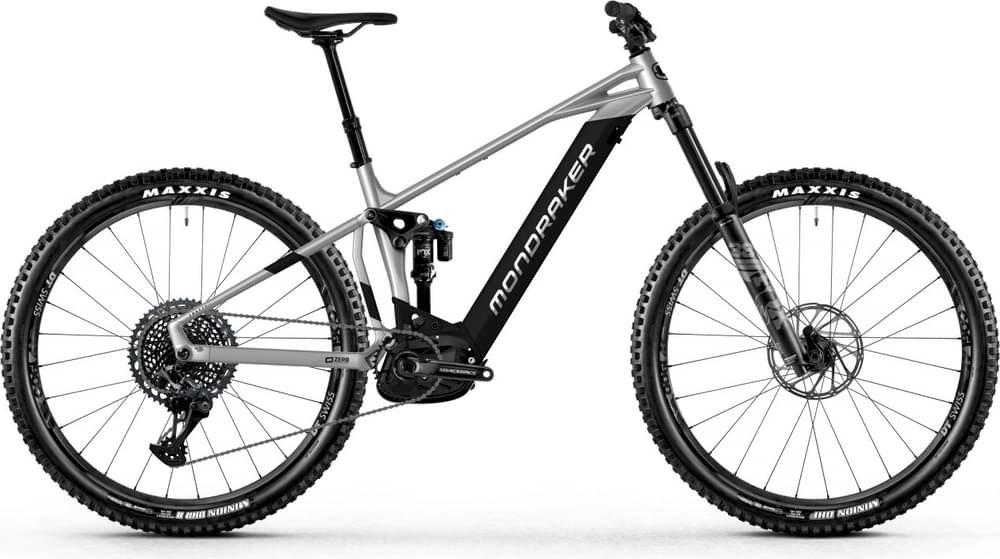

The 2022 Mondraker Crafty is the Spanish brand's full-power trail eMTB: a 29in machine running 150mm of rear travel through Mondraker's Zero Suspension System, driven by a Bosch Performance Line CX Gen 4 motor (85Nm) on the then-new Smart System platform with a 750Wh Bosch PowerTube battery across every trim. Mondraker's Forward Geometry philosophy shows in the long front centres, slack head angles and short 455mm chainstays, giving the Crafty a stable, planted character that leans towards descending confidence rather than nimble playfulness.
The seven-trim ladder splits two ways. Frame material steps from 6061 aluminium on the R, RR and XR up to a full carbon Stealth Air chassis on the Carbon R, Carbon RR, Carbon RR SL and Carbon XR. Fork travel splits too: the R, RR and the three lower Carbon builds run a 160mm fork, while both XR trims step up to a 170mm Ohlins RXF 38 with a matching Ohlins TTX Air shock and a correspondingly slacker, longer-travel geometry. That gives buyers a clear choice between the more trail-focused 160mm builds and the burlier, Ohlins-equipped XR variants.
Spec scales sensibly with price, from SRAM GX/NX Eagle mechanical drivetrains and Fox Performance suspension on the R through Fox Factory Kashima on the RR and Carbon RR, up to the flagship Carbon RR SL with wireless SRAM AXS shifting, a RockShox Reverb AXS dropper and carbon DT Swiss wheels. Maxxis Minion DHF/DHR II rubber and four-piston SRAM brakes are near-universal across the range.
The 2022 Crafty has since been discontinued and replaced by later Bosch-generation Crafty models, so it now sits as a used-market proposition. As a 150mm Bosch-powered all-mountain eMTB with proven suspension hardware and Mondraker's distinctive long-and-slack geometry, it remains a capable descender for riders who value stability over agility.
