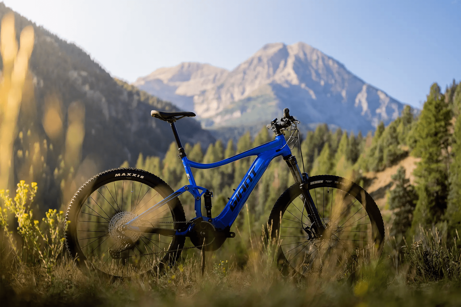

The Giant Stance E+ 2024 is the Taiwanese giant's budget-trail eMTB: an aluminium FlexPoint single-pivot chassis with 140 mm of fork travel paired with 125 mm out the back, Giant's SyncDrive Sport motor (Yamaha-built, 75 Nm of torque) and a removable 625 Wh EnergyPak battery. At a claimed 26.24 kg and a £3,199 base trim, this is one of the most accessible eMTB price points for a fully-suspended bike from a tier-1 brand. With a conservative 65.5 degree head angle and 468 mm chainstays it is firmly a trail and bridleway tool rather than a modern enduro contender.
Drive system and range. The SyncDrive Sport (Yamaha-built PW series, 3.48 kg unit weight) delivers 75 Nm of torque, modest by modern standards where 85–120 Nm is the new norm. @Kiwi Giant explains the platform is based on the PW-S2 drive unit with 7% more torque than the older PW-ST. The 625 Wh removable EnergyPak gives a reasonable but not generous real-world range — typically 800–1,200 m of climbing per charge depending on mode and terrain. Giant offers an EnergyPak Plus range extender for big-day capability.
Geometry and handling. A 65.5 degree head angle is conservative, trail-leaning rather than enduro. Reach progresses cleanly: 425 mm (S), 450 mm (M), 480 mm (L), 510 mm (XL). The 468 mm chainstay is held constant across all sizes — long for a 125 mm rear-travel bike and prioritising stability and climbing traction over playfulness. Wheelbase grows 1,204 mm to 1,301 mm. The handling profile is calm, planted and easy to live with — sensible for the bike's intended buyer.
Build and value. Only the £3,199 base trim is gold-listed. Stock spec on Stance E+ 2 platforms is a known compromise. @petro1head documents the as-shipped suspension: SR Suntour XCR 34 LO-R fork (140 mm, tapered steerer, 110x15 thru-axle) and SR Suntour Raidon R shock (190x45 mm). Both are entry-level — fine for the price but the consensus is that owners get genuine ride quality gains by upgrading. @sdrider details a comprehensive upgrade: a FOX 34 Factory Grip X (140 mm) drops fork weight from 2,526 g to 1,686 g (840 g saving) and a FOX Float DPS Factory shock adds another genuine performance step. @FL-Roadrunner went further on an earlier Stance E+2, swapping the stock 130 mm XCR34 for a FOX 36 E-optimized Factory at 160 mm — a major improvement for bike-park use.
Community-verified strengths. Affordability and accessibility are the headline strengths. @hemismith places the Stance E+ alongside Specialized Tero 3.0 and Scott Aspect eRide 940 as comparable 75 Nm-and-under value choices, with the Giant punching above its weight at the price. @Lancelot specifies the Stance E+ 1 Pro LTD as a recovery-friendly platform for riders with limited mobility, choosing Ergon GP2-L Evo touring bars for wider grip and edge turn-up. @anfos notes the practical service point that the rear brake cable runs under the motor on Stance E+ 2 — only the motor cover (not the motor itself) needs to come off to change it. @Kiwi Giant confirms a PNW Rainier Gen 3 30.9 mm dropper at 125 mm fits a roughly 6 ft rider.
Caveats and known gripes. Stock suspension is the biggest weakness — multiple owners (@sdrider, @petro1head, @FL-Roadrunner) recommend immediate upgrades. @sdrider notes a meaningful gotcha: fitting a PNW Loam 120 mm 30.9 mm dropper requires dropping the motor to route the cable under it; do not try to run the cable above the motor. The bike's 26.24 kg weight is heavy for the travel and category. The 65.5 degree head angle and 75 Nm motor are dated against 2024–2026 alternatives, and 26.24 kg is a lot for 125 mm of rear travel.
Verdict. The Giant Stance E+ is an honest entry-level eMTB: a tier-1 brand chassis, proven Yamaha-built motor, removable 625 Wh battery and a £3,199 price tag that makes full-suspension eMTB ownership genuinely accessible. It will suit first-time eMTB buyers on a tight budget, riders prioritising calm trail manners over aggressive descents, and anyone wanting the global Giant dealer network for support. Buyers who want a 120 Nm Bosch CX Gen 5 motor, a slacker head angle for serious descents, or factory-grade suspension out of the box should look at the Canyon Grand Canyon:ON 2026 hardtail at a similar price, or stretch to a Cube One77 trim. Production status: current.
