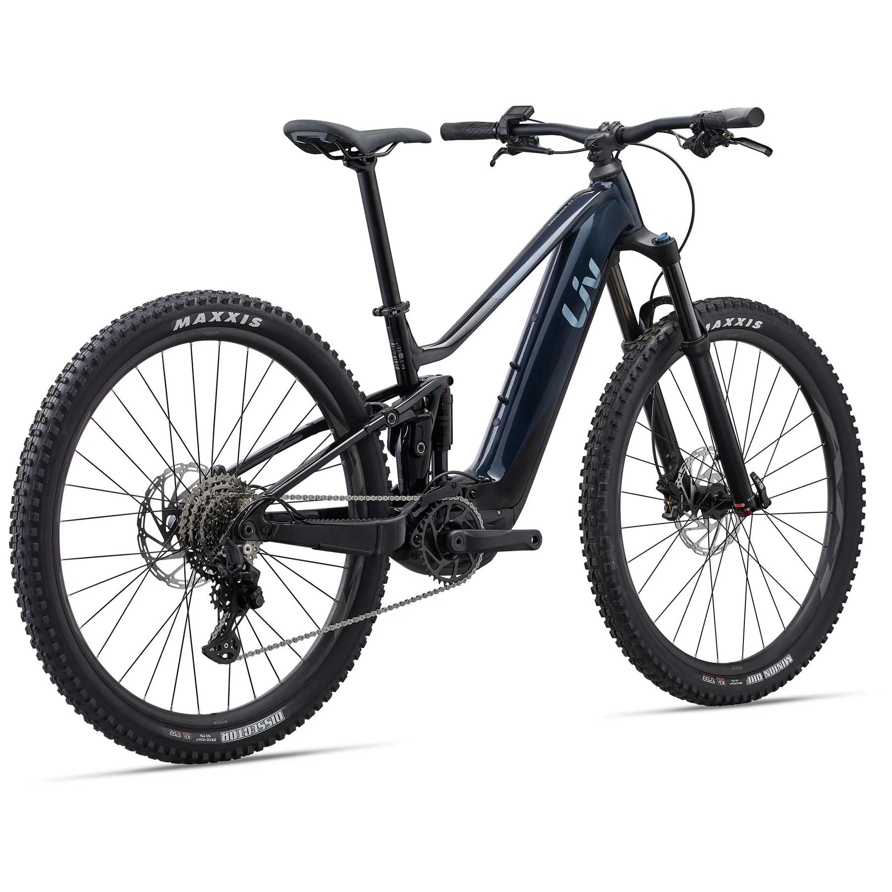

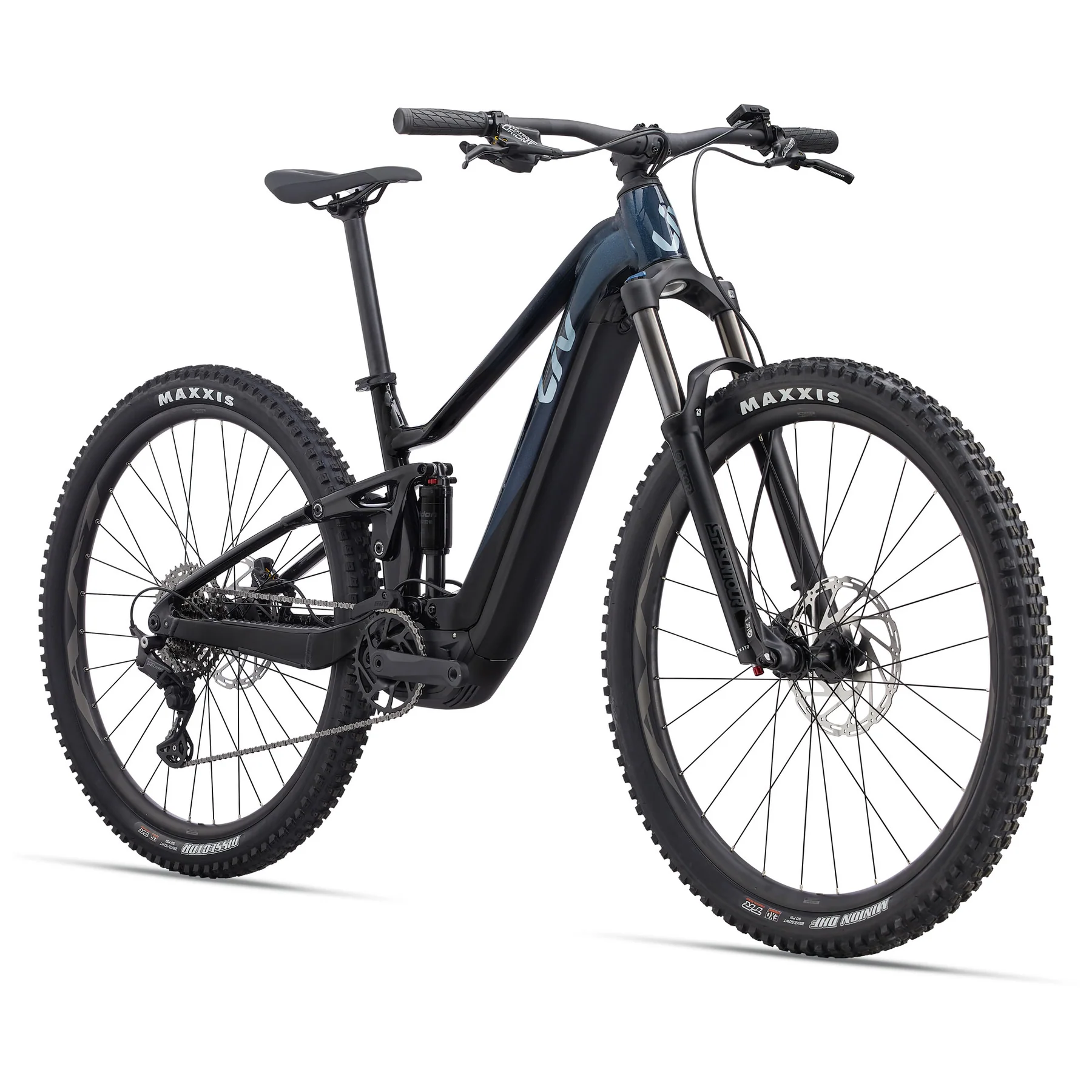

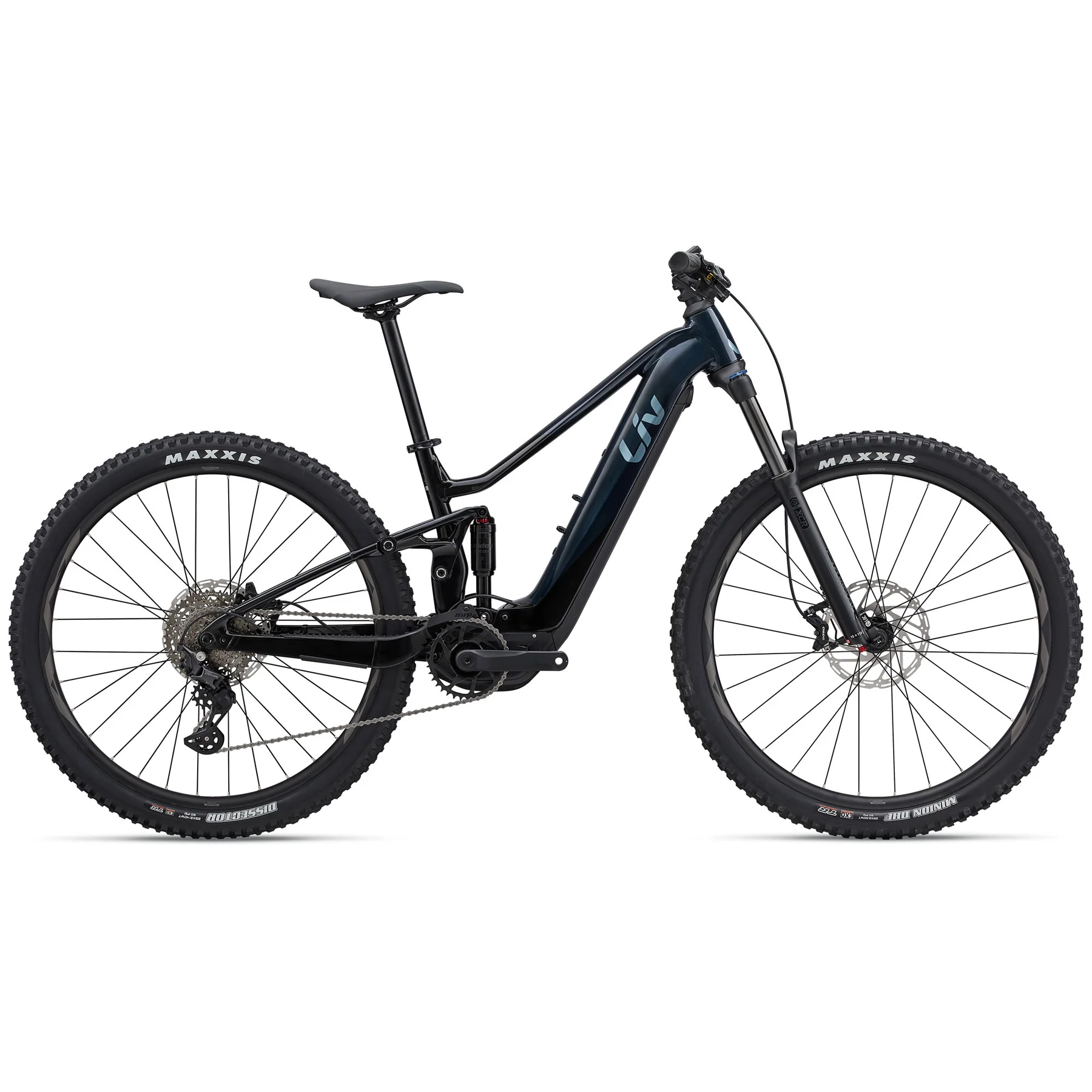

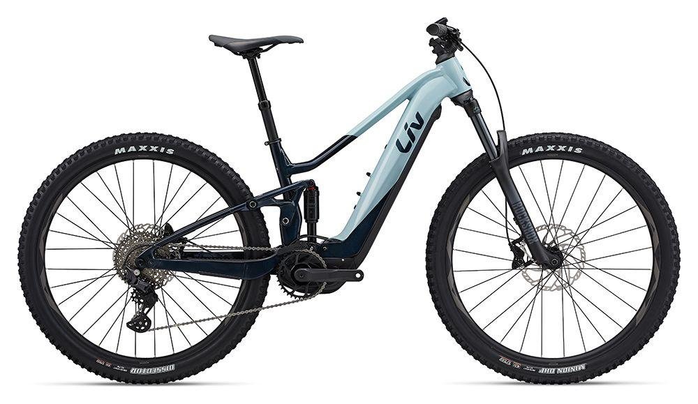

Frame
Frame: ALUXX SL-Grade aluminium, 125mm travel FlexPoint suspension system, 12x148mm thru-axle, UDH hanger
Fork: SR Suntour XCR 34 LO-R, 140mm travel, tapered steerer, Lockout, 110x15 thru-axle
Shock: SR Suntour Raidon R, custom tuned
Electronics
Motor: SyncDrive Sport 2, 75Nm, powered by Yamaha
Battery: EnergyPak Smart 625Wh EnergyPak Plus range extender compatible
Controls: RideControl Dash
Display: RideControl Dash, full colour lcd screen
Charger: EnergyPak 4A smart charger compact
Components
Handlebar: Giant Connect TR Riser 31.8mm
Grips: Giant Tactal single lock-on
Stem: Giant Contact
Seat Post: Giant 30.9mm, 2-bolt Micro Adjustable, alloy
Saddle: Giant Sport
Pedals: Aluminium Platform
Drivetrain
Shifters: Shimano Deore LinkGlide
Front Derailleur: MRP HD2 co-moulded chain guide
Rear Derailleur: Shimano Deore LinkGlide, 10-speed
Brakes: Tektro HD-M745 Orion, 4-piston, hydraulic disc, (F) 203mm, (R) 203mm
Brake Levers: Tektro HD-M745 Orion
Cassette: Shimano LinkGlide, CS-LG400-10, 11-43T, 10-speed
Chain: Shimano, LinkGlide, CN-LG500
Crankset: FSA Comet E-Bike crank arm setFSA MegaTooth Direct-mount 1X steel 36T
Wheels
Rims: Giant AM 29", Tubeless ready
Hubs: Giant eTracker Boost,
Spokes: Stainless steel
Tyres: [F] Maxxis Minion DHF 29X2.50"foldable, TLR, EXO, 60TPI [R] Maxxis Dissector 29X2.40"WT foldable, TLR, EXO, 60TPI
Other
Lock: Torx 25 Battery Lock with built-in Torque limiter
giant-stance-e-plus-2-2023-black-diamond-002_1800x1800.jpg View attachment 103333 qn5X5xmV0120Mtx54J73pTCVQ.png HKdof6ViBYt_xn_DRrYJ6_rUc.jpg

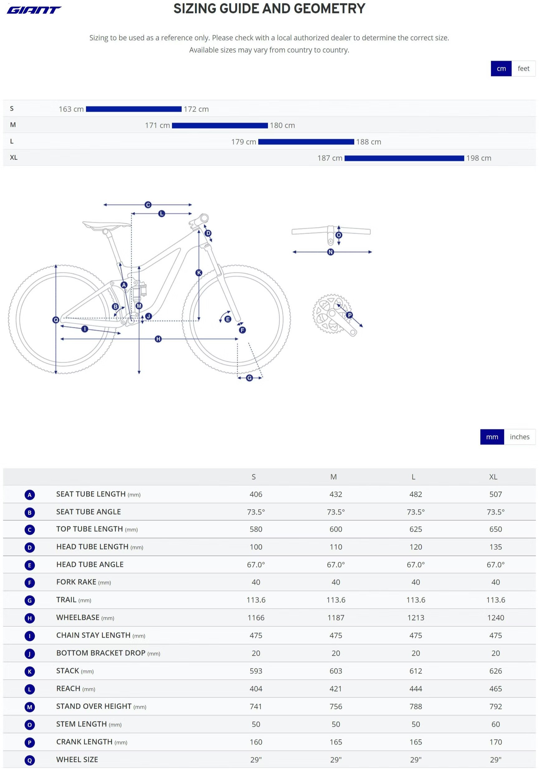

Motor is probably based on the newer PWX3 so smaller and lighter, the other big difference is new more modern geometry. I don't see the 2023 Stance or Embolden on the Giant NZ site?
