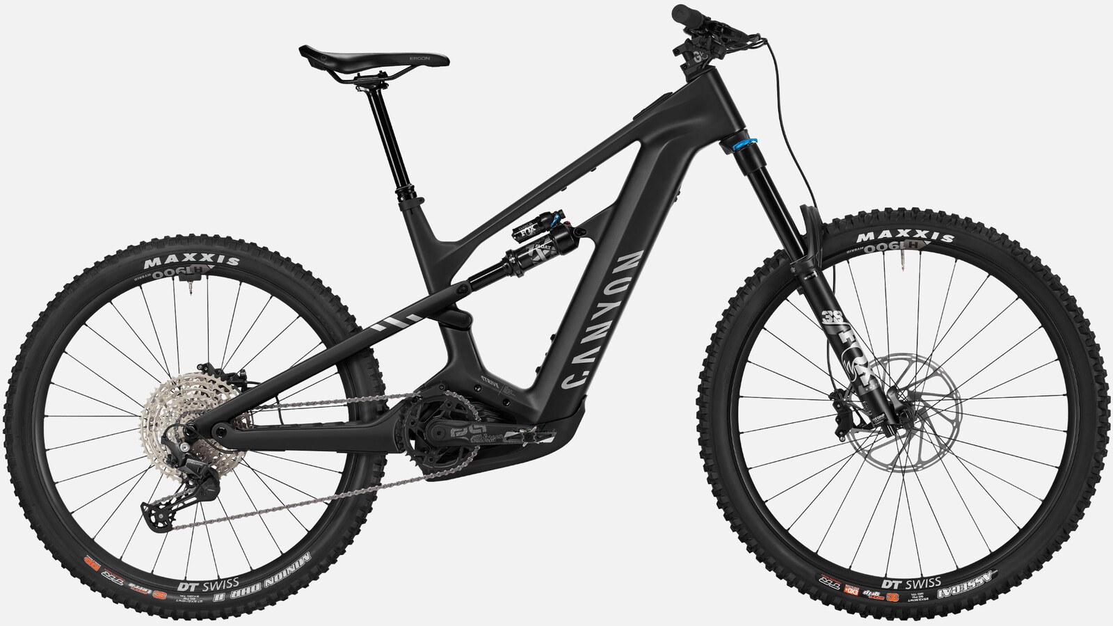

Canyon Strive:ON 2025
From £5,499
EMTB Forums verdict
The first-generation Strive:ON (2023–2025) was Canyon’s race-bred carbon e-enduro — developed with Fabien Barel for EDR-E racing and crowned BikeRadar eMTB Bike of the Year 2024. 170 mm front / 160 mm rear, mixed 29/27.5in wheels, and a clean, planted Triple Phase chassis.
Crucially, almost the whole range ran the standard Bosch Performance Line CX (85 Nm / 600 W) — the value-focused CFR Underdog (£5,499) and the award-winning CFR (£6,699). Only the flagship CFR LTD (£8,999) got Bosch’s CX Race Limited Edition motor (same 85 Nm but a 400% race assist mode and slightly lighter). It did not use the newer “CX-R” unit, which arrived later.
This generation is now discontinued, superseded in May 2026 by the new Bosch Gen5 (120 Nm) Strive:ON. Still a brilliant used buy if you find one — just know which motor a given trim has.

Frame
Strive:ON CFR carbon e-enduro frame, 2.45 kg (size M), reinforced to Category 4e test standards, 160mm rear travel, K.I.S. 2.0 steering stabilizer integrated in top tube
Bike geometry diagram
SMLXL
Reach450 mm475 mm500 mm525 mm
Stack628 mm637 mm646 mm660 mm
Chainstay445 mm445 mm445 mm445 mm
Headtube Angle63.5°63.5°63.5°63.5°
Seattube Angle (eff)78°78°78°78°
BB Drop25 mm25 mm25 mm25 mm
Wheelbase1245 mm1274 mm1304 mm1336 mm
Headtube110 mm120 mm130 mm145 mm
Standover772 mm777 mm782 mm788 mm
Front Centre800 mm829 mm859 mm891 mm
