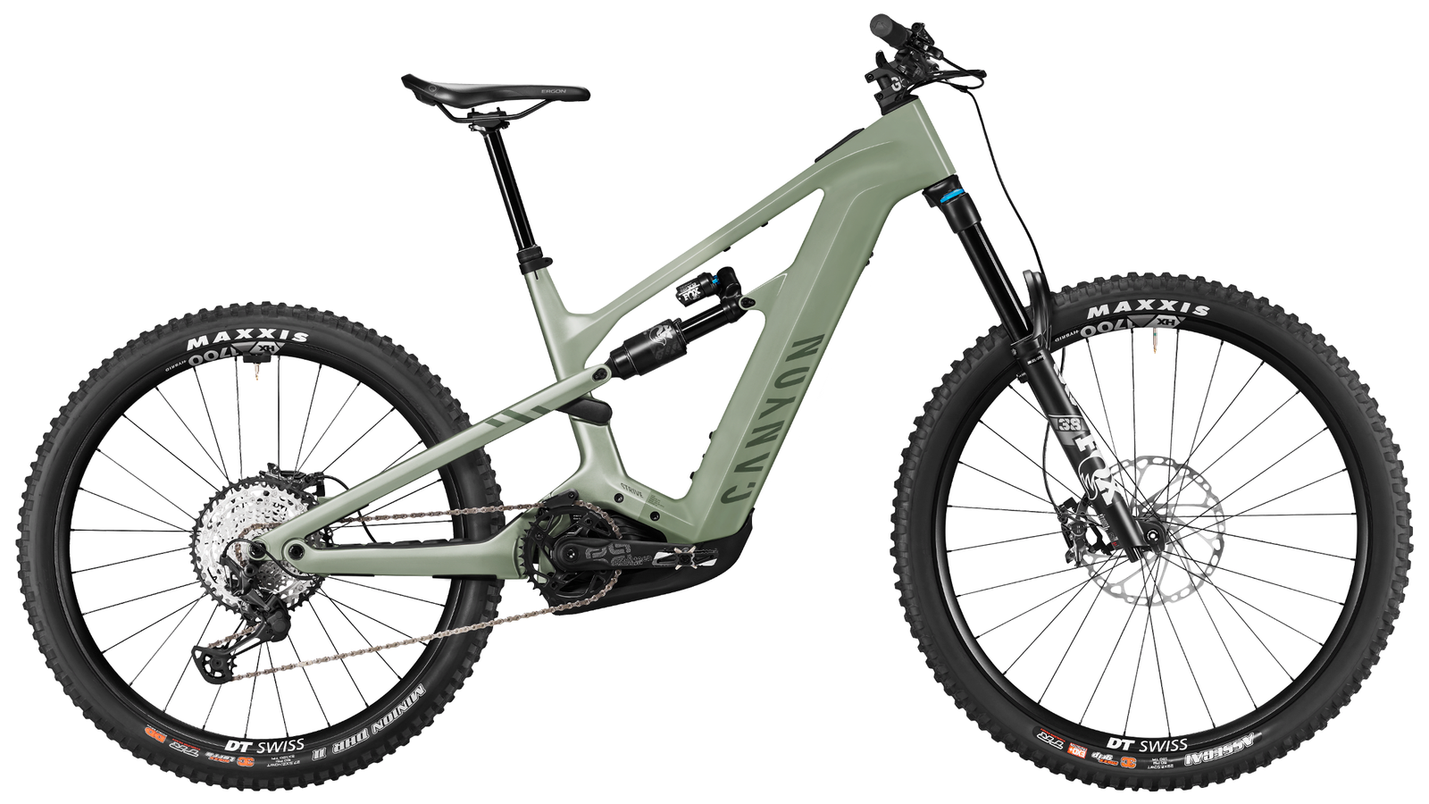

Canyon Strive:ON 2023
From £5,499
EMTB Forums verdict
The 2023 Strive:ON was Canyon's first electrified Strive: a full-power e-enduro race bike built only around the flagship CFR carbon chassis. It pairs 170 mm of fork travel with 160 mm at the rear and runs a mullet wheel setup, a 29in wheel up front and a 27.5in out back, driven by Bosch's 85 Nm Performance Line CX motor with a removable PowerTube battery offered in 625 Wh or 750 Wh.
Geometry is firmly race-focused: a very slack 63.5 degree head angle, a steep 78 degree effective seat angle, a constant 445 mm chainstay and reach growing from 450 mm on the S to 525 mm on the XL across four sizes. The range opens with the CFR Underdog at GBP 5,499 (Fox 38 Rhythm, Fox Float X, SRAM DB8, Shimano Deore), steps up to the CFR at GBP 6,699 (Fox 38 Performance Elite Grip2, Fox X2, XT brakes and drivetrain), and tops out with the CFR LTD at GBP 8,999, a 23.1 kg build with a RockShox Zeb Ultimate, SRAM X0 AXS Transmission, Pirelli Scorpion tyres and the lighter Bosch Performance Line CX Race motor.
This first-generation Strive:ON has since been discontinued and replaced by later Strive:ON models. It remains a focused, carbon-only e-enduro race platform with aggressive geometry and a strong spread of three builds.
