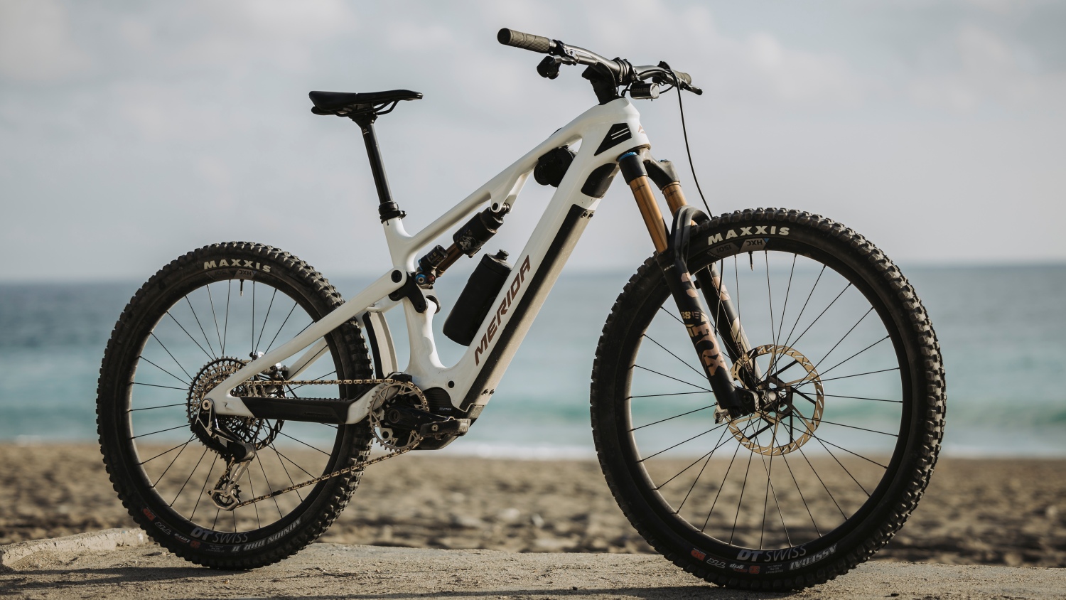

Launched back in 2017, the original Merida eOne-Sixty was a revolution to me. New, compact motor designs allowed manufacturers such as Merida to design a frame with sensible chainstay length and bottom bracket drop. This did wonders for handling on the trails.
The new eOne-Sixty isn’t as revolutionizing. Still, Merida has done a lot of changes. I was sure the new eOne-Sixty would be launched in 2023, but it kept getting delayed. And when it was finally announced, Cannondale beat them by a week with a few significant similarities.
2024 Merida eOne-Sixty LITE 875
2024 Merida eOne-Sixty CF 10K
Just like the recently announced Cannondale Moterra SL, the eOne-Sixty has the Shimano EP8 (801) motor. It doesn’t end there, the Merida eOne-Sixty also has got flexstays and an internally fixed 600 Wh battery. Making both bikes light for a big battery, big motor emtb. But they’re also quite different. The Merida is a burlier bike with beefier components and longer travel. Check it out in this video or keep on reading.
Flex-stays​
Looking at the rear triangle, you might notice the pivot point near the rear axle is gone. The new flexstay design named “P-FLEX” allows the rear frame to flex as the suspension compresses. Merida says the new rear suspension design is tuned for more progression to work well with the new high-volume air-shocks and even coil-shocks. Suspension progression is higher for the bigger frames, ranging from 8 for the smallest frame to 16% for the biggest.
Carbon P-FLEX rear frame
Alloy P-FLEX rear frame
The first part of the travel has over 100% anti-squat, which should make for a stable and efficient pedaling experience. Around half-way into the travel, the anti-squat drops below 100% and becomes more active over bigger impacts. Anti-rise has been reduced compared to the previous model. The new eOne-Sixty rear suspension should be more active under braking while still ramping up towards the end of the travel.
The kinematics are the same for both the carbon and aluminium frames. And that seems plausible, the stays probably don’t need to flex much. I like the idea of flexstays, less moving parts and less maintenance is good. And it’s probably less weight too. I expect it will work well, Merida has been using flexstays on the latest non-assist One-Sixty that has been out for a while.

The new frame is longer, lower, slacker, as expected. You might know I prefer chainstays of about 445 mm, or slightly above. And I think 64.5* is a nice head angle for a down hill capable trailbike. It’s no wonder I was happy reading the geometry table showing 446 mm chainstays and 64.4* head angle. The frame in size Large, I mean Long, has a wheelbase of 1.266 mm. There are longer frames around, but this seems perfect for a capable descender that wants to work well on flatter trails too. The 78.4* seat angle is properly steep. 9 mm bottom bracket drop doesn’t seem a lot, but it isn’t tall considering the rear suspension travel has increased drastically.
Geometry is the same for the alloy and carbon Merida eOne-Sixty
Geometry changes over the previous model
A burlier mullet bike that can be converted to a 29er​
The eOne-Sixty has been a mullet bike with 155 mm rear travel for years. The 6 mm increase in chainstay length is a sign the new model will fit a 29er rear wheel. In the default, mullet setup the eOne-Sixty now has a whooping 174 mm of rear travel. There is a flip chip on the rocker that drops the rear travel to 160 mm and makes room for the 29 inch wheel. The fork travel has been increased too, up from 160 to 170 mm. It seems the new bike is a more capable descender while not giving up on its pedigree as a great allrounder.

The motor is a powerful one that weighs about 2,6 kg. I think this is a good choice for a lighter full-power bike. It seems the updated Shimano EP8 (EP801) is quite durable too. Here’s more on the motor:
The new 600 Wh battery is fixed inside the frame. Unfortunate, or too little, some will say. But it’s not that surprising. The carbon eOne-Sixty always was the lighter weight, high-performance option. And internally fixing the battery saves weight. Labeling it 600 Wh is a bit confusing, but it seems it's because of some new EU legislation. The battery has the new 5,8 Ah (21700) cells making it 626 Wh. That’s about the same capacity as the old carbon model while being lighter, more than half a kilo is my guess.
