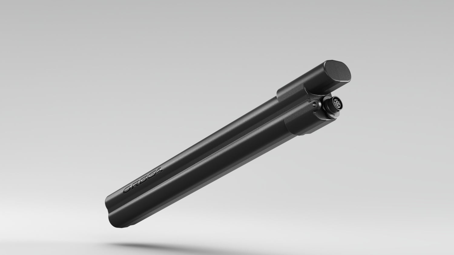

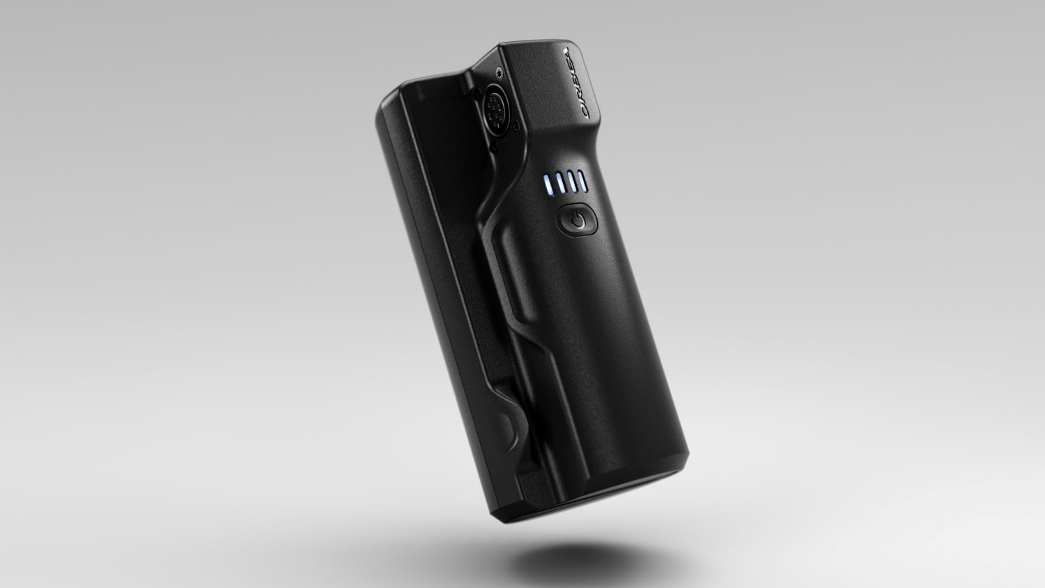

The new 420 Wh battery

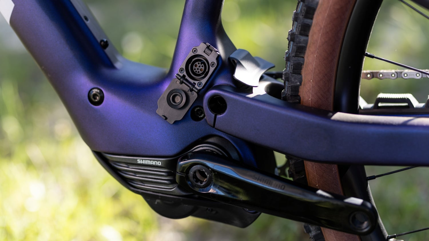

The 630 Wh battery combined with the range extender
The 210 Wh range extender battery has a claimed weight of just 1.1 kg.

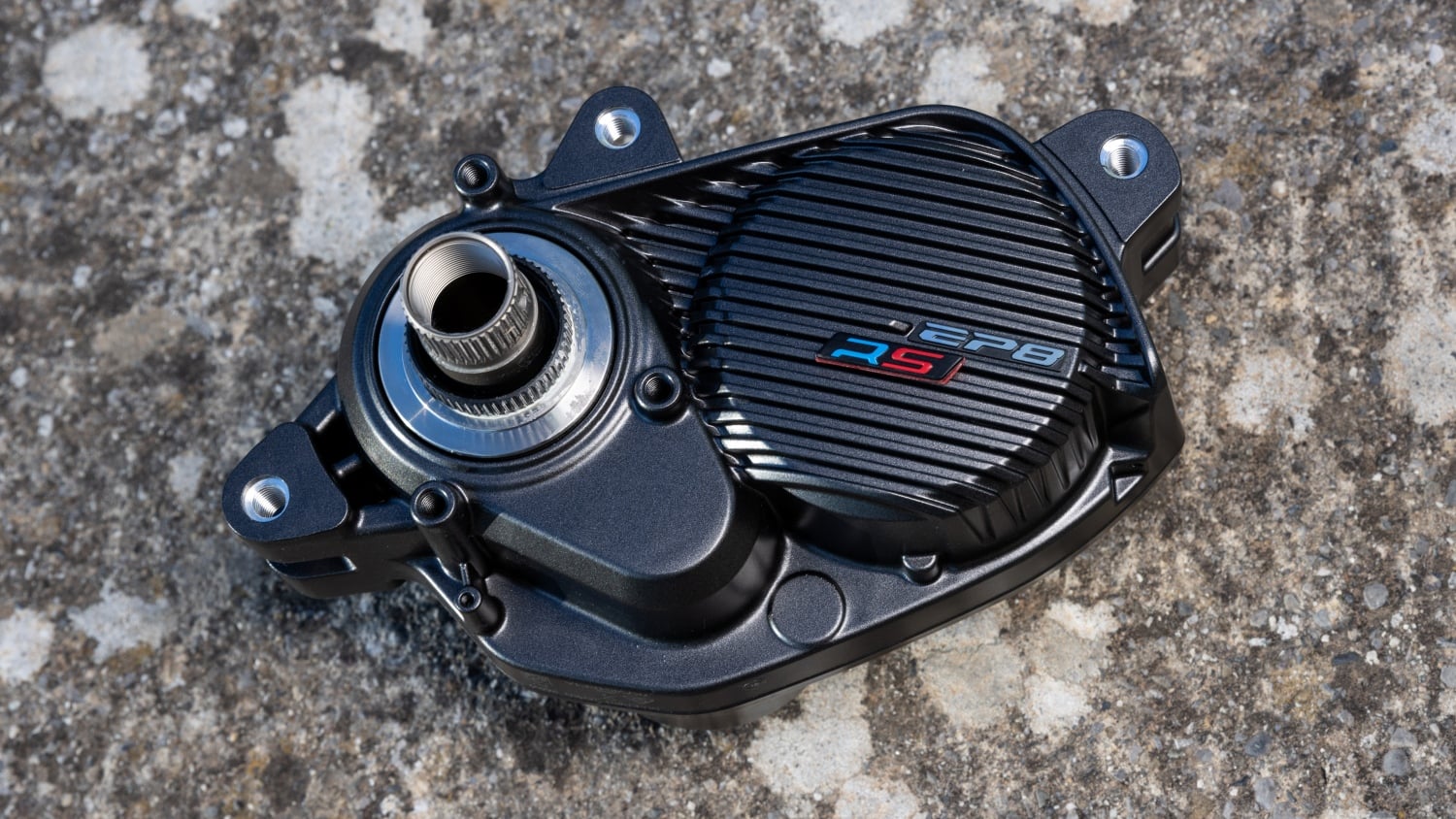

The new Shimano EP8 RS gen2 motor
How can you tell this is the new Shimano gen2 RS+ motor? The S is red.

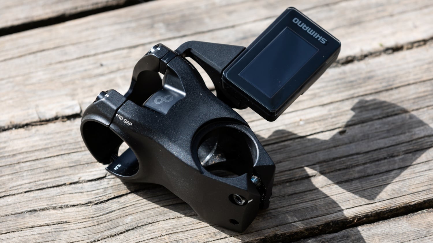

Orbea attaches the Shhimano display to the stem. Photo: Jérémie Reuiller

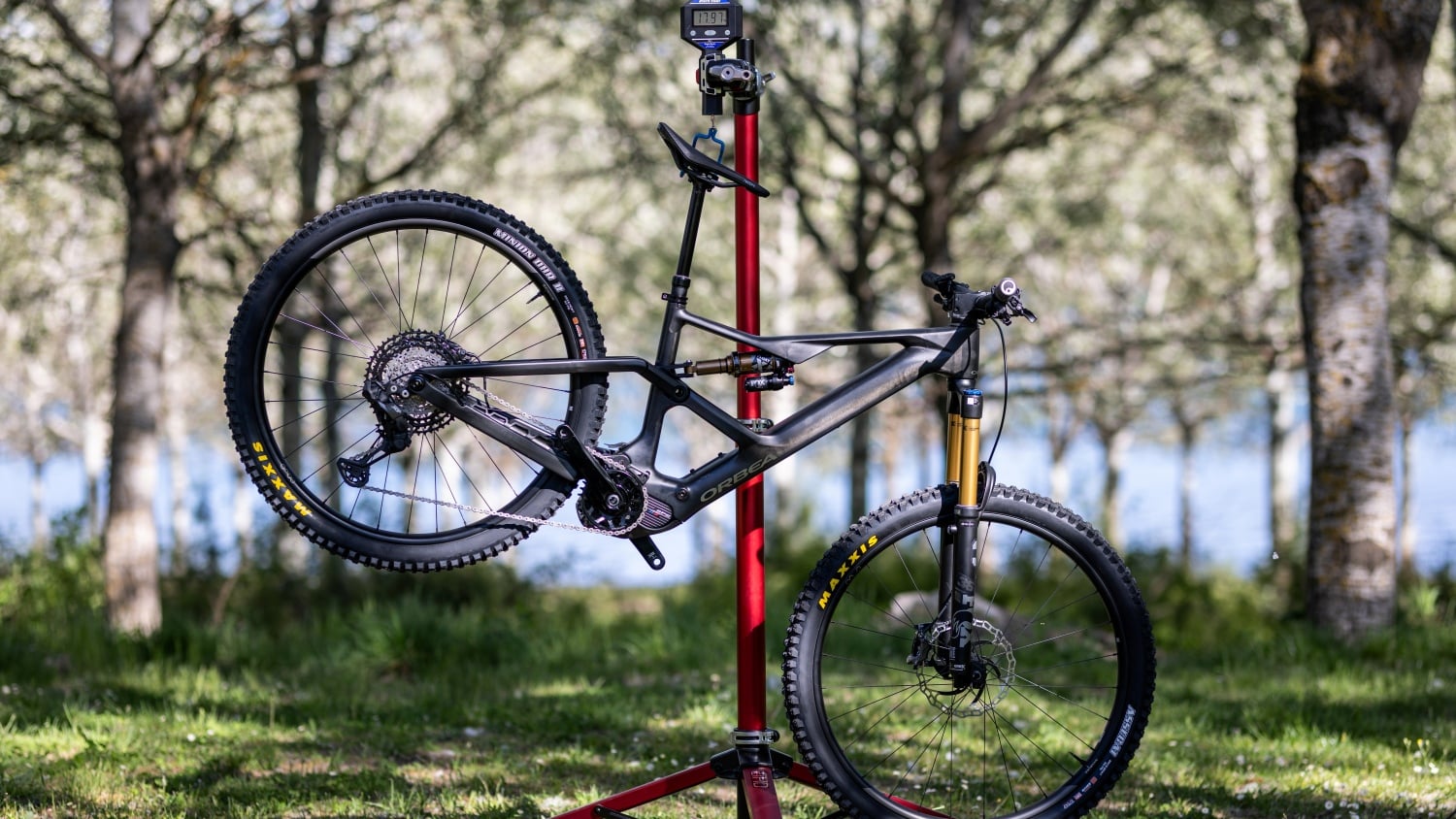

I haven’t ridden one yet, but “Rob rides emtbs” has. The new EP801 RS gen2 feels powerful and Rob doubts many will miss the extra peak power. When riding at below max power, it feels as generous as the EP801.
Rob weighed the lightest Rise SL M-LTD 140mm to 16.26 kg in size XL. And frankly, that’s lighter than necessary for his riding. The heavier Rise LT feels more stable and more familiar. A mild emtb doesn’t have to be superlight, perhaps the sweet spot is around 19+ kg? See Rob’s video for the full story.

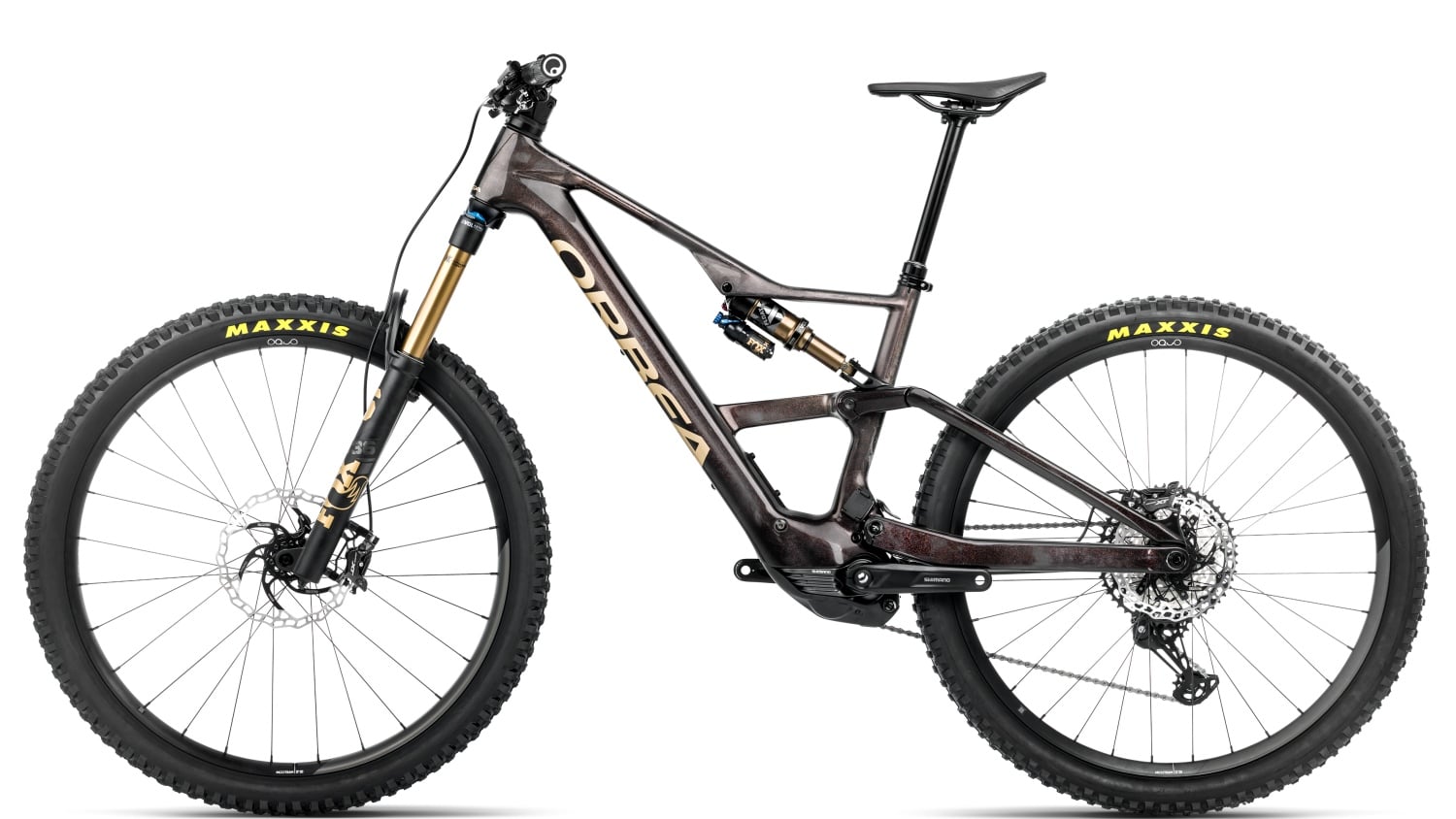

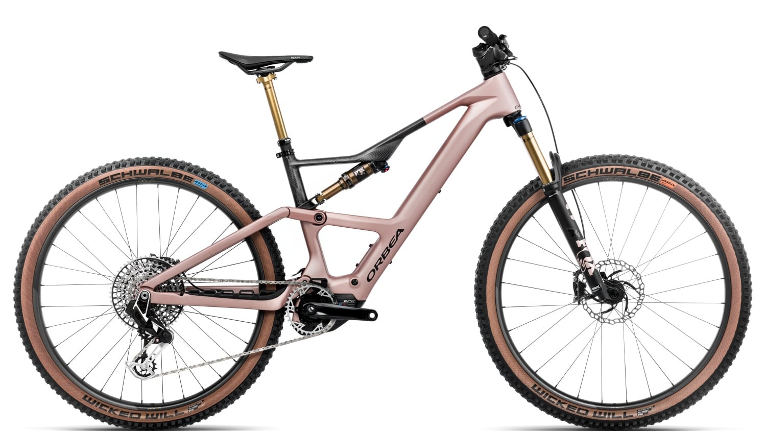

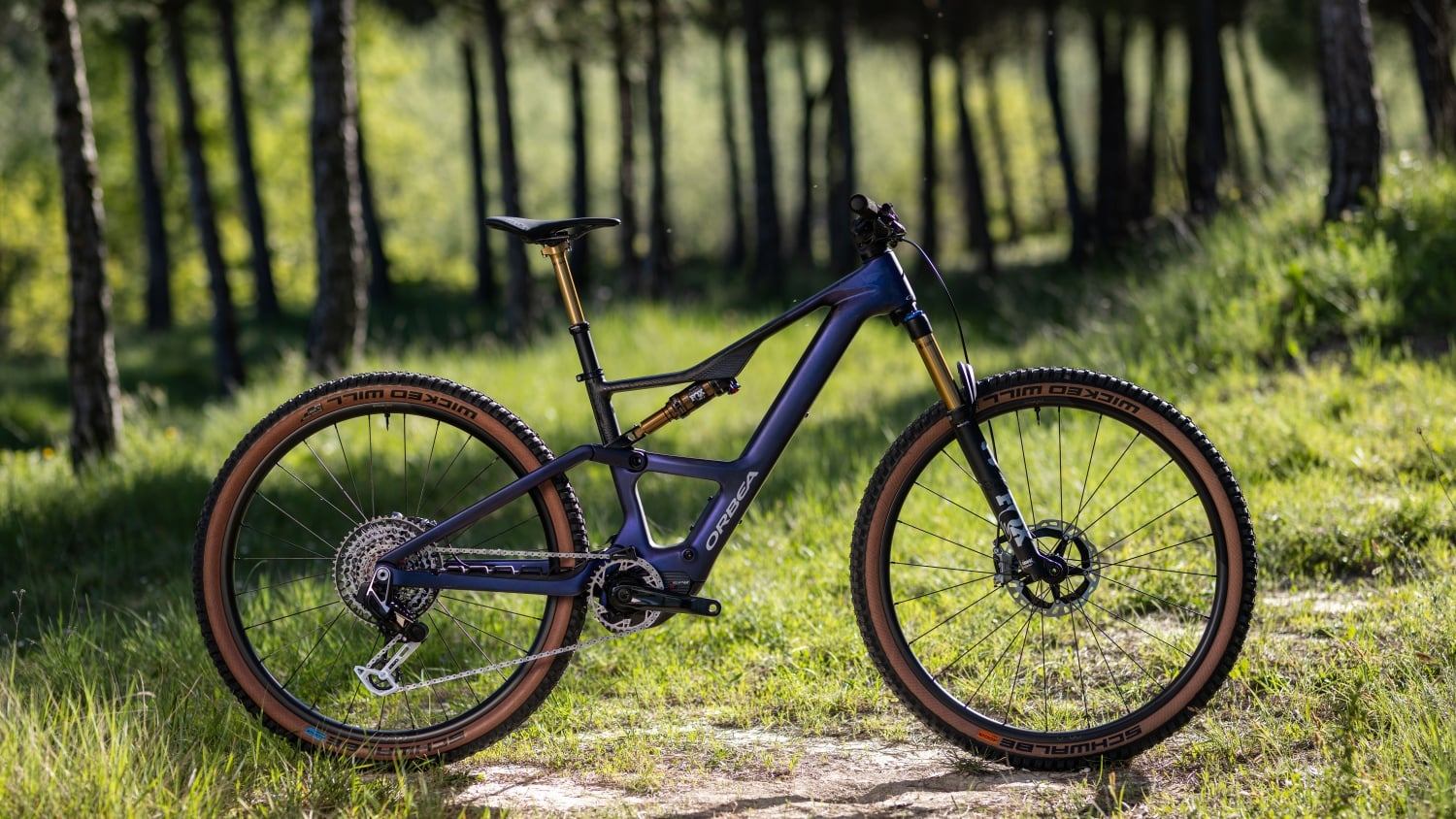

The Orbea Rise SL M-LTD and M10 look very much like the previous Rise with 140 mm rear travel. And I’m happy Orbea is still offering a mid-travel Rise. I think the handling of the 140/140 travel 29er Rise was quite special. The lower font end and bottom bracket gave it a nice connection to the trail. I felt like I was flying low and fast over the dirt and pine needles.
The shorter travel Rise head angle is down by 0.5* to 65.5*. Depending on frame size, the wheelbase is up by 13-24 mm. The bottom bracket drop of 37 mm is barely altered. Chainstays have shrunk by half a centimeter to end up at 440 mm. While the frame geometry is relatively similar, it seems more modern.

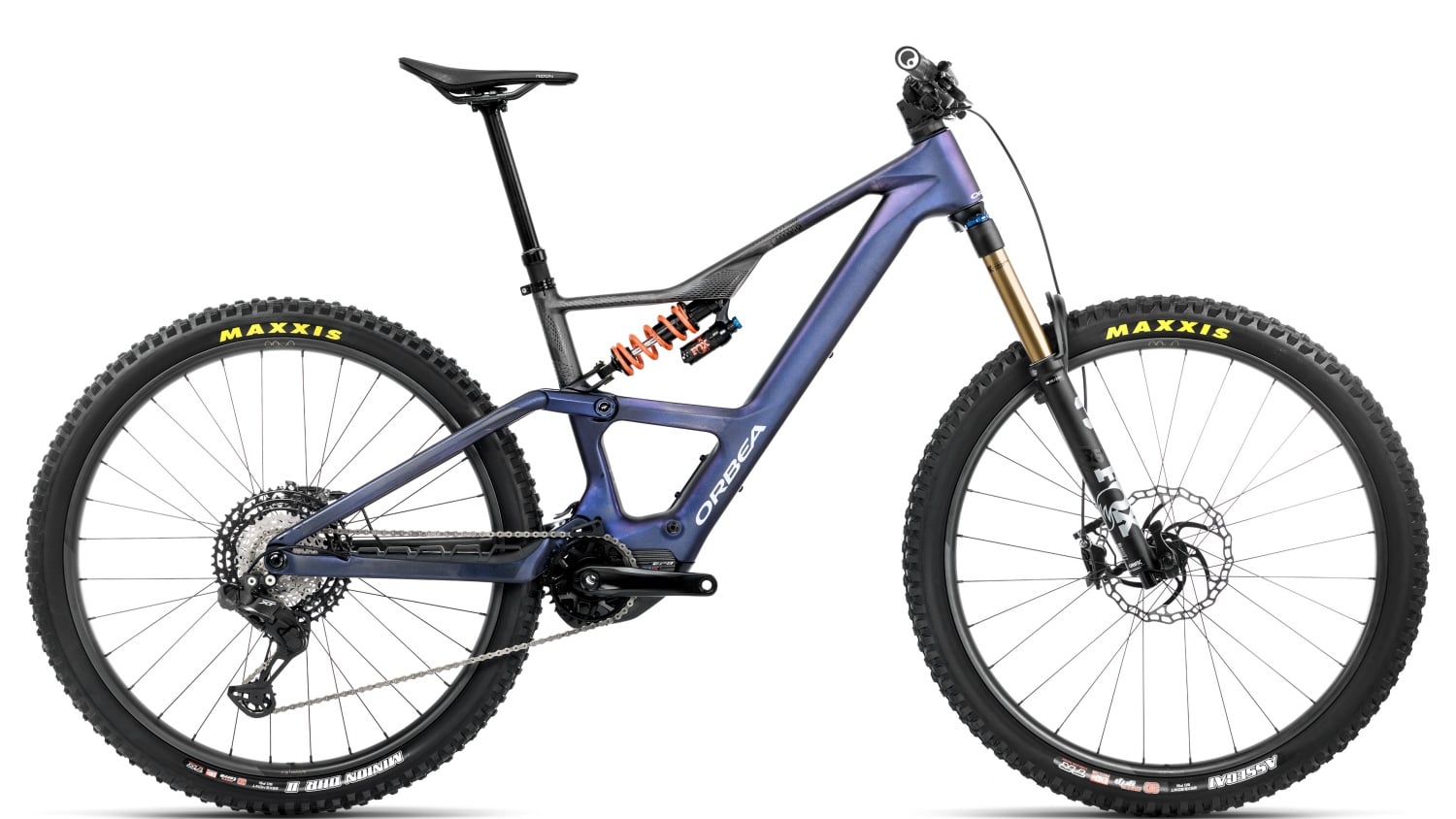

I’m quite excited to see the old 150 mm forked models being replaced. To me, they fell between two chairs, or categories. Adding a 10 mm longer and burlier fork didn’t make it that much more capable on the descents. It seems Orbea very much fixed that with the new LT. They bump the travel up to 160 mm front and 150 rear while keeping the 29er wheels. The weight remains low with the M-Team weighing in at 17.97 kg.
The Rise LT M-Team is lass than 18 kg, barely.

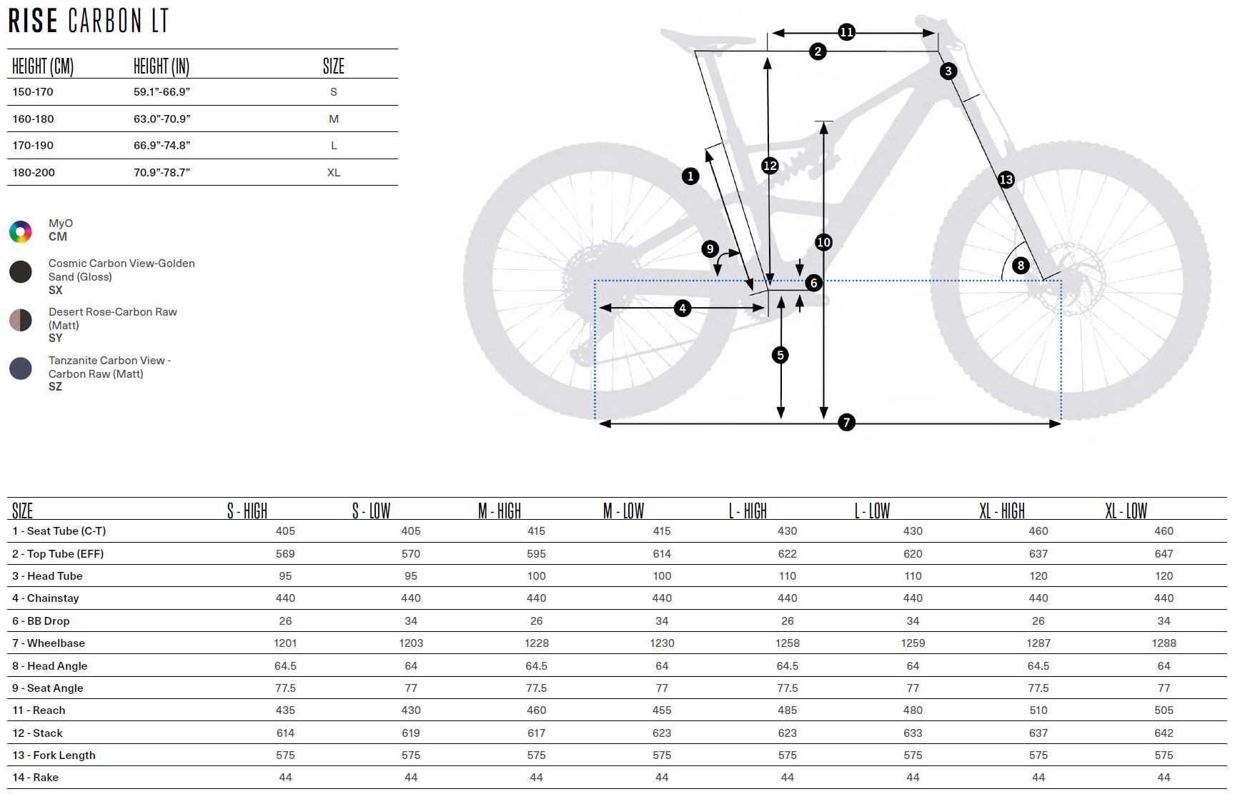

Orbea Rise LT carbon geometry

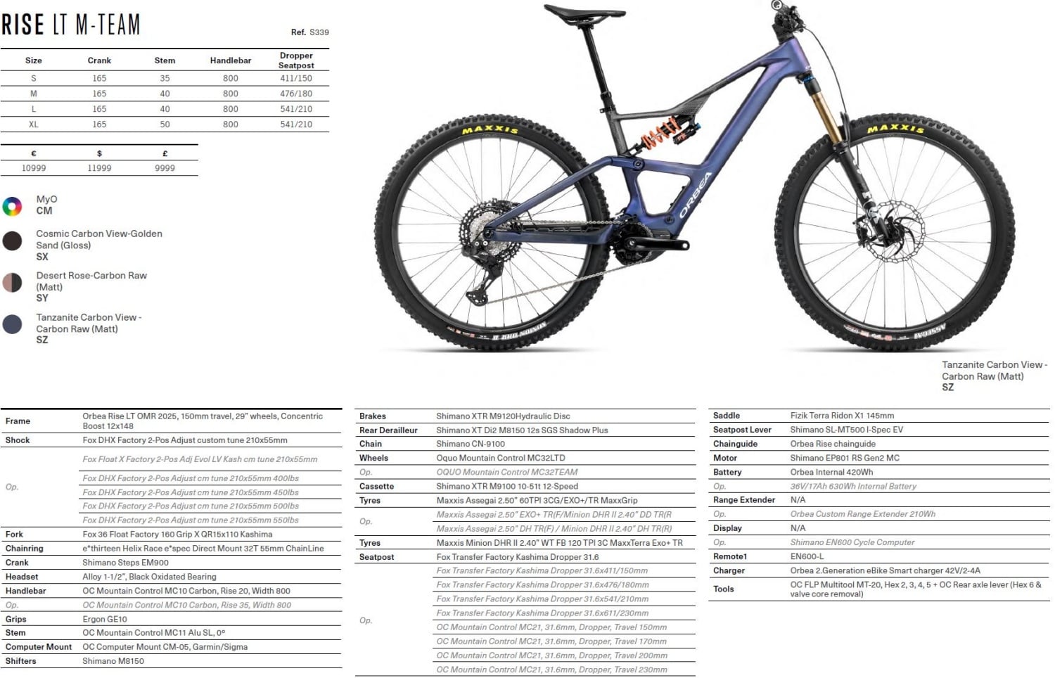

The new Rise LT seems a great platform for those who want a beefier Rise. The 64.5* head angle is a great choice for a capable yet maneuverable bike. If that is too steep, set the bike to the low position for 64*. The wheelbase is increased by 2 mm in the Low setting, putting a size L frame at 1.260 mm. If you want maximum frame reach, set the frame to High for 485 mm (size L). Chainstays are the same 440 mm as found on the SL. Geometry looks promising for an aggressive, lightweight emtb.

Orbea Rise LT M-Team: £9.999 / €10.999 / $11.999
Orbea Rise LT M10: £7.599 / €8.499 / $8.999

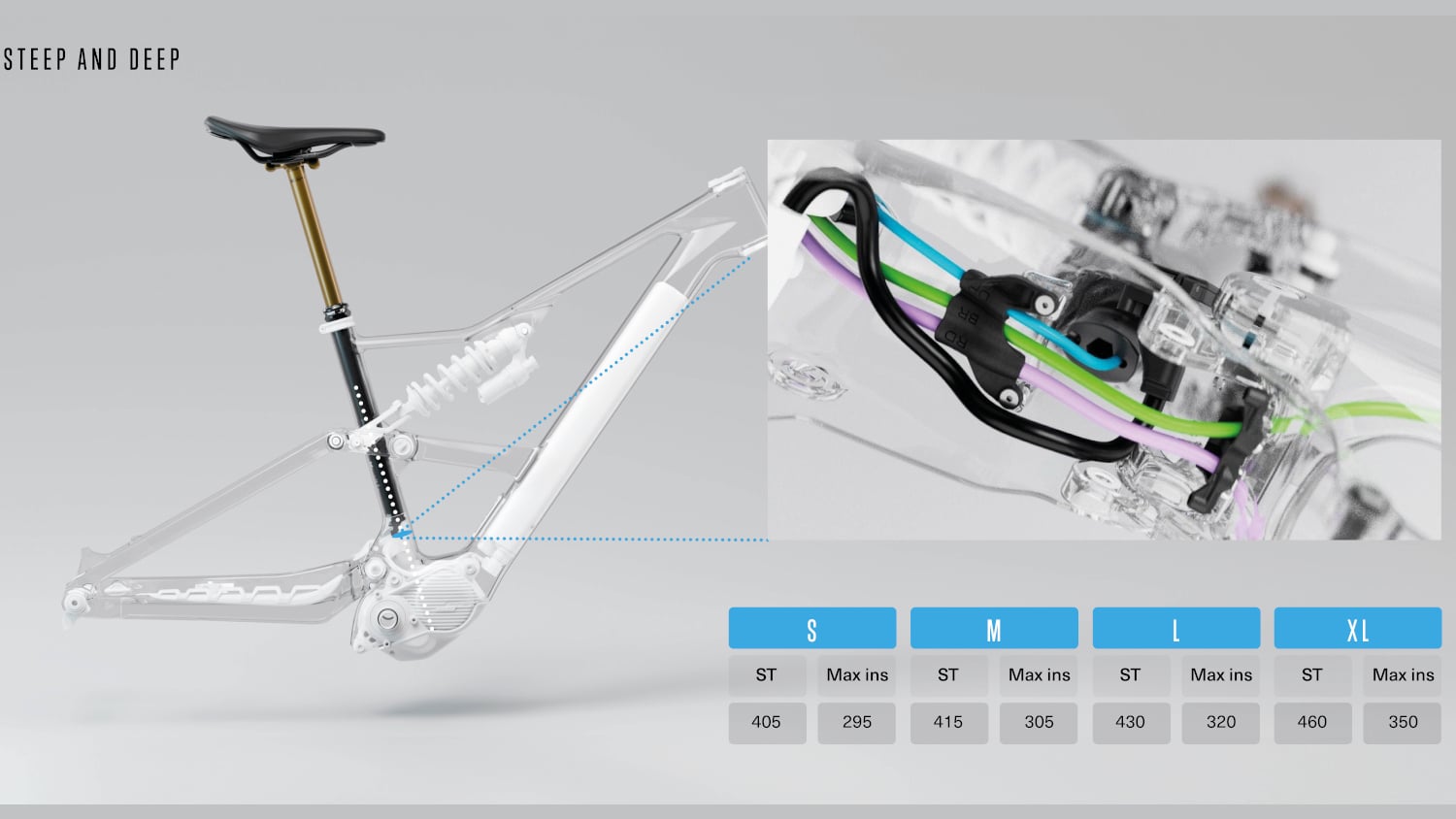

The new Rise has room for long dropper posts, starting at 200 mm travel!

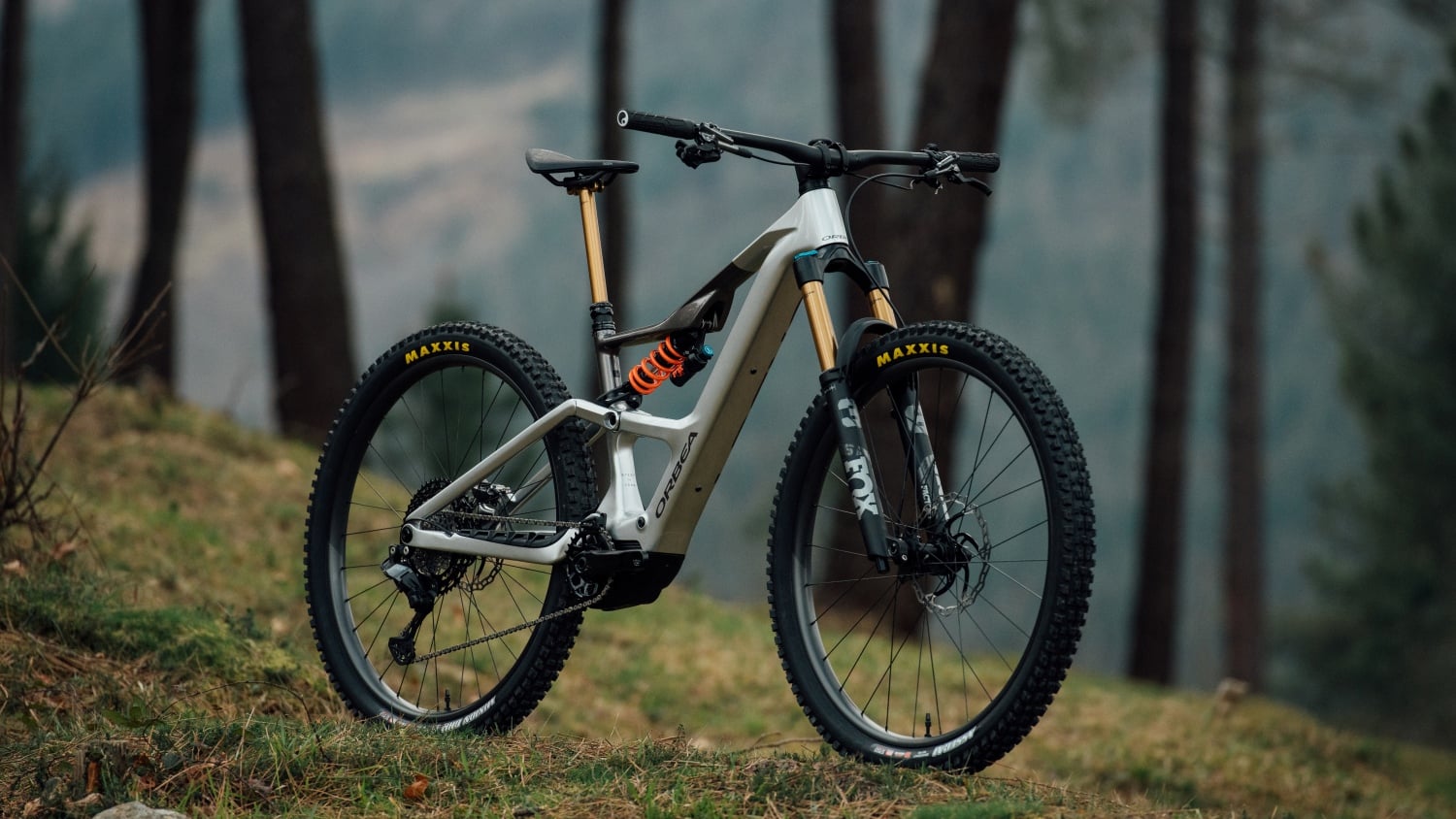

Who's excited about a coil shock on the Rise LT?

Fact is: There is no special Orbea firmware for all these "RS" branded drive units.
Orbea uses the absolute original and standard Shimano motor firmware on all of their bikes.
See here.
The only difference between a standard Shimano drive unit and the "RS" drive unit from Orbea is that Orbea uses a blue (and now blue and red) "RS" sticker and glue this sticker on the right side motor cover (in a very bad way) and then reduces max. torque and max. peak power levels via a (hidden) functionality which already exists since many years in the Shimano motor firmware.
Shimano has created these hidden functionality already many years ago for reducing max. torque and max. peak power for using some of their rear hubs which are not designed for such high torques (up to 85Nm on the EP800, EP801 and EP6) and high peak power (up to 600W on the EP801).
So via this way it was (and is) possible to reduce these max. values on most Shimano STePS drive units, so that when these drive units were used in combination with some of the Shimano hubs, these hubs will get a longer life.
And since many years (starting with the EP800-RS on the first Orbea Rise) Orbea falsely claims that they have "invented" and "developed" a very special "RS" firmware with special profiles for their light eMTBs, which definitely is not true!
Orbea has only limited the max. peak power and max. torque so their sometimes somewhat low capatity batteries (e.g. the very leightweight 360Wh version) will not create instantly negative feedback from their customers soon regarding range.
Also some of these Orbea created batteries use battery cells which are not able to deliver enough instant current for the max. nominal torque and max. peak power of the standard Shimano STePS drive units, so this was also another reason to limit max. peak power and max. torque on these "RS" branded drive units.
In my eyes, it is absolutely fine that Orbea uses these (Shimano created) functionality to reduce max. peak power and max. torque to get more range with their small batteries, but ORBEA SHOULD STOP TO LIE ON THEIR CUSTOMERS ABOUT THE SELF CREATED "RS" FIRMWARE NOW!
Don´t fool around !with your valuable customers, Orbea! Your customers are paying a lot of money for your (very good) bikes, but they deserve the whole truth!
So, thumbs up to the creators and developers of the Orbea bike design but thumbs down on the Orbea marketing department.
=> Don´t lie on your valuable customers who pay a lot of money for your bikes.
Put your pants down and forget about your "RS" - BS!
You have created an own battery system with great range externder, but if your batteries are not able for the standard Shimano STePS drive units to generate the nominal max. peak power and max. torque due to some restrictions of your battery capacity, then don´t lie on your customers and and don´t tell them that you have created a very special "RS" firmware with very special "RS" profiles - just tell your customers the full truth, that you just have reduced max. peak power and max. torque on the standard firmware of Shimano.
So, again, Orbea is using the absolute original standard motor firmware from Shimano for on their EP801-RS, EP800-RS and EP600-RS bikes for many years now and have noting invented for this.
There is no Rider Synergy (RS) at all - only the bloody sticker on the right side motor cover and the reduced values for peak power and max. torque!

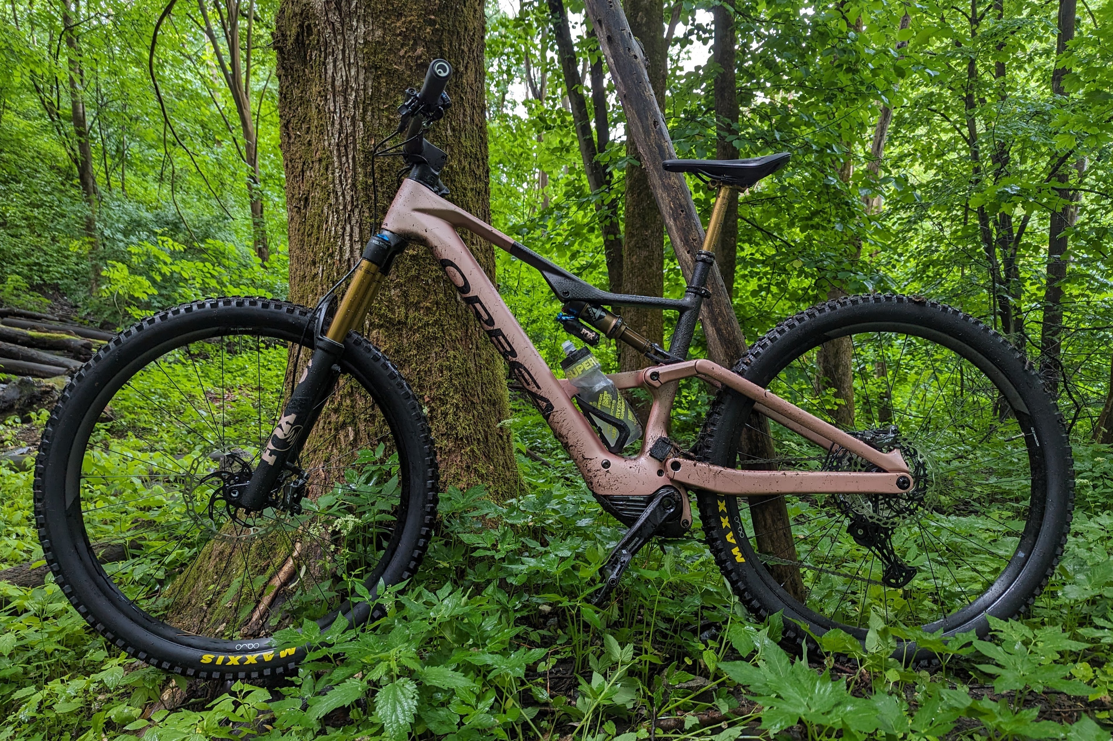

Had my first ride today. I can confirm that the motor is more powerful than last years model, it now feels close to full power emtbs. Unfortunately it is also a bit on the heavy side - 20.6 kg (size L, M10 with big battery, Maxxis Minions with tubes). Ideally I'd like to shave off a kg, but I think I need to keep the 630Wh battery.

Is that weight with pedals and the stock aluminum wheels? I am considering ordering one. Without tubes and with carbon wheels, it should be about 44 lbs. Thanks and I hope you enjoy the bike.
Without pedals, stock alu wheels, alu handlebar (waiting for stock carbon one to arrive), Fox Transfer dropper (175 mm, waiting for 200 mm to arrive - both these are probably heavier than some other droppers). As the new one starts at 16.3 kg, it is light with the right components.
Fwiw, the Levo with turbo set to 80-85% seemed to be a pretty good match up steep hills. About what I expected.
It sounds like it won’t quite be on par with a full power bike, but close. It should be noticeably more powerful than the original Rise, TQ or Fazua motors.
