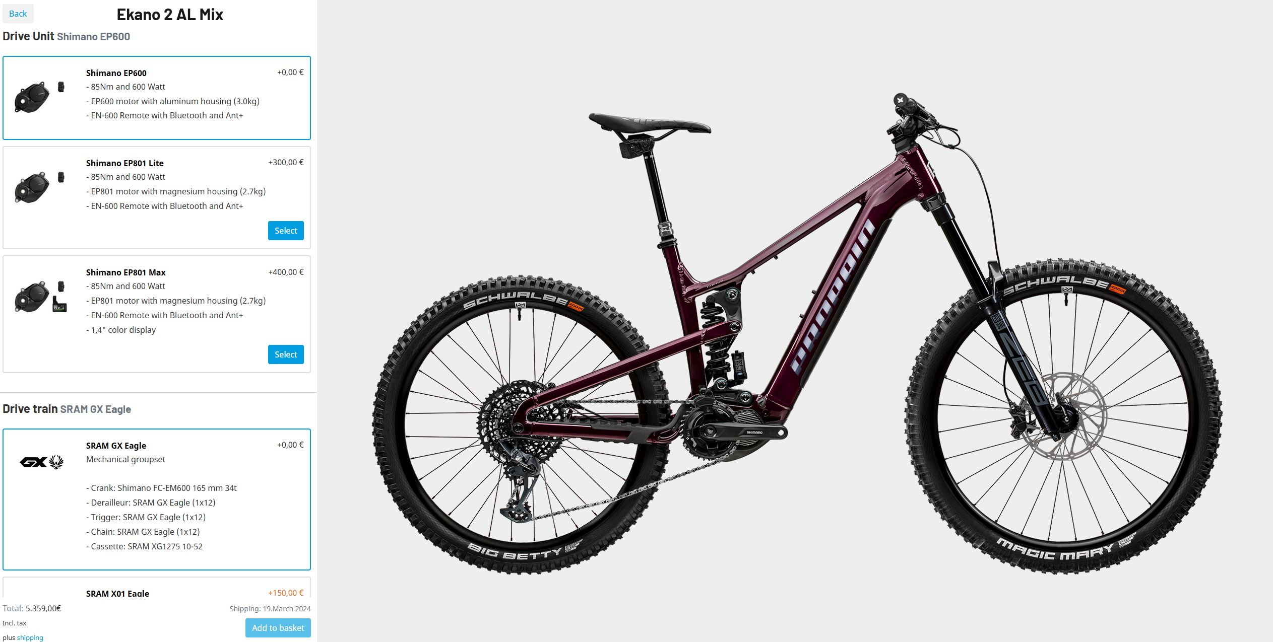

The Propain Ekano CF with the Sram motor was launched late 2023. This is a full power emtb with a 630 Wh battery. But it’s not a lightweight bike and it’s not cheap. The Ekano AL alloy version is cheaper, it comes with a Shimano motor and a similar 630 Wh battery.

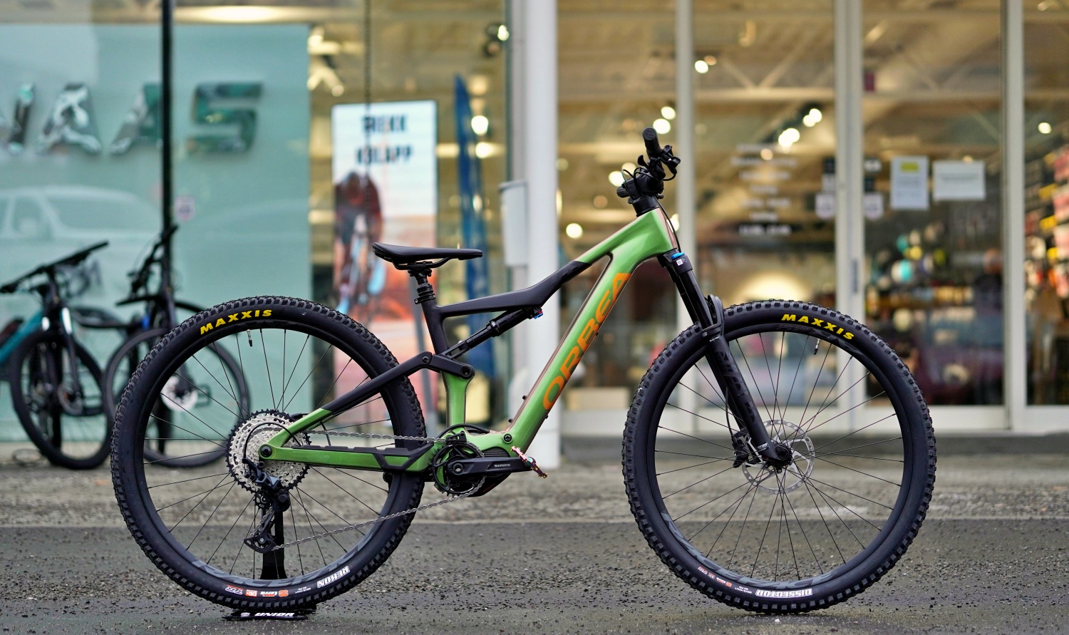

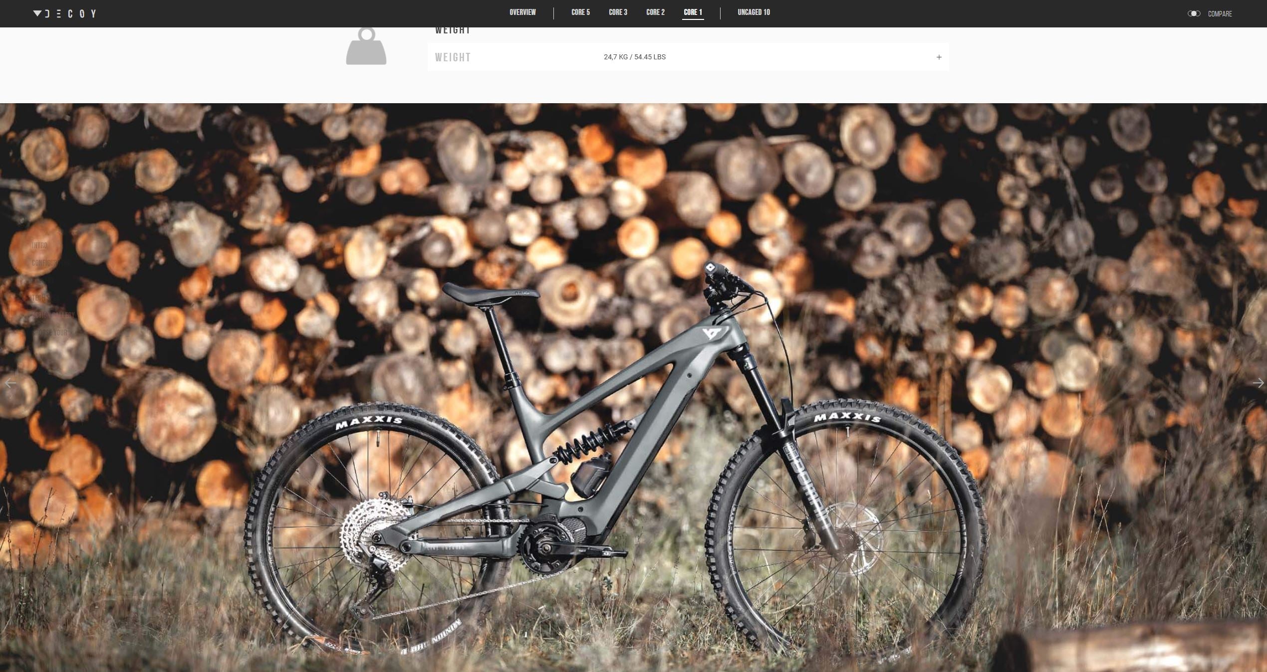

The next bike I want to bring up is the YT Decoy. It's not a lightweight bike, but the price isn’t that bad. The Decoy has a full power Shimano motor and a 540 Wh battery. Another emtb that comes with a 540 Wh battery is the Orbea Rise. This bike has a relatively low starting price, and it’s much lighter than the two afore mentioned bikes.

Okay, now I’m getting somewhere, I promise. The Orbea Rise H30 is a sub 5K €/£ emtb weighing 20,9 kg. Orbea, and all other emtb manufacturers, should get their hands on the new and more energy dense cells as soon as possible. They might not be that much more expensive as production cost is high priority for new cells.
2023 Orbea Rise M20
Seriously, the old Rise?​
Orbea should skip the RS software for detuning the motor. I mean, YT and Propain/Sram are using this battery configuration with full power motors. It makes no sense for Orbea to keep detuning the motor, not on a bike with a reasonably big 630 Wh battery! That’s all it takes for Orbea to launch a full power, sub 21 kg emtb at 5K €/£! And this is just the entry-level alloy version. For a little more cash, you could buy a sub 19 kg full power Rise with good range.
