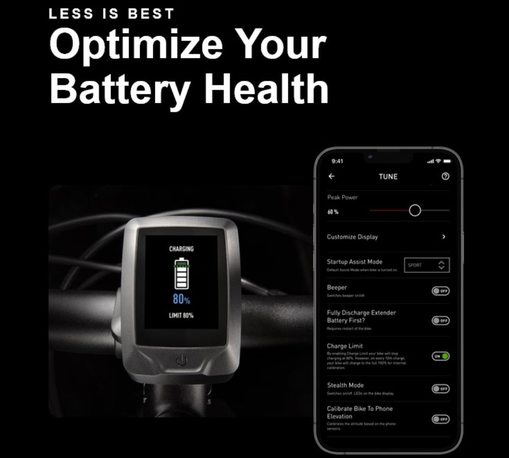

Turbo system update​
Specialized has just released a new “Turbo System” software update with the “charge limit” feature. This will limit the maximum state-of-charge to 80%. This is fine for long term storage. Also, Specialized claim most users don’t use the full 100% on their rides, so charging to just 80% will be fine for many of us.
How to get it?​
You can get the new feature on your existing bike. Download the Mission Control 3.11 app to enable it. If that doesn’t work:
Your bike may require a full system update, including a battery and display update, to enable this feature. This update needs to be applied by an authorized Specialized retailer*. Please contact your retailer to schedule an appointment. Once completed, you can enable Charge Limit in Mission Control.

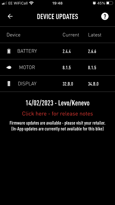

Here is what mine says. So we got this feature, but they've removed the at home firmware upgrade feature!!
I got mine updated Feb 14, 2023 at my LBS. It was in for the battery update and the display update, released that day, came along for the ride. I find that the charge feature works exactly as indicated. Charges to 80% when on and when turned off it charges to 100%. The new display code seems to make Mission Control a little glitchy when changing the tunes. I"m hoping for another update from Spech but I can get the tunes to save and load correctly but I can't do it fast.
If you want the Charge Protection feature you need both the Battery updated to 2.6.6 and Display updated to 34.B.0 The battery needs updating at the shop.
