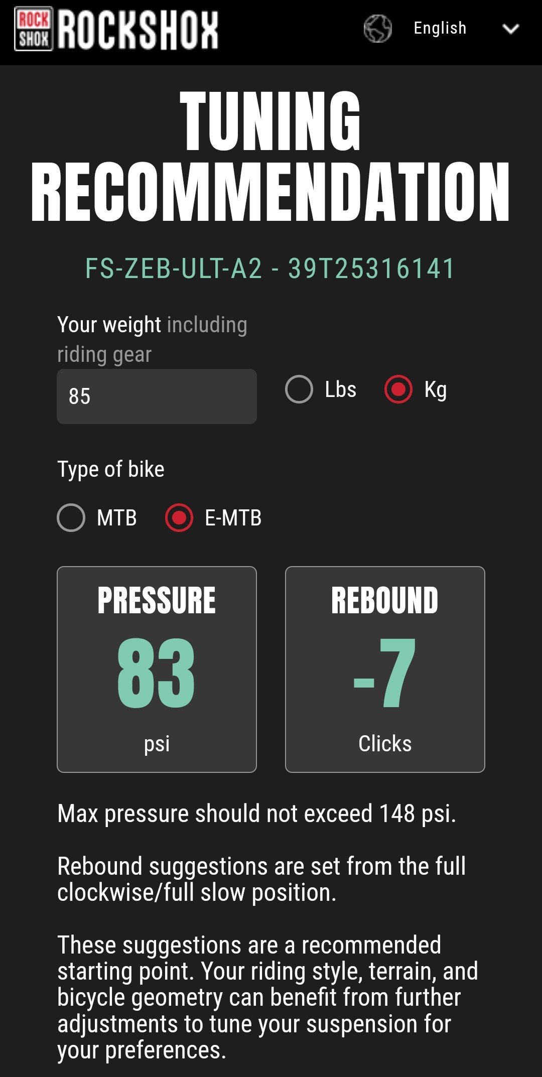

If you use Rockshox Trailhead, stick in your forks serial number then go to tuning, the recommended base air pressure setting for eMTB for your weight is so high that you end up with ridiculously stiff forks!

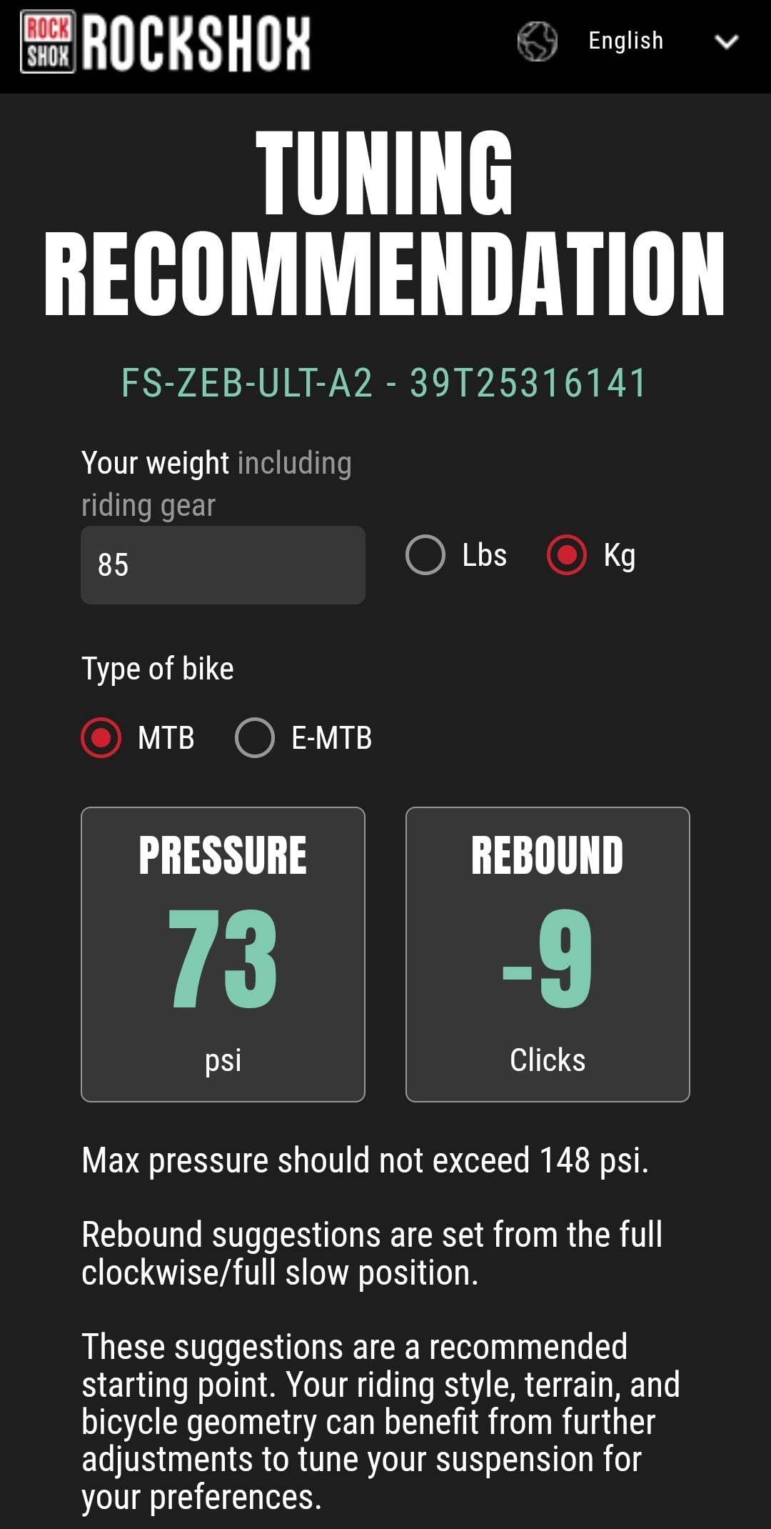

I am 85kg/187lb ready to ride (you are 109kg). As you can see for me Rockshox Trailhead recommended 73psi with MTB and 83 psi with eMTB. Same result for online and the App.
ZEB Ultimate tuning recommendation - MTB.jpg ZEB Ultimate tuning recommendation - eMTB.jpg

I found the recommended EMTB pressures on trailhead app was too high... couldn't get full use of the shock. Ended up splitting the difference between the EMTB and non-EMTB pressures for my weight and seems to be working well
