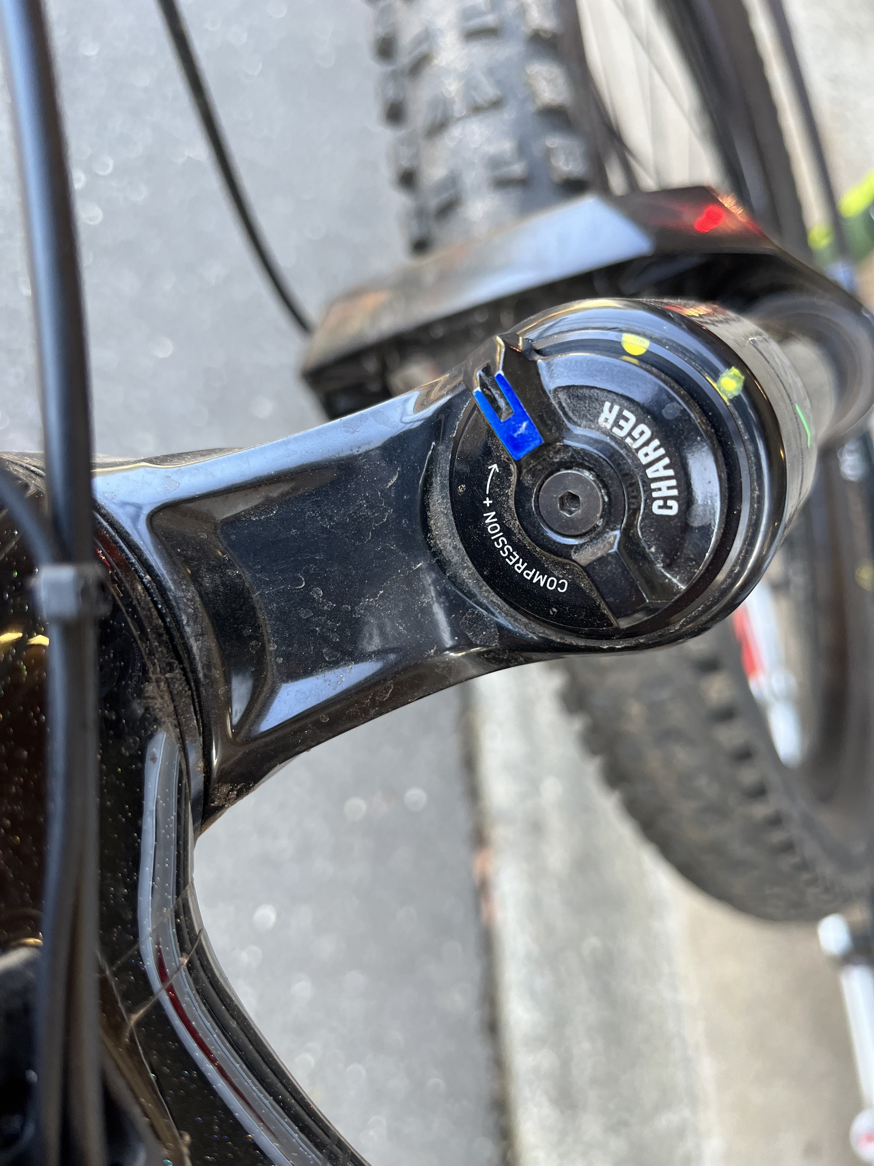

Picked up a new eMTB and it came with a Zeb Select (A2) 170 mm with RC damper... long story short, the damper top cap keeps loosening on its own. In the 10 rides I've had it, I've needed to tighten it three times. Here's a picture (yellow reference mark) showing the movement after 2 rides.
Anyone experience this?

Yes, I can apply more thread-locker if that's the issue... though I've never had this occur on FOX and Manitou forks. I tighen the top caps hand-tight and they've never loosened.

Hand tight is not tight enough, they need a gentle 'nip up' with a socket (or spanner), there's a torque setting in the documentation sonewhere. No need for thread locker.

Yes, I’ve torqued it to 28Nm and it loosened after two rides. Hand-tight meant with tool, not fingers.
The first time it loosened, I simply nip’d it up with a cassette tool and it came loose too.

Doesn't sound right. TBH if it were me I'd take it to a local LBS and get them to have a look at it.
Edit: you could perhaps try using some "Plumbers Tape" aka PTFE tape.

Bike is from an online retailer... not taking it to a local shop. Was curious if this was a common occurance on these forks. On MTBR a couple folks stated they've seen new RS forks with loose top caps.
Could be as simple as adding some loctite... I'm just surprised it has such a tendency to loosen. I've sent a inquiry to RS... a brand-new fork shouldn't be doing this.

It isn't but as you're discovering, the bolt that holds the adjuster on is short & needs a helping hand to stay put. These things are mass produced in a Taiwanese factory & you tend to get random faults. I service a lot of forks & regularly see leaking footnuts, globs of grease blocking air chambers, rebound adjusters rattling loose and so on. I'd say the engineering & design is generally pretty sound - with a few serious caveats- but assembly can be sketchy. Yours clearly didn't have a pre loctited bolt used as it should have, so apply loctite to the bolt & enjoy life.

I don't think OP's issue is with the compression adjustment knob coming loose. They are talking about the actual fork top cap (that requires a cassette tool to tighten) coming loose. Look at the picture again and the marks they have made in yellow.
Hmm, looks like you're right, my bad. I misunderstood the assignment. To release the damper assembly, you would normally split the fork to separate the damper shaft from the lower legs. I'm now wondering if the damper assembly could rattle loose at all if it were connected to the lower legs as no one would ever normally unscrew it before releasing the foot nuts & I don't think the shaft has free rotation.

Hmm, it’s NOT the small cap screw securing the compression knob that’s loosening. It’s the damper top cap, threaded into stanchion with the cassette interface.
I want to verify the presence of factory applied thread-locker and whether the stanchion is fully pressed into the csu. That’ll require unthreading the top cap and the damper can only extended so far, thinking like a grip2 unit. Maybe it’s different.

Yeah, I get that. The only way to unscrew the damper assembly is to disconnect the damper shaft from the lower leg or at least it should be. I'm now thinking you have something very wrong with the fork if the assembly if it's coming loose - it should not be able to rotate since it's one whole connected assembly bolted to the base of the lower leg.

Nah, the damper shaft can rotate. He just needs to tighten the cap a little more. if Loctite makes him happy, then that's ok, too. It's not a big deal, and takes less time to fix than it does to take the bike to the shop... or to read this whole thread.

Nothing like overkill… I released the air pressure in the fork, compressed it and undid the damper top cap.
When I extended the top cap, the factory thread locker was visible, but it was covered in oil. Whether it went together oily or the thread tolerance is shit…. I cannot say. Plus there’s little blue bits/strands of thread locker everywhere. Pre-applied/dry stuff.
The only thing not visible without pulling the damper out is verifying no stanchion gap (fully pressed in).

To follow up... I've had a few rides since and there's no movement of the cap. So success and I didn't have to waste time shipping it back for just loctite.
I pulled the damper assembly out of the fork and cleaned the top cap and stanchion threads. Re-installed the damper assembly, added new fluid to lowers and blue loctite on the top cap threads.
I also increased the torque to 30 Nm if memory serves. The loctite had a day or more to cure before I rode it.
