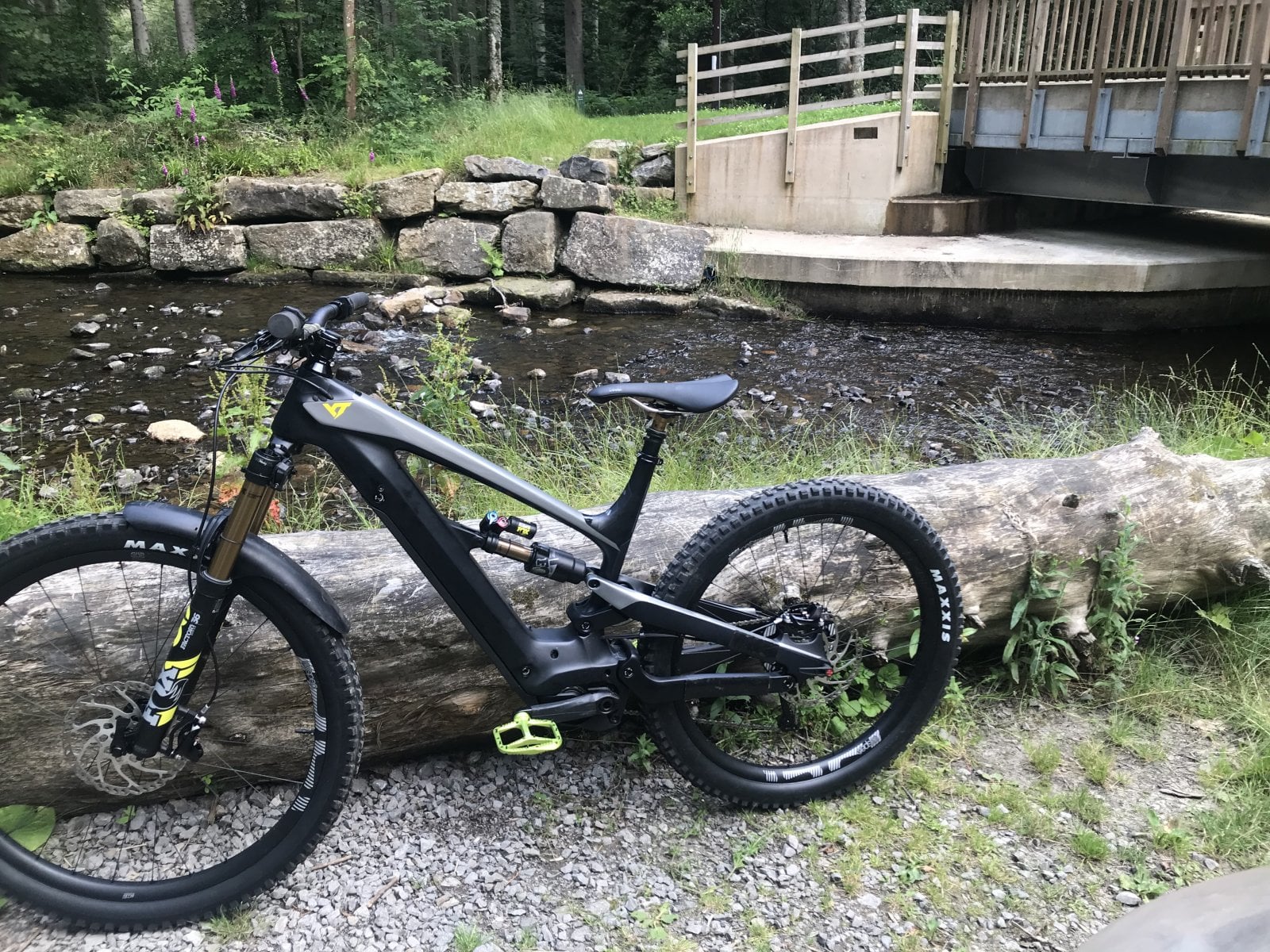

Had my first decent ride on mine today. The Shockwiz was plugged in to do some repeat testing.
Did a baw hair under 25 miles and 3750’ of climbing, well into the last bar of battery but it didn’t drop to eco. All in trail in the E-TUBE ‘low’ setting. 115kg of chiseled beef on board?
My Jam2 with the colour display would drop to one bar (red) and run for a while in the mode you were in. Then it would flash red and drop the assistance level to eco. I cannot remember if the display changed to say eco or if the assistance was just cut back.
Not sure how it goes with the E7000 display. The one bar didn’t start flashing at any point.
Not sure if it’s self calibrating or what, but I’ve noticed the last bar does not last nearly as long as the first bar. On one of my initial rides I had a short 3 km road section back to my car, I tried to boost there, I started with barely two bars, quickly dropped to one then it turned itself off with about 1 km to go. I learned then once I get to one bar I know I need to shift into limp mode (eco) myself, or it’ll die quickly. Once it’s out of juice the power is cut and the screen says “off.”
Yeah, one bar & boost is playing soggy biscuit ??
