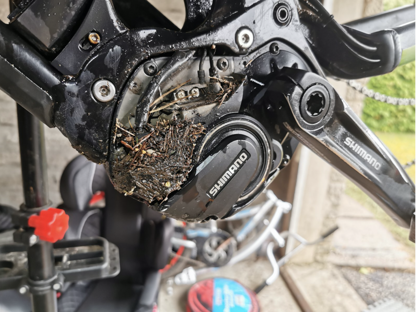

The biggest issue with the YT IMO is that the design of the frame means you cant easily remove the the cable cover on the LHS side of the motor, which is one of the areas where a lot crud can collect, and clean it out. Lot of historical problems with the shimano motor come from crap collecting in this area and causing electrical problems.

Yup the YT is a great bike, and its really good they are opening the service centre, but its the only brand I can think of where you potentially have to drop the motor to access one of the areas that with a shimano you need to keep an eye on. This isn't an uncommon sight after a few winters rides, though I suspect the lack of access may also help a bit with this. If you have a shimano motor you should regularly check behind and clean out the area if needed. If you cant pop off the panel then you cant tell if you have the issue.

It may actually be that the fact the frame overlaps the side of the motor helps - its very hit and miss how crap gets in there, it tends to track down the cables behind the cover - I have done months with nothing getting in, then randomly stuff gets in when I next check. The photo is a bit of an extreme example but illustrates the point.

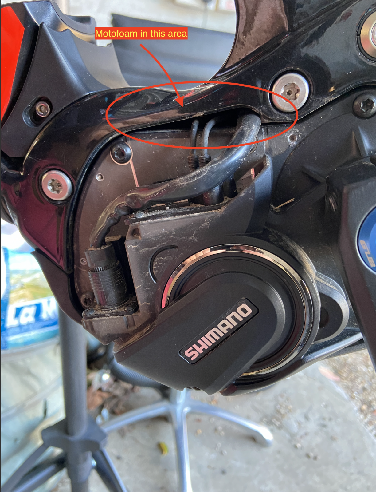

A lot of us with various bikes have put motofoam between the underside of frame and top of motor, and also put some tape over the joint on the top of the panel to help.

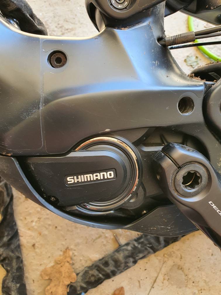

I'm not even sure how that would happen on the decoy?
Looks like a different angle so should not be an issue and well covered?
the crap can get though the top of the motor when the cables go in - like I said its hit an miss and very random, but worth checking once in a while because I have seen motors fail due to corrosion on the connections in there - a lot of the time its caused when washing the bike and it forces stuff in there. This pic is from a different thread, so ignore the comment, but you can see the cables coming down into the area.

I think the YT should be ok the the motor looks well covered like its tucked up in to the frame. The bottom is foamed but I think the wires run along the top. I think some foam is good idea around the battery where it meets the frame though I've seen some people do that.
The biggest potential issue with the YT IMO is that the design of the frame means from what I can see you cant easily remove the the cable cover on the LHS side of the motor, which is one of the areas where a lot crud can collect, and clean it out. Lot of historical problems with the shimano motor come from crap collecting in this area and causing electrical problems.
Yep, It takes about 5 mins to remove the cover.
If you take out the battery of the Decoy you can with a flashlight see the main connector of the battery. Looks pretty clean with my 2 Decoys after 1 year. Think the motor is covered by the frame from the top. Is almost impossible to have dirt getting in. Must come via the battery compartment and that is sealed from at least particles.
