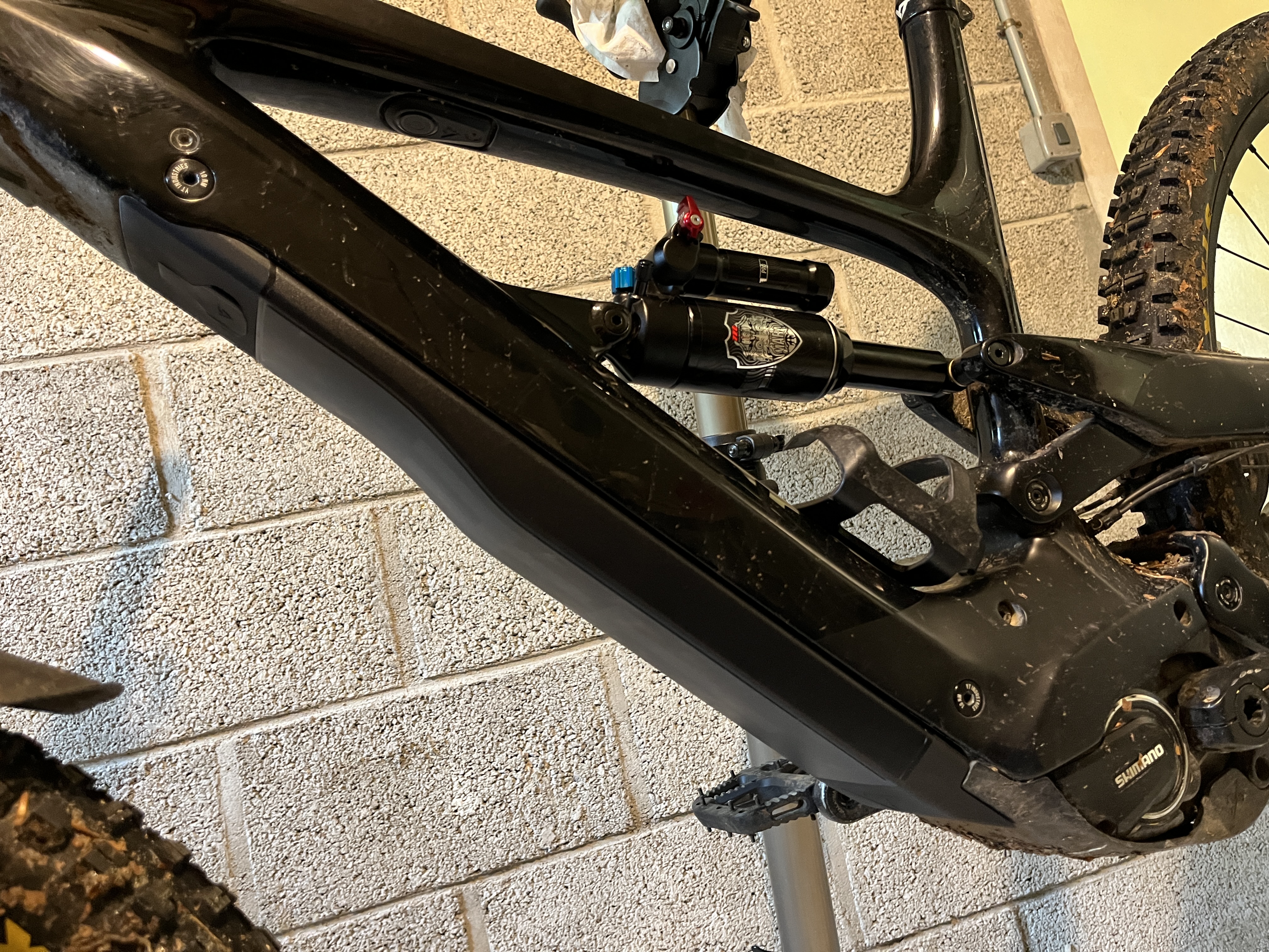

Could anyone please give me the measurement of how much the "hump" protrudes compared to the 540?
Looks around 30mm or so in the photos......

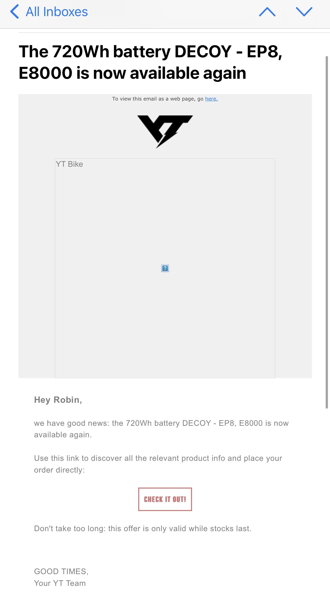

Wednesday afternoon, I emailed to YT, asking them if they see any hope for the battery. They sent me a standard answer, I got upset and wrote back that I expect a specific answer to my email. They replied they don't know exactly when they will become available. I replied, asking that I do not expect an exact date but at least a date range - weeks, months, years, decades, never. They answered that within the next 3-6 weeks something might be available, no guarantee.
Same day, Wednesday evening, as so often, I refreshed my bookmark for the battery availability and there it was! Even before I got the email! I ordered and got one. Called up my friend who has a Decoy a couple of minutes later and they were sold out. What a joke!
Anyway, mine is on its way and am pretty relieved. As said, I like my Decoy otherwise and it would have been difficult to find a suitable replacement. So, I can shift that decision out for another year or two.

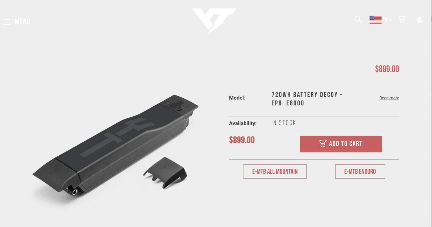

the 720wh batteries have been in stock on the US site for 24 hours now. They must have gotten a lot of them in stock at the US mill.
Thanks for the alert! My buddy just got one and he's been bikeless for weeks with a bad battery.
It's less, around 17mm.
If you are ready to ride a slightly slacker seat angle and head angle a crown spacer like the Reverse one might be the solution to fit the 720 in the S frame

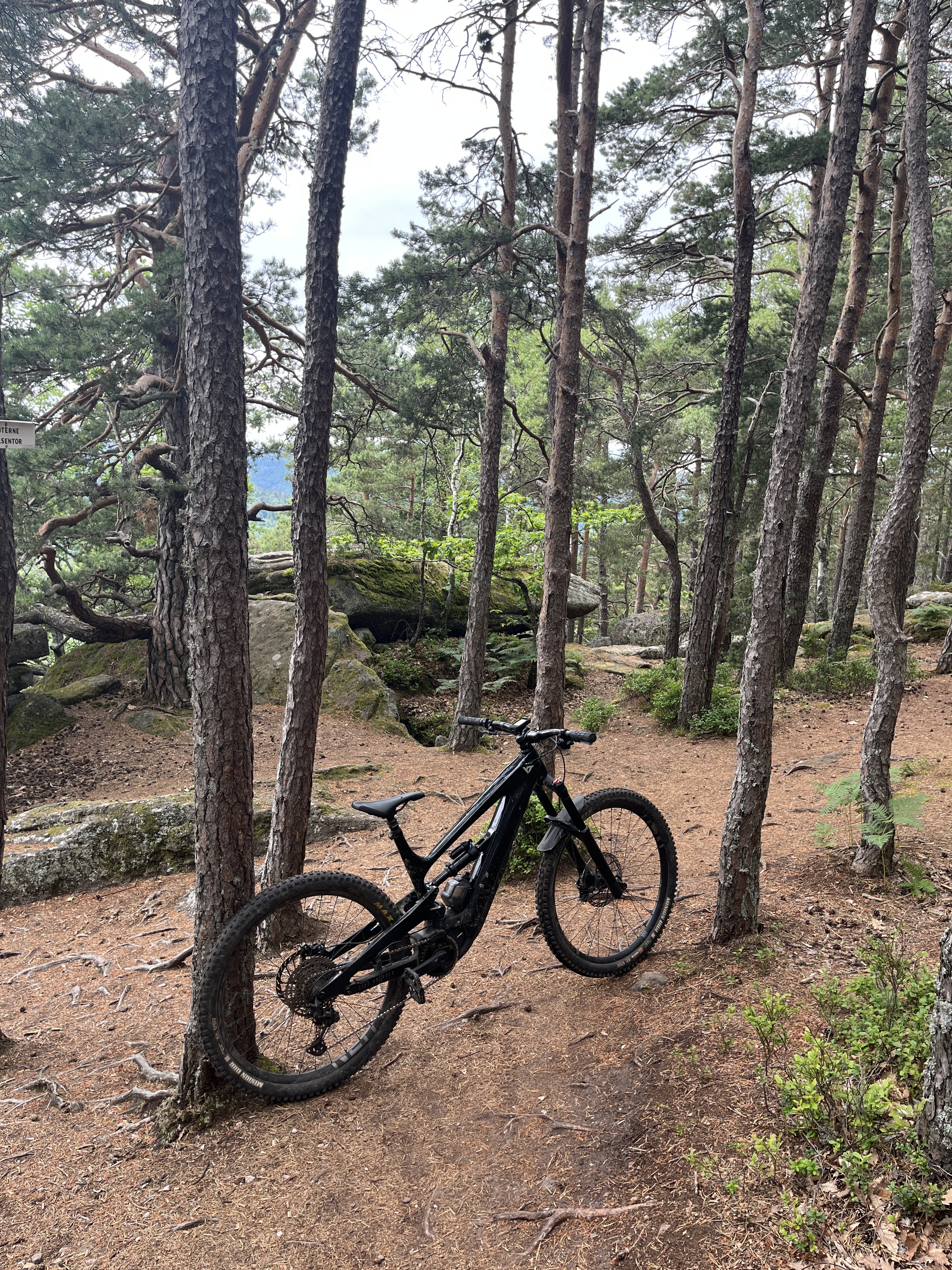

First ride with the 720wh, all in trail 50km/1300m and 20% left.
I don’t feel the handling difference with the 540wh, maybe it depends on the frame size, on the XL I have the feeling the weight is still very well distributed.
It’s really nice not to worry about the range anymore for my use. The main drawbacks is that YT doesn’t offer to take the old battery back like they promised a couple of years ago and the pricing is steep…
Thanks for the info! Took the spring out the fork today and the current gap with a 2.5" tyre is 16mm................
That's with the Smashpot set for 180mm travel, guess I could reduce that to 170mm and/or set the bottom-out damper to max, have to weigh up pros and cons....
Doh, reducing travel just makes the fork shorter, it will still bottom out at the same point!
Reduce the fork to 170mm and use a crown spacer if you really want the 720wh.
I don’t think you will loose that much performance or even notice 1cm less travel you can just increase the bottom out damper as you said

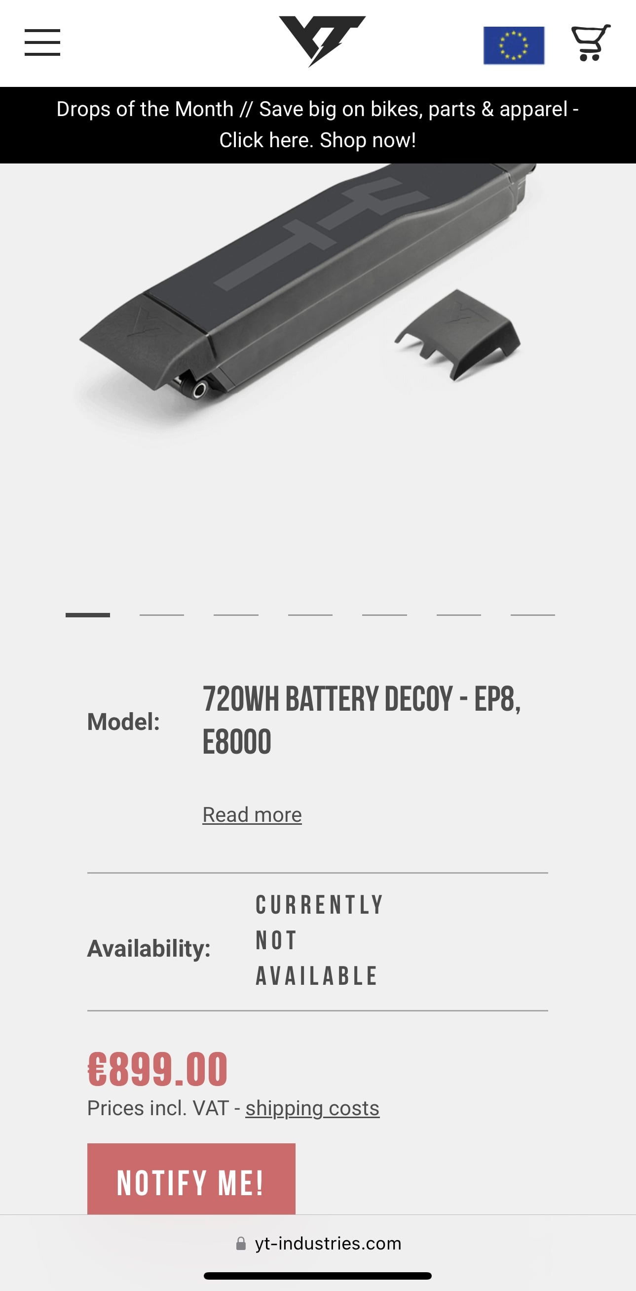

These 720WH batteries have been coming and going from stock 3 or 4 times now. They are still available at the moment in the USA. Seems like YT is getting a bunch of these now.
I wish you could pay the difference in price and purchase the bike with the 720 (similar to how canyon does with the 900) instead of having to buy another battery. I don't necessarily want 2 batteries, just a bigger one!
Just to confirm, I emailed YT USA and asked about purchasing a Decoy with the 720 battery and they said it was not possible. They said it was only available as an accessory.
