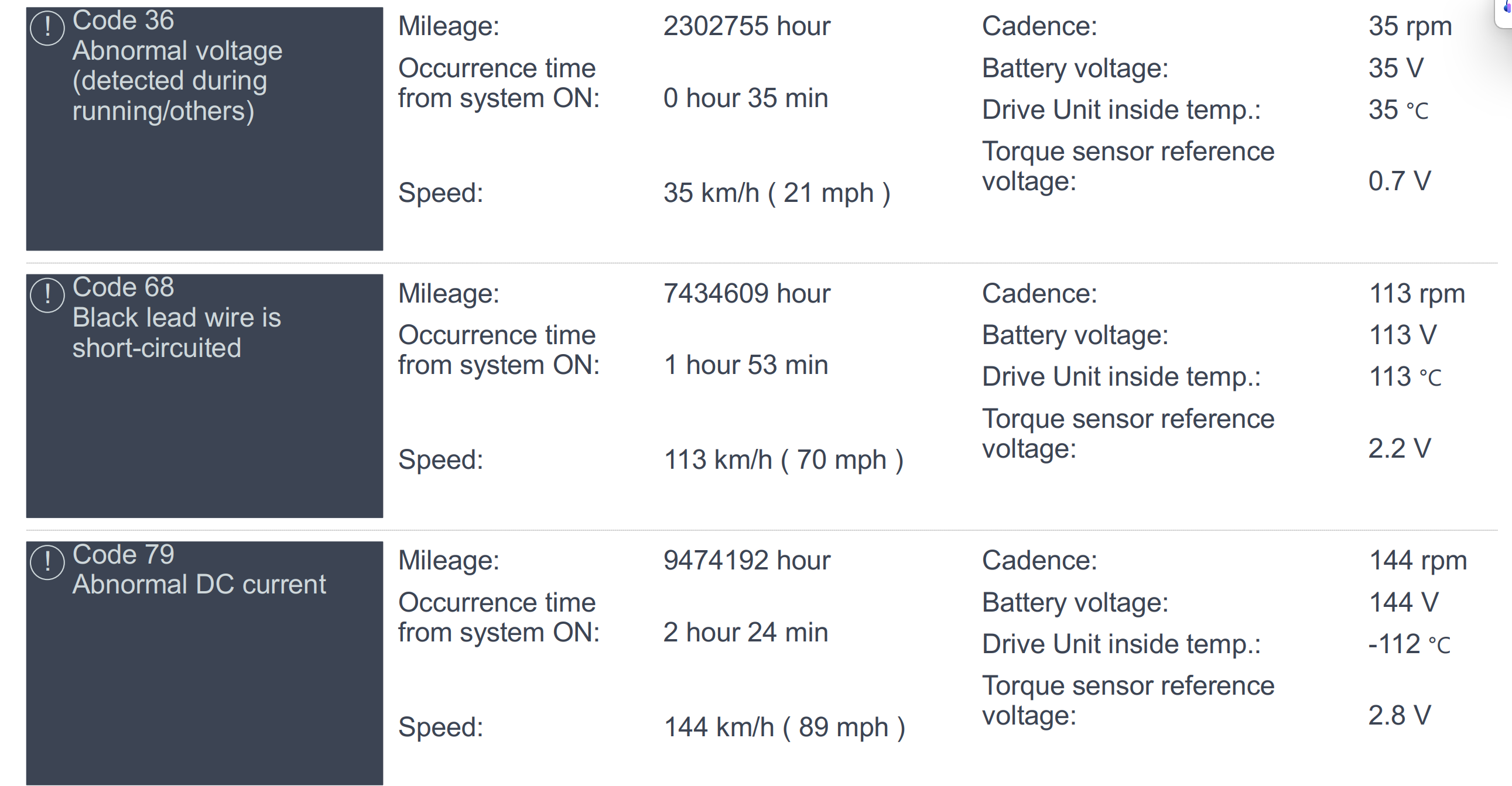

Has anyone managed to clear codes? I've got 3 that when trying to clear them I get a "clearing failed" message.
Nope, unfortunately not.
Oh no. I've got 3 faults on mine. Still working on it and stripping the bike down to fault find etc.
I noticed on a replacement motor details it says they needed coding and yedt needed (Yamaha diagnostic tool) and wonder if it was different / better than this software.
Out of interest, what are the 3 faults? Mine has 3 faults too, although functionality doesn't seem to be affected.
Took me a bit to reply, sorry...
Yeap, same errors:
I don't think there's anything to fix really, I think the bike is working as it should and these might be shadow codes that just can't be cleared.
