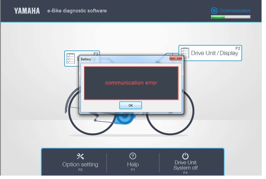

ernetmyk
May 27, 2023
Ukraine/europe
Could explaine, please:
Installed the software on the laptop and made a "Drive unit/ Display" successful diagnostics. But to make battery diagnostics, it does not work, it gives an error "communication error".
What could be the problem is: driver, software, battery any else?
Deacon
Jan 27, 2023
21
16
England
I get the same with my Allmtn 10 with the Yamaha PW-X3 motor.
I can connect to the motor OK, but not the battery.
I think this is due to Yamaha changing from there own branded batteries to Simplo/Trendpower battery manufacture, at the end of 2022.
Yamaha either need to bring out new Software, or we need Simplo/Trendpower software.

Funkeydunk
May 28, 2019
380
280
Uk
Some of the yam bikes don’t have yam batteries, this is why the Sw can’t read them and reports an error. This is normal, the battery probably isn’t faulty, just a limitation of the SW

I own a Haibike Sduro Hardnine 7.0 (2016, PW-X1) and an AllMnt7 (2023, PW-X3). Software works on both, and also on both the battery cannot be checked (Communication Error). Reading the fault History works fine, cleaning it does not (An error occurred). I only tested history cleaning on the PW-X3, as tghe PW-X1 had no errors reported.
If anybody had access to a newer version, this would be a breeze!

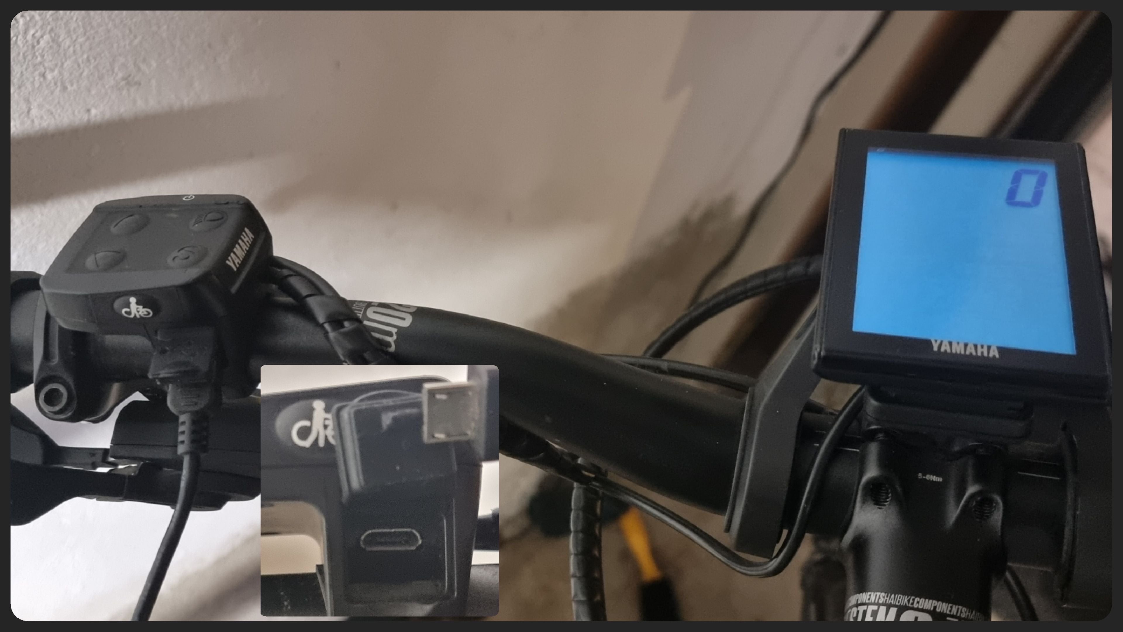

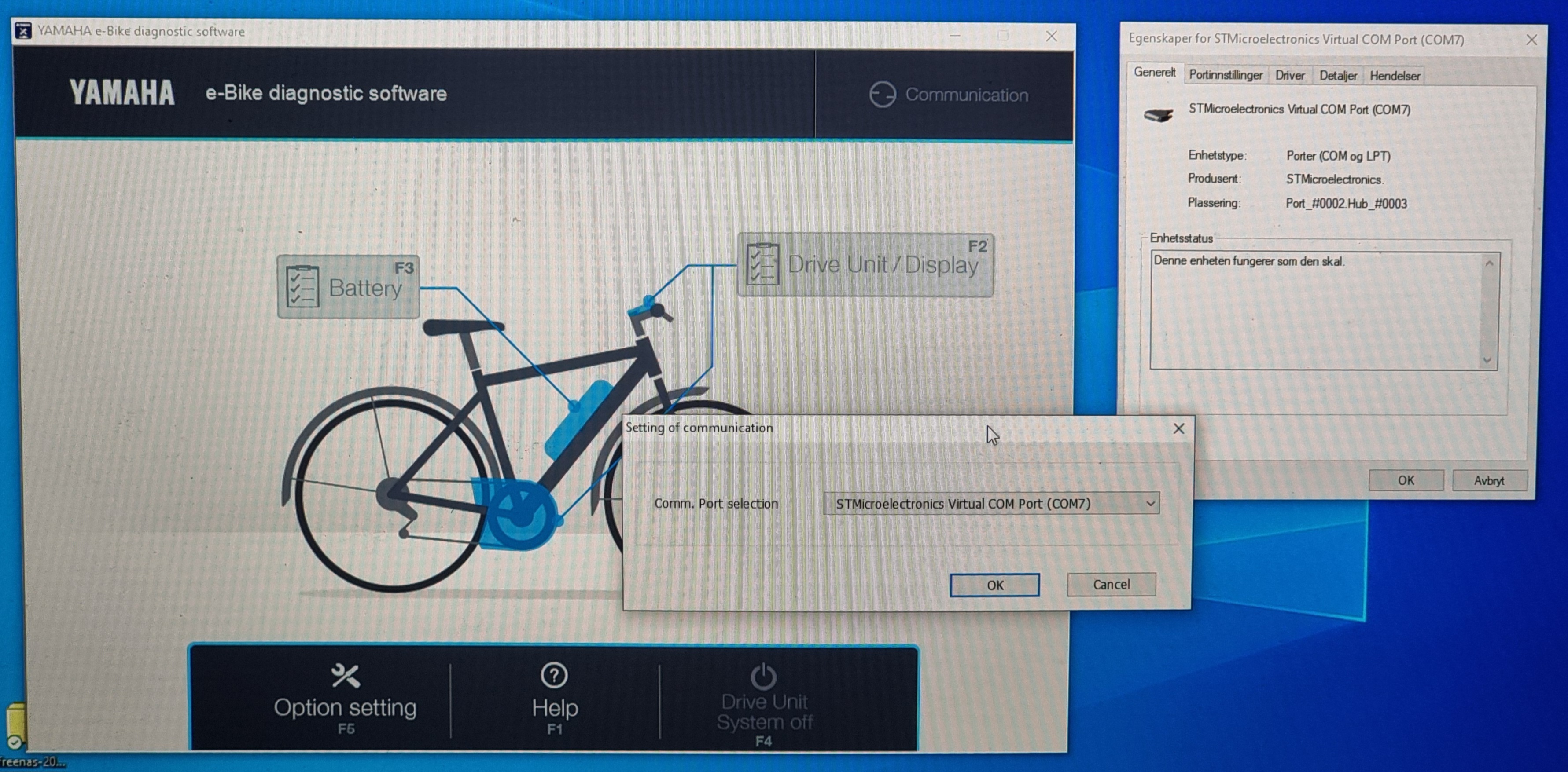

Hi.
New on the forum. Has anyone been able to make the e-Bike diagnostic software work with Yamaha PW LCD like on the picture (Haibike Sduro trekking 4.0 2016)? I've connected the Yamaha to a PC (Win10Pro), display on bike shows "0" (not PC), get the correct comm.port setting. Neither red or green on the "Communication" symbol.
Any ideas on what to do?
Cheers.

Hello.
Right now I'm writing program for 2019+ displays (open source alternative to program from this topic). But according to my information, old 2016-2018 years displays had no pc connectable port at all. How do you connect your display to pc?

Hello.
Connected through micro-USB.

Looks like I got my hopes up a bit too early then. Thanks, I'll check it out. Here's a picture of the connection.
OTWall
Feb 21, 2024
Norway
Ok, so what happens when you trying to read it with program? Now you have dialog window to select port, what's wrong when you checked port and trying to read something?
Unable to make any readings. The connection is not made, stays grey (not failed connection/red nor good connection/green).
