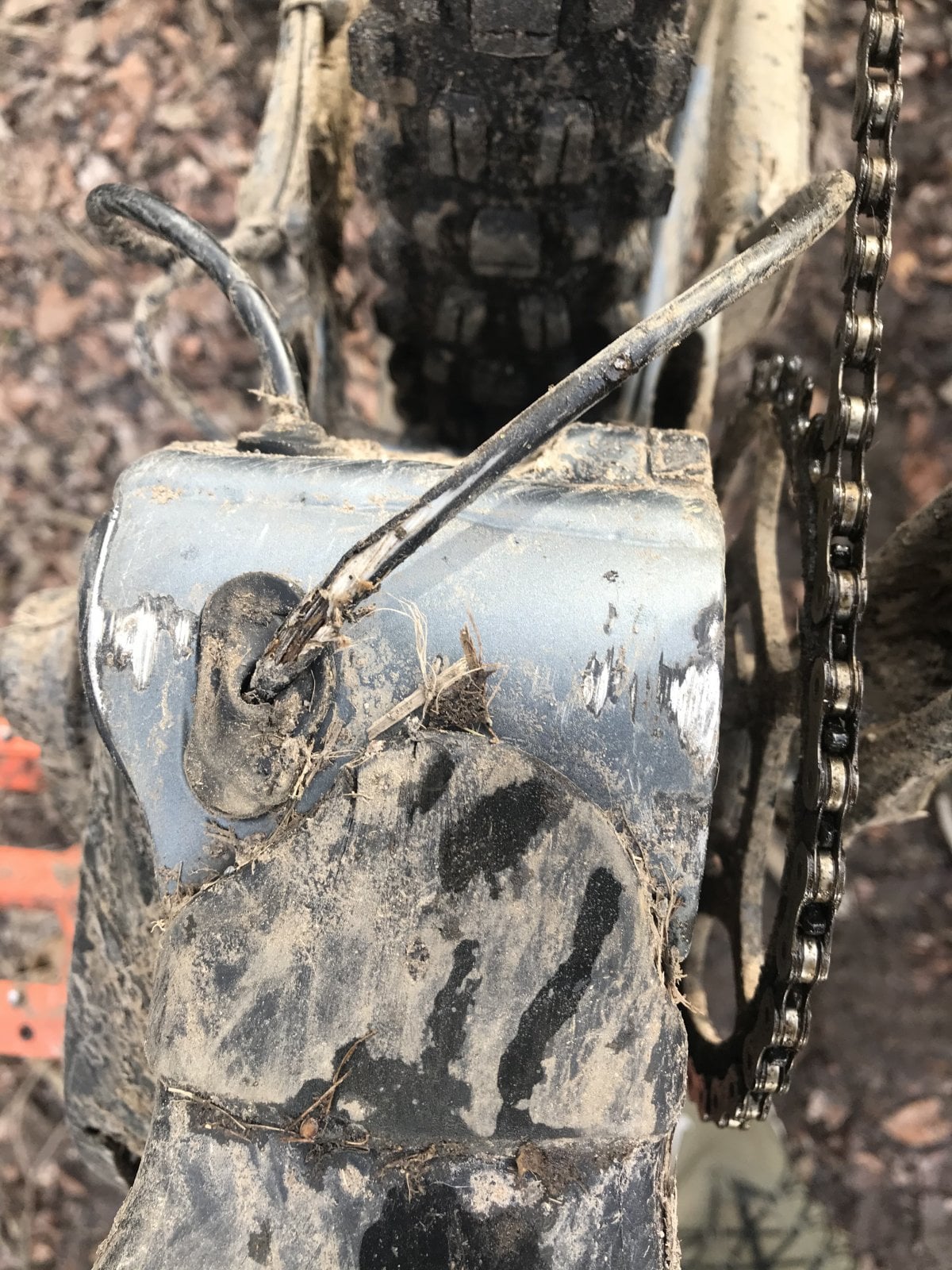

Here’s mine. First pic looking down to Mam Tor. Second is the result of a big rock step down. Had to replace the rear mech cable ? I know plenty of people commented about the poor cable routing.

I thought it was the brake hose and speed sensor cable that got moved? ? Will double check with my LBS. not sure where the rear mech cable could get moved to unless I run it out past the motor casing.
Thought there was meant to be a dealer fix for that. Had mine done in Sept on my 150
Doesnt the dealer fix still route the brake cable out from the bottom?
I did my own fix and pulled all the cables out from the big hole in the back, much better.

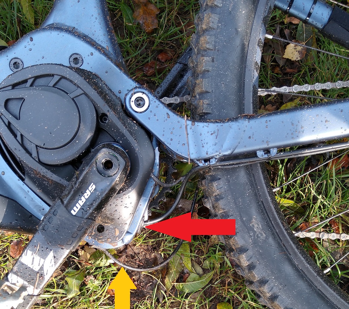

My dealer pulled the magnet sensor cable out of the side of the motor cover, after a notch was trimmed out.
So you've pulled the rear mech cable out of the rubberised hole with the rear brake hose?
Is this just a motor cover off job, or drop the motor out?
Mine looks like yours Tribey. If I crush the gear cable again I’ll try and drag it though the same grommet as the brake hose. I’m going to bang a slice of an old tyre under there for the time being to soften a blow.

I don't understand that "fix". The brake hose is still routed under and will not hold up for many rides. I removed the rubber housing complete and pulled all cables out from that hole. Removed the motor, but it's a quick job.
