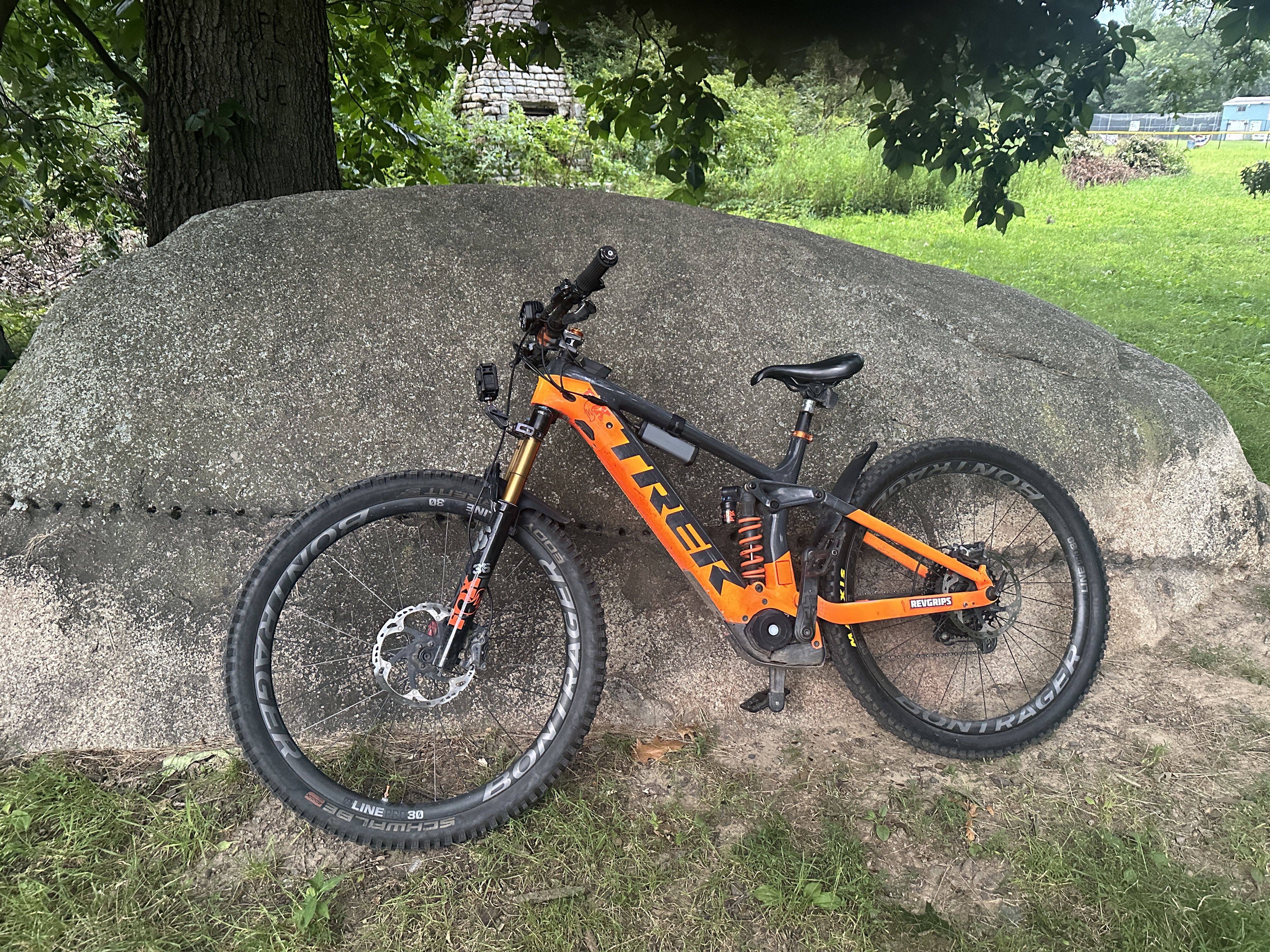

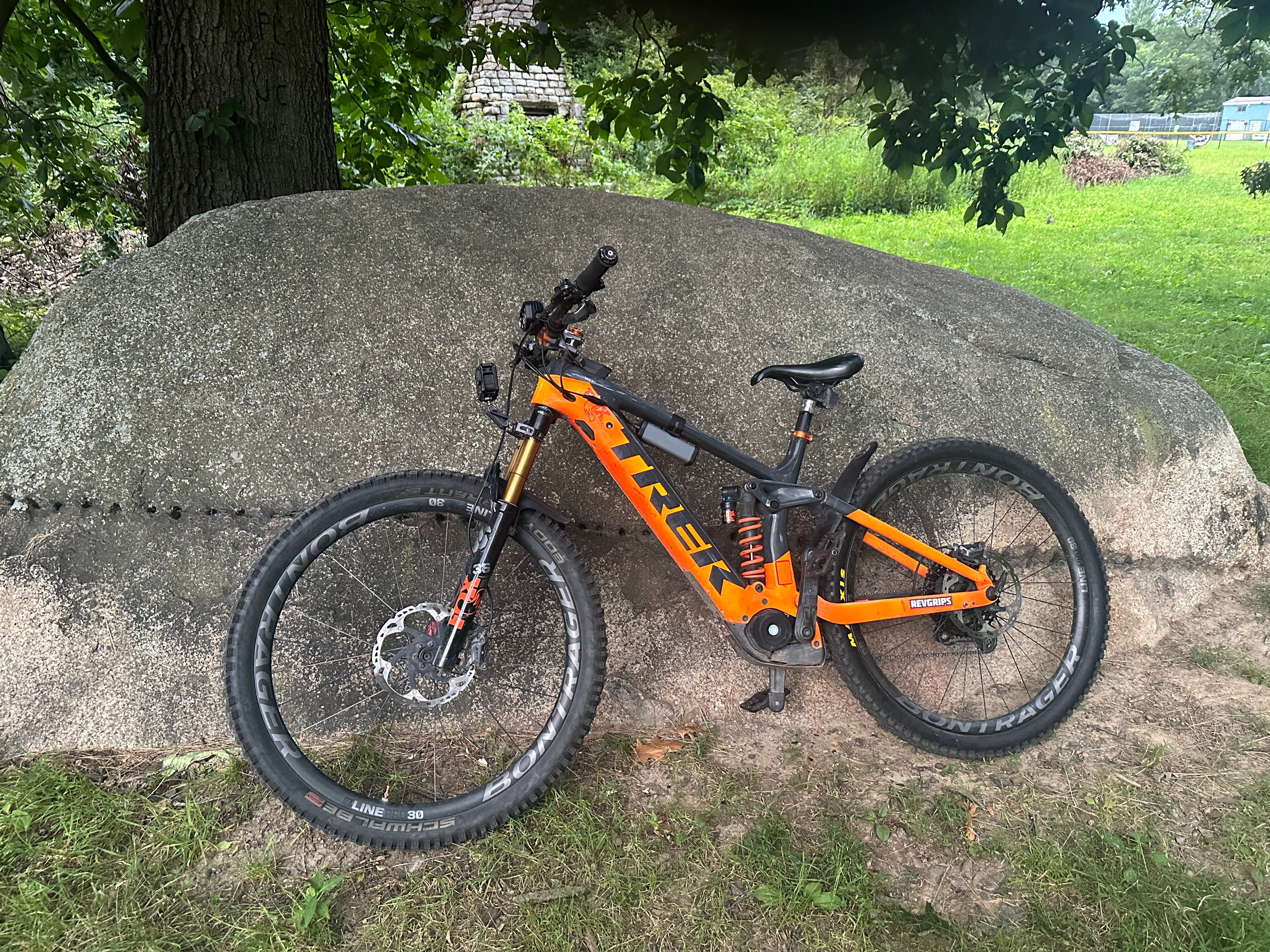

CLutch built in?? I mean seriously if the battery power fails, why is there no disengage so you can simply use your 10K 12 speed as such? Ever try to pedal when the bike either runs out of juice or with Trek one if its many "errors" that pop and disable the bike. I really wondering why this even a thing. Help me understand. thanks

Maybe if you didn't have 155mm cranks it would be easier to pedal!

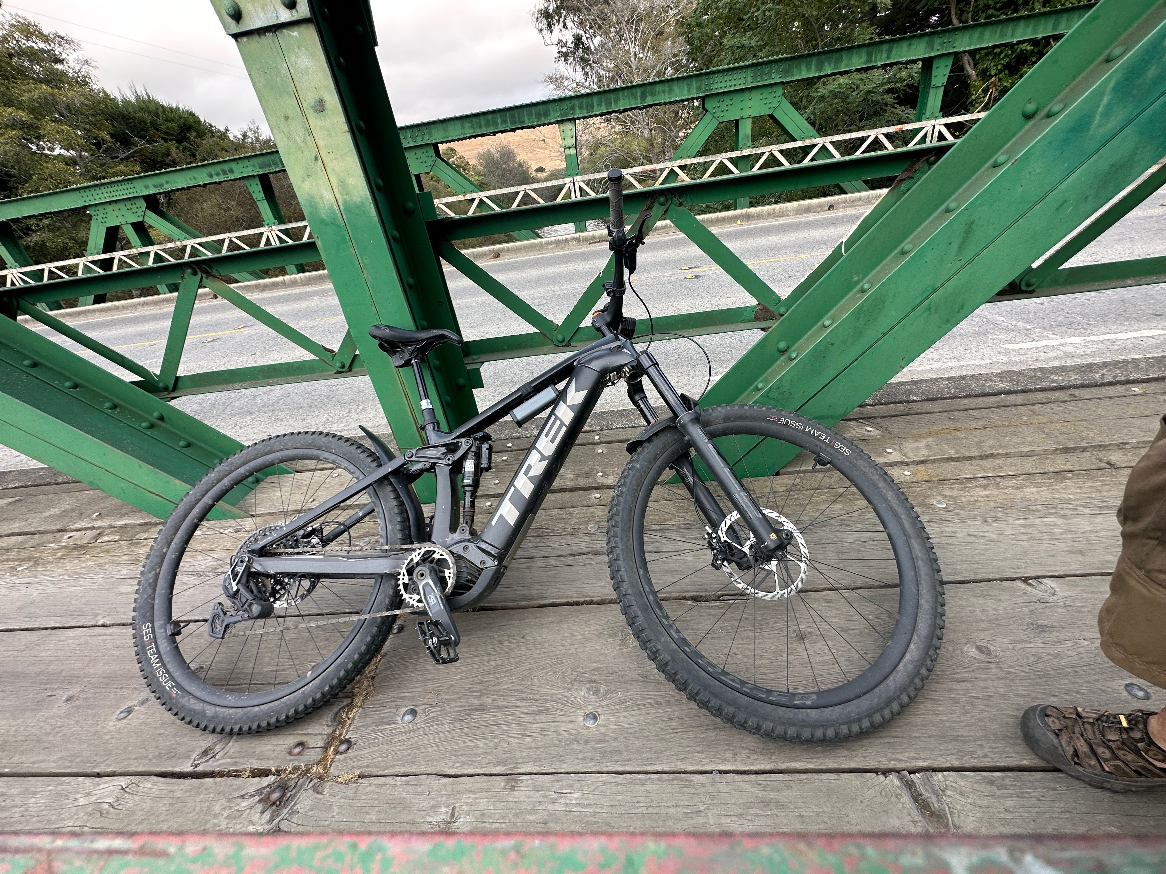

Hi, unsure what you mean by 'many Trek errors'.
The motor in my Trek Rail (2023 model) is a Bosch and as such it is the Bosch Flow software that' glitches' to produce errors... although the number of times it has done that in the 9061 kilometres (5663 miles) I have travelled I could count on one hand... If I could remember even one.
I can pull the battery out of the bike and it only gets easier to ride because of the weight reduction. Of course this means the software isnt logging power, speed, cadence etc so that is pretty boring. If your machine is regularly throwing up errors and your pedaling is driving the motor then it sounds like there is a problem in the Bosch motor.
