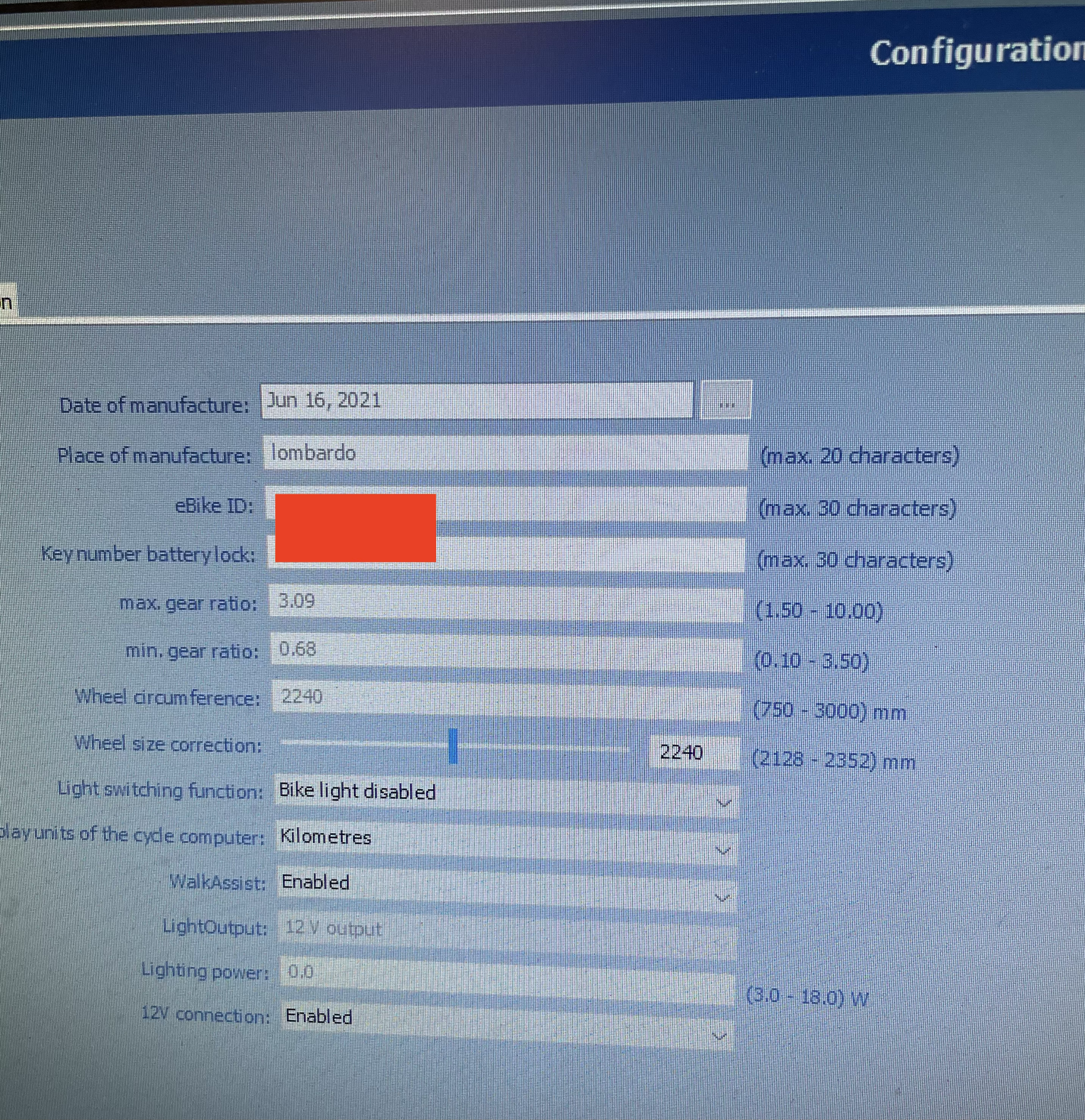

So I visited my LBS with access to Bosch Diagnostic Software tool and they were not able to update the gear ratios. Unfortunately, the values are grayed out, read-only. Not sure what to do now :(

It can only be provided by your maufacturer.
Oh no, that would be a real shame ☹️. It would seem that "overpaying" for bikes from well-known brands is not just paying for the logo, but for an actual customer service :) Trek LBS really wanted to help but they could not change the values. Actually it's weird, because they've performed firmware upgrades and printed out reports for me in the past without any problems.
The bike is a Stilus which is sold by Decathlon but manufactured by Lombardo in Italy. I just contacted my local Decathlon store and they say they do not have access to Bosch software, just the only one main service central in the country in a different city has the access. So I'd have to get the bike shipped to them and wait weeks or even months for such a simple change. And that is assuming Decathlon Poland would actually be able to change those values rather than having to ship it Lombardo Italy 🙃.
However, I've ridden with the new gear ratios for a few hundred kilometres without any problems with errors or feeling of the ride, so I'll just keep on riding it with wrong ratio saved in the motor, hopefully without any future problems.

I checked as well. The bike manufacturer must first authorize the change to your gear ratio.
You will need to work with your bike shop to schedule a time for the bike manufacturer to connect to your bike remotely and download the changes needed to your bike motor e.g new gear ratio.
Any professional bosch dealer/LBS knows this procedure and should be able to assist you, and coordinate the change with the bike nanufacturer.
