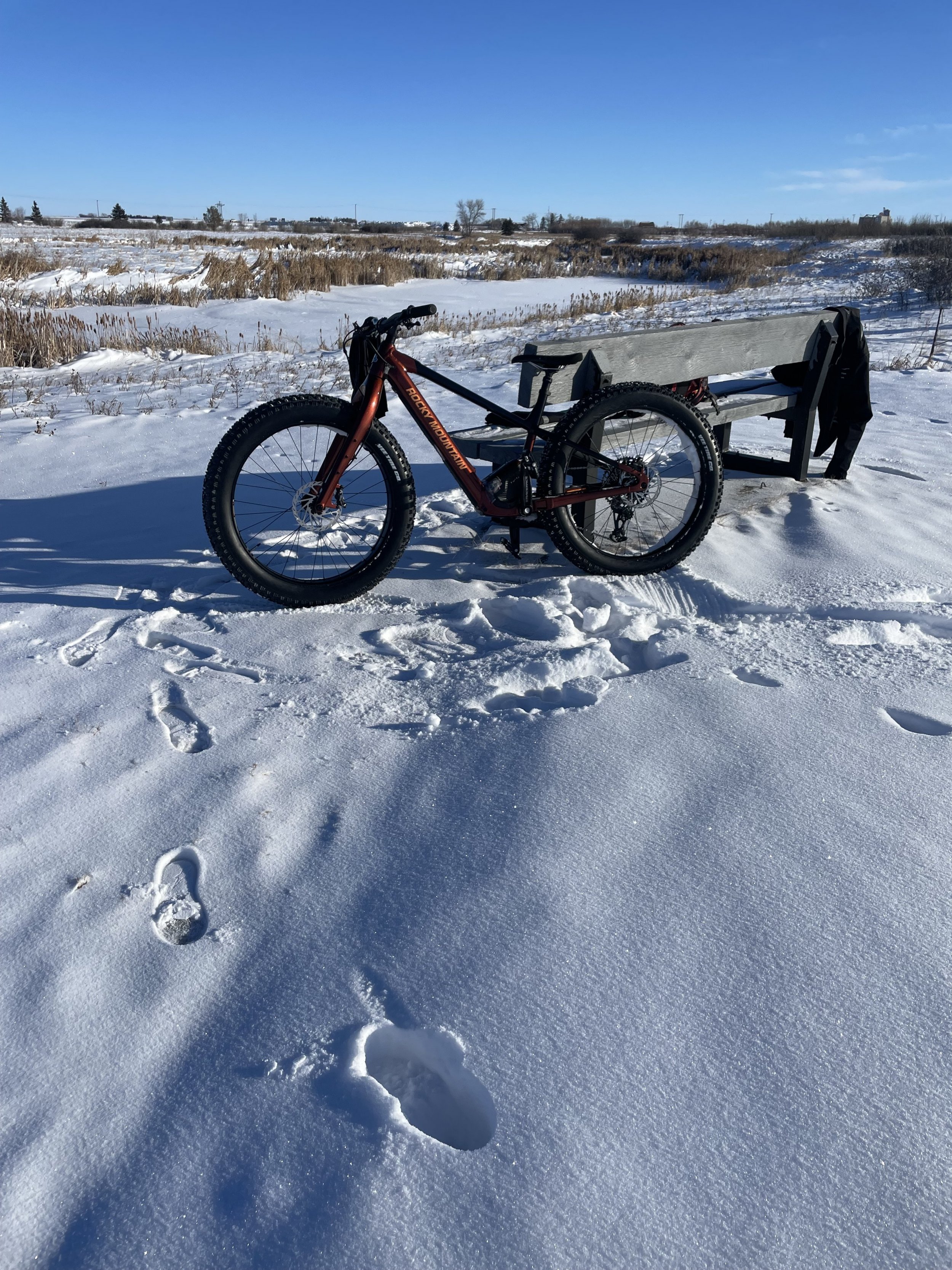

Bought a RM A50 and love it. Were I live we get snow/ice 5 months of the year most winter and lots of wind and snow drifts and with studded 4.5 tires and 107nm of power it works great. Game changer. In snow suspension is not needed. Will change my mind in summer I am sure and will put some forks on RM and 27.5/3,8 tires.
Nice bike!
