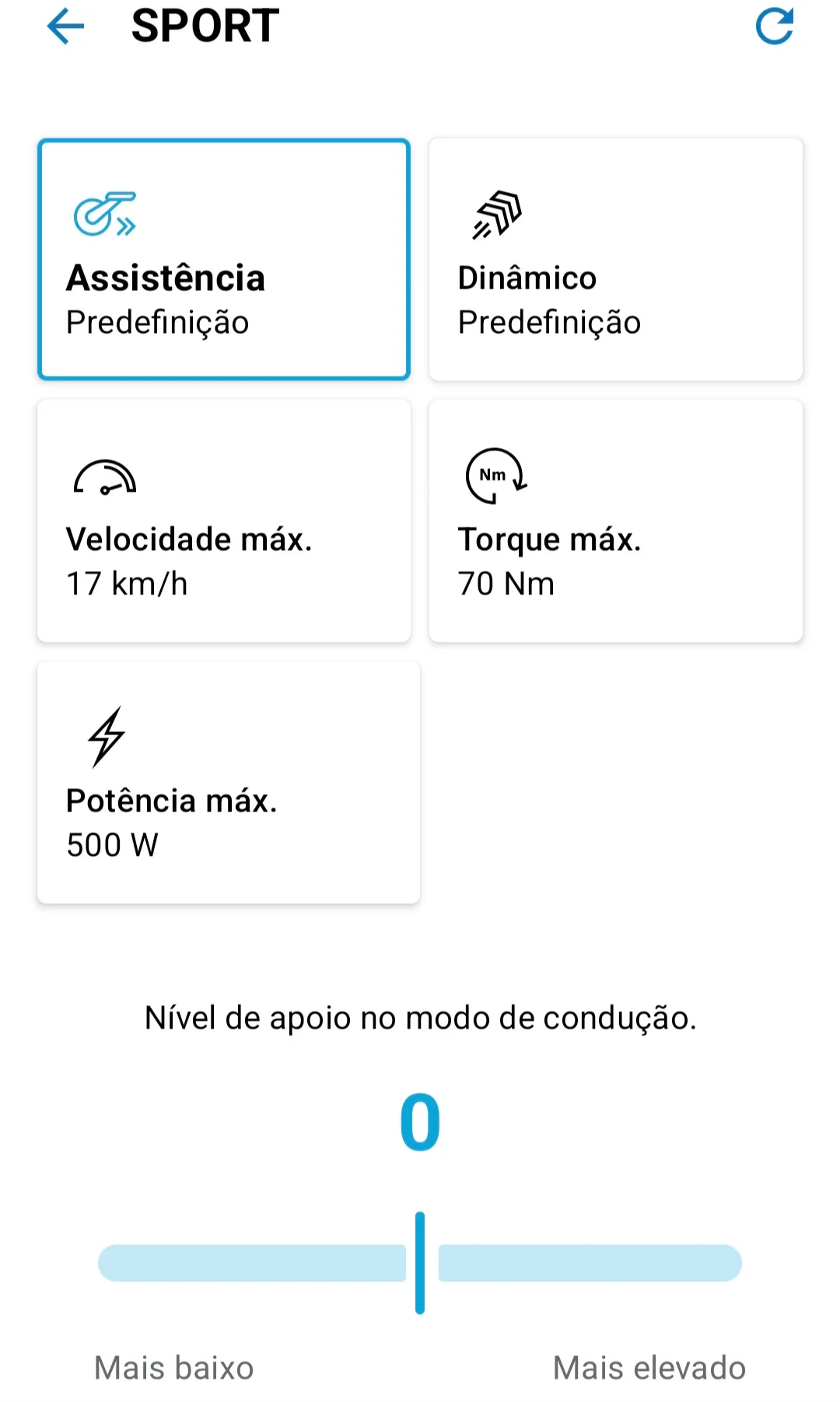

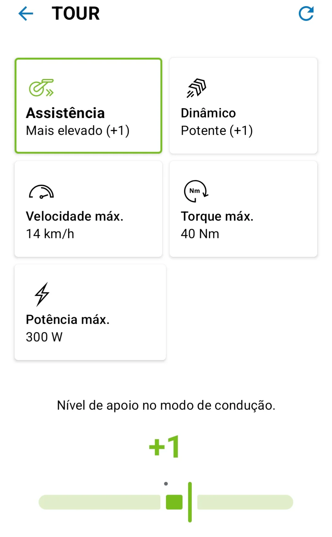

I left the watts at the default of 850, and lowered the default Nm from 105 down to 85Nm. I also set the over-run to the middle setting. If I had the skill (which I don’t) I could damn near go straight up a rock or hill in auto, yet for tame stuff auto is super smooth until you put some of your own watts into the effort. Avinox really nailed it when it comes to tuning.
